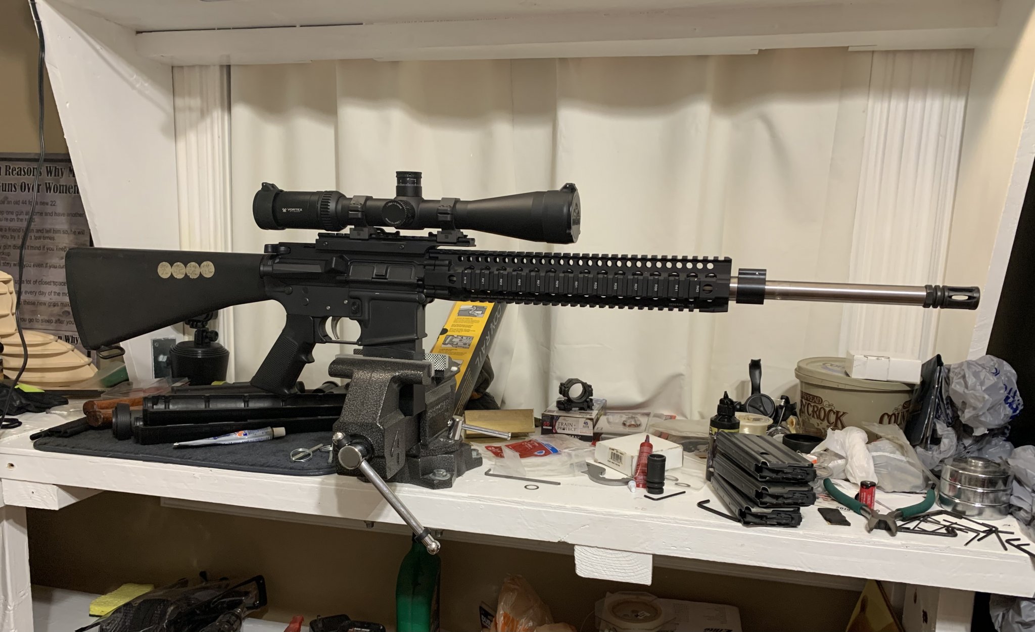

I say roll your own!
Here’s another. I put mine together using the barrel from my CLE .22LR trainer service rifle. I acquired a DD rail and an upper and put her together. It’s fun to shoot with a scope and shoots really well at 100 yds.

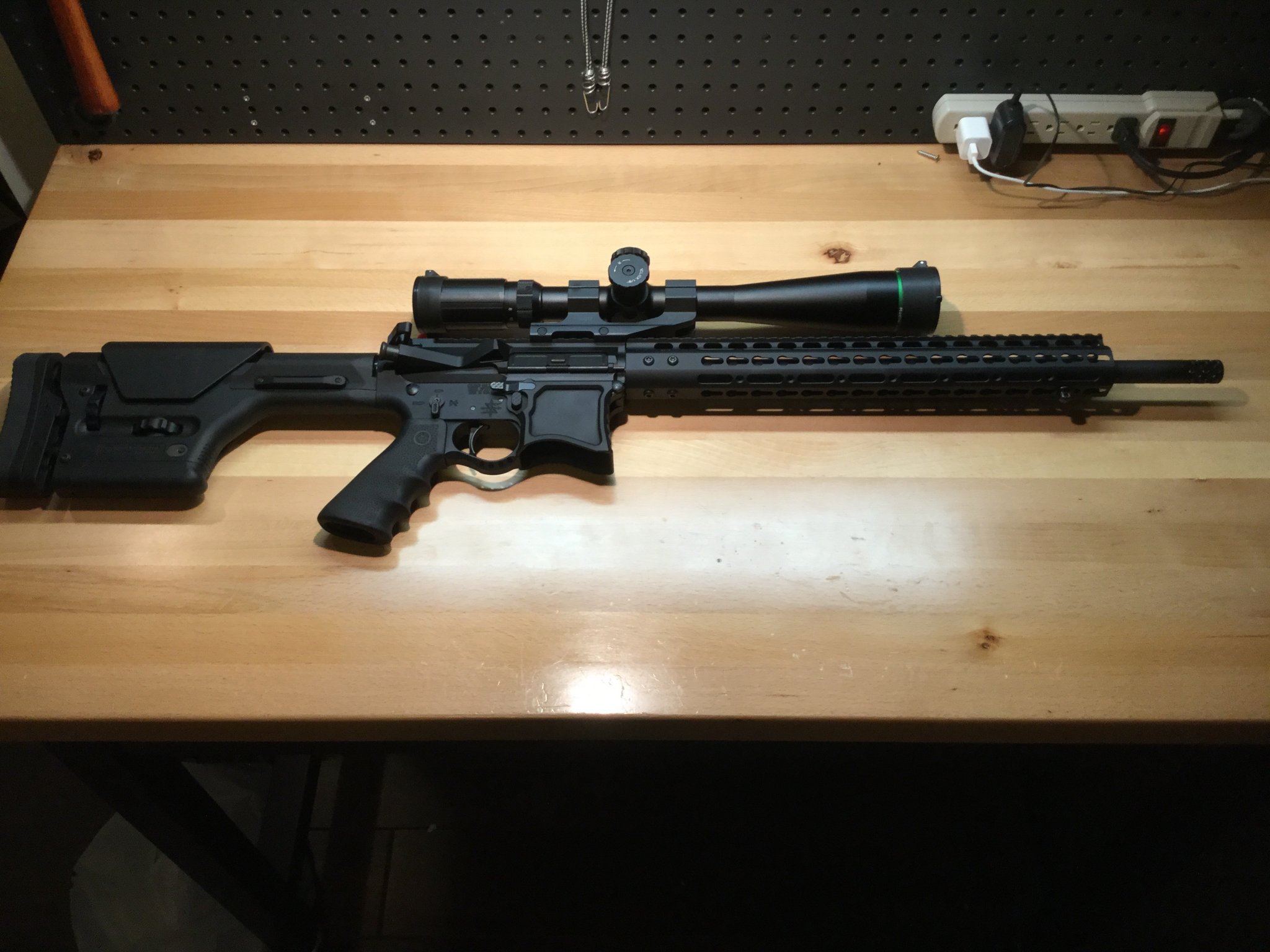

This is what I am running with an Aero upper and handguard. It runs great. My barrel is only 4.5", so not a setup for accuracy, but Beyer makes extremely high quality stuff and I am sure his longer barrels will be very accurate.

Looks good! Tell us about this setup! Were there any bugaboos?
It is a Seekins Precission billet upper and lower receiver with a Noveske NSR 15 hand guard and a Clint Beyer 18" barrel. It has a CMMG bolt and a Hiperfire 24c trigger set at 1.5 lbs. I am using a Booney Packer (I think that is what they are called) magazine adapter with SW 15/22 magazines. The buttstock is a Magpul Gen 1. There were zero bugaboos putting it together. It is very accurate with RWS and SK ammo and actually has zero problems cycling any 22 ammo I have fed it. Only problem is it was expensive as hell to build. The scope in the picture is a Mueller 8X32 but it now has a Vortex PST 6X24 Gen 1 sitting on it.
