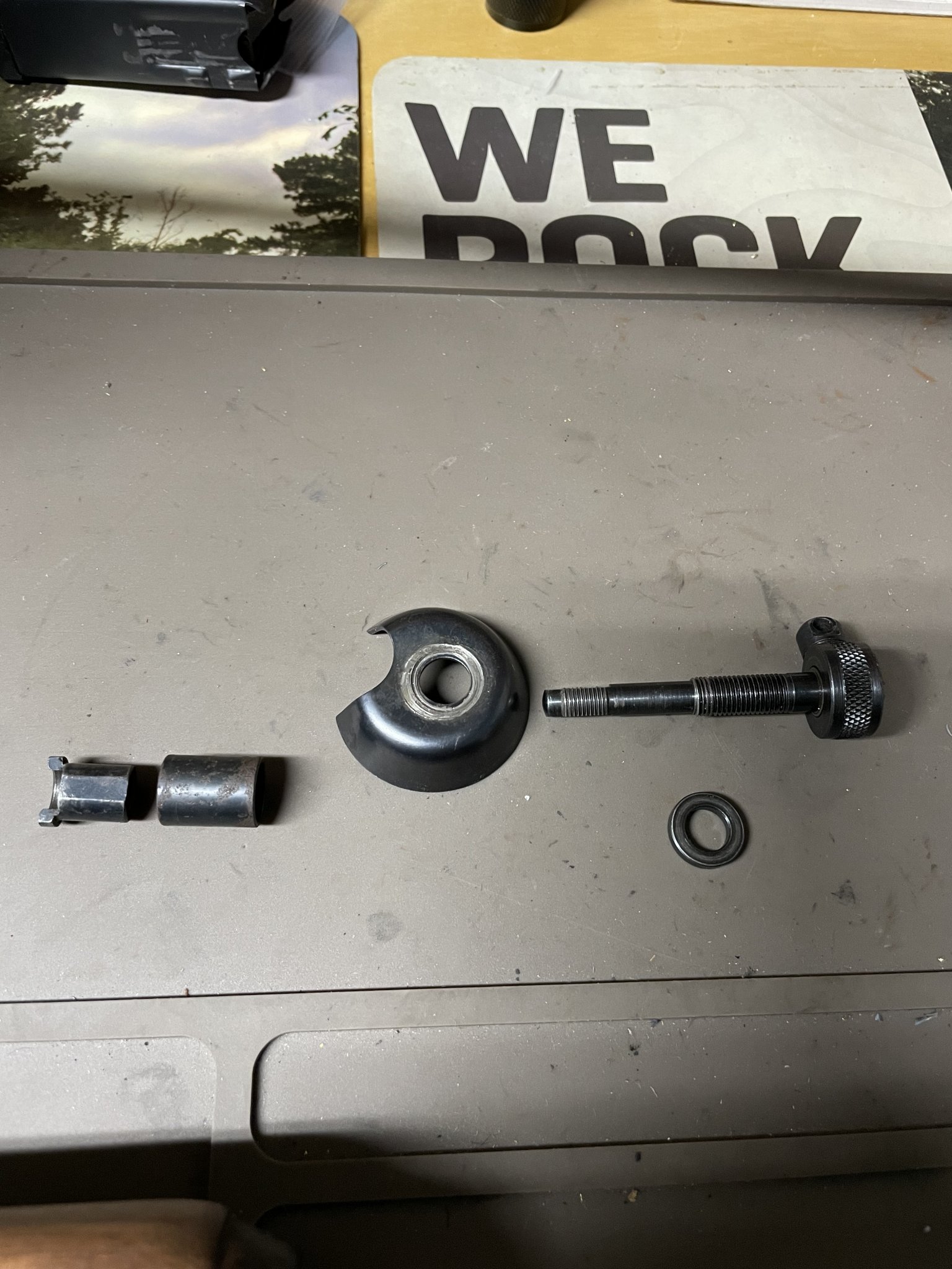

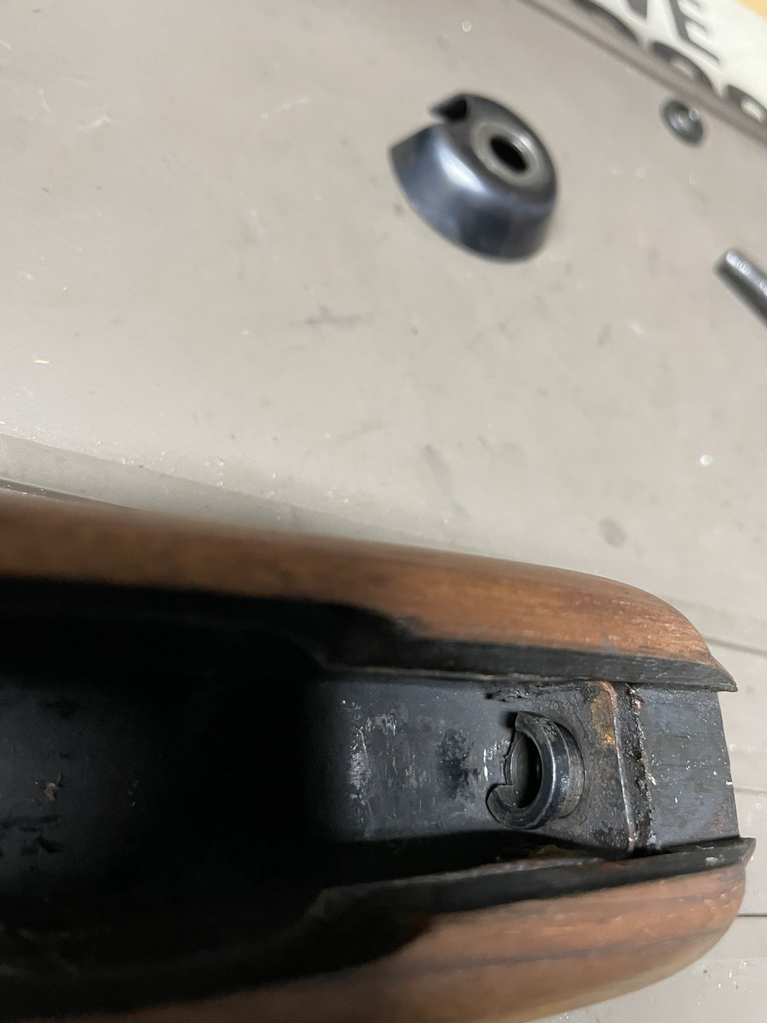

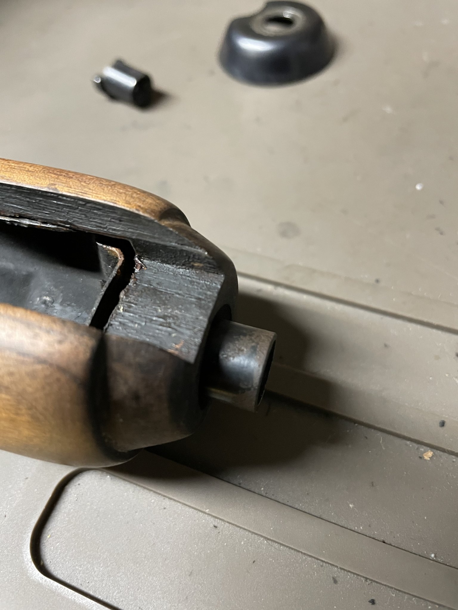

So I have a 742 that was completely disassembled probably two years ago to have cerakote and redo the wood. Rifle turned out nice and is completely back together except one thing. Funny that I got everything back together perfect except the bolt that holds on the forend. If I assemble it the way I believe it should go with the original parts that were there before then it is loose and the screw is bottomed out. I took a couple pictures of what parts I’m using. I have a threaded boss on the inside and a collar that seems to go in the front slightly pulled out in the picture for reference. I hope any of this rambling makes sense and someone can see what I’m missing. If I add another washer between the cap and the bolt instead of just the one in the photo it gets tight. But then you can hear the collar inside rattling around as it moves on the smooth part of the bolt.
I think by the looks of it my washer is to thin. The bushing that guy uses is like five of my washers. It doesn’t show in the video where those two pieces I have in the nose of the forearm if there in the correct position.

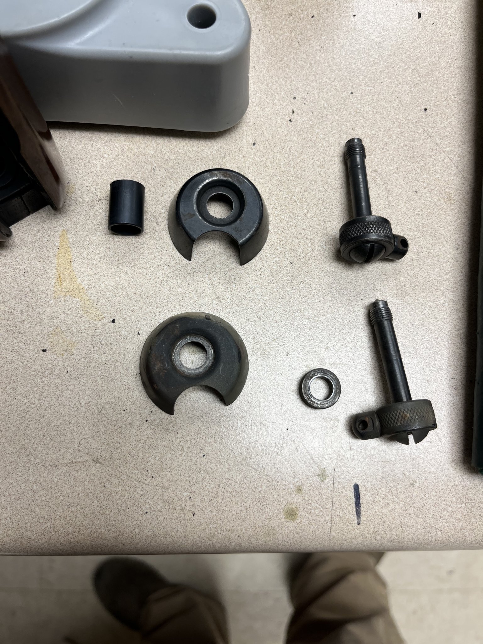

I got two 7400s in the safe. I’ll go check, but I think one of mine moves as well.
Reactions: Simonsza1
So both are similar. One is missing a spacer. Both have no “wiggle” and are fairly snug. One of the 7400s has shorter barrel

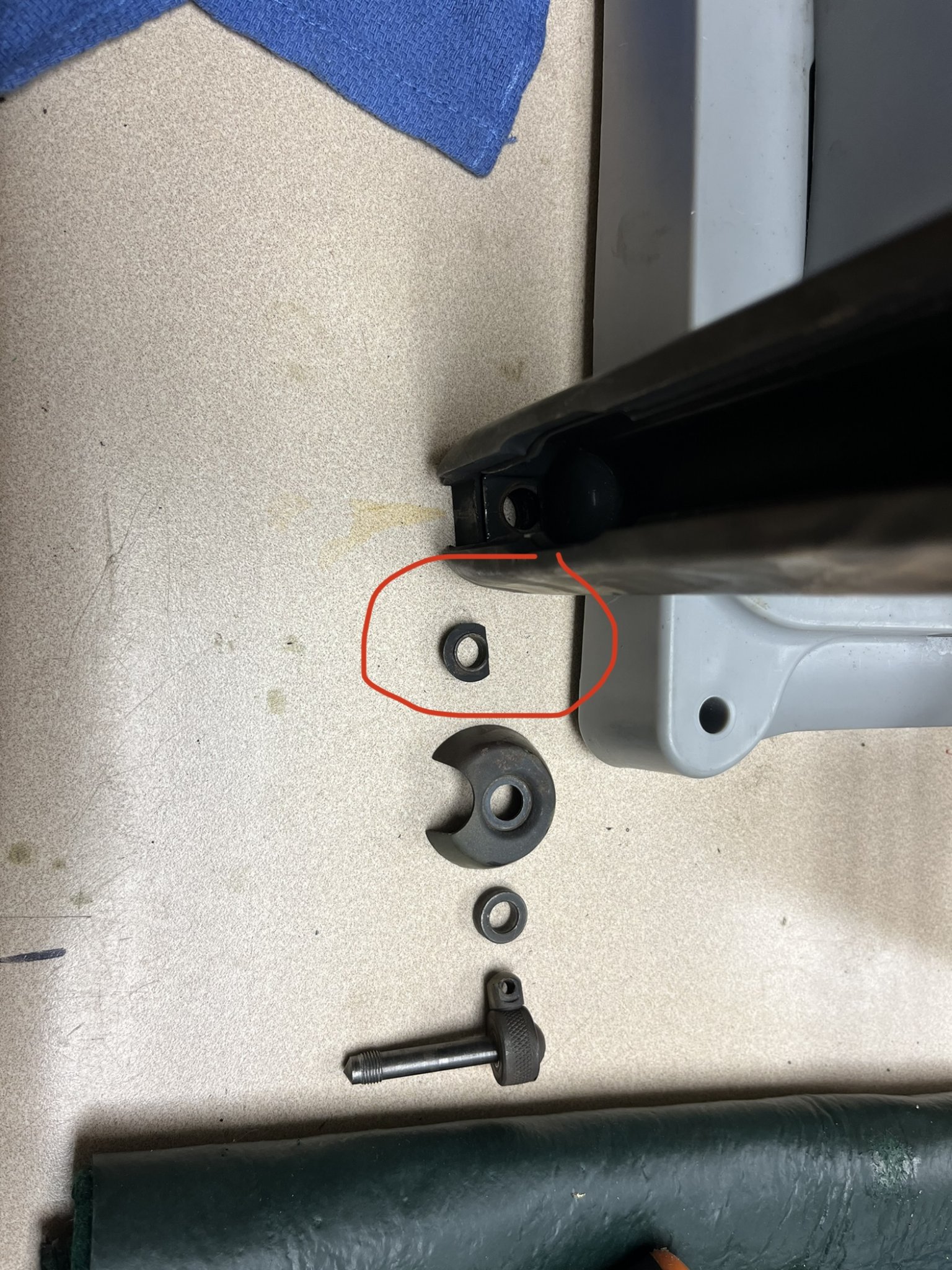

Hey rooster do you have that sleeve and the threaded sleeve in the forearm itself. I have them just slightly pulled out in my pictures so you can see them.
I have that sleeve, but it appears neither are threaded on the 7400s I have.
Gotcha! I just don’t understand how the different thread pitch idea is supposed to work. When the threaded part up on the shoulder starts to thread into the threaded spacer it goes about two threads and then locks up.
