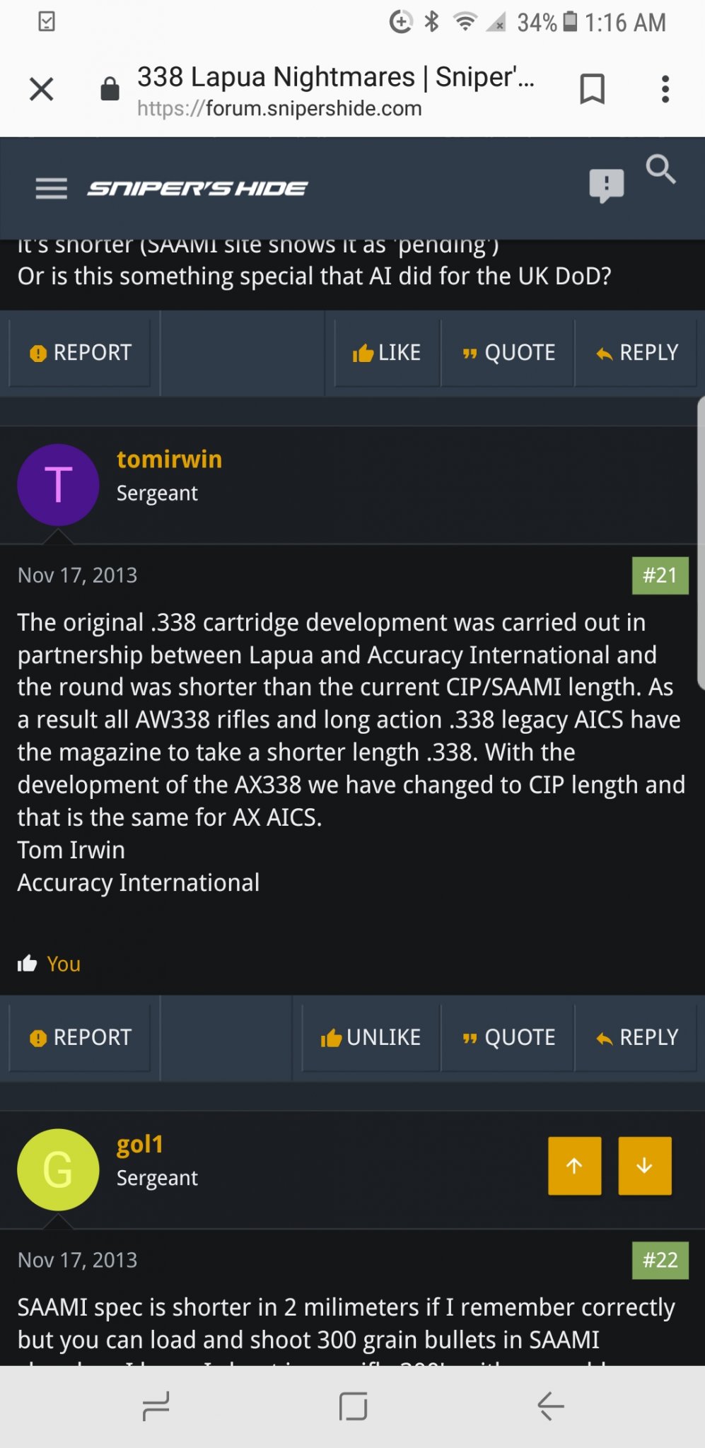

I'm building a 338 edge. I want to use an ax aics chassis that's pre2014, I like those buttstocks better. I found one for sale and it's what I'm looking for (I think). The current owner only uses normal length 300wm magazines 3.64ish I believe.. he does not know if it's CIP length/capable chassis and does not have a magazine to test this. What do i do??
I read the comment from the AI rep. Earlier in (another) thread. The way I understand it is all ax aics are CIP?? Some later comments contradict that..
Please clarify this for me, thanks in advance.
Deployed at the moment so I'm confined to using text/message style communication. I read a thread on here eariler that only confused me further.. I'll see if I can post a link.
I found this a while ago.. am I reading it wrong? I believe he's saying ALL AX ACIS will fit CIP?
There is a 300WM AIAX AICS and also a 338 specific AIAX AICS. The current 338 chassis are all CIP. The above was asking if his 300WM AICS will take a 338 CIP mag, it will NOT.
