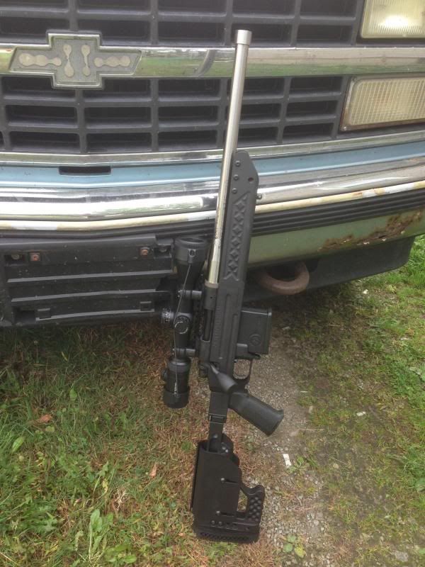

I went with a 2.0 on this 16 inch 300 Blackout and am now wanting something lighter. Between the scope and chassis it is just to heavy for it's intended purpose. Add the 1.5lbs of suppressor and it's even worse. Eventually it will most likely wear a conventional light weight stock and a scope made for the BO.
