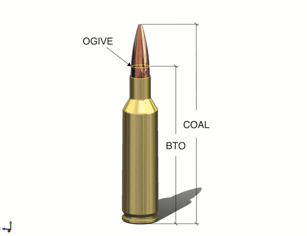

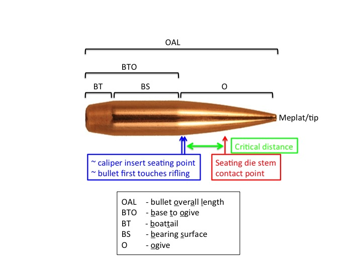

As soulezoo mentioned, the ogive is where we place our attention (CBTO- case base to ogive)
The barrel doesnt touch the bullet at the tip, it touches it right in front of the bearing surface (full bullet diameter). The tip of the bullets varies far far more than the portion thats pushed down in the case which is why the OALs rarely match even when the CBTO is the same. We want the ogive measurement to be consistent- We want where the bullet touches the barrel to be the same.
Now, does the OPs .002 diffrence now come into play with the actual .244 bullet diameter being different or is the difference between that point and where the comparator contacts as shown in this image by the green critical distance measurement?
Those are some really good pics and should hopefully clear up some of the confusion.
And doesn't the die use the ogive?
It seems to me that the die is pushing the same point on the ogive to the same length every time-- it's just that sometimes it pushes more base into the brass than others. (It sets the BTO every time, using the contact point on the ogive.)
So the only thing a variance in bullet length changes is how far the bullet base gets shoved into the brass.

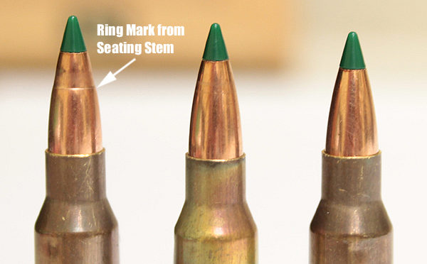

The ogive is the entire curavature from the exact point it transitions from the bearing surface to the meplat.
So, yes, the stem seats on ogive but if you were to try and seat it at that exact outermost diameter you would have a very hard time doing it well as it would have the propensity to slide about. The stem is a bit smaller so that there is enough bullet for it to not only be in contact with but also push solidly against and hopefully in such a way, over enough surface area, so that it doesn’t make the bullet or disturb it in anyway that could effect its aero dynamics.
Take the top half of your seating die out and stick a Bullet in it and check for yourself. Or better yet look at the ring on your bullets where it makes contact. Or look at the picture in my previous post, you can see a pinky fingers width above “the start of bullet ogive” line on each bullet there is another line. That’s where the stem is contacting.
Edit:
I see. I should have said "the die seats at the same spot on the ogive", then, and the die should be set to generate the same base-to-contact-point each time.
So that shouldn't change, and if the bullets are different lengths, what would change is how much bullet gets shoved into the brass.
To me where the die is hitting the bullets is not the same where the comparator is hitting so I could see the 1 to 3 thou difference when measuring. I’m sure if you measure the same spot your die is seating the bullets then you could be getting closer results.

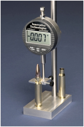

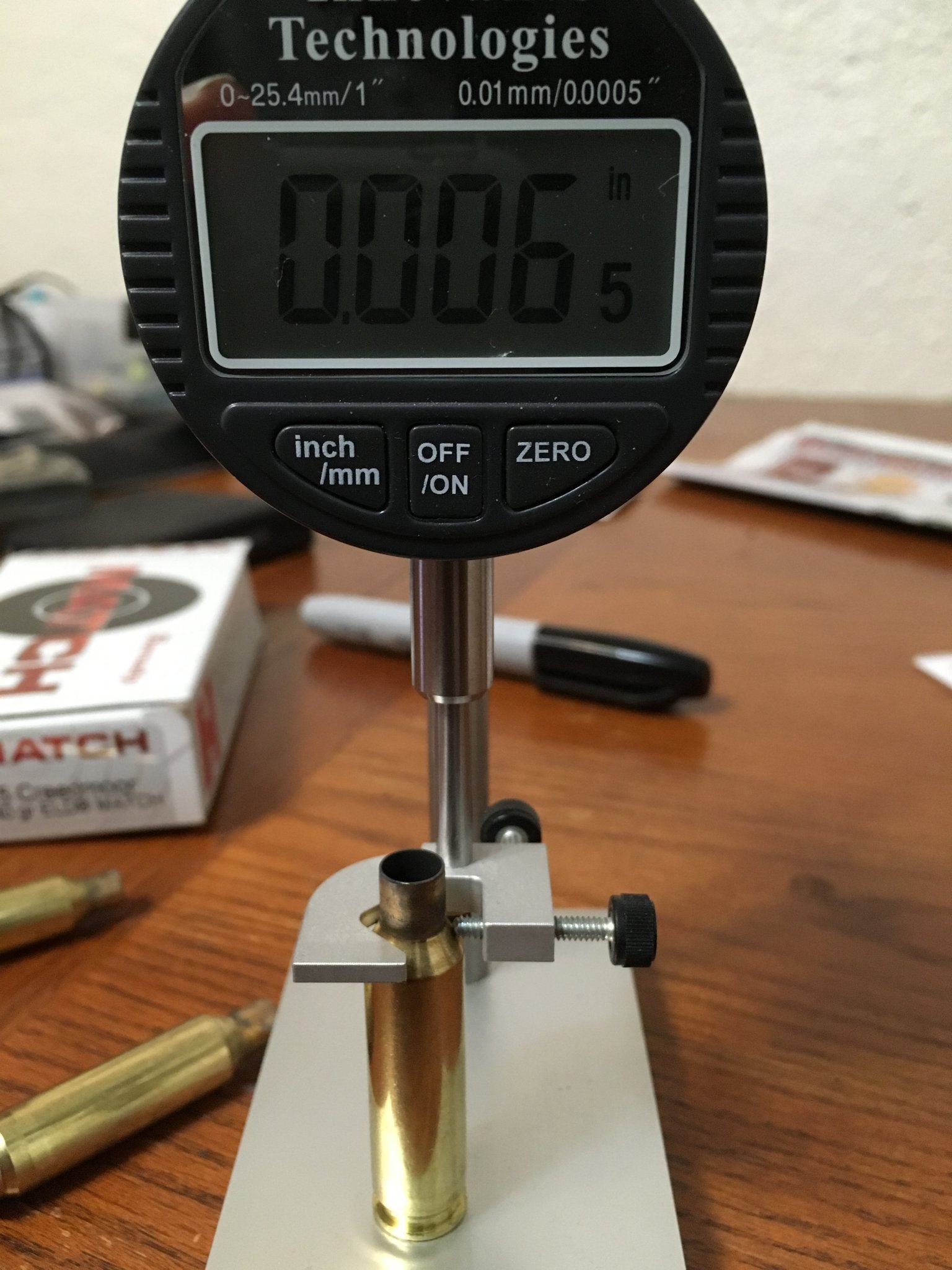

Is really chasing a thou going to make that big of diff? I only ask cause I am afraid to go down the rabbit hole. I do reload and do my best to prep my brass the same and have a fd-120i scale for consistent powder throws but that’s about it.
In my experience I have found the Hornady comparator gauges aren't the most consistent things in the world. If you take a measurement and then spin the cartridge a little and repeat you will find that you can sometimes get several different measurements that vary by a few thousandths. Also if you tighten the comparitor body onto your caliper arm too much it will actually cock the comparator off a little bit. I don't get hung up on being at lets say exactly .020 off the lands, if i'm .018 to .022 im not going to stress about it as long as all my loads are coming out within 1 or 2 thousandths of EACH OTHER at CBTO. I load up a dummy round using the comparitor gauges to get as close to my desired CBTO as possible (spin and recheck in the comparator a couple of times). After that I use a gauge that I bought from http://www.larrywillis.com/ for comparison of the rounds coming off my press which I have found to be far more accurate.
I also use that gauge to measure shoulder "bump back" when resizing as I find it to be extremely accurate for that as well. As a couple of others have already mentioned both of these methods are subject to error if your primers are not seated below flush so use a primer pocket uniformer and get those pockets as deep as they should be. Another thing I have noticed is that my Redding competition dies are so sensitive that my seating depth will change as much as .001 with temperature changes in my reloading area, so if i'm reloading throughout the day I may have to make small adjustments here and there.
That's what I use. Damn fine tool!
