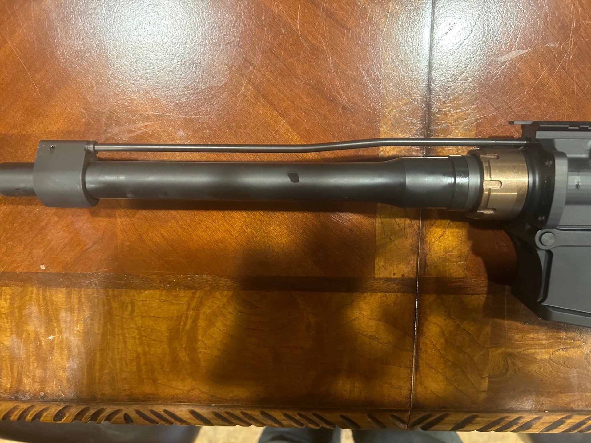

Post a picture of your LaRue with the handguard removed.

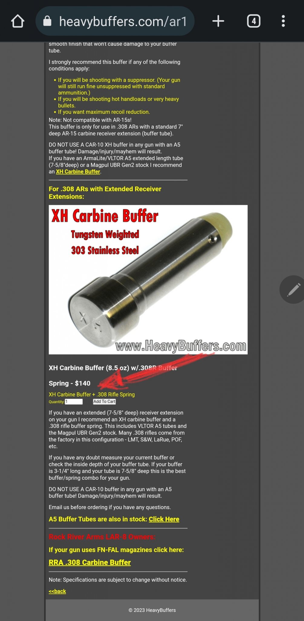

I see your update, you'll need a new gas tube also. It will be more difficult to try and reuse the existing one due to the ferrule. I assume it has that update, if not it's just the roll pin.
I recommend the buffer+spring combo at the bottom of this page, that will help solve your issues along with the gas block. The block alone probably will not do it.
fixing to post some pics. Man im sorry but a $3k AR not designed to be suppressed in this day in time... come on now.
Im not against buying the buffer+spring but Tech guys over there never mentioned it... Just said drop the Sentry in and adjust it out.... am i supposed to get the XH version as i see its for suppressed weapons specifically?

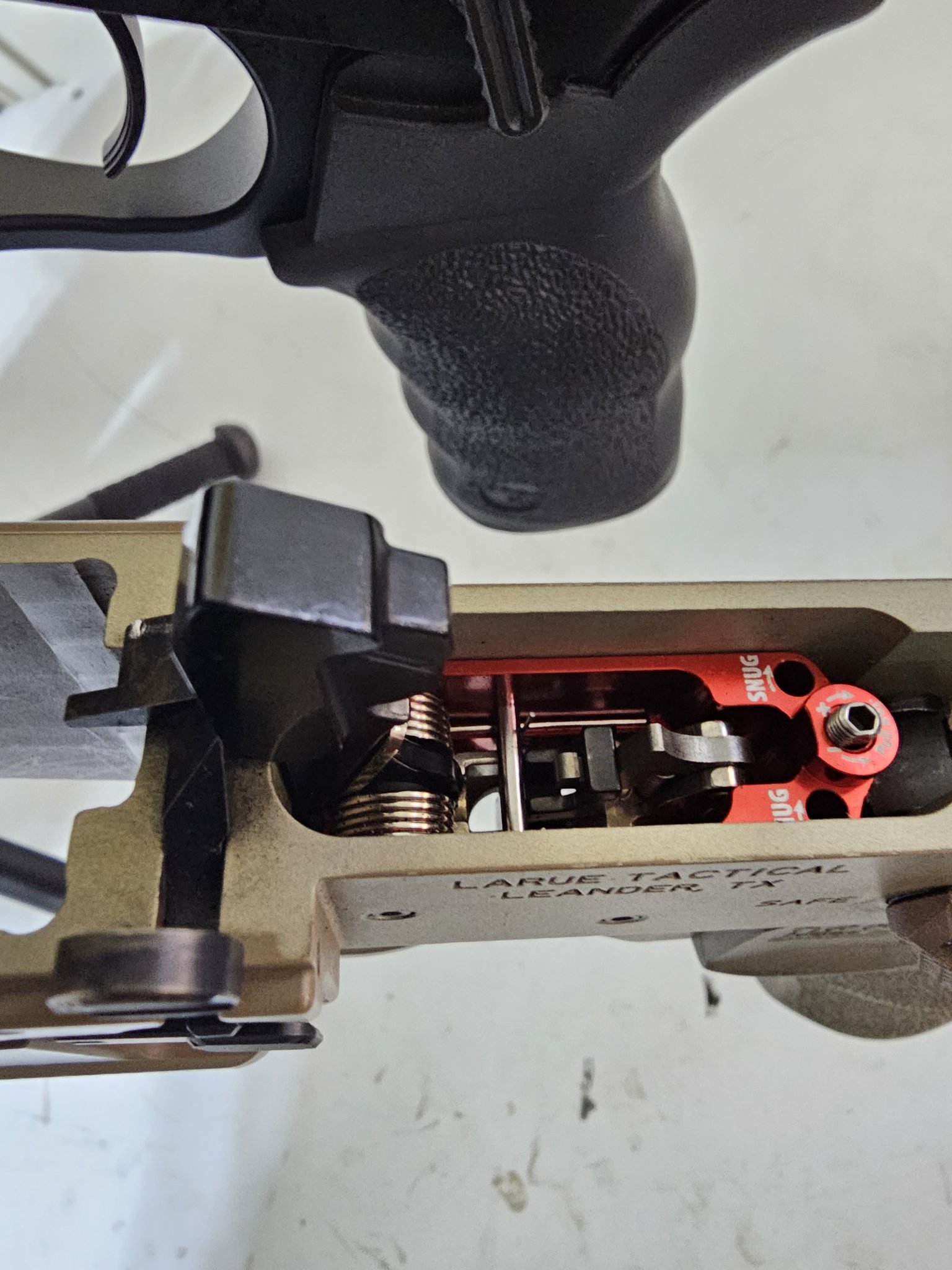

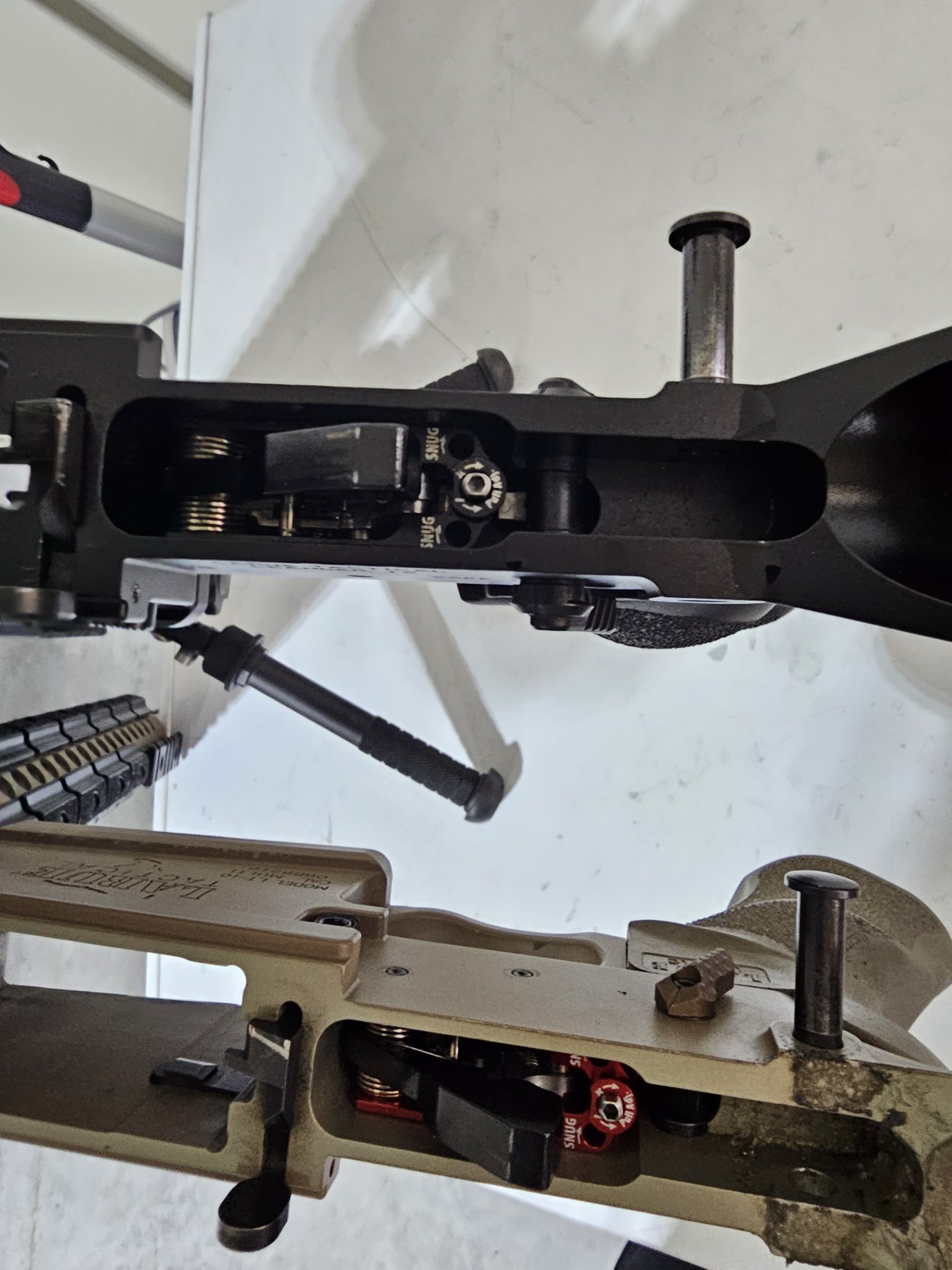

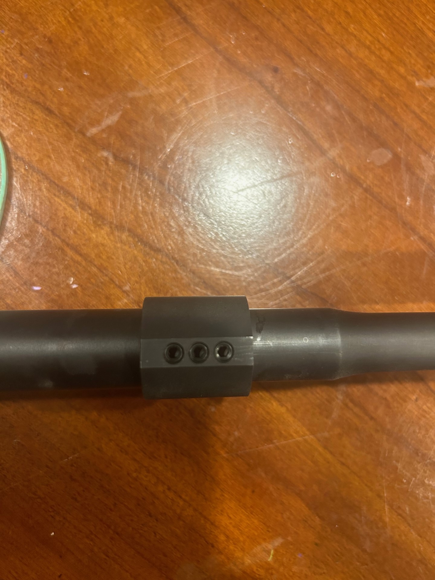

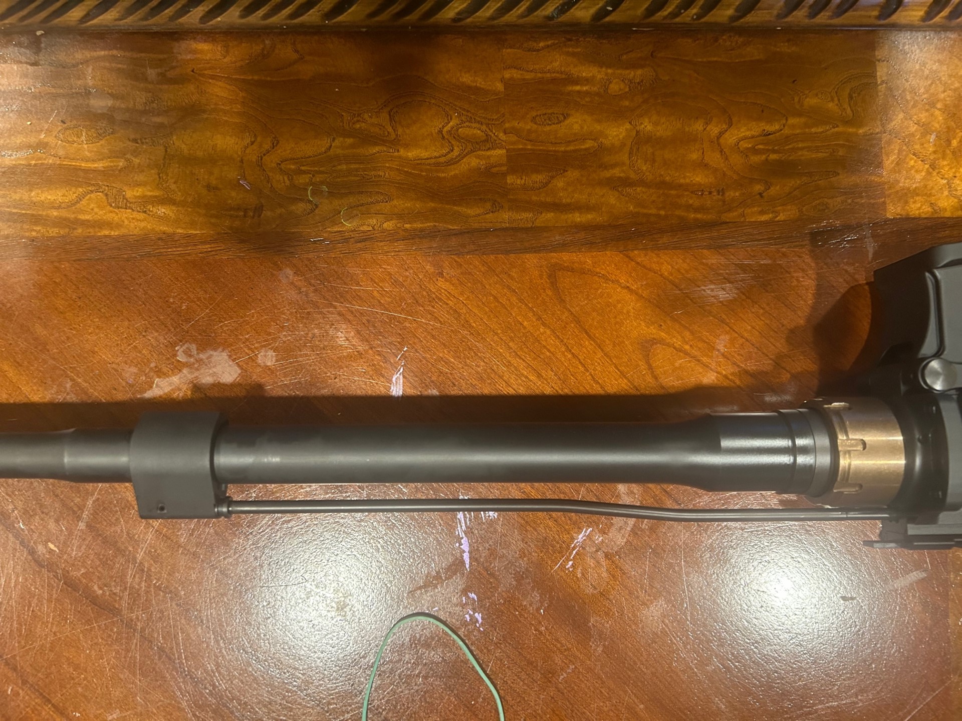

Here is both sides, and bottom with the 3 allens. i see the roll pin which i have tools for. Im assuming those allens are gonna be blue loctite or worse...
Here's the deal - traditional non flow through suppressors suck on large frame ARs.
Also, fixed gas blocks are preferable to adjustable gas blocks.
The larue suppressor is very similar to the oss/huxwrx cans.
I got so fed up screwing with AGBs and other tuning crap, I just bought an OSS can for my gas 308. You can probably make your rifle and silencer work, but that fixed gas block is a "feature not a bug".
I personally wouldn't waste time with a high back pressure can and a large frame. Gas to face, dirty crazy fast, vastly decreased reliability, just not worth it.
I can't remember what year the Tar was released, it was a decade ago? It has a pencil barrel, which is for weight reduction. It's not designed to be shot suppressed, and you will have accuracy degradedation with the Tar barrel when you hang a can off the end.
Try shooting it without the can and see how it performs that way you know what the rifle is truly capable of.
The combination of the buffer, spring, and adjustable gas block should get you up and running. I am running the Dominus and the Magnus on mine and this has helped solve my overspeed issues. The spring you want is at the bottom of the page, it's 8.5 oz, and a 308 rifle buffer spring.
Don't touch those Allen screws until you see the locktite start to smoke. I usually hit them with a small map torch quickly, if you use propane your likely to apply more heat than you want to the barrel. Make sure you have some fresh Allen wrenches.

Bootleg makes a large frame adjustable carrier these days. Might be worth a shot if you don't want to mess with the gas block.

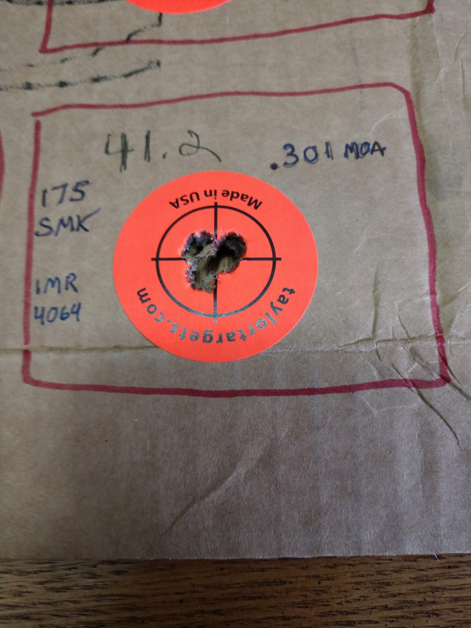

I've been rebarrowing LaRue Rifles for over 10 years now it's not hard.
My question is this, the PredatAR and DD5 V3 are basically the same weight if I remember correctly so why not just keep using the DD5 as your "Walking Gun"?
Larue rifles are a outdated downgrade with shit customer service, if you would have posted this thread in the ARF.COM LaRue forums the handful or Dildo Dust Groupies would have jumped on you like a pack of dogs with Mettee in the front, telling you it's your fault and you're an idiot for not buying the correct "LaRue Rifle"

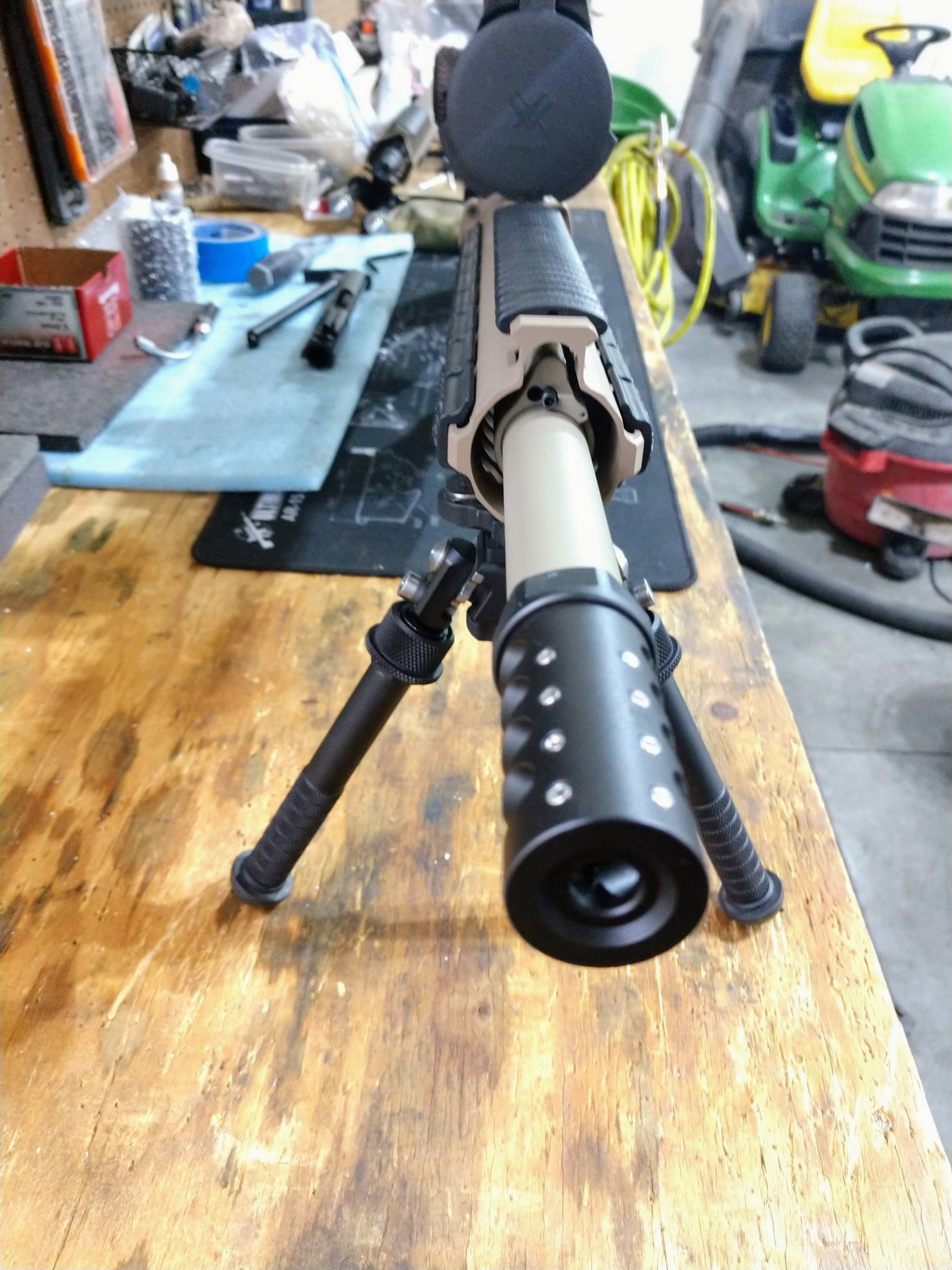

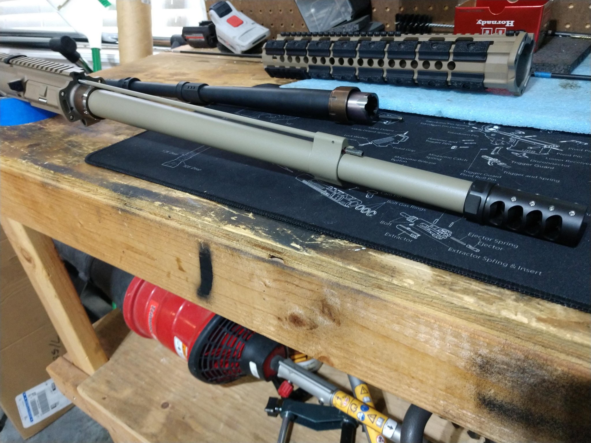

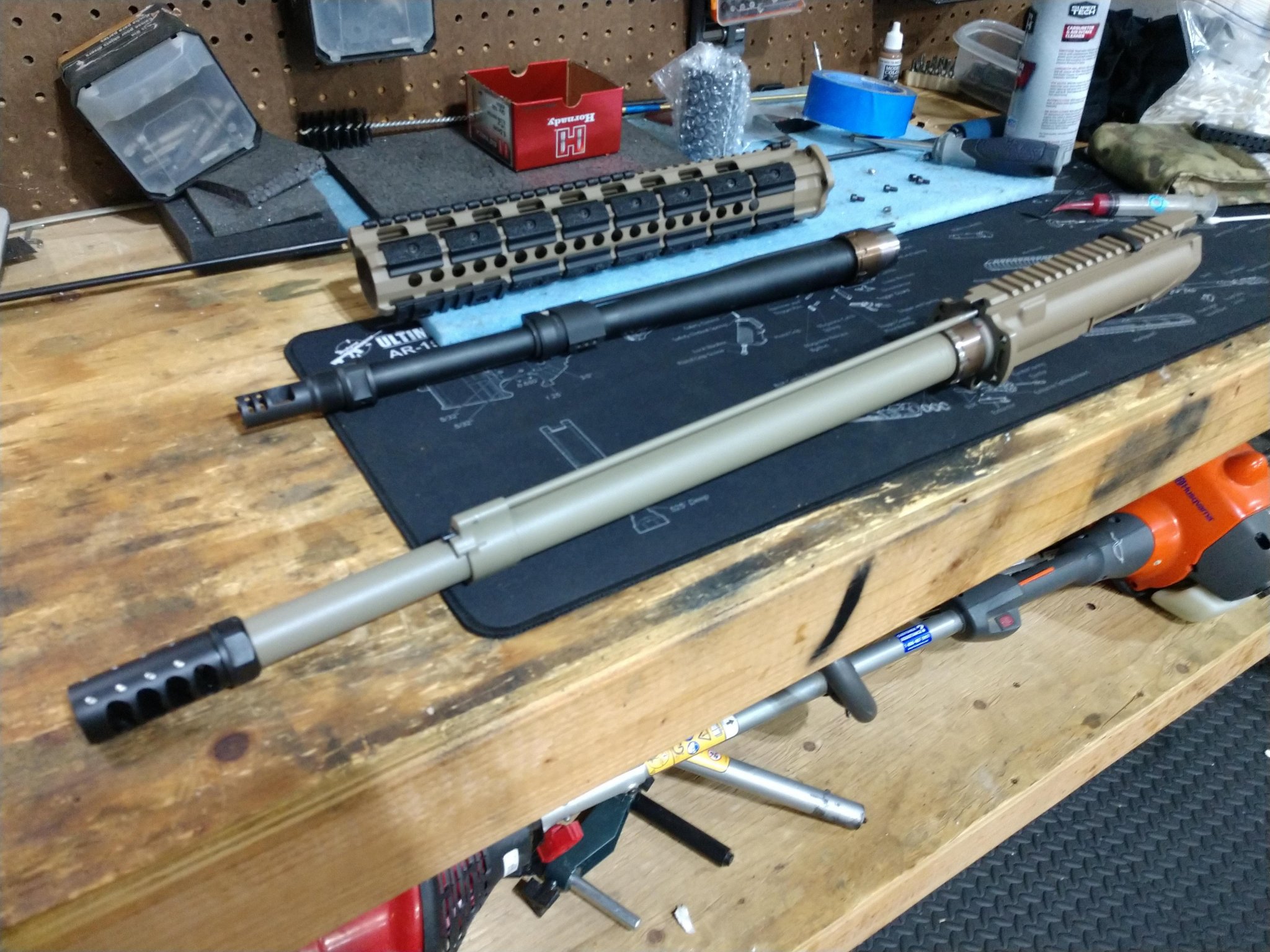

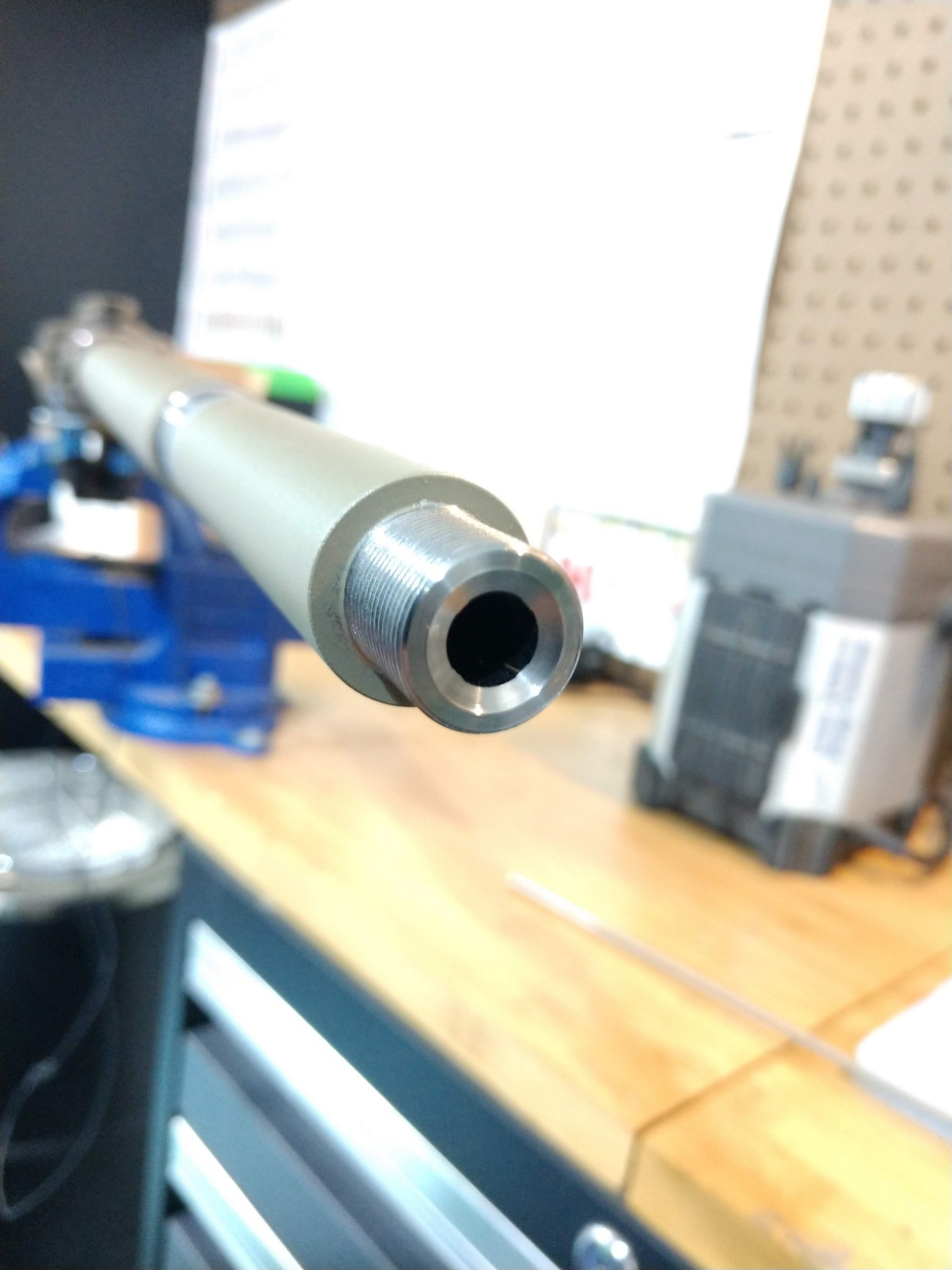

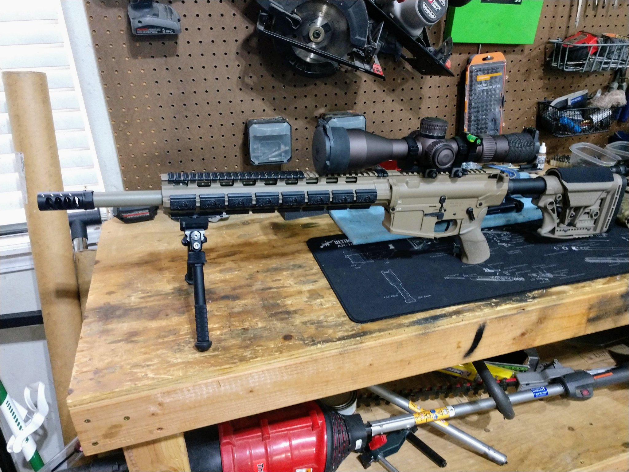

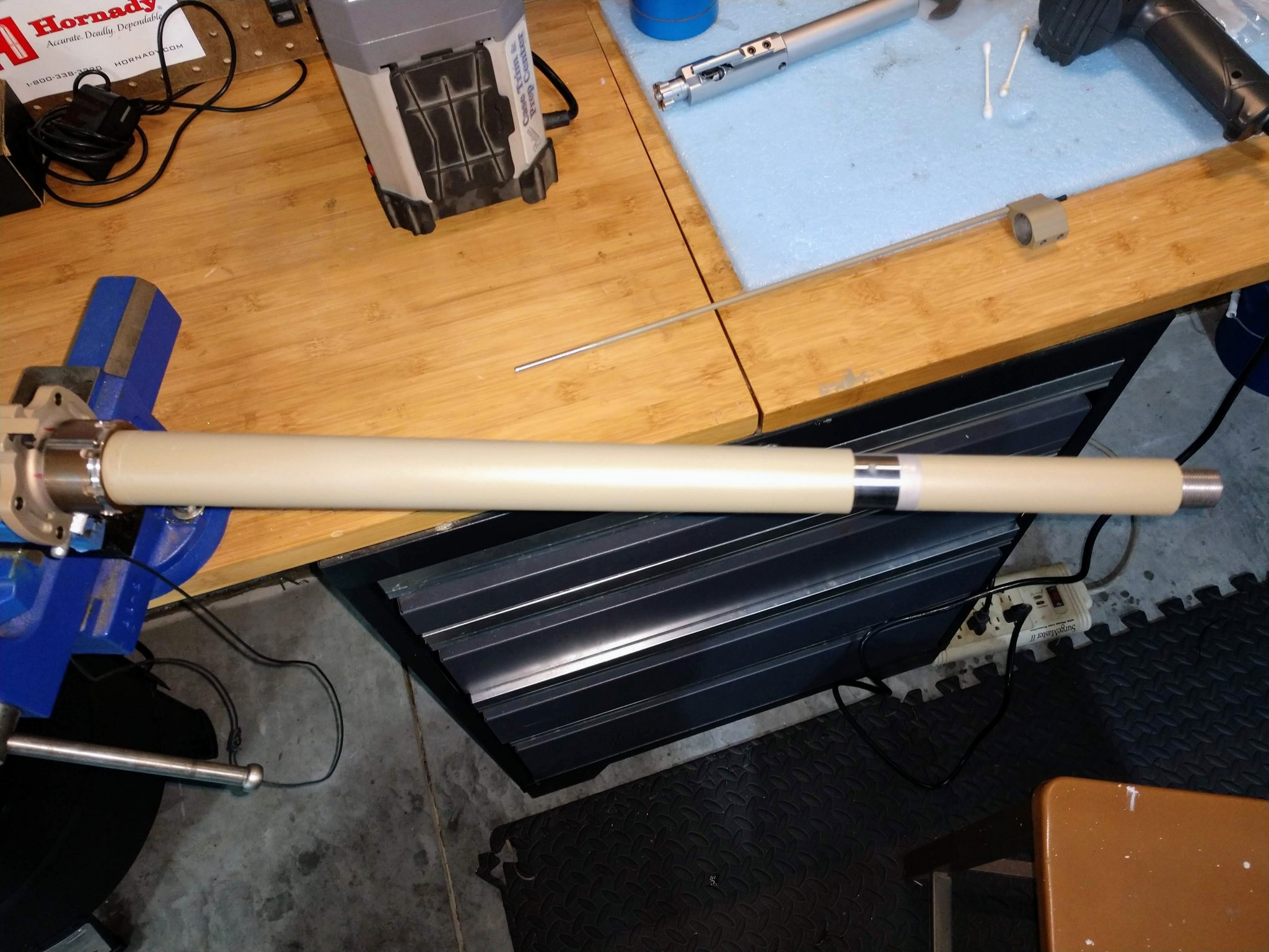

This is one of my Rebarreled PredatARs with a 18" Bartlein from Compass Lake / 1-10 Twist / Rifle Length Gas. / 5/8x24 Treads / M110 Contour. You'd obviously want a lighter profile or just say fuck it, keep your DD5 and turn the PredatAR into a long range precision set up with a Custom 20" Bartlein CLE Barrel chambered in 6.5 Creedmoor.
The CLE barrels will shoot Sub 1/2 MOA during load development, I'd like to see a Larue barrel with the XTRAXN chamber do that.... Oh Wait!! They can't because of what that bullshit chamber does to your brass rendering it useless because it's so blown out you can't even resize the Fire Formed Brass in a full length sizing die let alone a small base die. Take some of your fired brass and try to resize it.. just make sure you have a tool to removed the case out of your Die after you rip the case head off.

You have a few options:
Get a low backpressure/flowthrough can. With large frame AR's this makes a huge difference
Get a Bootleg or Gemtech 308 adjustable carrier (this would be my first choice, least intrusive and one of the cheapest)
Get a BRT gas tube that restricts gas flow, and can be designed to run with a can
Install a AGB

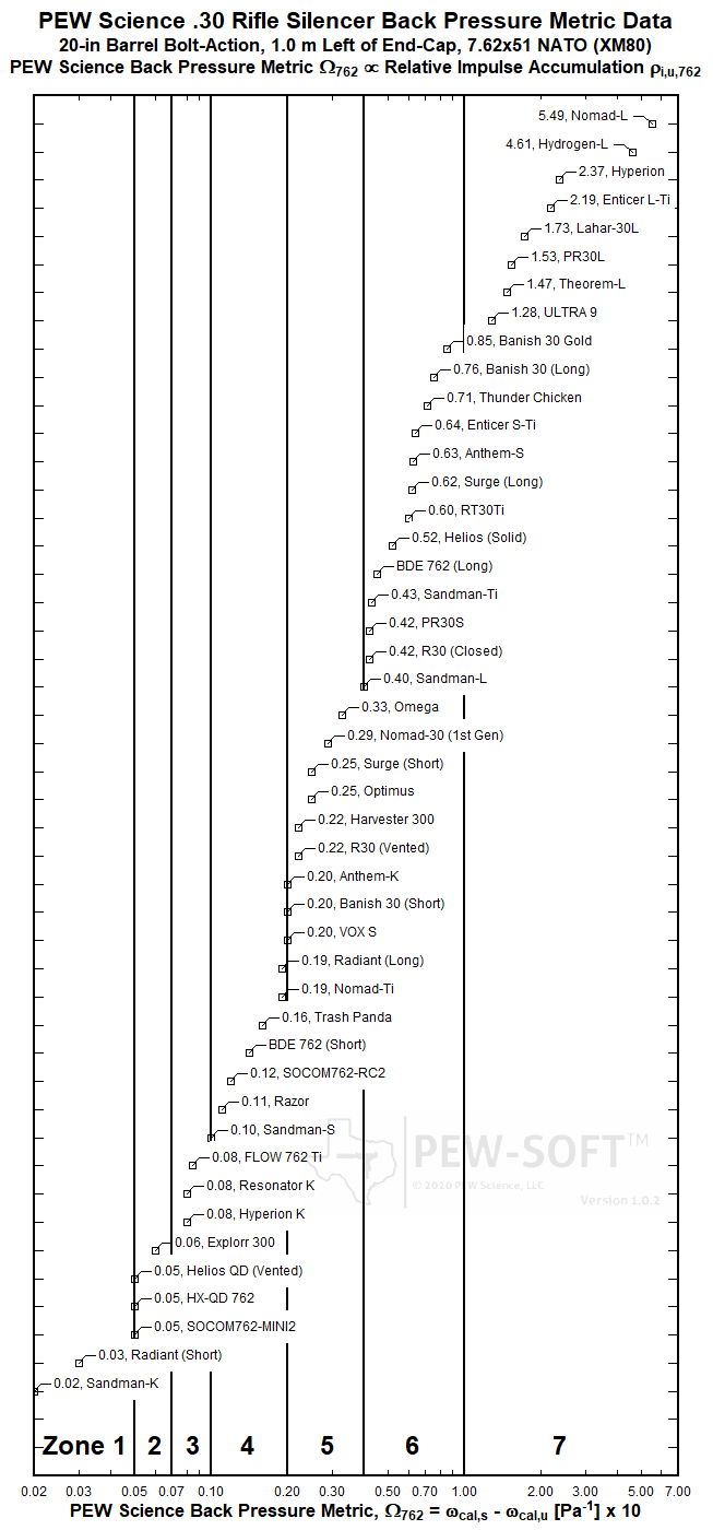

We are lucky we have so many options today with good, flow through cans:
Hux/OSS
KGM
Larue
New Velos from Silencerco
NG2
B&T RBS
and more
Here is a good list of cans rated by backpressure in case anyone wants to use to help them select a can. Unfortunately for you, the nomad-L is one of the worst on the list.
Reactions: mettee
That's why I bought a hux 😏
Agree, great resource!

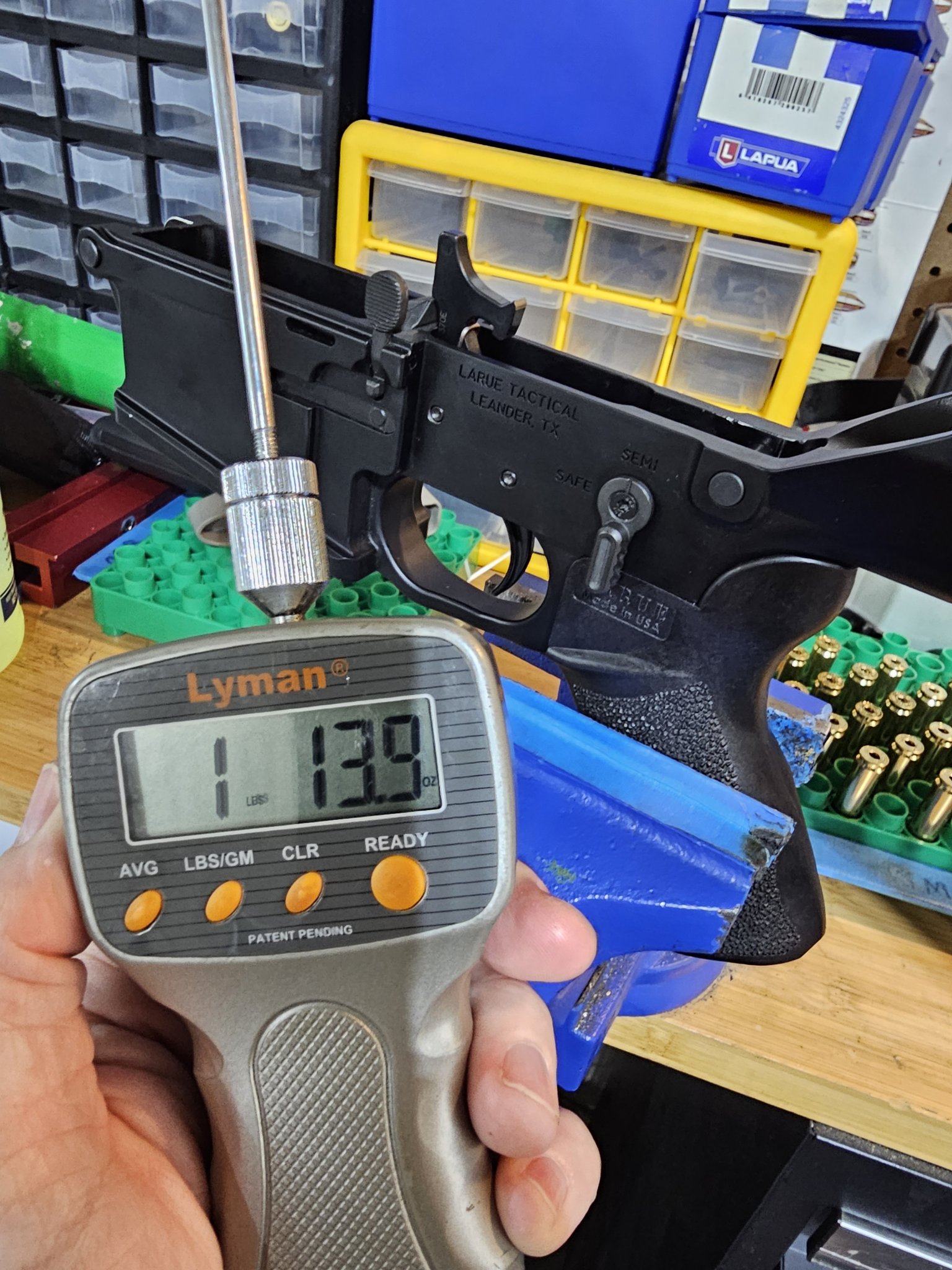

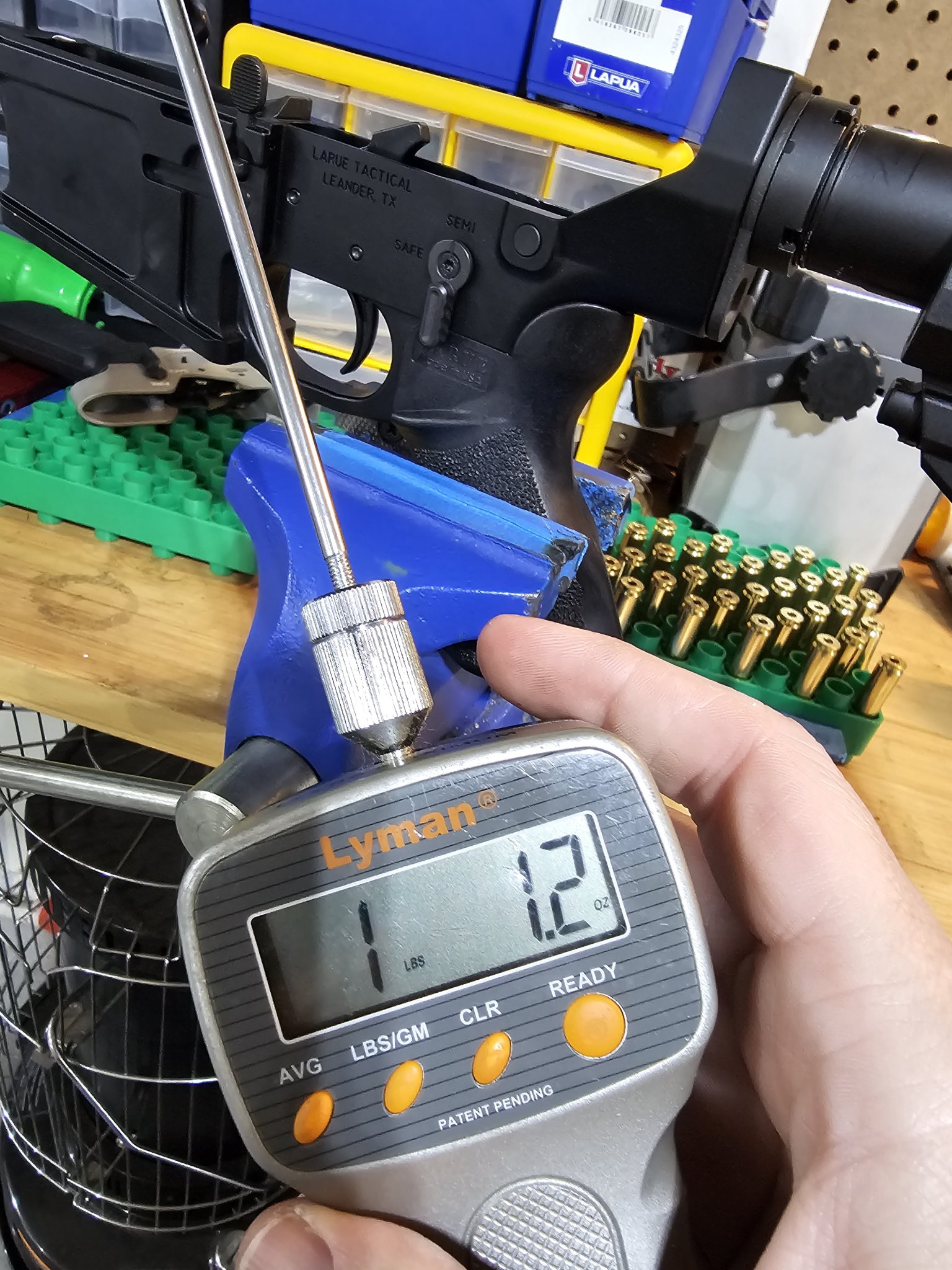

I resized hundreds and hundreds of pieces of brass in just the last week fired through xtraxn chambers without issue. Quit spewing lies, you are a liar.
Here is a sub half inch group from last week shot out of my tobr with larue barrel during load testing. And a couple 3 shot groups. Lots more where this came from.
Larue doesn't disclose things that aren't incompatibility issues to begin with, you don't know how to use the word concentricity correctly so I'm not expecting you to understand that. You obviously have an anger issue, better to keep quiet than open your mouth and remove all doubt.
Aren't you banned from ar15.com too? For this same pathetic behavior?

Sell it.
I give LaRue just as much credit as I do criticism because of his true Free Floating Barrel design and monolithic 20 MOA top rail that todate is still one of the best designed Large Frame AR'S Uppers on the market, well... used to be on the market but his true Free Floating design paird with a Quality Custom Match Barrel produces some of the most accurate rifles I have ever seen. But the facts are his oversized .308 Chambers, questionable customer service, and poor treatment of customers is irrefutable.
Problem with Seekins as i looked at them before i bought the LARUE, that sp-10 is advertised as 2lbs heavier than the DD or larue... Im going the wrong way in weight there but i know they're good.
I'll can call JP and ask about weights....
I know of Lone Star Armory in Ft worth, i was going to call Andrew over there and see what options he offers. Would you guys recommend anyone in the DFW area as far as Builders goes.

Sorry wasn't trying to detail your thread OP, but just illustrate that you're not alone with your frustrations.
If you decide to Keep the Larue and wish to turn it into a Long Range Precision set up send me a PM and I will do the work for you. You can ask around here..there's no charge for my services you just pay for the parts needed and shipping, it's just something I do to help out fellow Hide members.
All you have to do is just send me your upper and by the time you get it back not only will it function properly but it will shoot Sub Half MOA.
But as mentioned above I would be remissed if I didn't agree with the post above you would probably be better off sending it on its way instead of pouring more money into it if you've already got a DD5 shooting .5 MOA as it is.
Your DD5 v3 is already considered a pretty light rifle, what is your goal weight you're trying to achieve?
@MSTN knows how to build a light weight Large Frame Gasser, I'd send him a PM and see what he suggests.
See thats why im here, I've read people have done some 6-7lb guns and a pound makes a difference but i don't want a cardboard handguard and foam buttstock to achieve this if its not realistic its not realistic. Thats why i thought i'd call a builder.

If your Rifle was built from 2014-2020, I know exactly how this story will go. If it's a newer model I'd like to see if these issues still persist or if they've been addressed.
Same as asking them two days ago about dropping in a Triggertech tripper. gun said " yes it will fit but we can't guarantee the gun will shoot properly with it". Thats exactly what i was told.
Also regarding the TT Trigger, you're 100% good to go. Every Larue rifle I own is either running a TT AR10 Diamond or a AR10 Adaptable with zero failures.
How does the TT diamond AR trigger (I have 3 of them , 2 stage, in bolt guns) compare to the G HI speed match and SSA-E X? I have a bunch of larues but not super fond of them.
If you're wanting a Triggertech I'd recommend going with the Adaptable 2.5Lbs, the reset is much more pronounced compared to the Diamond Series so you'd better off if you like to wear gloves while shooting...
The G High speed NM are excellent, and even better with the JP Enhanced reliability trigger kit. The SSA-E and SSA-EX are also good choices and are very easy to find tune to get them to break at or under 2 lbs
As for the MBT, I can walk you through on how to tune them as well. Mine all cleanly break at 3 LBS.
I'll see if I can post some videos, usually I can't because they say file size to large.
Videos won't up load, pics will have to do..
MBT first Stage.. 1lb 8.9oz
MBT Second stage.. Breaks clean at a total pull weight of 3 lbs 1.1oz
Tuned SSA-E First Stage. 1 lb 1.2oz
Second Stage total pull weight of 1 lb 13.9oz
