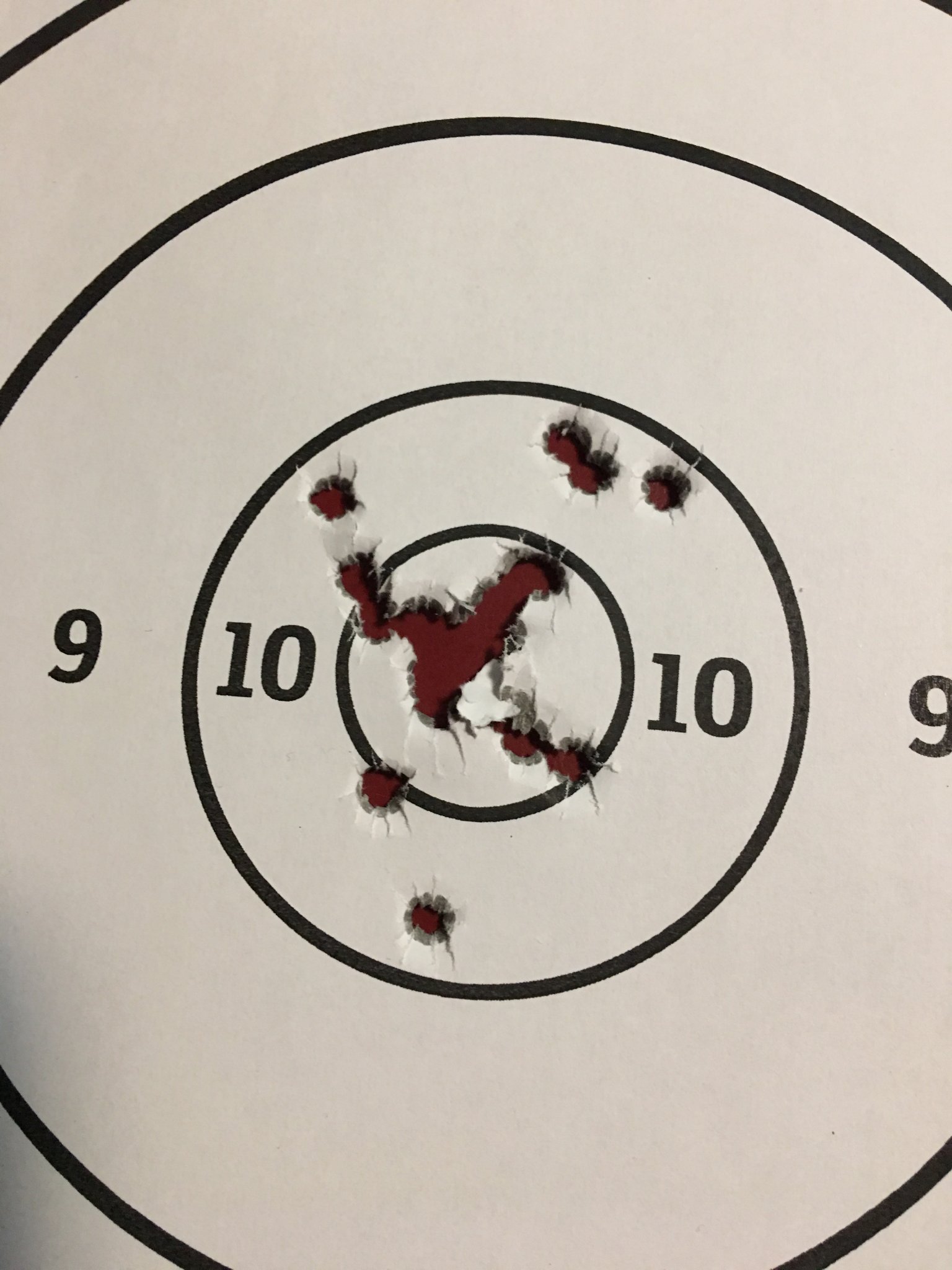

So went with Buddy today to practice at 300 yards . As u can see I shot a 200-15x on the target which should put me close to 1st place in a match. So I’m pretty happy . On the other hand my buddy is concentrating on my fliers . I think he’s asking for too much out of me and my gun . I don’t see many people keeping everything in the 10 ring . I’ve only shot one match (500) yard , 394-20x. It would have been much better if I could have seen I was shooting a little high . Anyway , opinions please ? I think he’s asking for perfection . What do u guys think ?
Thx
Mark
Could be a number of things... ammo, lighting, scope parallax, etc. but I'd probably look at shooter position first. Shoulder pressure, cheek pressure, that sort of thing.
Thank u . Shooting free recoil so there is no shoulder or cheek pressure .
I would say if his groups are better than yours listen up. If his are worse than yours well he doesn’t have much to say imho.
That doesn't mean there aren't any gun handling issues, just that they are more subtle and a lot harder to nail down. More in the return of the gun to position after every shot, little stuff like that.
I don't shoot much 'true' free recoil, mainly because I don't have the setup for it - and a .308 with 200s isn't really FR friendly either.
If you really don't think it's position related, then you're back to conditions, etc. Lighting changes during the string (sun going behind a cloud, or vice versa) can do that, as can wind shifts (direction). Mirage can absolutely screw with you like that, too. Speaking of which... you *are* using a mirage shield, right?
Actually when I shot that string the mirage shield was not attached .
