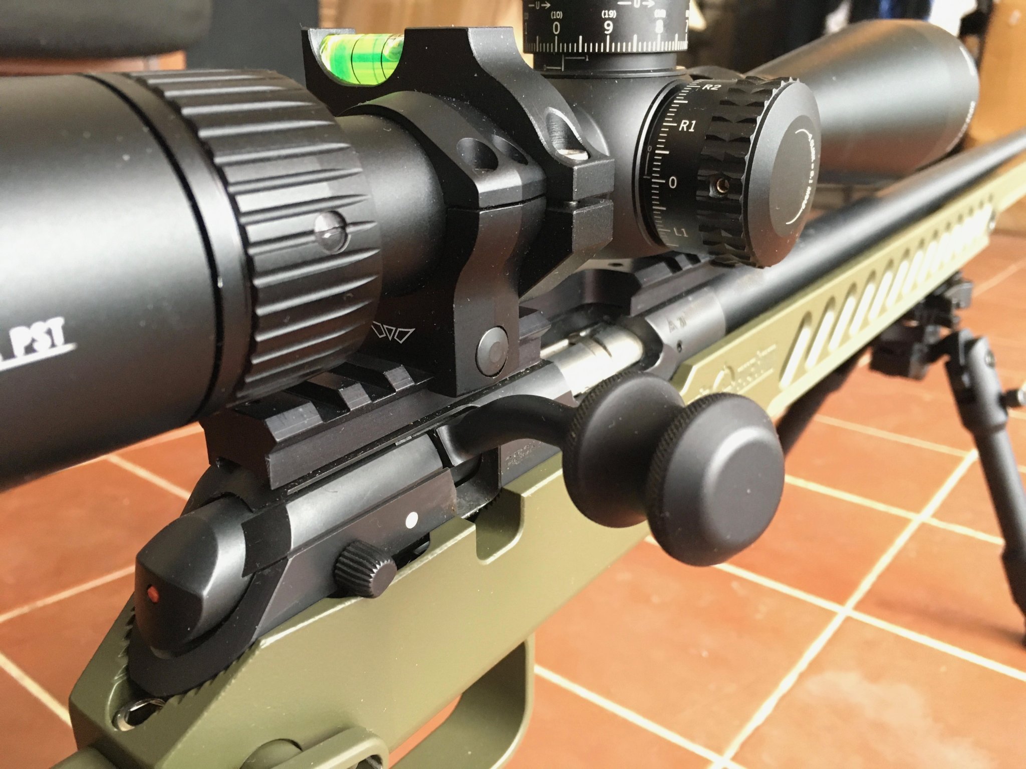

I've used a BScar 15 moa and now a 35 moa rail without issue on my 457. Generic 1" rings on the 15, now using Warne Mountain Tech 30mm medium (#721M) along with the BScar 35 moa rail. You can see the clearance here:

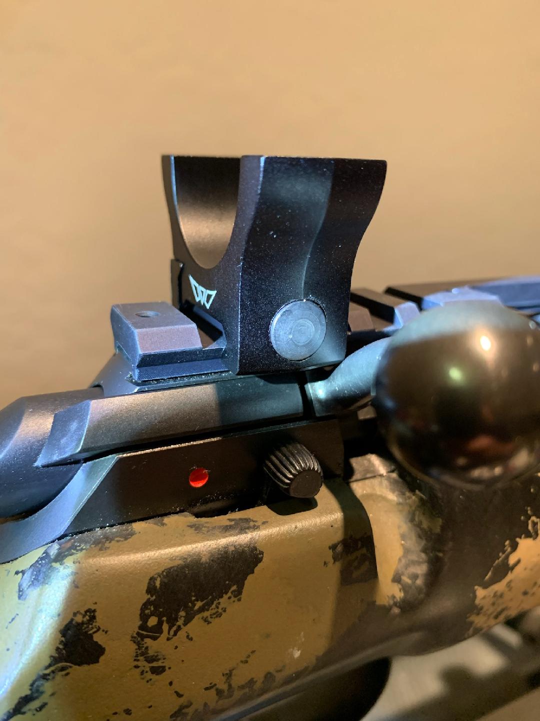

A friend ran into that exact issue with the bscar 0 MOA and his 457. Vortex precision, Seekins or other rings that are narrow on the bottom and have an upward angle work better than stuff that is wide and squared off.

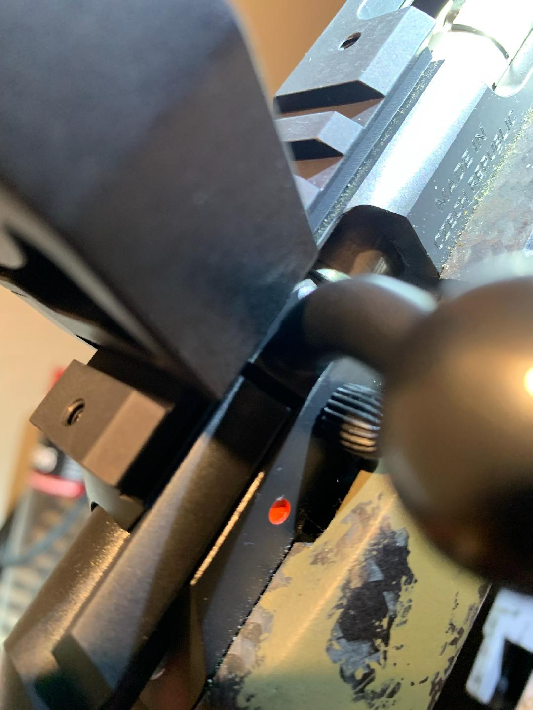

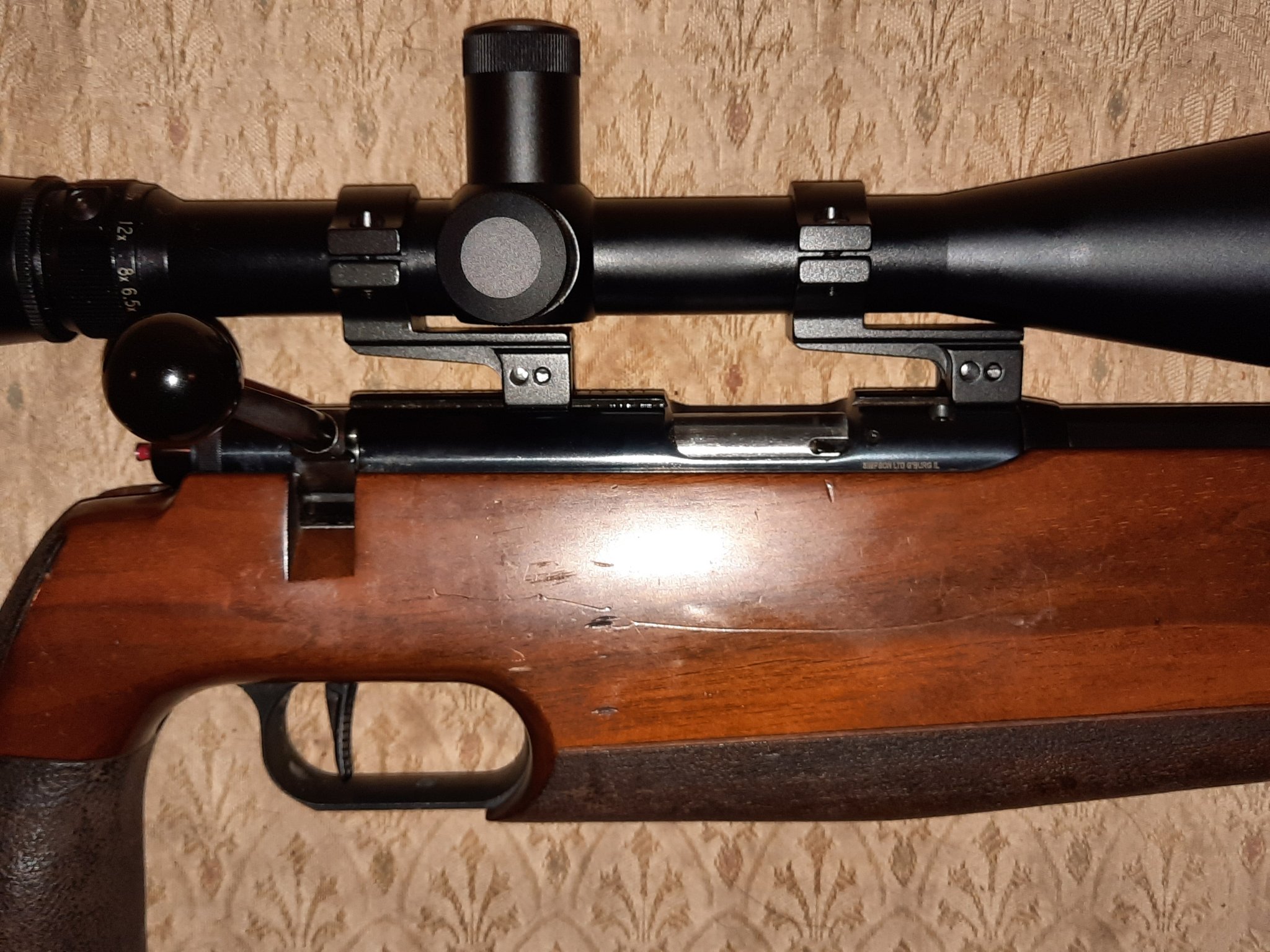

Pics of the issue for future reference:

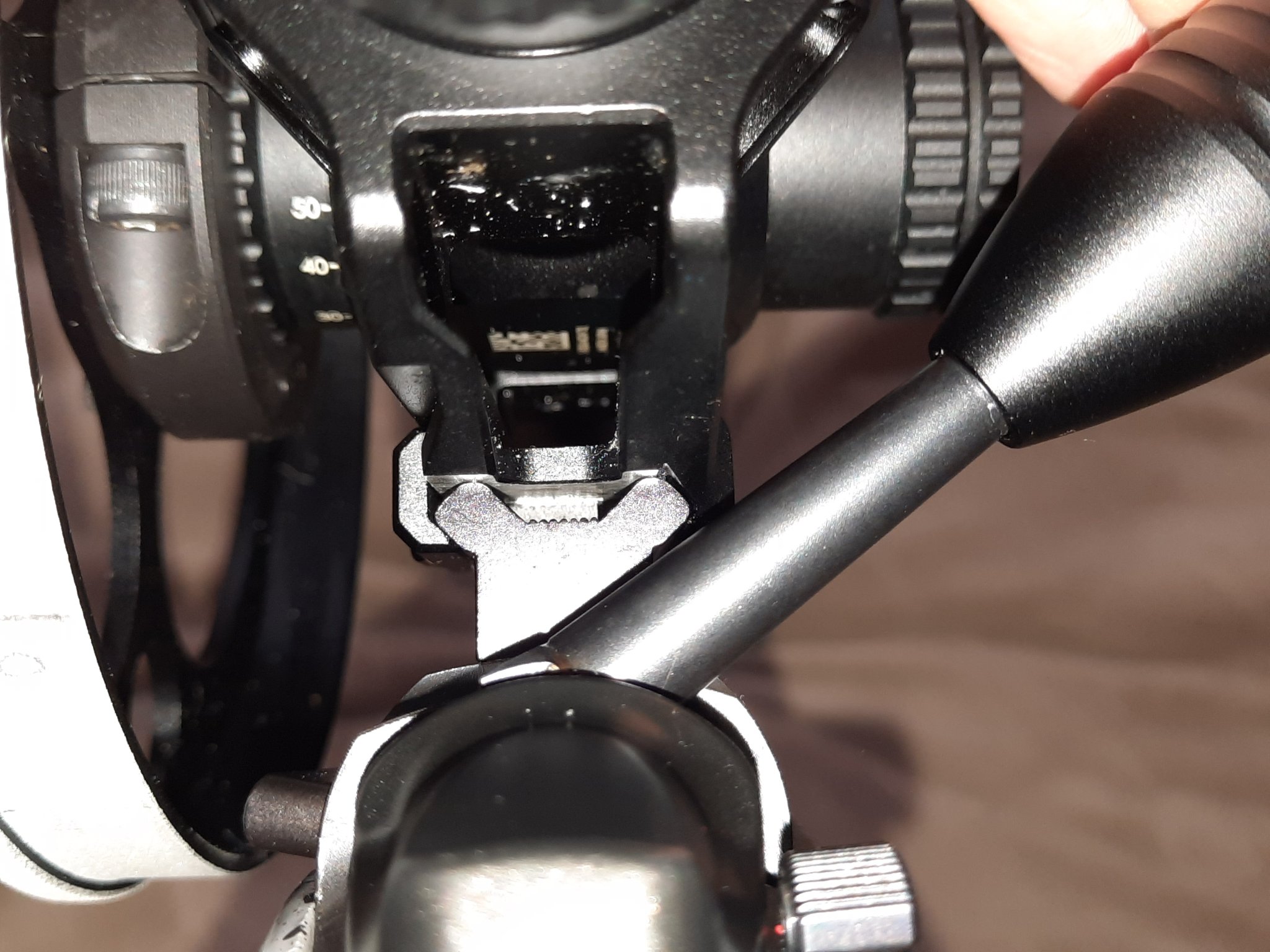

With a Vortex angled ring:

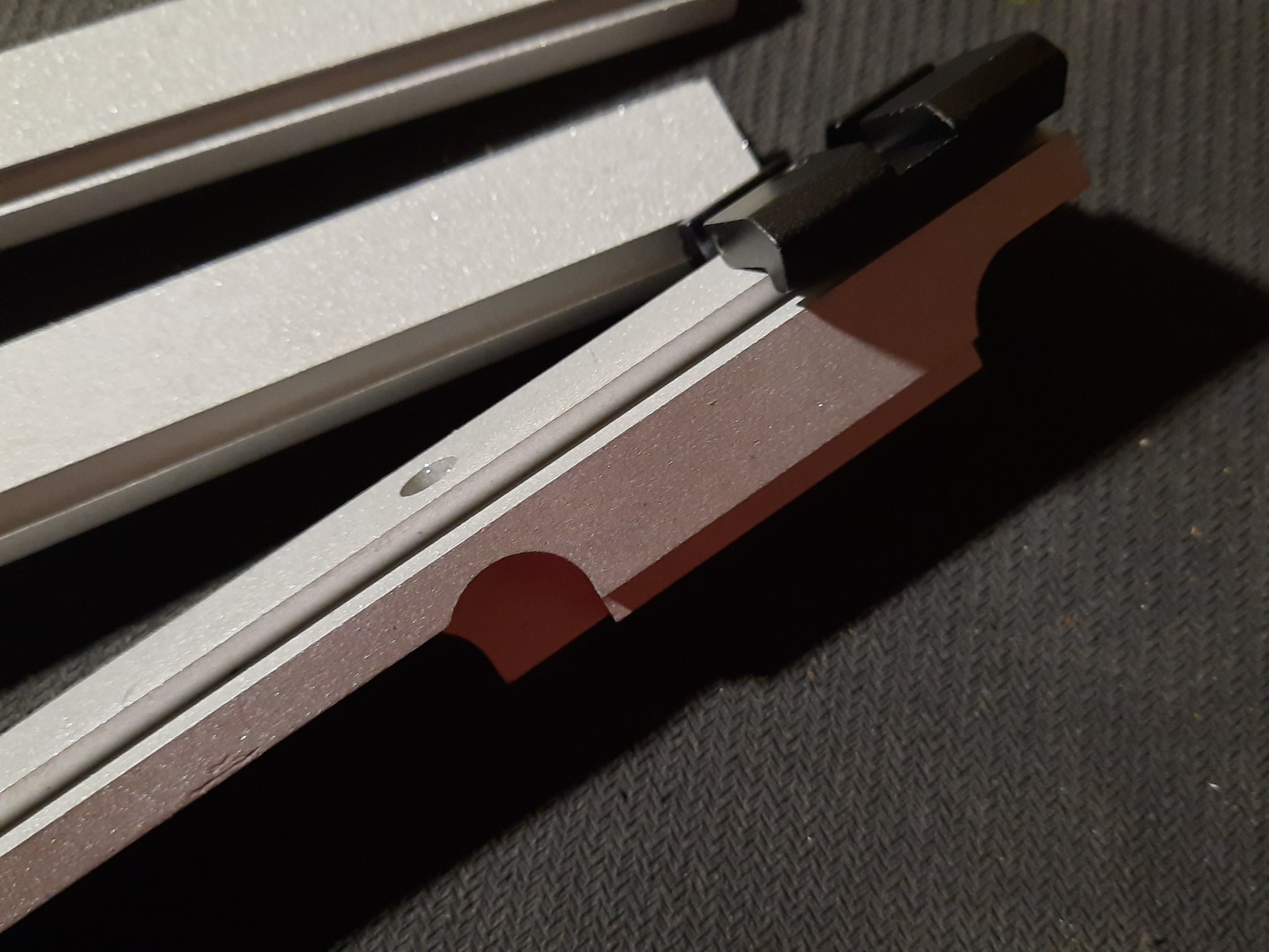

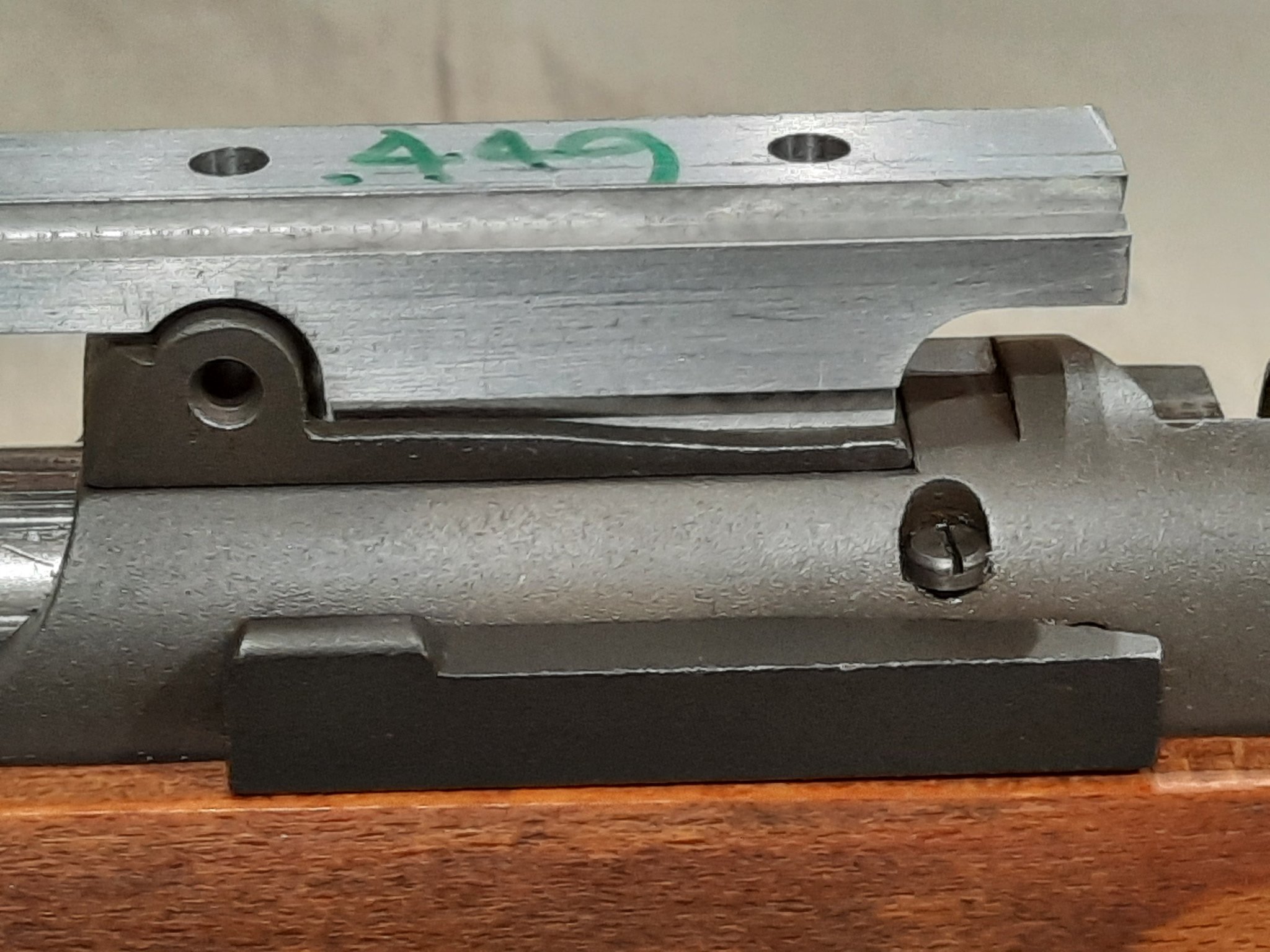

In the case of post number 8, given that the rings are likely aluminum, and the steel fastener probably has some sort of knurling to
prevent rotation, I would probably add a 1/2"x 45* chamfer to clear the bolt. Then hide it with Alumi-hyde or black Sharpie. On the Bergara

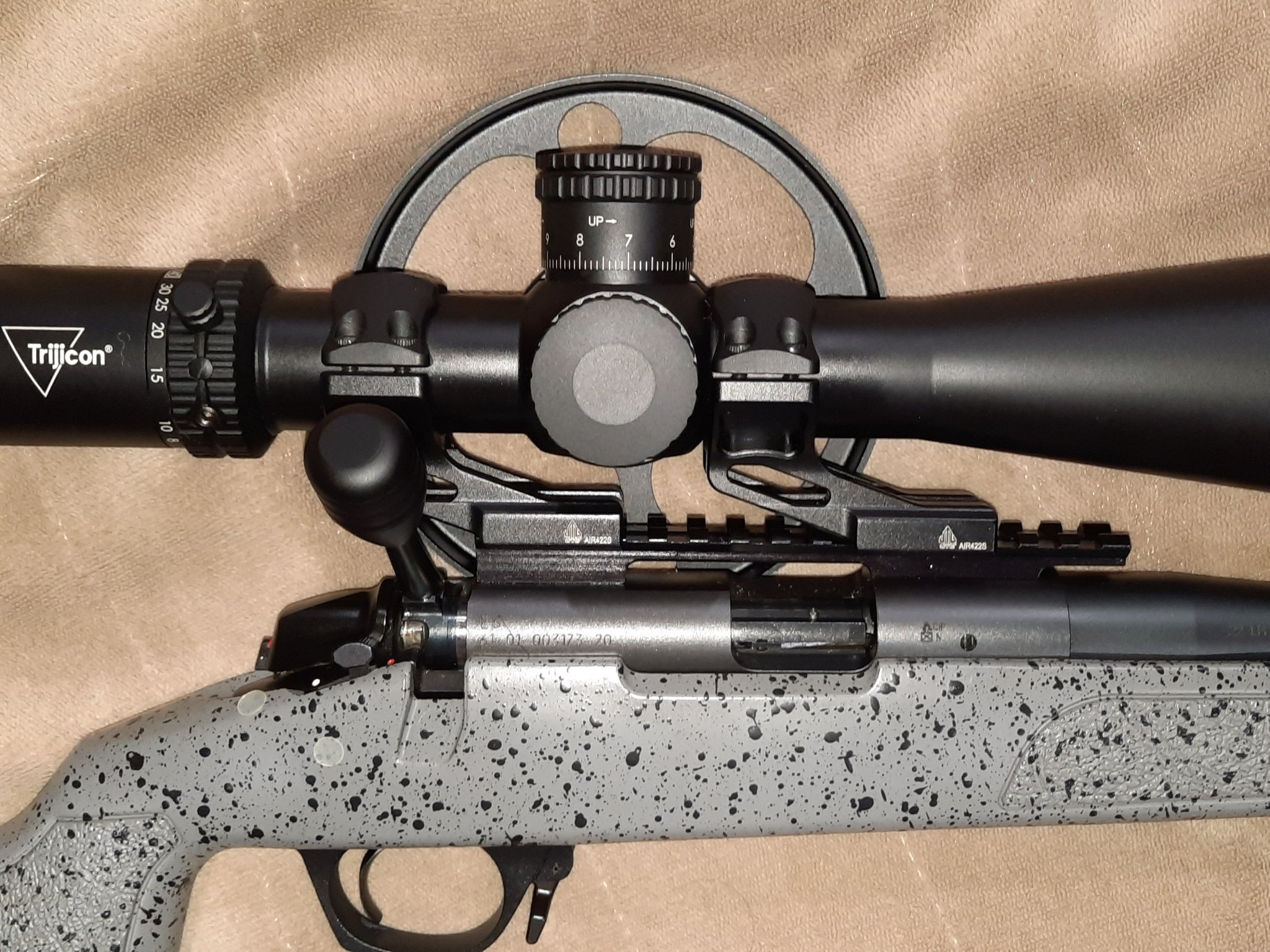

you can see that the base stops where the bolt lifts. The V22 is the same way. The first thing I do is decide where my scope needs to go for me to shoot from the most ergonomical and comfortable position.
Then I find mounts to get me there. In photo #3, you can see the base clamp screw.
It is flush mount. None of my mounts have big, manly, 1/2" hex nut to snag things or cause another interference. A couple of years ago,
my two Anschutz 64s had mounting issues. The existing DIP mount stopped where the bolt handle started. I spoke with Bob at DIP and showed him my mounts and clearance condition. A short time later, he sent me special ANS 64 bases. With my narrow scope mounts with flush screws
that also had a very narrow foot-print, allowed Bob to simply extend his existing product. His next step was to make it a standard DIP product. I believe it's called a Scout.

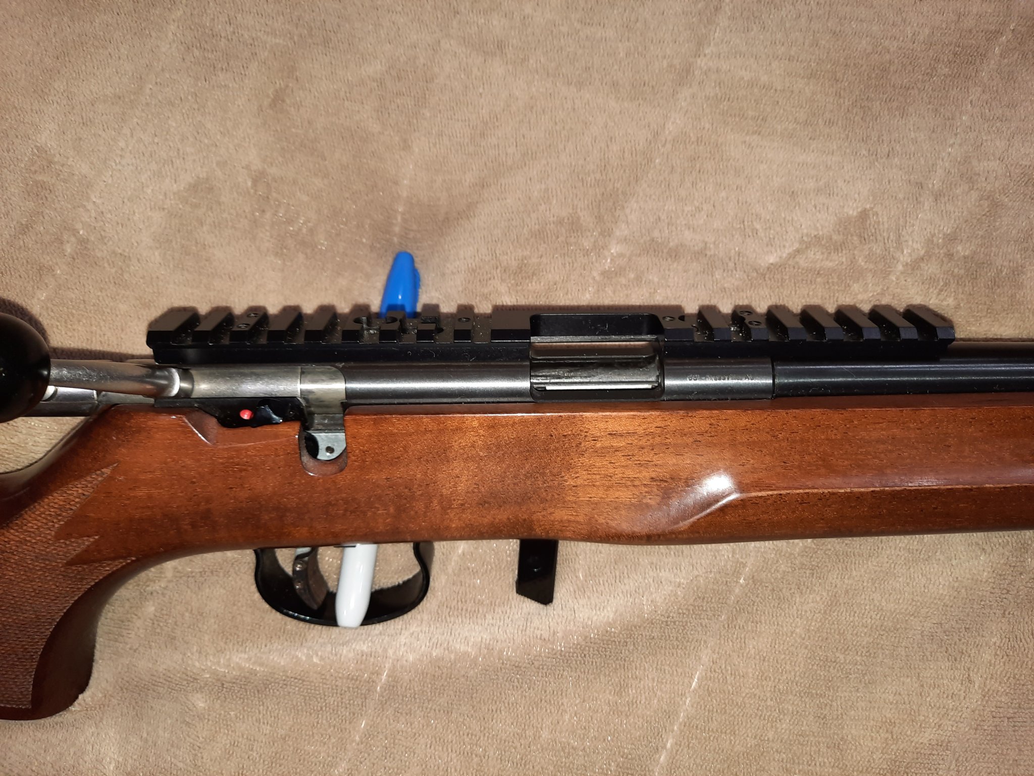

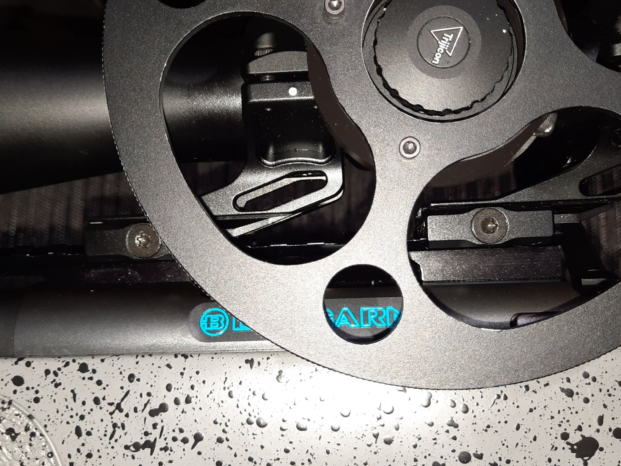

Worst case.... design a mount and have your local shop make it for you. Shown in photo 5 and 7. The Dove tail to PIC rail pinch block is
shown in photo #7 in black.

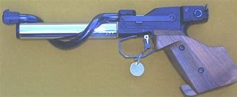

Look at Olympic shooters with sights intentionally positioned 2.5" above the bore. They put spacers under the front and rear sights to
get that high. I'm guessing they know more than me.

LOOK at the last FWB 65 Olympic pistol..... It still puts the pellet in the same hole at 10 meters just like the straight bbl. 65s guns do.
It was made to prove a point.
