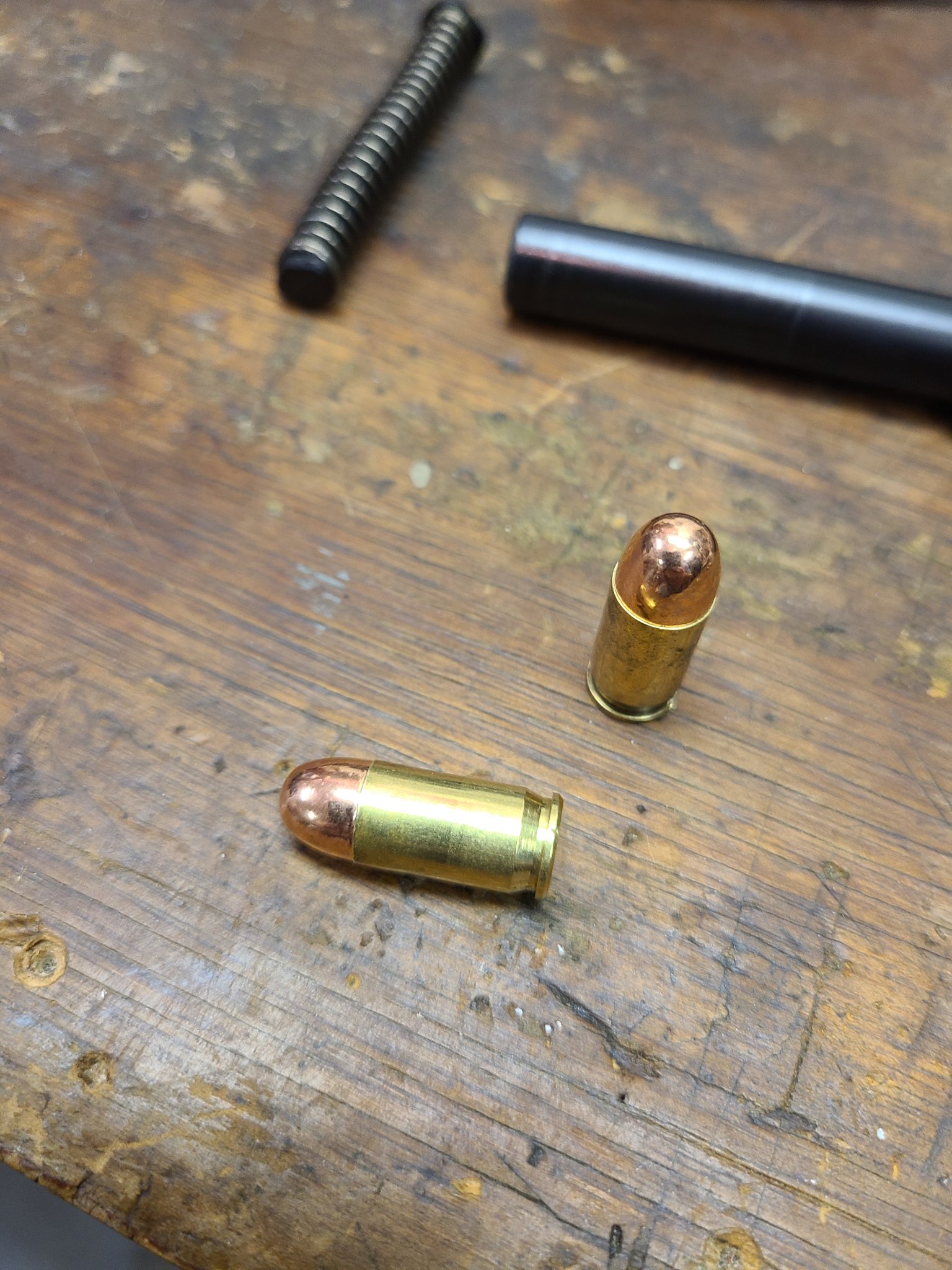

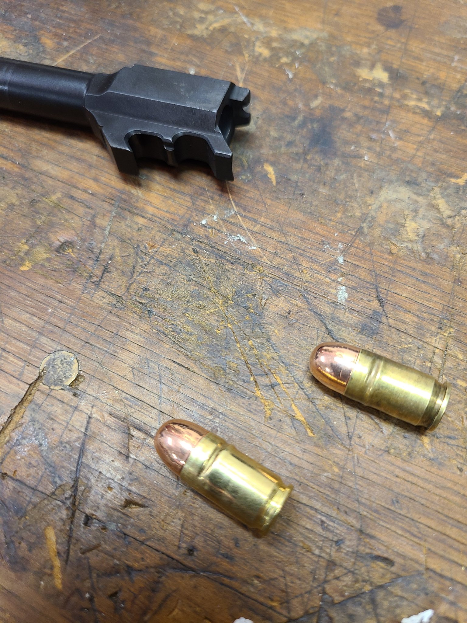

Hey guys I'm trying to get my rcbs taper crimp dies setup properly and have been struggling. I have never loaded pistol on my own before so this is a learning time for myself.
I'm following the instructions on the paperwork with the dies on getting the taper crimp setup properly for the 380 cartridge I'm loading. I thought I had it dialed in then the first two rounds I made came.out like this in the pics.
So my question is this. According to the rcbs instructions, I should have a measurable crimp (from calipers) by like 1 to 2 thousands difference from the case mouth to the bottom of where the bullet sits in the case . I can't seem to get that measurement without crimping to much? Can I just crimp enough and eyeball it to make sure the flar is gone from the case mouth?

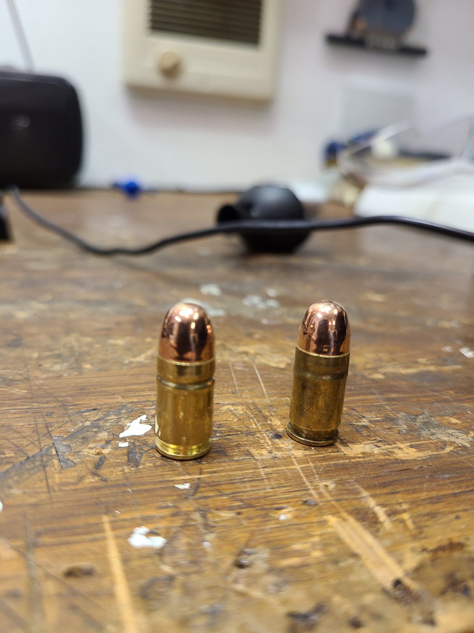

So this is where I'm thinking the crimp should be good? These rounds freely fall in and out of a case gage and they also fall into my pistols barrel freely as well.

Those look correct. Provided they fall within the correct surface on your case gage you did it right (some have 'steps' some are flush).
I like to use Lee factory crimp dies. Seat the bullet then go through and crimp them all. I have done the seat and crimp. Make sure you read and under stand the instruction for the seat and crimp. I always gauge my crimp by how far down past touching the case I go 1/4 turn 1/2 turn full turn. cases also need to be same length. maybe its the pics but I don't see much of a crimp on any of them. You got the right seating plug in there?
Taper crimp should be just enough to remove that flare. The rounds in your first pics show the case buckling. Your seating depth and crimp position in the die aren’t aligned and causing the buckling. What I would do is remove the seating stem and adjust the die so the case is just barely entering the crimp groove in the die. Lock the die collar and then put a 7/8 washer underneath the die to shim it above the crimp groove. Now set your seating depth with the seating stem. You should have an un-crimped round with the desired bullet seat depth. Now back off the seating stem and remove the 7/8 washer. Run the cartridge back into the die to crimp the case mouth, and screw the seating stem back in until it makes contact with the bullet. Now your die is adjusted for both.
Personally I don’t use taper or roll crimps on semi auto cartridges, a lee fcd seems to work better for that application. I only roll crimp .357/38 and .44spcl/mag bullets with cannelures or crimp grooves.
The rounds in your first two pics look *way* over crimped. That can cause overpressure/safety issues. I’ve found that less is more when it comes to taper crimping pistol rounds, especially if it’s just for plinking/target ammo.
I was afraid of that ,to be totally honest I'm not exactly sure what I'm looking for I've never loaded pistol and my rifle stuff I've never crimped.

Yeah, your first picture had waaaaaay too much crimp. It should be just a kiss, like .002 or .003". Plus with your plated bullets, a case with too much crimp into the plating can cause separation of the plating from the lead slug.

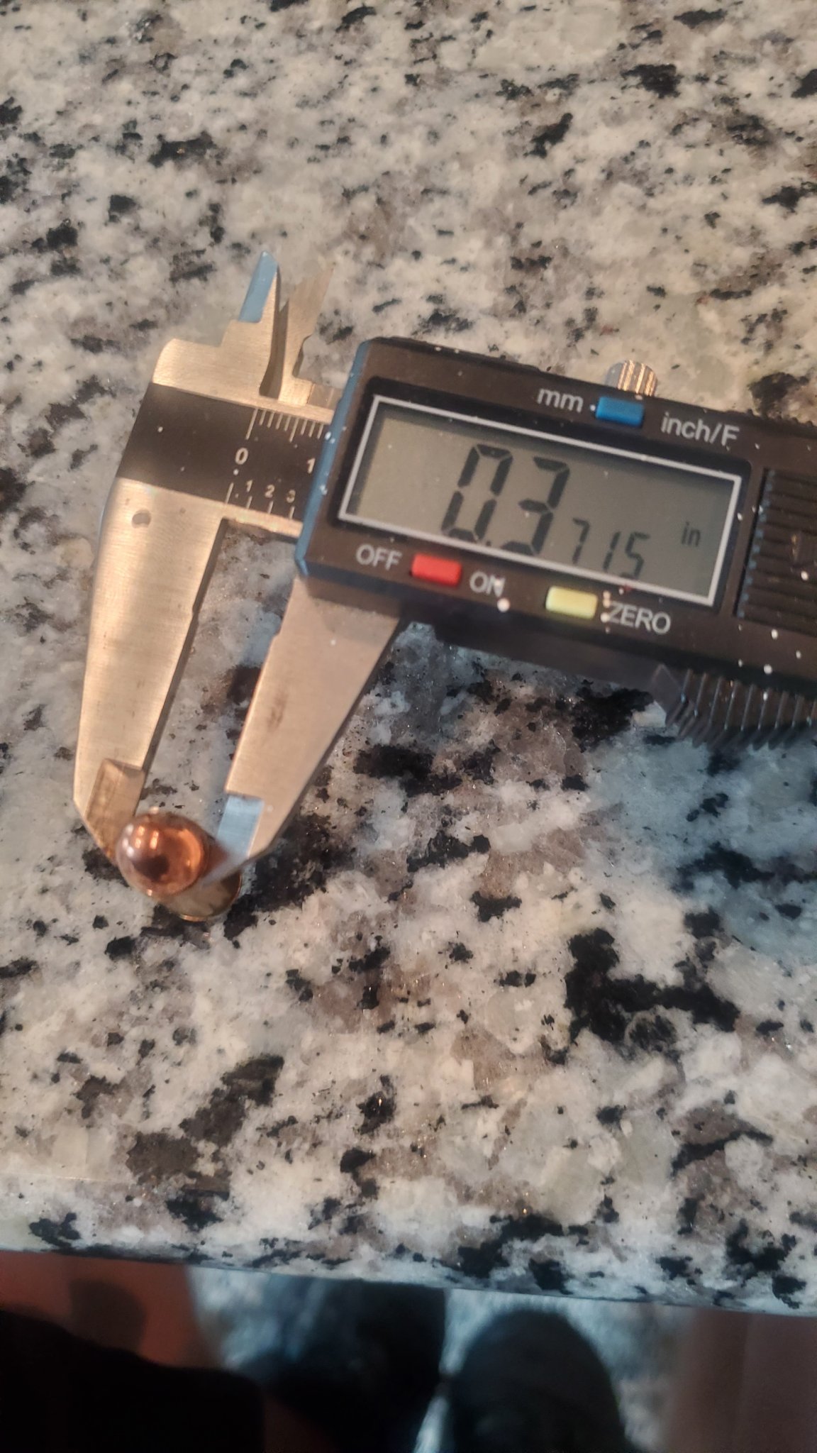

Calipers are your friend. Lee Factory Crimp Die is the answer.. roll crimping is for revolvers, or other cartridges where the headspace isn't from the case mouth.

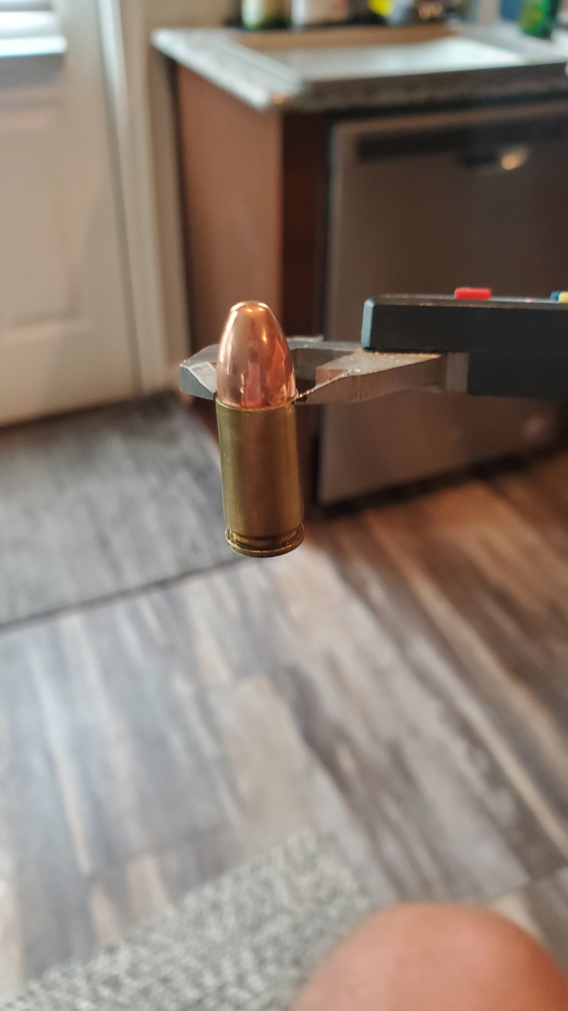

Measure the case mouth before crimping, them measure after crimping. According to the SAAMI blueprint, a .380 cartridge has a case mouth diameter of 0.374". If you crimp 2-3 thou, well your case mouth will be 0.371-0.372"
This is 9mm, but it has the same case mouth diameter as 380.
