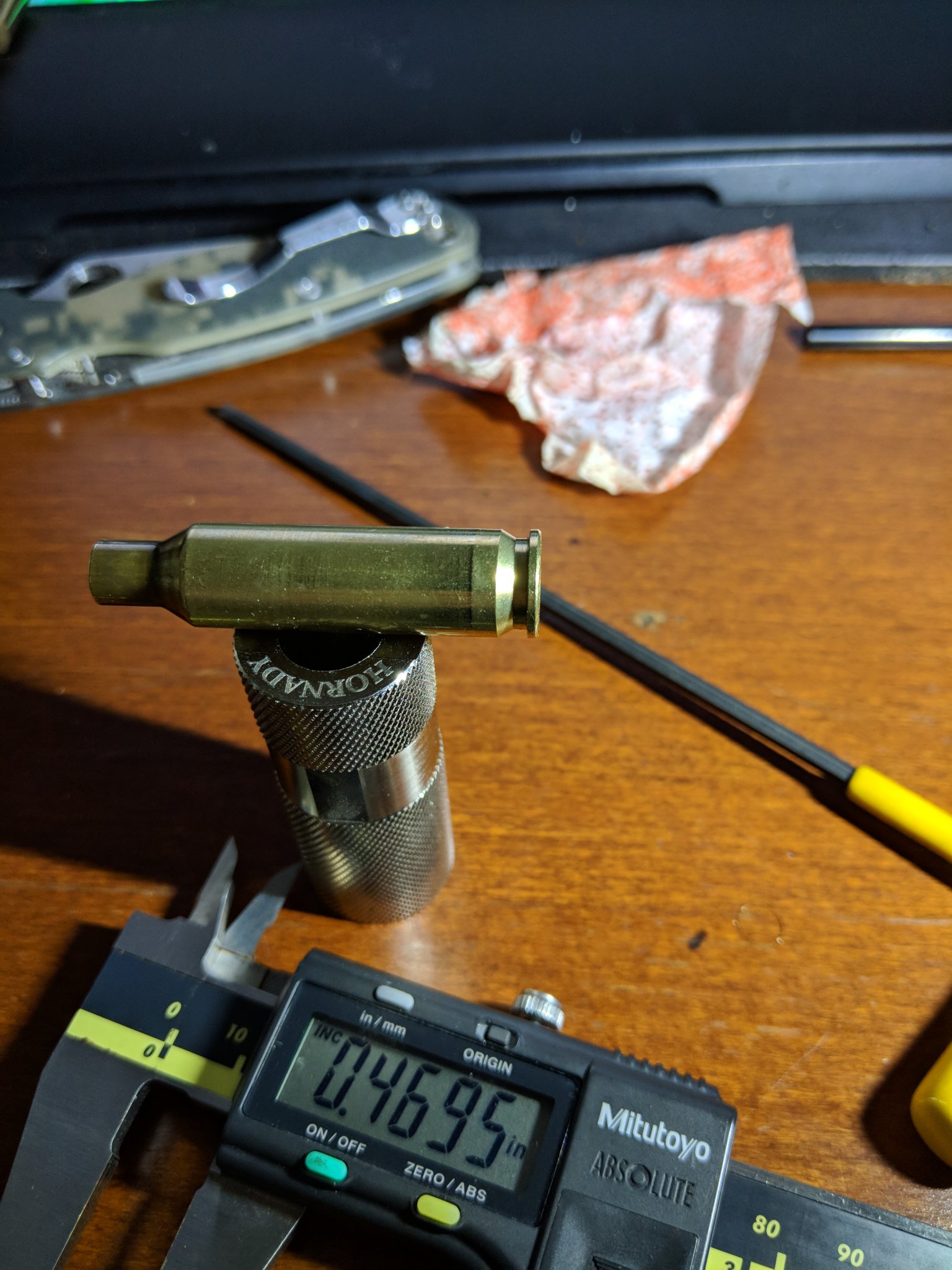

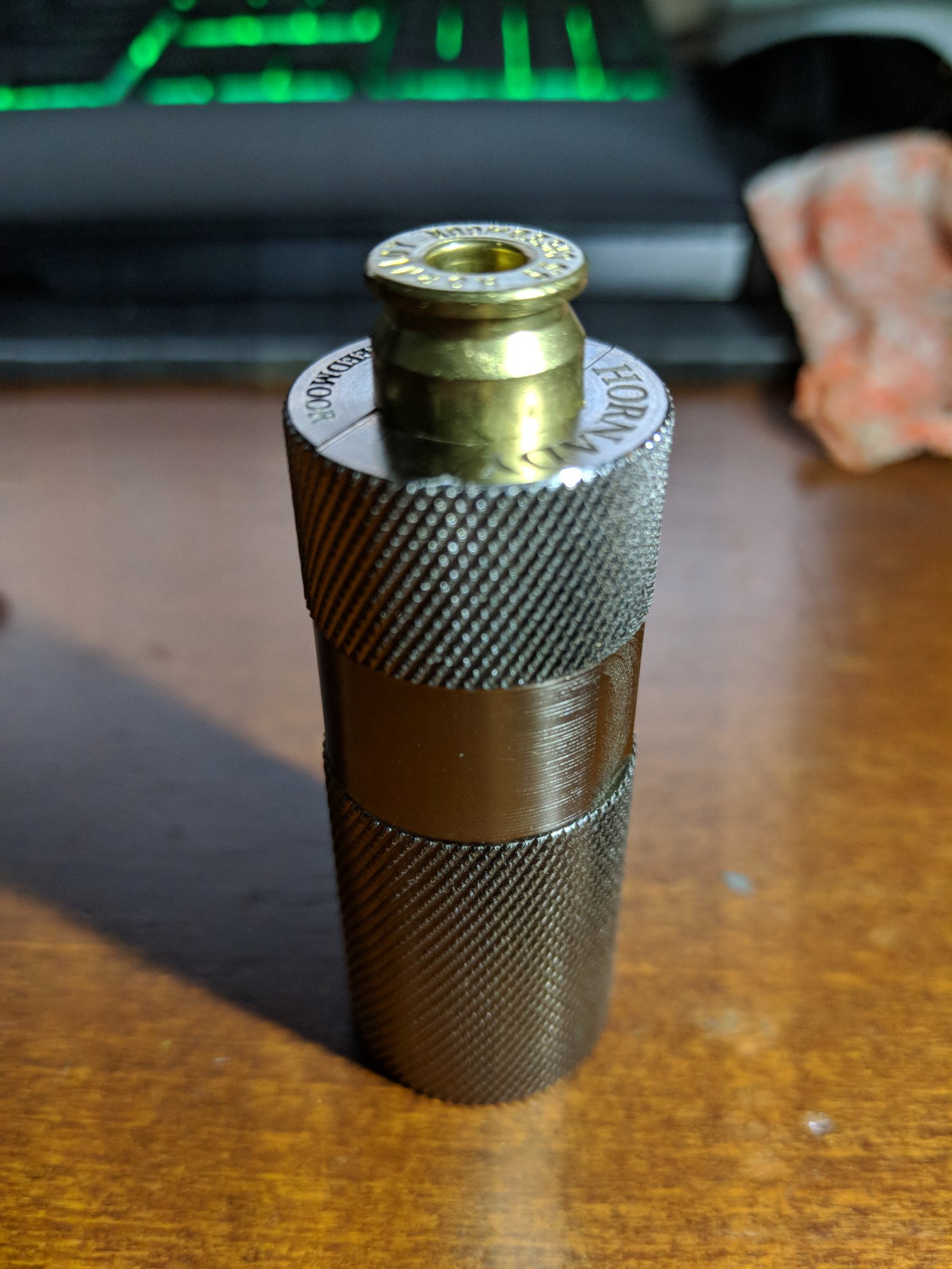

Some of my brass, after being put through sizing dies will get hung up in the case gauge. I will wind up with between 1mm and 5mm poking up! While I am running the brass in and out (with any of the dies I have used over the past several weeks) I notice that I have considerable resistance going in, and coming out. (Of course this is with a squeaky clean gauge, and I've wiped lube off of the brass.)
I did some experimenting, found that when I remove the expander I have a much greater success rate.
I tried moving the expander back a ways with my new Redding die, this made no difference.
Then I tried moving the expander "rod" back in my Lee Precision die - - This did the trick! I had a MUCH better success rate. Brass requires an average amount of force on the way in, then there's maybe a tiny bit on the way out. Out of about six hundred pieces that I processed yesterday, I ended up with ~15 that I could not get to drop into and out of my gauge checker.
Photo is of one of the more extreme cases of "bulge." Most of the throw-backs that I ran into yesterday had about 1-2mm of case head sticking up. I think the reading on my micrometer is maybe the widest point... but I might be wrong... (that is actually in spec??)

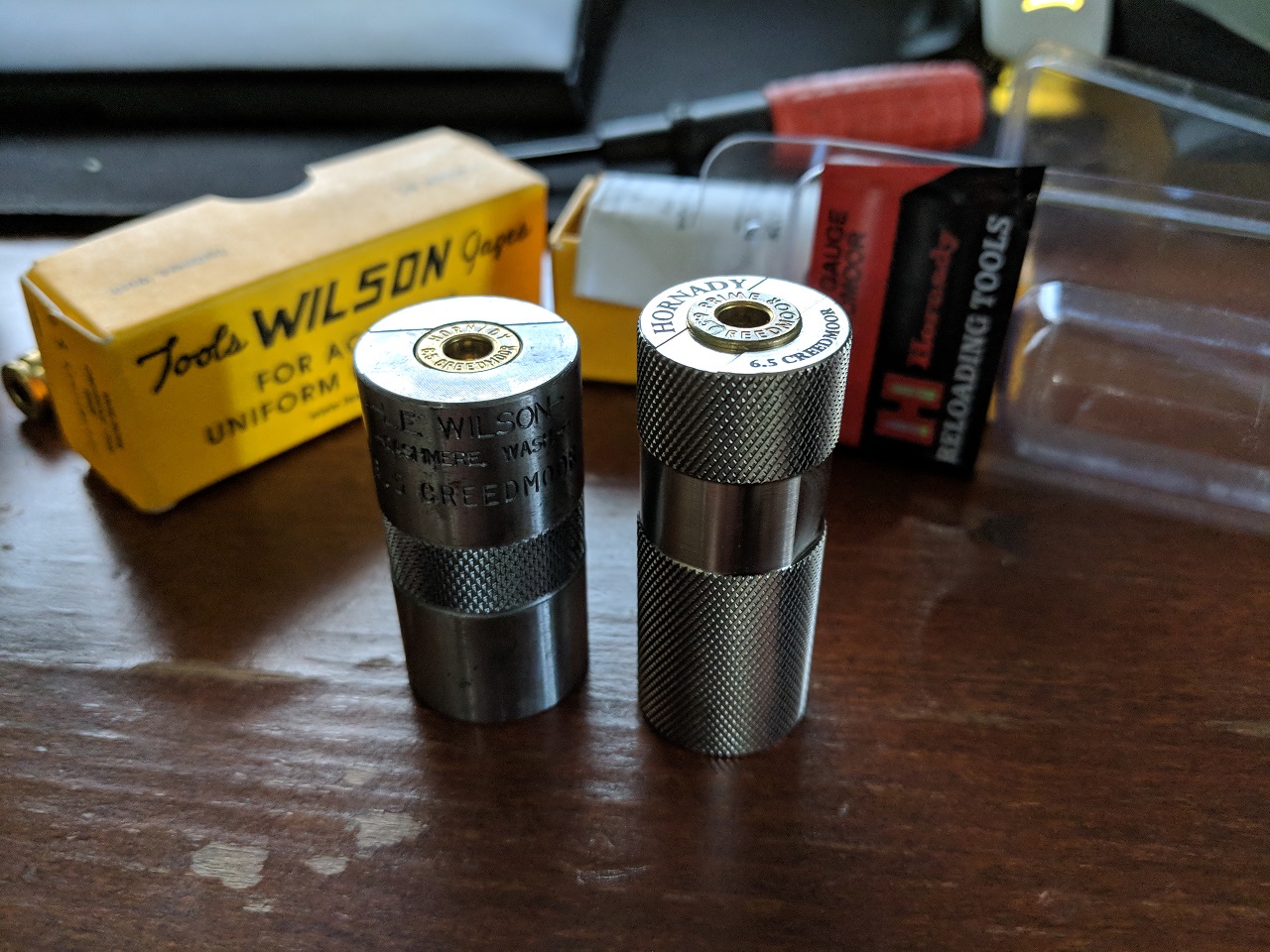

Necrobumping here... Check this out.
Hornady gauge is utter trash. Checked my entire bag of "f'ed brass" in this Wilson gauge and it's all perfectly fine.
I am so pissed! I wasted a lot of money, stressed myself out trying to get my brass to work in this POS!!
(I used two pieces of brass just for the sake of this photo... The one sitting nicely in the Wilson hangs up in the Hornady, and vice versa.)
Necrobumping here... Check this out.View attachment 6937232
I hate to say this, but you wasted good money on either gauge, they are designed for saami spec, with the Hornady being under spec some. Truthfully, if your chamber was reamed with a reamer that has done a shit ton of chambers, maybe even sharpened, your chamber may still be tighter, rendering these things useless. A caliper or a mic is your friend, like spife said, measure new, fired and sized, it all tells a story. I've loaded for almost 35yrs sometimes forego measuring, a couple of really had our asses handed to us on a 6 creed earlier this yr when it was right there for the picking.
Throw in a slightly out of spec die, can be a tough call too, and it seems to happen more and more these days.
But you still don’t know the dimension of what aspect is out of spec or the difference between the two other than this arbitrary comparison. The gauges are next to useless. They can still weigh down paper as culpuppy said :giggle:

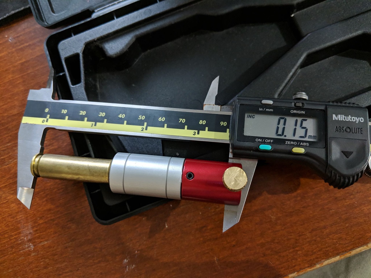

finally got a headspace comparator kit... I zeroed on a good, resized case that sits correctly in the case gauge... Bad cases that poke up are all over by about this much.
