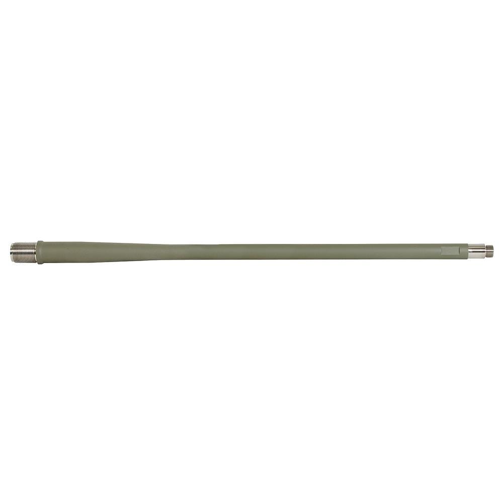

Honestly, this is not complex. If it is a AI factory barrel, it is either M18x1.5 (regardless of caliber) or it is 5/8x24, unless you have a ASR which is 3/4x24 which is not the case.
Simplest solution, post a pic and this will be closed in 0.5secs. Or google it.
Best way to tell if it is M18x1.5 is if there is a step down from the barrel diameter right before the threads. This is where the clamping portion of the brake connects. Looks like this:
And, yes, a AI brake can be installed at home with a 4mm Allen as long as your barrel is M18x1.5
