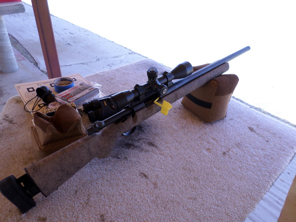

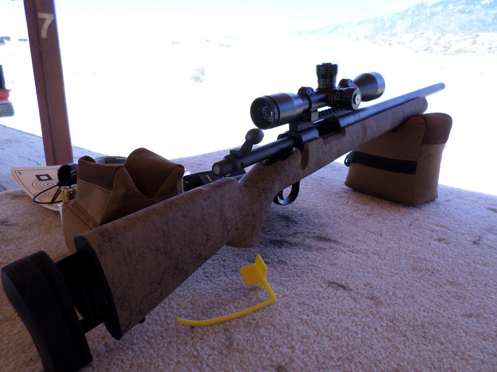

Here is my rifle as it stands. Still would love input to help me get to shooting 260 out to 1000.
thanks
Austin

Mistake #1: Using your student loan to finance a rifle upgrade. Bad idea, trust me. Save up for it, or purchase the components over time and have a gunsmith do it when you finally have all the components, but if you don't mind having more debt hanging over your head:
1) Barrel: There's barrels in the For Sale section that you can have immediately. Google will get you a lot of retailers who have barrels in stock. Expect to pay between $300 - $400 based on brand and features.
2) Truing action: Might as well. Why put a fancy new barrel on an action that's likely got loose tolerances from the mass production process? While you're at it, have the gunsmith check the fit of your bolt as well. Might wanna get a custom fitted bolt while you're at it.
3) Downtime: The barrel won't be your major source of downtime, it'll be the gunsmith. Once he has your gun, it'll go in the queue, and expect a few months of wait time, minimum. Make sure you use a reputable guy. Check reviews, make sure he won't close up shop and disappear, or hold on to your gun for 3 years, or overcharge the crap out of you.
You can call some of the big name custom shops for a quote, many are Hide vendors and reputable, but that also means they get a lot of business, i.e. longer wait times.
Ask your locals where they get their stuff done.
P.S. Did I mention don't use student loans to finance this?
Seriously....don't buy "stuff" with student loans. You will be paying for it long after the barrel burns out if you shoot seriously. Stick with what you have.
I bought a gun I'm still paying for when I was in college...I'm 32 now.

I've shot a 16.5" R700 308 to 900yd using 168gr TAP; your AAC-SD will get there with FGMM. It'll get there substantially better if you start reloading and use premium bullets, such as the 168 Berger Hybrid or even 168 Berger Classic Hunter.
If you must have a 6.5, sell your Remington to finance a Savage 12 LRP in 6.5 Creedmoor for about $900...as the Creedmoor has high quality Hornady 140gr A-Max factory match ammo available for ~$26/box.
Good luck...
Oh, I forgot one more thing:
Another option you MIGHT have is installing an AAC 260 "prefit" barrel...which was recently discontinued. Member Niles Coyote has done some recent reviews on one (among others), and needless to say, its pretty damn good accuracy for a sub-$200 barrel. It'd be a quick/easy R&R job for a good smith, though any half-competent person with a barrel vise and action wrench could do it themselves.
As I mentioned they have been discontinued, but if you troll enough forums and post enough WTBs you might get lucky and and find one.

This is the route I went and haven't regretted it yet. It cost me less (much less) to have the barrel fitted to my action than it would have to hang and chamber a blank from Bartlein/Kreiger/Rock Creek. Granted, it's not on par with those barrels, but I have no plans on replacing it until it's burned out.
Dude, you could sell your rifle, and buy a Remy action for Brownell's (they're on sale for $389 right now). You'll get more money out of it that way. You'd have a hard time selling a take-off barrel. The other problem is that you do not reload. There aren't a lot of factory loaded match ammo options in .260, while there are plenty in 308. I think .260 is cool, but in your situation you may be better off sticking with 308. Just my $0.02
