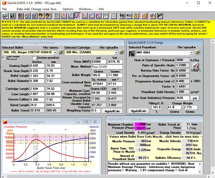

Can someone print me out a quickload for 308 win, 185 Berger Juggernaut, IMR4064, Case capacity 54.6 gr, COAL 2.934 Thanks.
Here (note the barrel length) :
What case has such low capacity?
A new unfired or FL sized Lapua .308 case. Interestingly to me, I had just recently measured the volume of some of my new Lapua .308 once fired cases trimmed to 2.005" that I had just resized and I got exactly the same volume as he posted of 54.6 gr of H20. Now, I don't know which case manufacture he's using, but I thought it was an interesting coincidence.

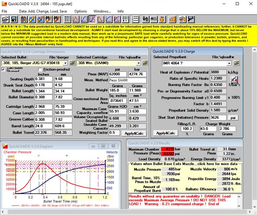

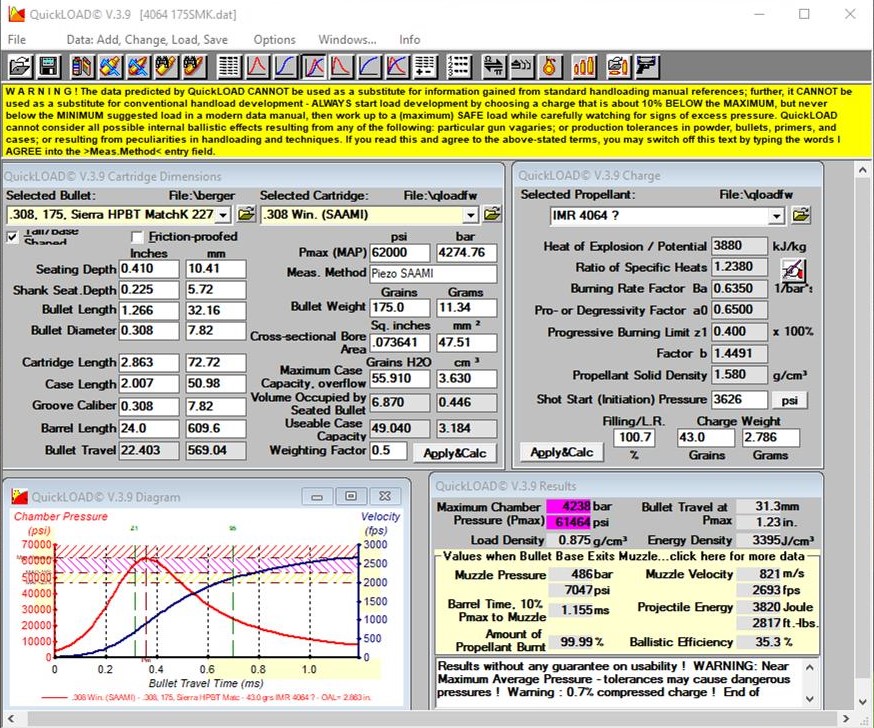

You're data is pretty much matching mine for the 175 SMK's out of a 24" barrel. For the 175 SMK's, my sweet spot is at 42.5 gr of 4064 where I get an MV average of 2676 fps. And when I look and my QuickLoad app information, it's essentially spot on for the load you're using. Only you're definitely at the high pressure point and over SAAMI's 62,000 psi maximum when loading 43.5 gr. I've loaded as high as 43.7 and got pressure signs like you as well.
Recently, I bought a bunch of Berger 185 jugs and am just getting ready to do some load development with the 4065. So, you're data here has given me some confidence that QuickLoad will be accurate enough to cut down on my development time. So, thanks for posting that. (y)
Here's some of that QuickLoad info you might find of interest:

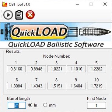

Once some adjustments are made in QL to fit my real world data, QL is very useful in finding where to start with replacement powder to use for a powder that may not be presently attainable. Same kind of thing if one wants to use a bullet of the same weight, but of a different design, or . . . and/or even a bullet of a different weight. There's an Optimal Barrel Time (OBT) calculation to match with a OBT app that helps find a powder load that's at or close to an accuracy node (see pic below). And again, it's not necessarily precise, but I find it gets me in the ball park to save some time, effort and money, in load development. Though I still have to do load development, QL helps me do it in shorter time, fewer trips to the range and with less expense. That savings I've gotten in development expense more than pays for the cost of QL.
