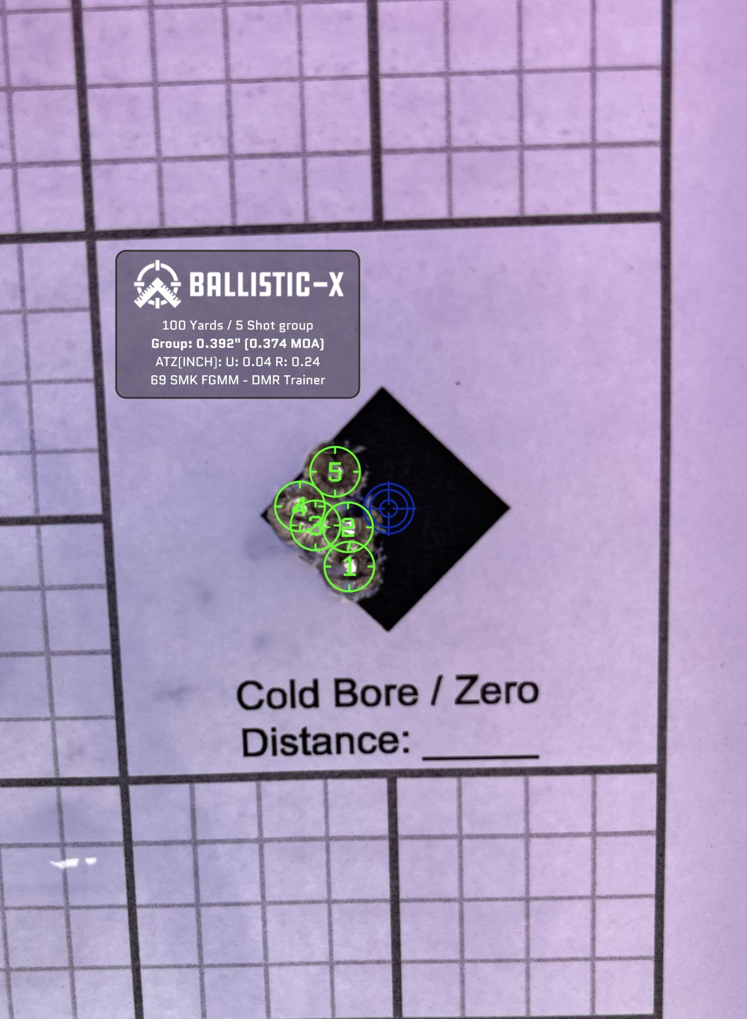

You are not going to be disappointed in a 1:7 twist, I shoot a Criterion 223 1:7 twist with their match chamber (long throat) it
shoots 60TMK, 69TMK, 77TMK, 69SMK, 70VLD, 75VLD and 80VLD into small little groups.
The only bullet I have tried in that barrel that it cant properly digest is the 75ELDM.
When this one dies I am going to get the exact same barrel.
