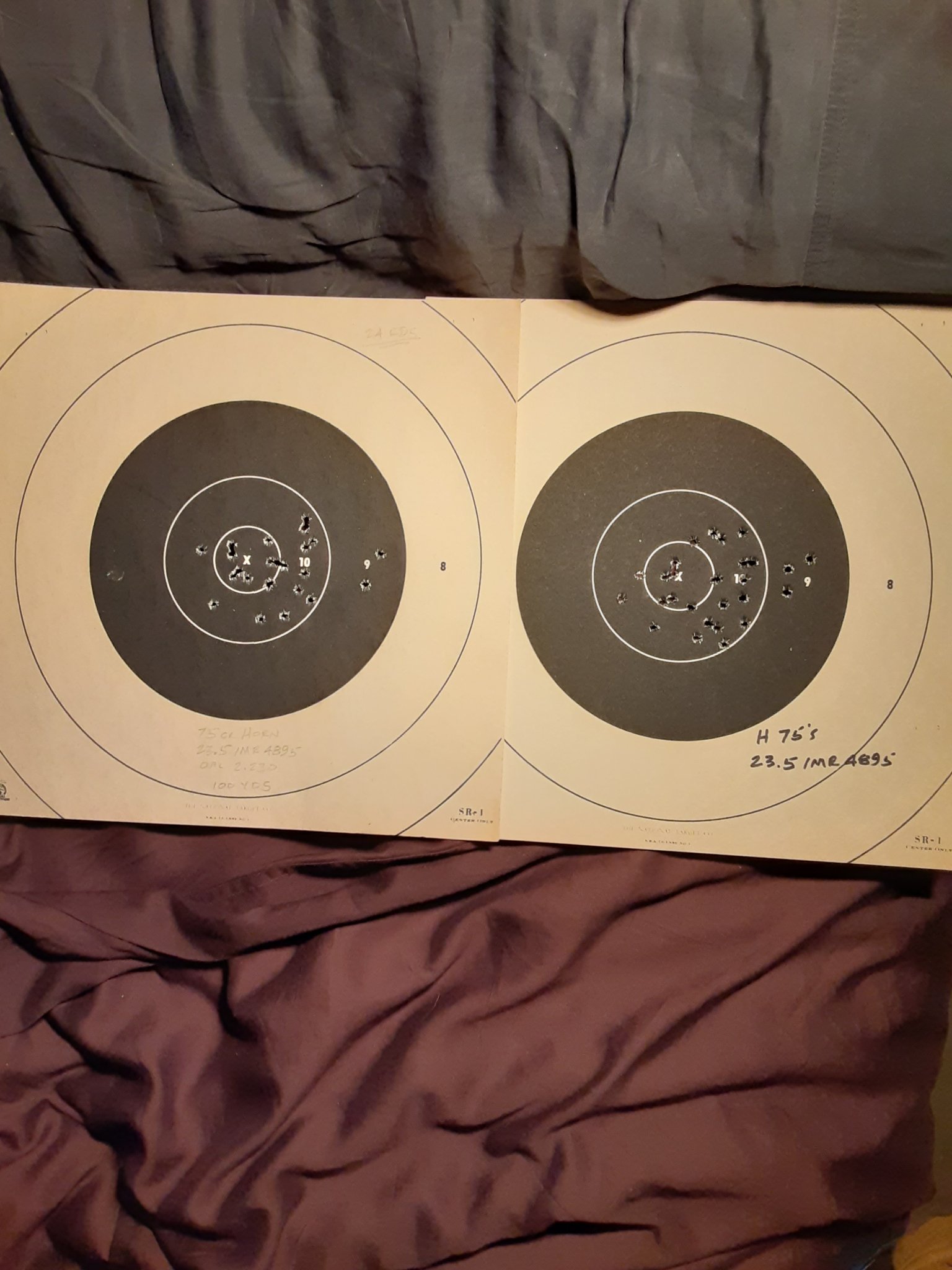

Target on left is pre-free floating.
Target on right is post-free float.

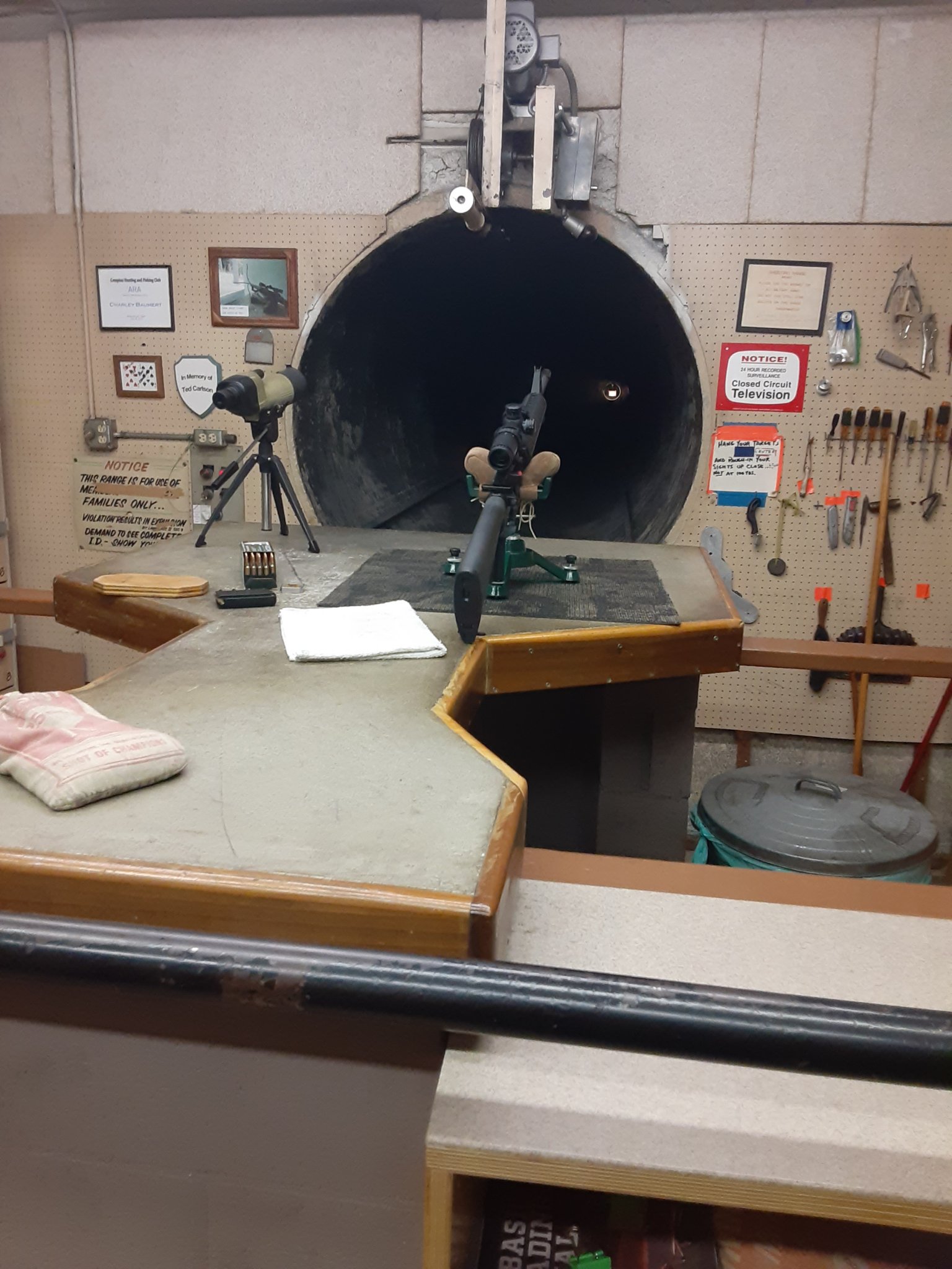

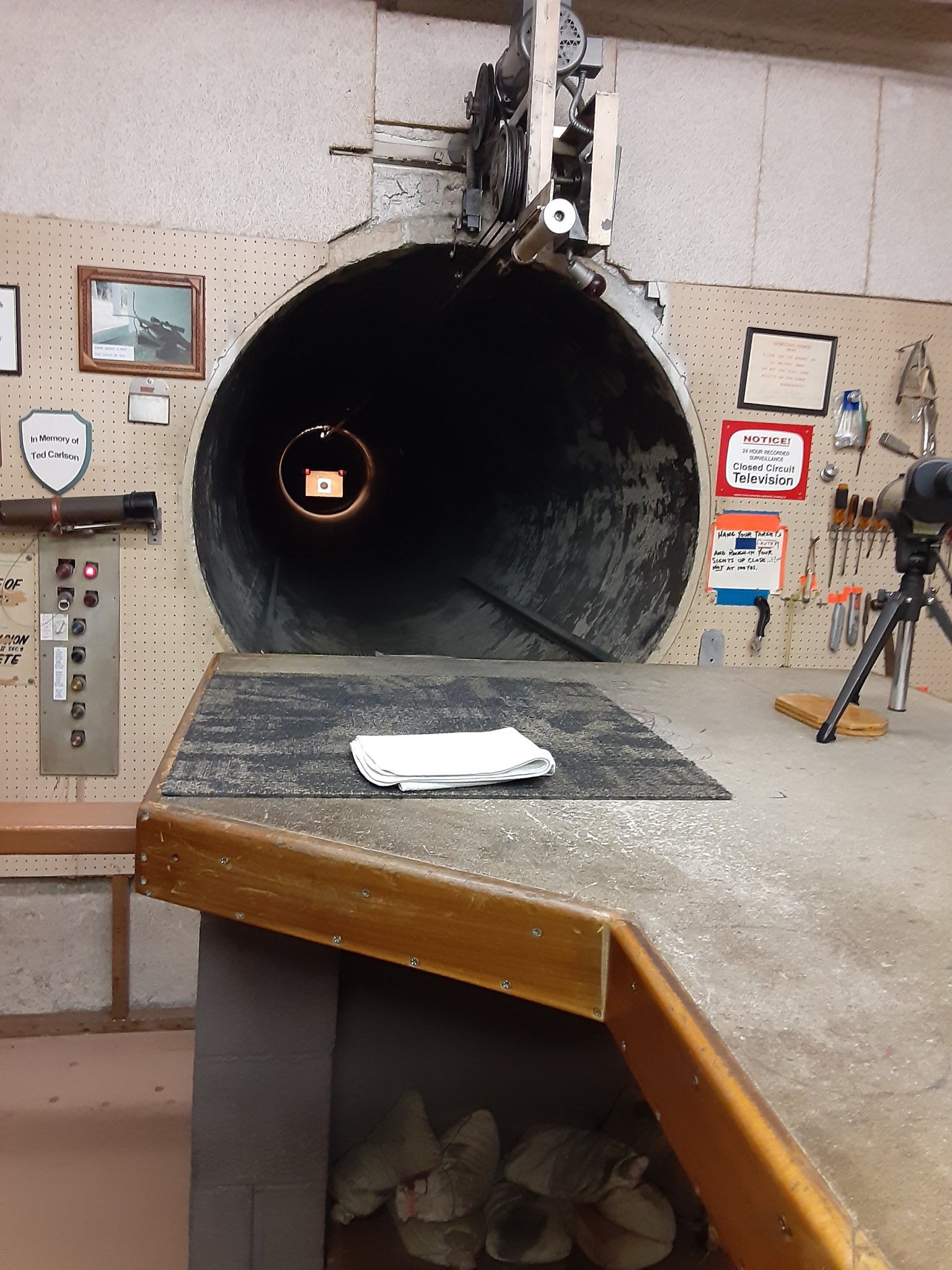

Pic of "tube" where I do my zero wind testing at 100 yds.

I've been doing load work ups for a while. The target on the left is typical of what I was getting at 100 yds. I put a CLE service rifle free floated handguard on it a few weeks ago, hoping to reduce the group size. The target on the right is the post free floating. They're almost identical, much to my chagrin. At least it isn't any worse, and I can sling up tight at the comps now.
Any way, I'm wondering if I just haven't found the "magic combo" of components yet, or if I just got a crappy barrel and am just going to have to live with it. These are SR1 targets and the 10 ring is 3" for all intents and purposes. I was under the impression that even a mediocre rifle should be able to do 1.5-2" groups out of the box.
I can't figure out what I am or am not doing/seeing here. Any help would be appreciated. What's your favorite load? Right now I'm trying to get the Hornady 75 gr BTHP match bullets to work. At this point, I'd be ecstatic with a 1.5" group.

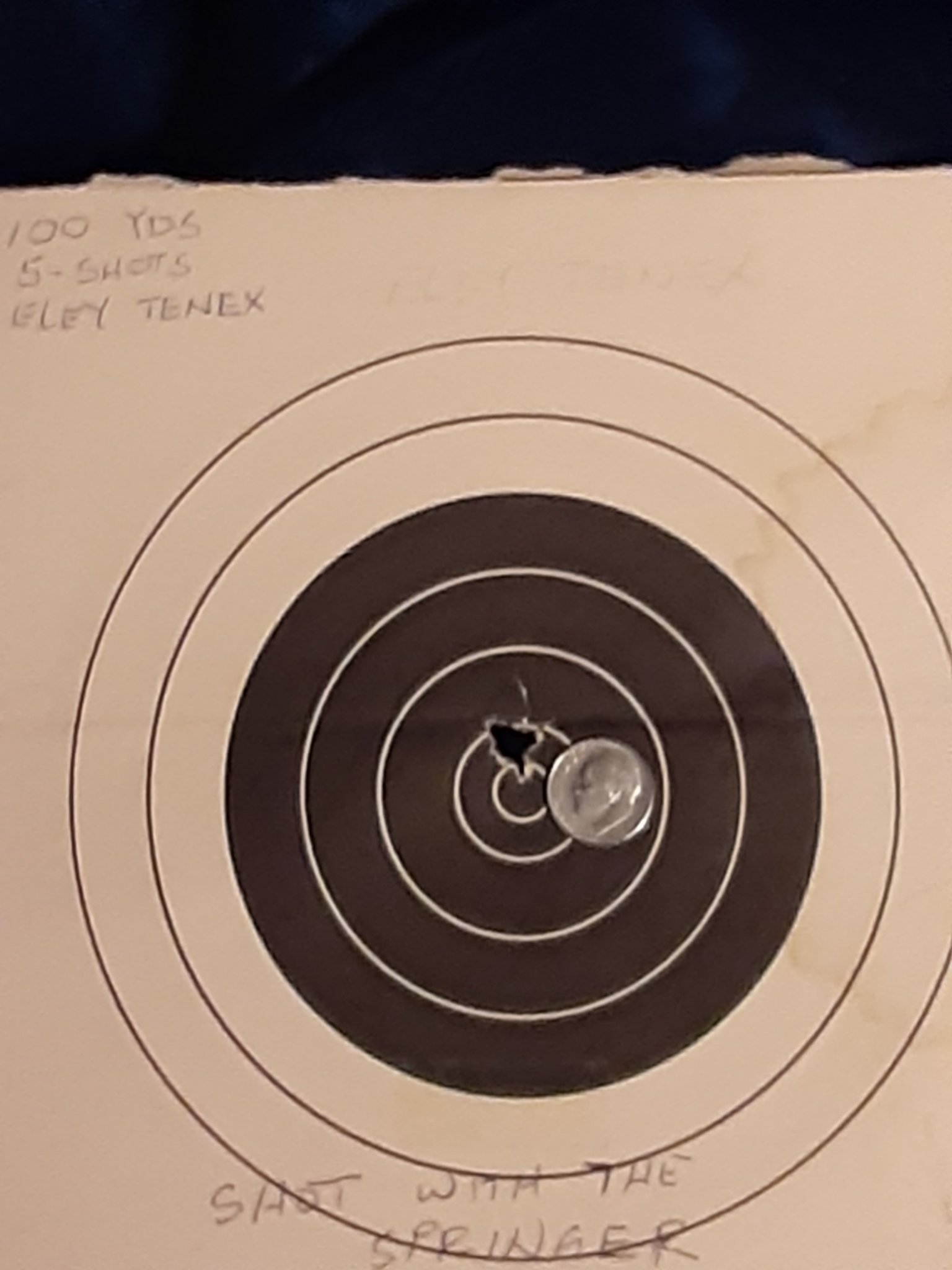

Just so you know it's not the trigger squeezer, this is a 100 yd target I shot with my US Springfield M1922M1.
Jon

It might just hate that ammo. Try a different <anything> and see if it finds something it likes. I've never had a .223 I couldn't make shoot the 75gr BTHP's from Hornady into tiny groups. Hopefully you have similar luck. Chrome lining probably isn't helping you but you should be able to do better than what you're getting.
Mr Turner
Your results are similar to my experience. Floating the barrel doesn’t help accuracy from the bench. It does reduce sling induced troubles.

If the barrel was not free floated and now is then the harmonics will likely be different and the rifle would need a new load workup. Looking at your targets I believe if you calculated the mean radius and the x/y dispersion the righthand target would show greater vertical dispersion.

How many loads have you worked up for it so far ? What powders ? Your groups did not change much by floating the barrel so that variable is out . I have AR 15s that took trying at least 5 different bullets before I could get them to shoot 1"-1.5" groups . I would try some Sierra Match Kings . If you can't get them to shoot I would then be looking at the rifle .
