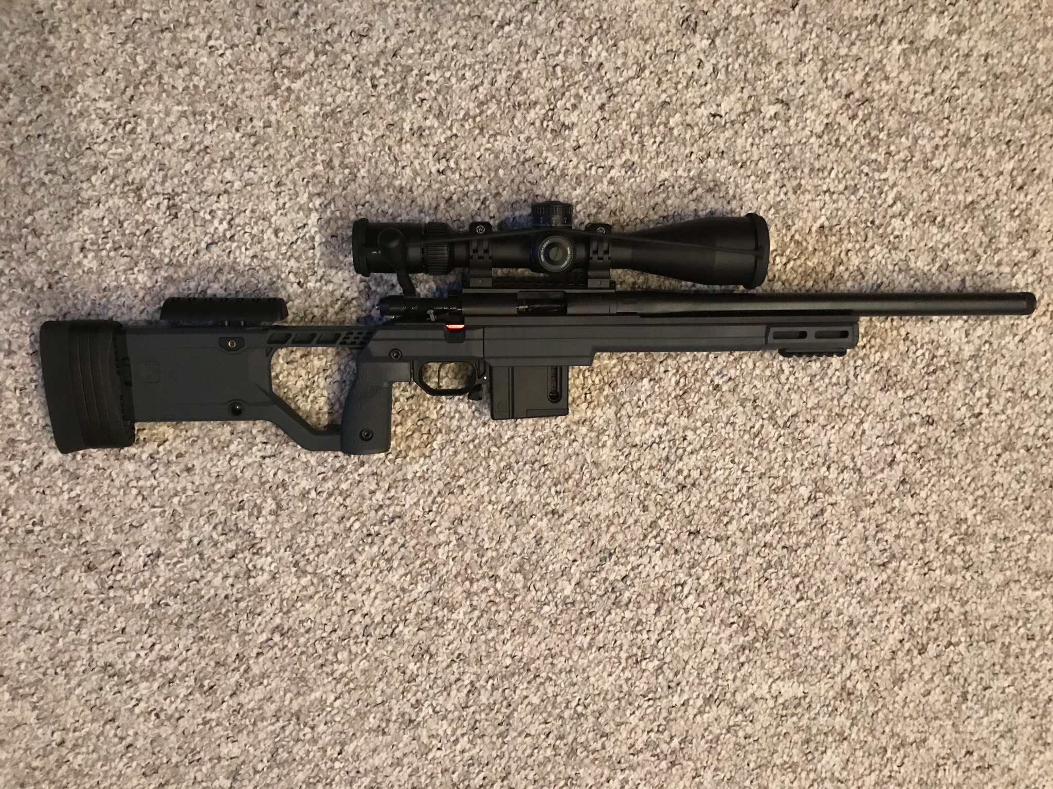

    So I was checking out the KRG Bravo when I came across the X-ray. For only a bit more money it also seems like a good option. Does anyone have any experience with it?
    I put a V22/18" Kukri in an X-Ray. I really like it, but I did have some contact of the Trigger Tech Diamond safety lever with the chassis initially, so had to mill a little more clearance for it to function "right". It wasn't a big deal, but it DID require a little bit of fitting. I believe the X-Ray is around $100 more than a Bravo.
    Reactions: fjr05

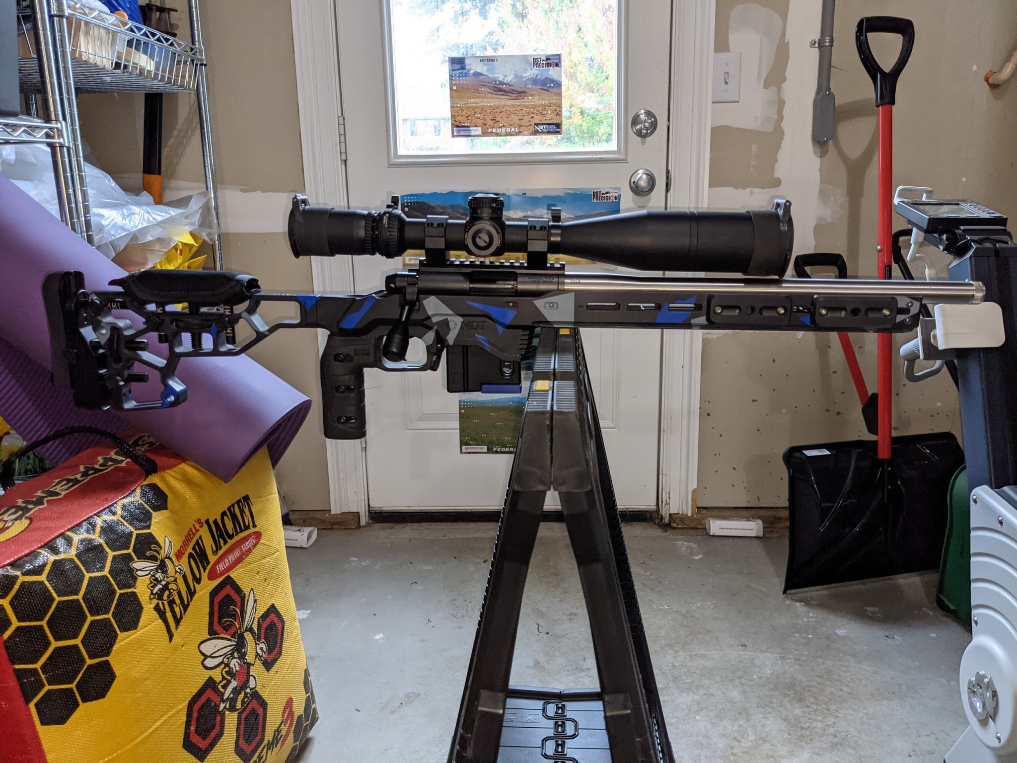

    This is a custom MDT ACC with the rear end replaced with an aluminum replacement piece, no bag rider, so I've cut a good .7-.8 lbs off the rear. It is running an 18" Kukri, I have 3 internal weights, and 4 external weights, adding about 3.1 lbs of weights to the front. This barely balances in front of the mag well.

    Not sure of your preference for a stock or chassis, but I know when I start on my Vudoo i'm going to look into the MDT XRS chassis. For the money this is an awesome stock/chassis. I have one on my centerfire and love the grip and adjustability at $500. You can also add the MDT side weights to this chassis to get the weight or balance you are looking for.
    I did look at this but honestly their photo of it killed it for me. It looks way to much like a mosin archangel.
    thays what I saw too. When you asked about the KRG I recalled that MDT made something similar. Then went and looked. I was like wth that thing reminds me of an archangel trash lol.

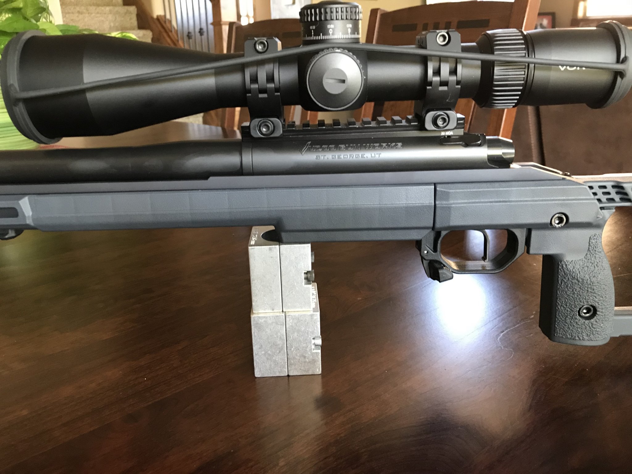

    For anyone interested in where an 18" Kukri in an X-Ray balances (no additional weights, just the plastic pic rail that came with the chassis).
    Yeh that's why I figured the ARCA aluminum fore-end + t-block weight should move the center of balance out about 3 inches from where your picture shows.

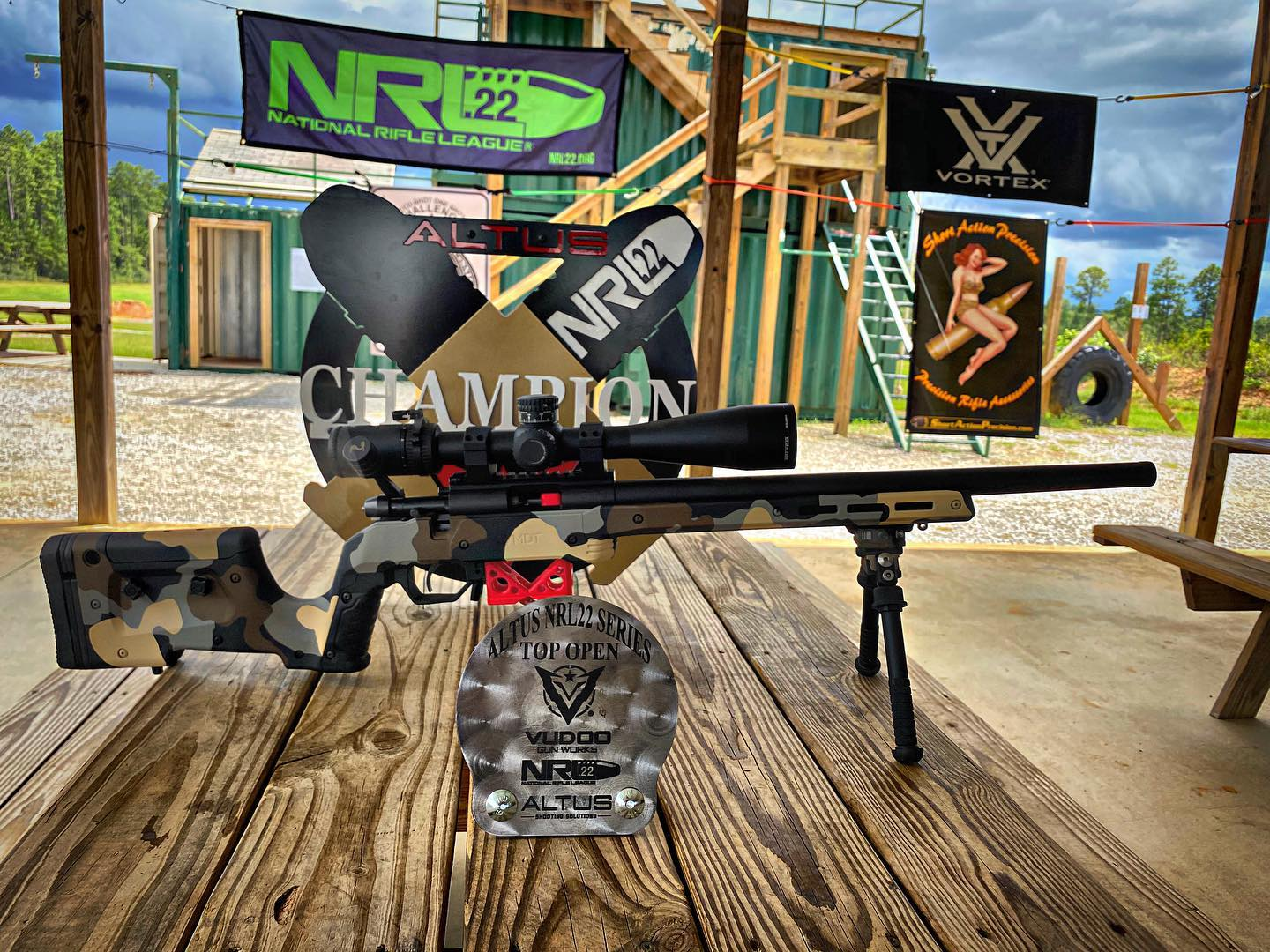

    Whoever owns that needs to have MDT use that for the website. That looks great.
    Yes, it's a great looking build that's for sure!
    @MDT_OFFICIAL on feedback about nicer photos for the XRS :)
    Thank you, you can always check out our customer gallery as well!

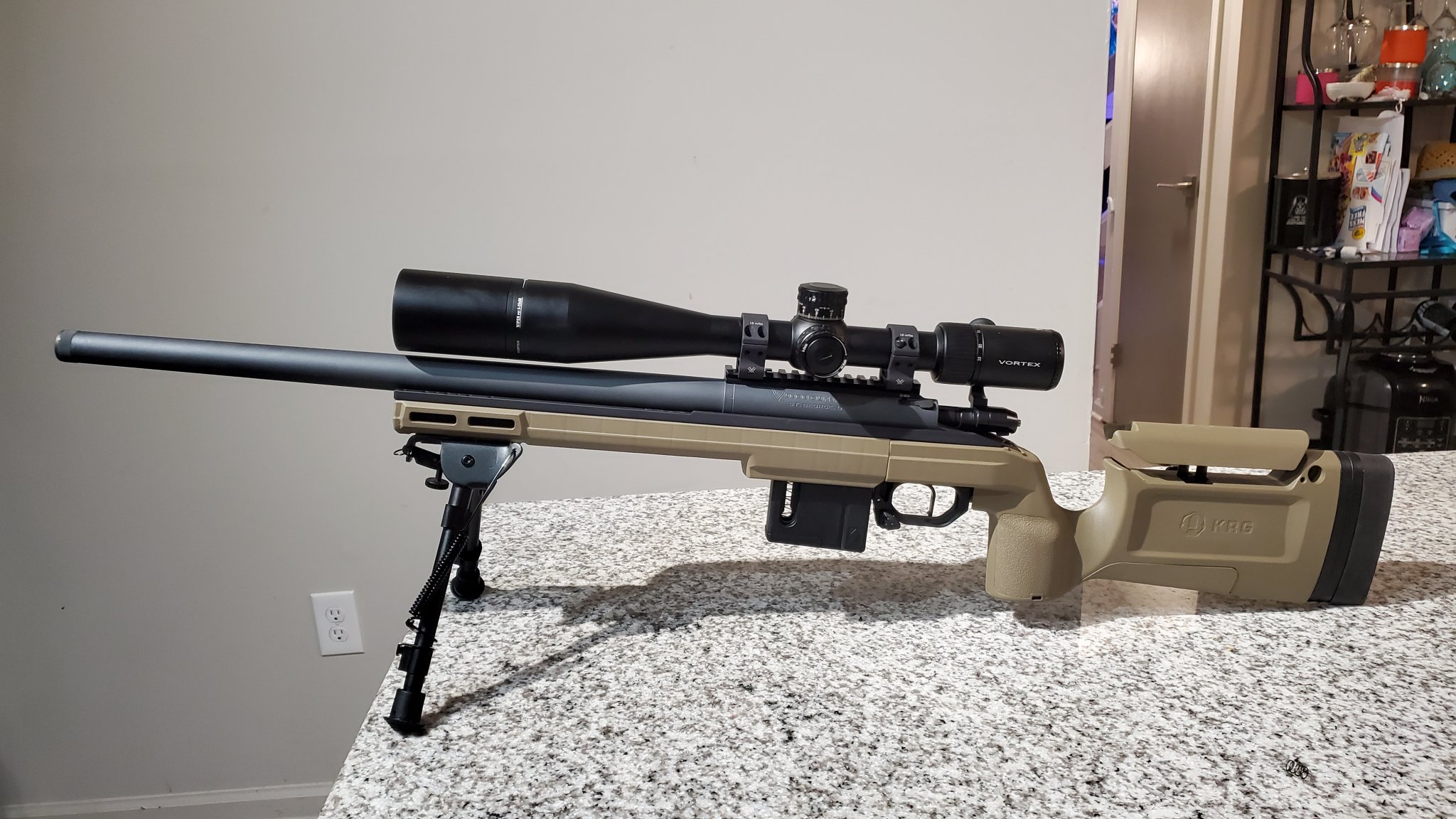

    Thanks everyone for your help on my first rifle build. Definitely spent more than planned but I got almost everything together today. Need to get the optic right and torqued. Also have to get another Atlas since I accidently ordered the 2 screw version. Old crappy Harris knock off for the moment.
    Not sure if I am a fan of the Bravo yet. @MDT_OFFICIAL I am thinking I need to find more money my wife doesn't know about and put in a order from you.

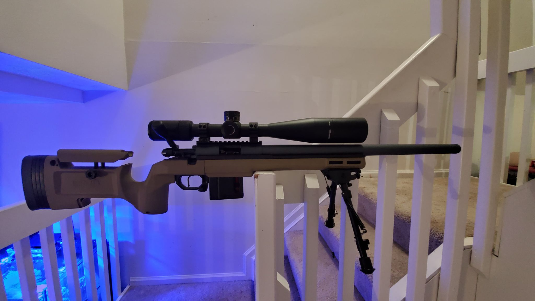

    Thanks for the recommendation. Went with the 20 mtu and bravo. Good balanace.
    Sweet. Any weight at all in the front? If you remove the Bipod does it still balance?
    Nice setup, it should shoot and balance wonderfully in NRL22.
    No extra weight. Haven't tried without the bipod yet but I will. I do feel like it is just a tad heavy on the rear. I do plan on putting a 12" arca rail, atlas psr, and a brake or suppressor so maybe that will be just enough.
    Is it not free sitting on that stairwell? Or is it being clamped in by the bipod? I ask since you say it's a tad rear heavy but it looks balanced in that picture?
