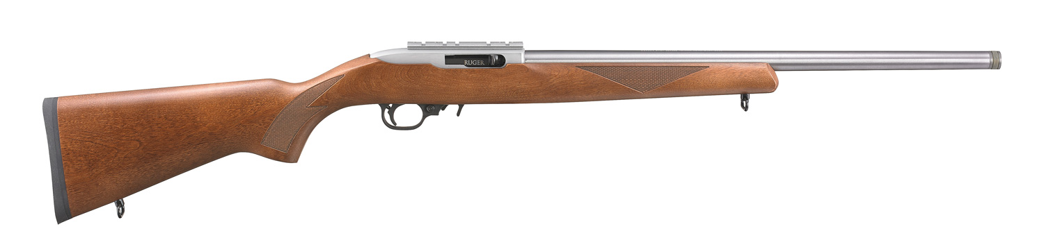

I bought a Ruger 10/22 sporter TALO (model# 31167)
It comes with this.
  • Combination scope base adapter for both Weaver-style and .22 tip-off scope mounts included.

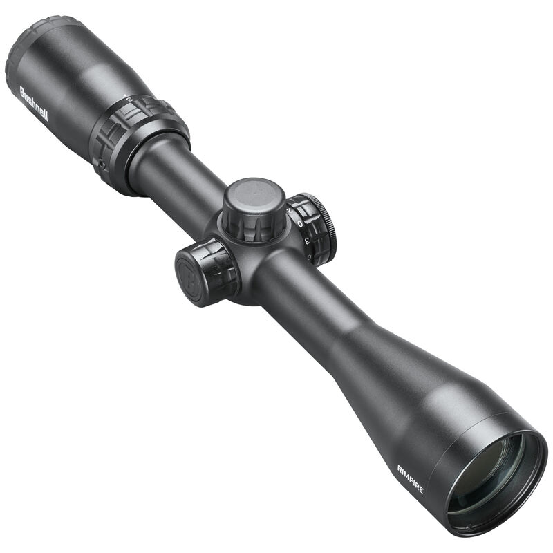

I also bought a Bushnell RIMFIRE 3-9X40 RIFLESCOPE ILLUMINATED (model# BU-RR3940BS13)
I am confused about what type of rings to get??? This is just going to be for varmint and plinking.

Whatever ring size will be the diameter of the tube, but how it attaches to the gun depends on what direction you want to go.

The slots in the rail are the narrow "weaver" slots. Most picatinny rings will not work on the rail. They have to be "weaver" rings. I'd recommend getting a new picatinny rail to replace the factory one. The dovetail is machined into the the factory rail.

I'd say the Monstrum 1" rings would be decent for a budget set-up too. I'll bet you'll want to upgrade scopes eventually, so I wouldn't buy high-end rings yet. Most better scopes will be 30mm or 34mm rings.

That is a fantastic rifle, and as already stated you may want to upgrade glass in the future with a 30mm scope tube with a bit higher quality glass and more magnification. I really like Bushnell and SWFA (non rimfire) scopes on my rimfires.
Maybe changed, but I've seen supplied rails that accommodate both. Think my son's 10-22 has one.
That model comes with a single rail that accommodates both weaver and tip off. Just get weaver rings for the scope you have.
