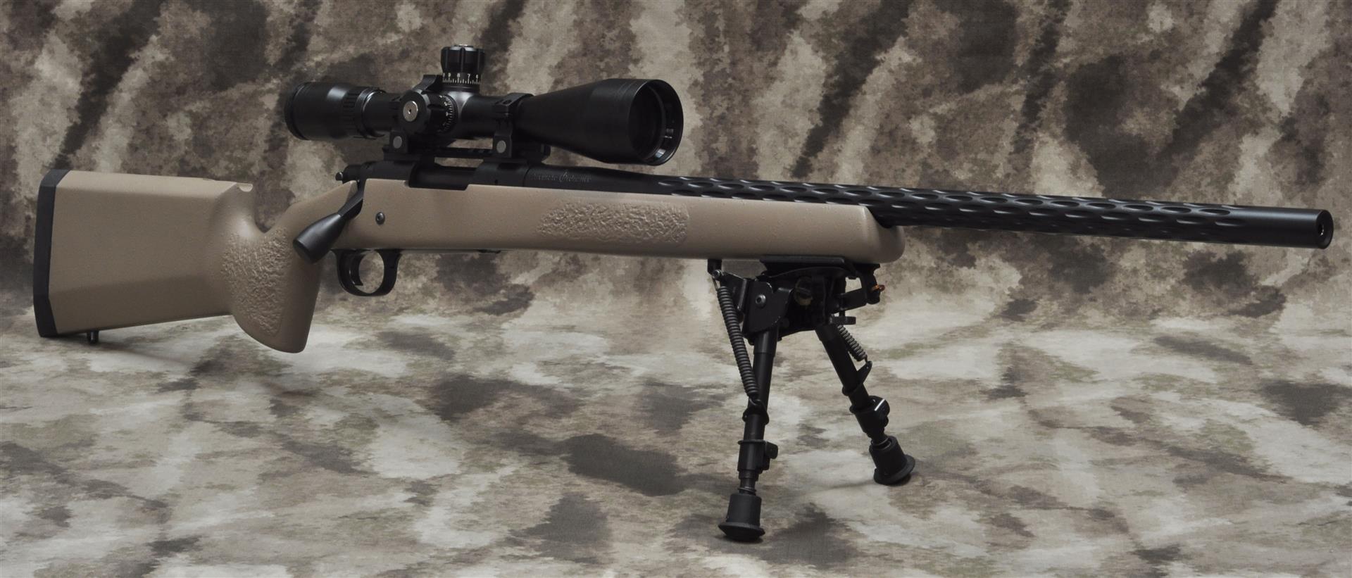

Look at the Manners Elite hunter series stocks. I have a EH-1 ordered in Elite Tac GAP camo.
x2 on this,here's my EH-1
I just bought a EH1 off a member and simply love it...I dropped an SPS 16.5" into it so it's not exactly the same type of build,but none the less...
A chum of mine has an SPS 20" fitted to a Game Scout,and comparing the two,the Manners stock fixes everything I disliked about the Game Scout...the EH1 has a little higher comb,this may or may not be good for you depending on the scope you use...The forend is a little fuller,not needed for your barrel contour but more comfortable to me,and seems more stable when rested on the forend...And the bottom of the stock ,in front of the toe is much more parallel to the bore,and not as touchy as the Game Scout when using a rear bag...the toe on the Game Scout is so steep to me,that if you have to reset at all,you lose elevation...it's great for rappid,gross elevation changes,but too touchy for me...
In any case I'd recommend the EH1,being you aren't opposed to a vertical grip...
I would give it a "9" except the texturing is useless...a waste of both time and epoxy...
Though YMMV...
