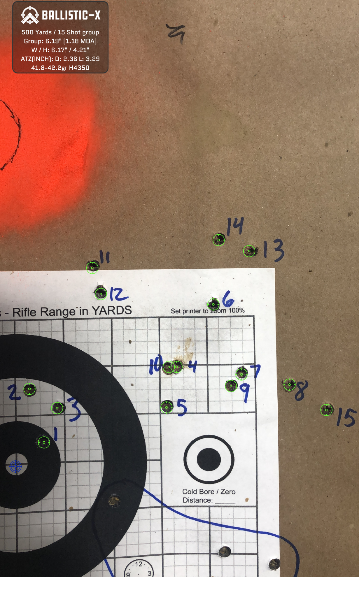

    I've been doing some load development for my 6.5cm and I tried doing a different style load development for this rifle. This would be my first "larger" caliber precision rifle... as I've always shot AR's from 300-600yds. So basically new to the 6.5 game.
    I did 2, 10-shot ladder tests from 39ish to 42.2gr. of H4350 at 0.3gr intervals. I shot them over a chrono at 500yds, same POA. I had two nodes, one big one at around 2620fps, and a smaller one around 2700fps...which is what I stuck with. 41.7-42.2gr gave me about 2" of vertical on test 1 and about 1/2" of vertical on test 2.
    I wanted to try and confirm this again at 500yds...not only for practice, but also out of curiosity. So I loaded 3 rounds each of 41.8, 41.9, 42.0, 42.1, and 42.2. I shot them 1 charge at a time, same POA.
    Here's my result. I did shoot 1-5 and 6-10 all in the same position and string. Then checked my velocities, reloaded my mag and shot the remaining 5...which could be why shots 11-14 are high...maybe my position and sight picture wasn't as good. I'm by no means a great shooter... but I'm really just trying to get an idea if my load development is good, so I can stick with a charge and practice more, etc.
    Winds were at my 2 o'clock going from 5-10mph...which could account for the horizontal... as I did not try to play the wind at all.

    Total vertical spread is about 4"... if you take away the 3rd test, where I got off rifle and came back, vertical spread is about 2.5ish inches.
    ES across the 15 shots: 39
    SD across the 15 shots: 13.9
    I did load 5 shots in the middle at 42.0gr. ES was 11, SD was 7

    I take it shots 1-2-3 are 41.8, 4-5-6 are 42.1, etc?
    If so, then that has the lowest vertical spread, but 3 shots is nowhere near enough to validate. Load up 20 or so at that weight (42.4?) and try and validate it.
    No, shots 1-5 are 41.8, 41.9, 42.0, 42.1, and 42.2, then shots 6-10 are reverse of that, then 11-15 are like shots 1-5. I did sort of a round robin with the charge weights.
    Essentially what I was trying to do was confirm that 41.8-42.2 was good enough to call my node, then load at 41.9 or 42.0. I was trying to make sure that I wasn't riding on the fringe of my node, so wanted to see what my vertical spread was across the 0.5gr of spread.
    After this I was going to pick the middle or so and load up 10-20. Just trying to get input on whether my head's in the right spot.
    So it’s shots
    1,10,11 for 41.8
    2,9,12 for 41.9
    3,8,13 for 42.0
    4,7,14 for 42.1
    5,6,15 for 42.4

    I was more concerned with the overall vertical spread across 0.5gr. of powder charge and trying to get more experienced eyes on whether it seems to fall into what appears to be a node.
    Its 500yds, so I wasn't really looking at the 3 shot groups of the different charges like I would at 100yds or something.
    Who knows if its in a node, there’s only half a grain of evidence to judge off of. It’s too narrow a window.
    Now if you’ve based this small sample size from some other testing then sure, I’ll assume that this is what you assume is your node based on the fact that you are showing it.o_O
    It’s not a great vertical spread but if you want to do better you’ll need to do something.
    What do you think we could tell you based on 15 shots worth of incoherent data is beyond me. I’d want better but it’s also settle for it if I were lazy.

    This hurts my head just trying to comprehend what you did. Take the 3 shots for each charge and highlight them or draw different colored lines between the like shots. So red lines connecting the shots with charge 41.8, green line connecting the 3 shots at 41.9 etc. You can screen shot this and draw the lines if needed.
    A node would be like shots 7, 8, 9, 10 are shots 41.8, 42.0, 42.2, 42.4. In which case you’d test with different seating depth at 42.0 and 42.3 or something of the sort.
    Nobody is picking on you here. You just didn’t give us much of a “node” to identify as your spread is only .5 grains total. And trying to interpret which shots are which make it more confusing. Connect the 3 round groups and maybe we can help you. If spife is correct than they all suck

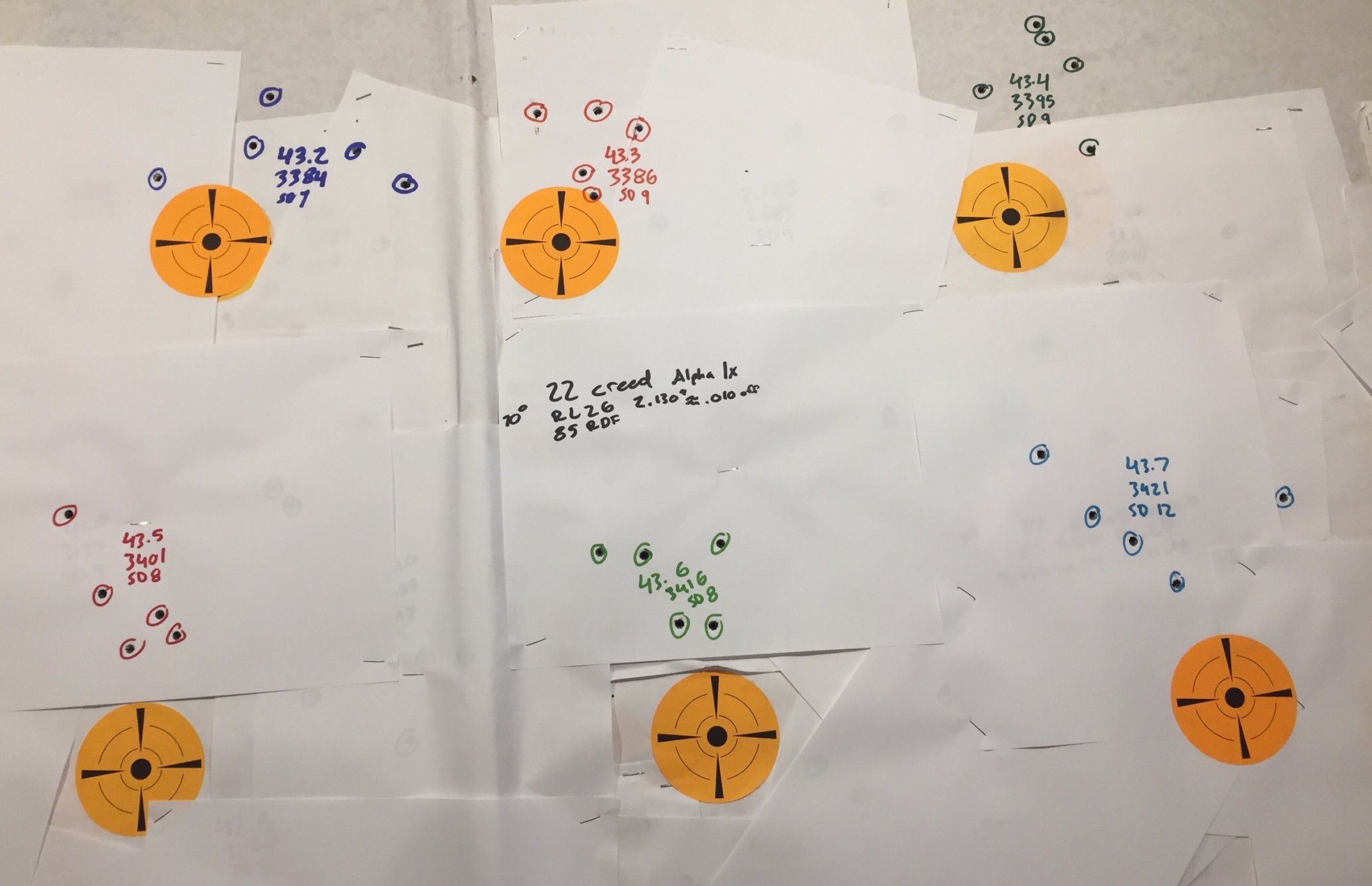

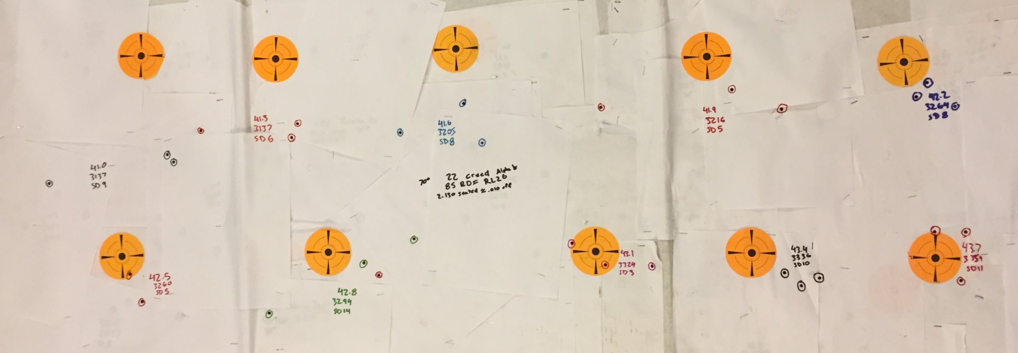

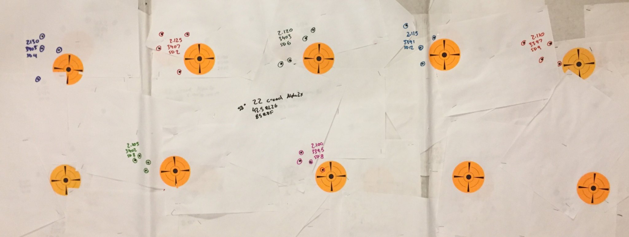

    I’ve been working this up this extensively just because it’s a new chambering to me and I wanted to explore it and not rush to decisions but here goes.
    Initial 100 yard pressure test, found it at 44 with noticeably heavy bolt lift though not all that extreme
    Do it again at 500 in a bit narrower windows to see how it shoots, clearly tightens up around 42.2 and 43.4
    Checking it out in tighter higher but still wider range based on above, seems pretty forgiving
    Seating depth because it’s also a new bullet and I don’t know how it jumps, it’s fine from .010 off to .030 off
    10 round confirmation from .010-.025 off while hitting each 10 round string hard and letting it cool in between. So I think I’ll just shoot the hell out of this load until the steel starts to tell me otherwise in 1k rounds.
    Next barrel I could narrow down a bit and save a few rounds in testing but so far I’m really liking this 22 creed chambering. But this testing lays out out right there, not really much interpreting to it.

    I’m sure some people will tell me I’m wrong and a larger sample and it will all equal out the same but I think the target clearly shows a preference for some spots.

    And you did all this 22 Creedmoor testing at 500yds right? The 22 Creed looks awesome. Seems to be very forgiving for guys too?

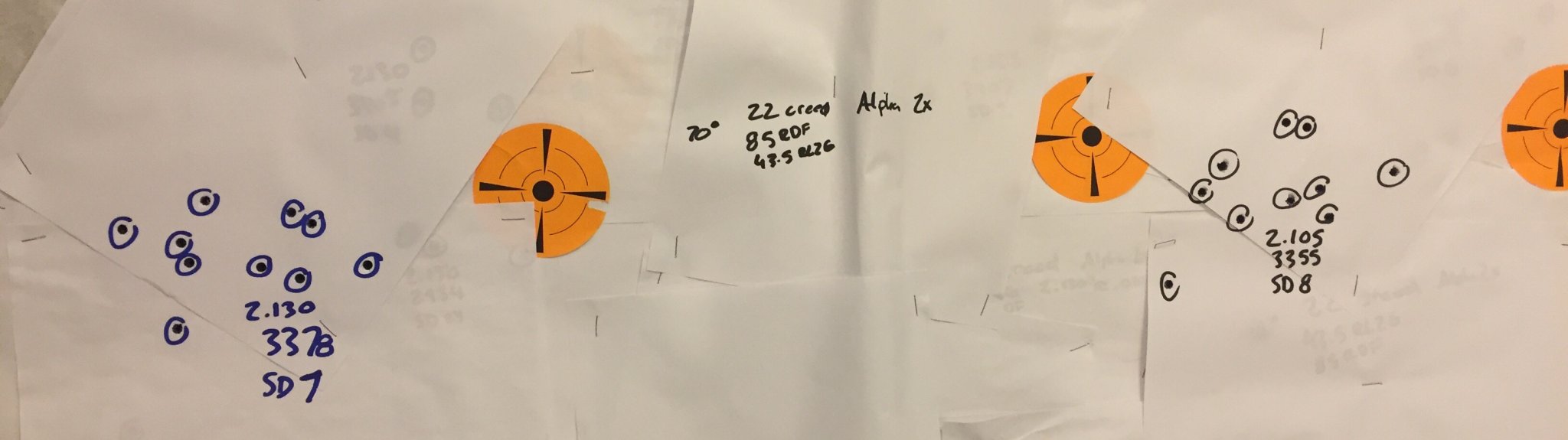

    I did about the same as spife and the pics below are 5 rounds with 260 at 600 yards (one with bic lighter) and 5 rounds with my 284 at 500 yards as the result.
    Other than the initial 100 yard, yes. 500 yards, those are 3” stickers.
