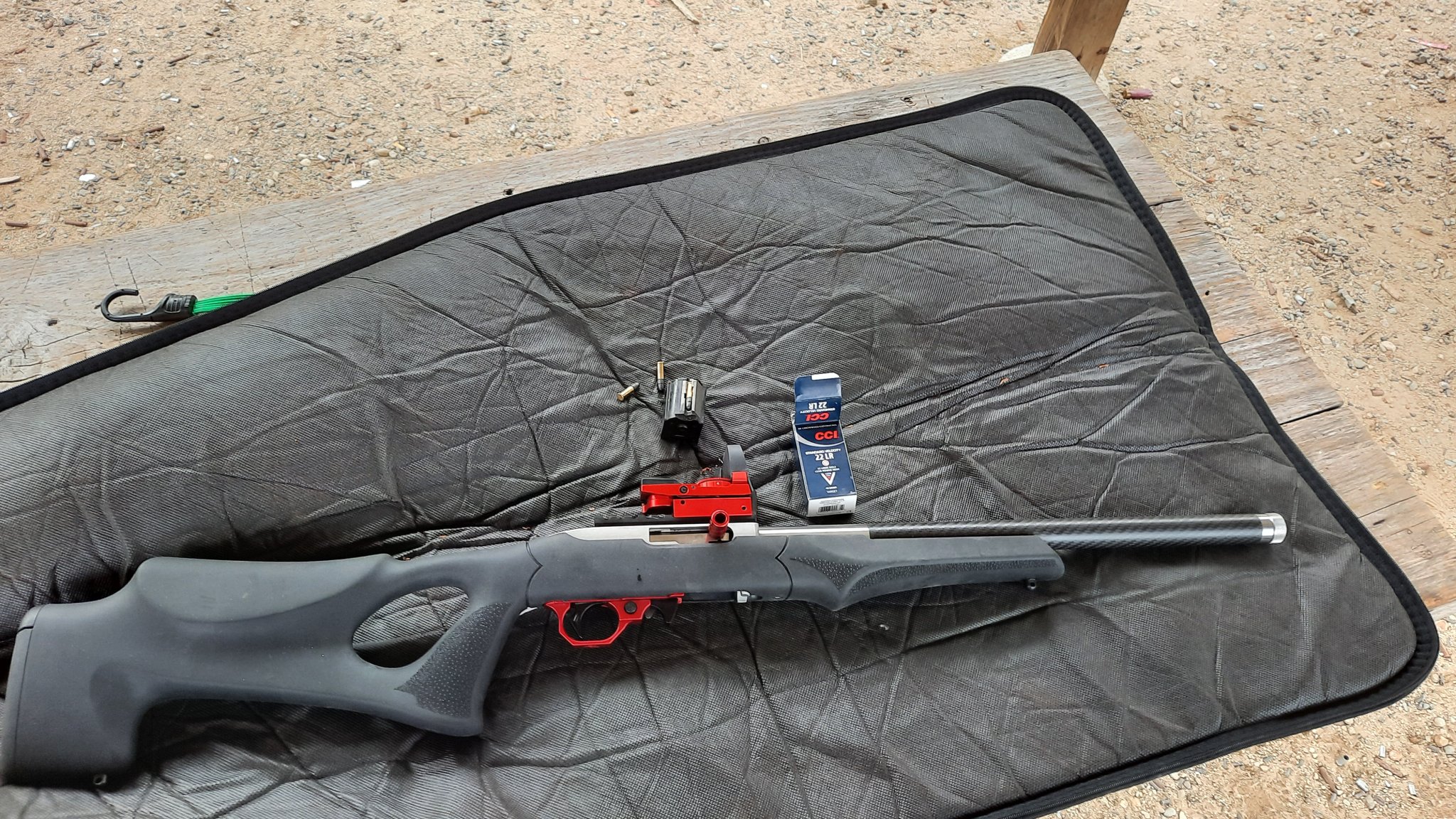

    There is hope. The length from the front of the receiver /stock cutout to the tip of top edge of the stock on the Hogue Overmold Tactical model is only 8 1/4" ( 9 1/4" to the very tip of the stock on the bottom edge). A 10" barrel would easily clear with near 2" to spare. I have both style Hogue Overmold stocks and Like them both. While I don't consider myself a "Tacti cool" fan, I do find the ergonomics and versatility of the Tactical stock are excellent! It's light, stiff and it has the same tacky feel. I think it might even point better and faster than the standard model.
    That looks cool, may have to get one and try it. (y)
