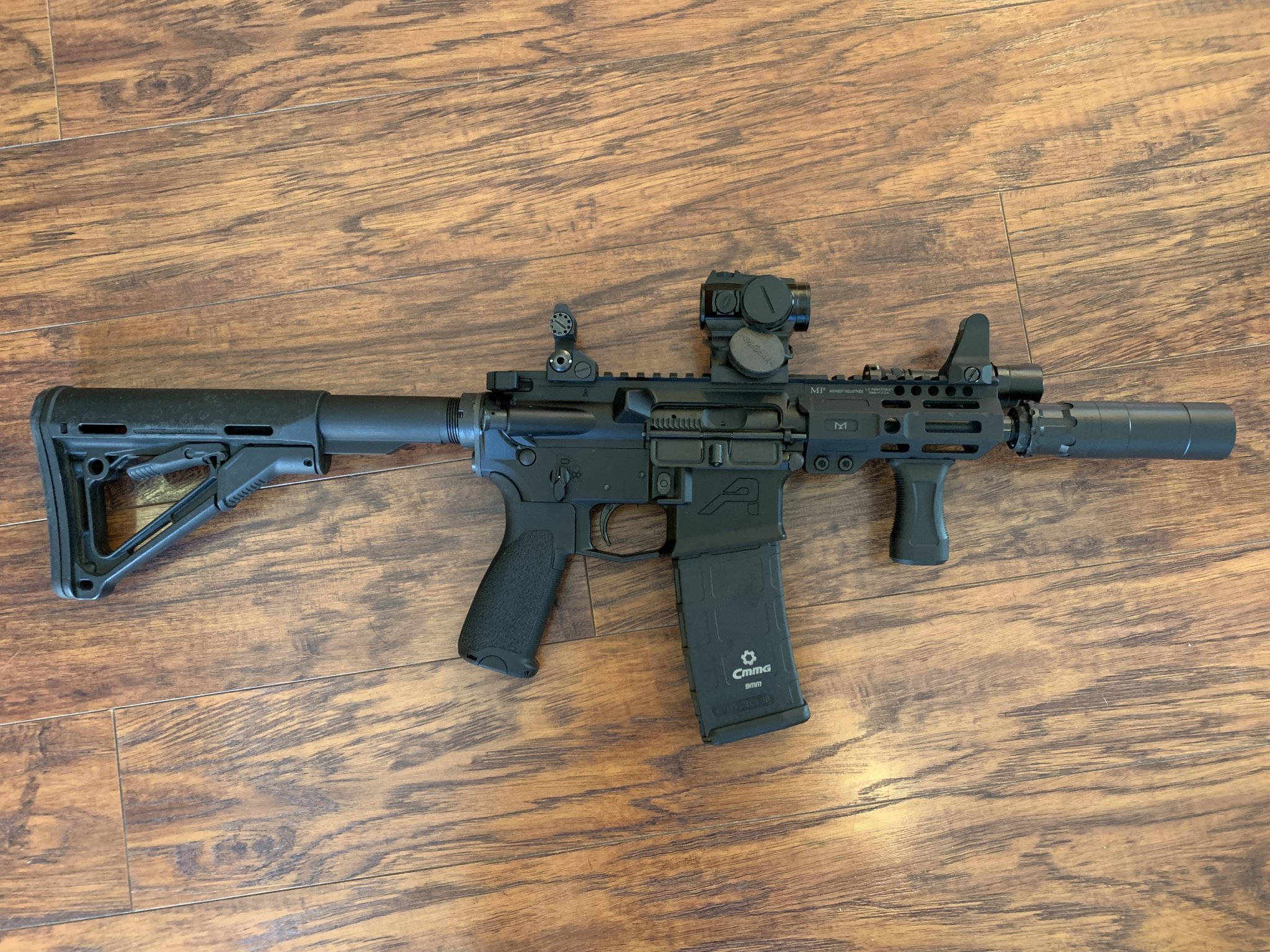

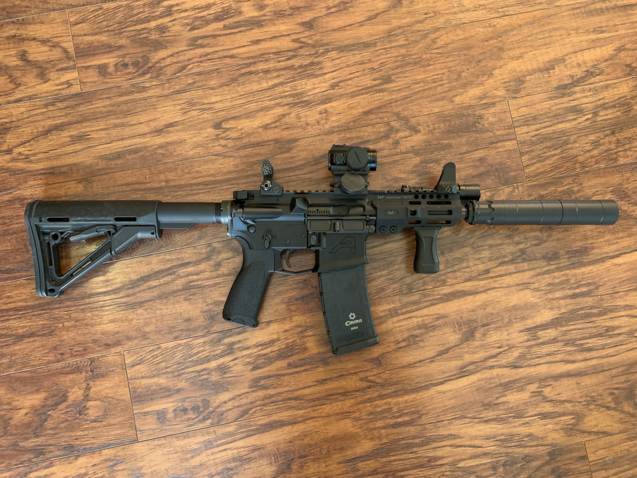

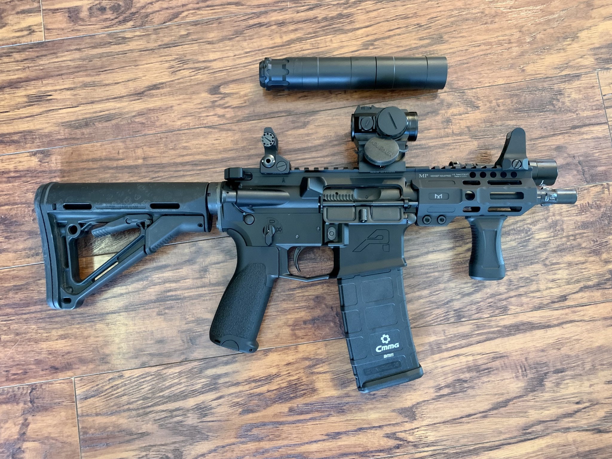

Home build Form 1 SBR, 5” CMMG delayed radial blowback bcg/barrel kit and 9mm converted magazines.
