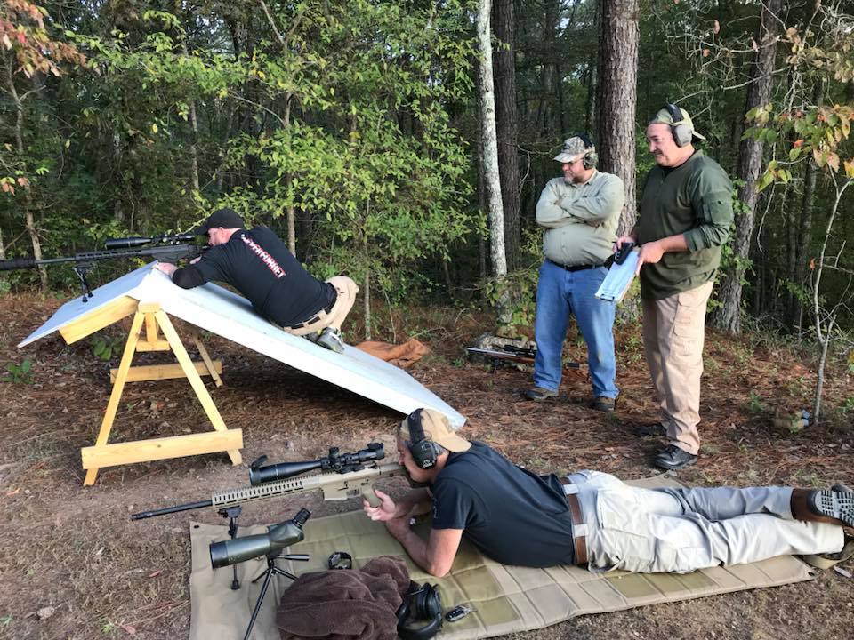

I built one in a day... its a 7/12 pitch... Its built to be portable... Used only 1 sheet of ply...
