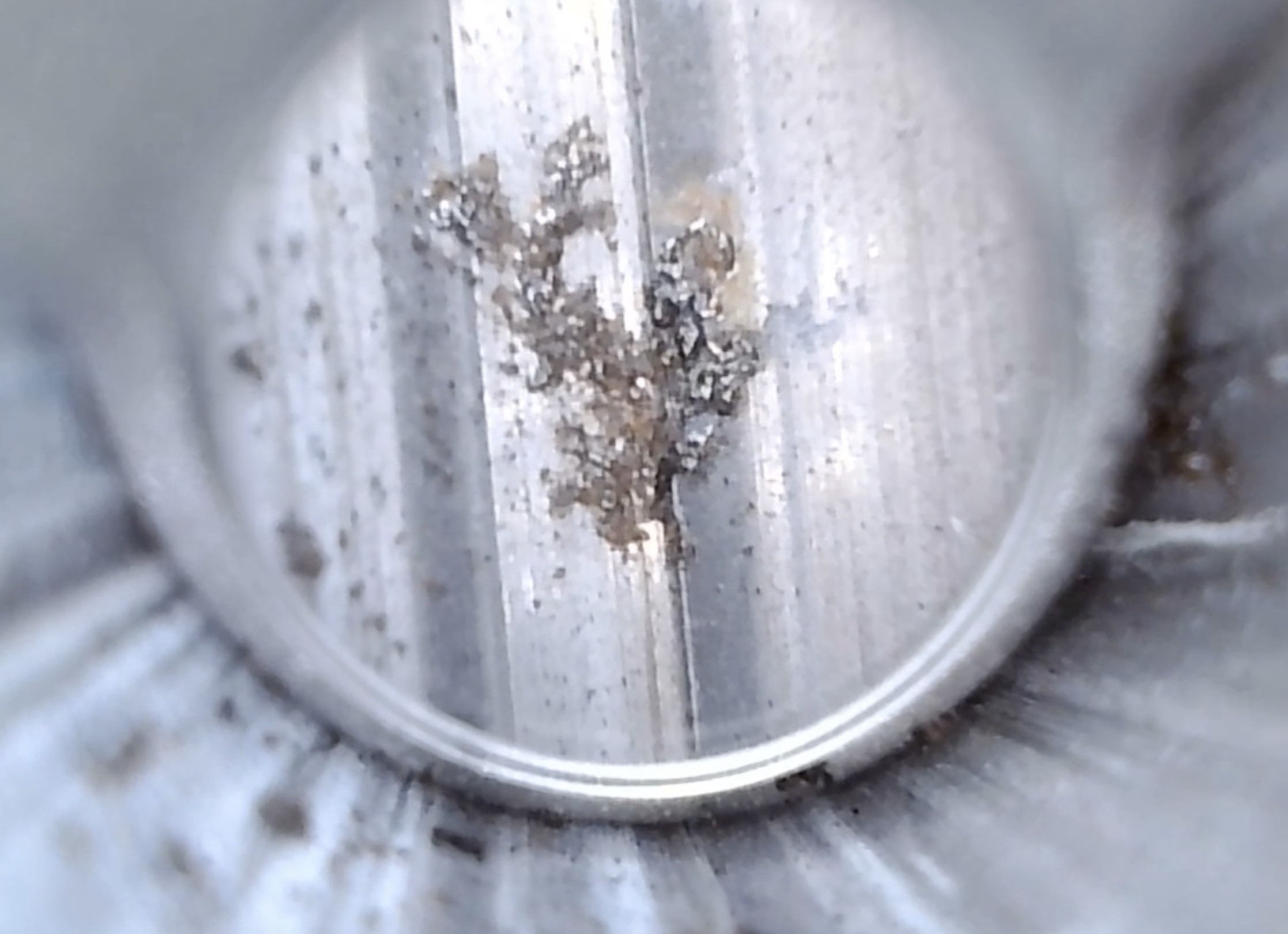

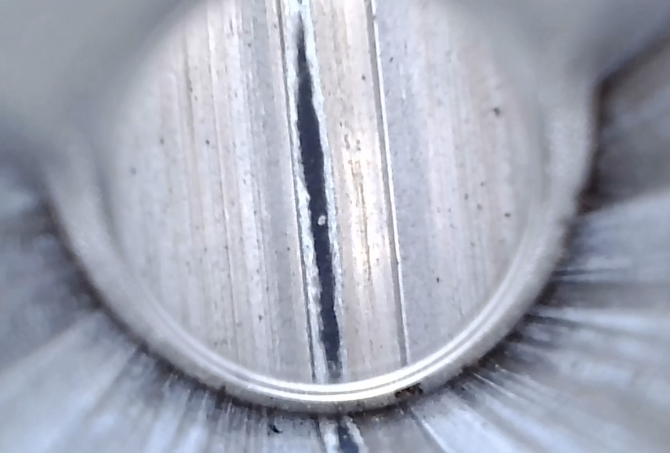

Hi Guys,
I just bought a borescope, and I wanted to check my barrel before I start cleaning.
what is this ?
FYI
Rifle : AI ATX 6.5 CM (about 200 rounds )
Hopefully you measured where it was.
Now, clean your barrel thoroughly and look again. I agree with the corrosion and hard carbon assessment above.
Your barrel will otherwise be fine.
Thank you
Is it normal to see corrosion after 200 rounds ? Or am I doing something wrong ?
Thank you
Depends on your conditions you've got it in man. If you let some moisture get down the bore, or took it out from a cool house into a hot afternoon and let it condensate etc...
Stainless isn't impervious. But it is a lot more resistant than carbon steel.
As said...measure where you found this "corrosion", clean it and look again. Yes, it may be corrosion but it is pretty early in life for what looks like that type of pitting. Actually, just push a dry patch or brush thru and see if the "pitting" is in the same place.
Bore scopes are very handy tools...IMO, primarily to eval state of cleanliness/dirtiness and the effectiveness of your cleaning regime. But we have all pretty much seen stuff that someone is stressing over as pitting and it turns out to be lint from patches or some other crap sitting on the surface fo the steel.
If it is actual pitting after only 200 rounds of 6.5 CM....and you don't live in a tropical rain forest...I'd take it up with whoever you bought the rifle from (assume you bought it new)
