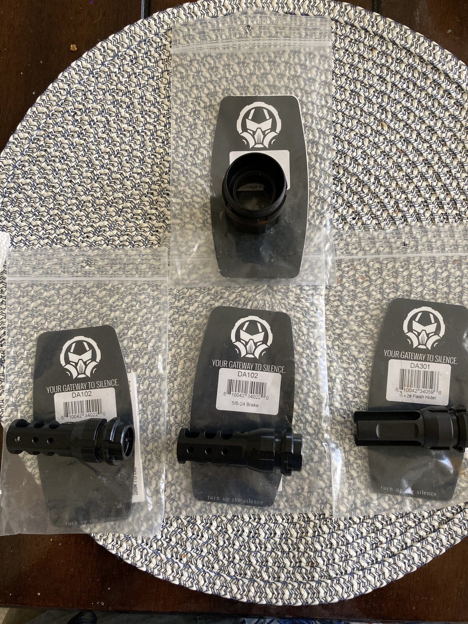

My Nomad 30 finally cleared "jail." Comes from Dead Air direct thread. Dead Air also have KeyMo and Xeno mounts. Alternatively, I could swap the end cap to Area 419's and buy into their Hellfire system. I am sure there are others that I am missing. I started running some numbers on what all this could potentially cost depending on how many rifles I wanna swap the can between. It would be drastically cheaper to just direct thread the can onto 5/8-24 hosts. I've got a self timing brake that I can do the same thing with. For less than $100 I can get a 1/2-28 end cap. The only down side would seem to be the ass pain associated with trying to swap between 1/2 and 5/8 at the range. Looking at the Dead Air Xeno/Area419 options, it appears you simply thread onto the adapter (which can host multiple muzzle devices) instead of the barrel directly... so, conceptually the same. Questions:
1. Other than the convenience associated with swapping muzzle devices between rifles, what would be the advantage of an adapter based system? On the surface, there doesn't appear to be one (i.e. threaded on is threaded on, regardless of whether it's an adapter or the barrel).
2. Does the KeyMo even make sense anymore? It's larger, heavier and considerably more expensive. What's the upside?

This is why I invested in the KeyMo/KeyMount system. Yes, it's pretty hefty in weight, and cost... But the KeyMount muzzle brakes are really nice, and if you're using it on magnum cartridges, it helps to mitigate erosion of the blast baffle as quickly as if you're running DT.
Also, your mention of the conundrum of running DT on both 1/2x28 and 5/8x24 is solved, because KeyMo is the same size, regardless of the size of the threads that the muzzle device & barrel have. So, you only need the 1 KeyMo mount, and then buy your KeyMount devices according to your rifle's threads. 👍🏼
My 5.56 AR's use a 1/2x28 KeyMount, and my 6.5G and 300 BLK use 5/8x24 KeyMount... The external dimensions of the KeyMount devices are the exact same. This means I can quickly and instantly interchange my suppressors between all my rifles with no tools. Pretty cool design.
Other than the convenience, the right muzzle device will have other positive functions. Example, the KeyMount 3-port muzzle brakes do a VERY good job of mitigating recoil, even without the suppressor attached.
I like KeyMo, but some folks don't. The ratcheting really lets you know the can is on there, and that it isn't going to go anywhere, even under heavy fire.

1. Kind of. Direct thread without torquing the suppressor on it will likely back off. With the taper system you get the same repeatability and the suppressor will not come loose. It's qd lite imo but faster than dt. Your bare muzzle isn't exposed and you don't have to buy thread protectors.
2. Imo no. It adds a lot of weight and length. It's quick. That's about it. I'm thinking of selling off all my key mo stuff. The weight and length penalty is too high. It's also very expensive.

I like Ayn Rand as much as the next guy, so I'll look at the Rearden metal... that said, the Area419 universal adapter would do what you want. It's literally just the tapered base and it's $40 per unit. Other than that, you'd just need the suppressor end cap for your can, and you can swap it onto any platform with the adapter. Most economical system I've seen yet (that $40 uni mount also accepts their brakes, so you could also just swap a brake or flash hider around if you were so inclined.

Another option…I put the Q Plan B on my Nomad 30 which allows me to QD on any of my rifles hosting a Q Cherry Bomb muzzle brake which are 1/2 or 5/8.
You could get the proper 5/8x24 and 1/2x28 direct thread mounts and rockset them and permanently install them to the barrel. Then just move the suppressor from gun to gun. That’s what I do. This obviously wouldn’t be ideal if you wanted to shoot without the suppressor on but where’s the fun in that? Lol

I don't get the fascination with suppressor 'QD' systems.
Overly complicated at times, adds weight, length, stacking of tolerances, cost and potential for issues (such as grenading a can downrange when you mixed up installations steps #4&5). They also aren't really any quicker then DT.
If you can get away with it, direct thread is the way to go, IMO.
If you need to swap between two different types of weapon systems (i.e. AR15 with 1/2x28 threads and precision rifle with 5/8x24), then I personally think the most elegant simple is Q's cherry bomb system (can't stand the prick that runs the company, but the cherry bomb is a nice system). The taper before the threads thing actually works, and it's such an elegant and simple way to mount a suppressor if you can't feasible DT.
Reactions: DJL2 and BamaSE
I've built a couple form 1s and I've standardized on the rearden atlas and brakes which are based on the Q plan B/cherry bomb system. I had planned to go with keymo originally but the rearden setup is half the cost and adds less length than the keymo. The keymo is a QD system but after the few strings of fire, you're probably not gonna be taking that can off in a hurry.
Another advantage of the rearden/cherry bomb brakes is that there is a taper in front of the threads for the can which seals the gas from getting onto the threads and locking them up. That can be a problem with direct thread mounts. Also, as others have mentioned, direct thread can back off. Biggest problem with rearden is that they're never in stock.

Another good option is Griffin’s Plan A. Your MDs are around $80, and $80 for the adapter for the end of your suppressor. It’s also a taper mount and I’ve been pleased with mine.

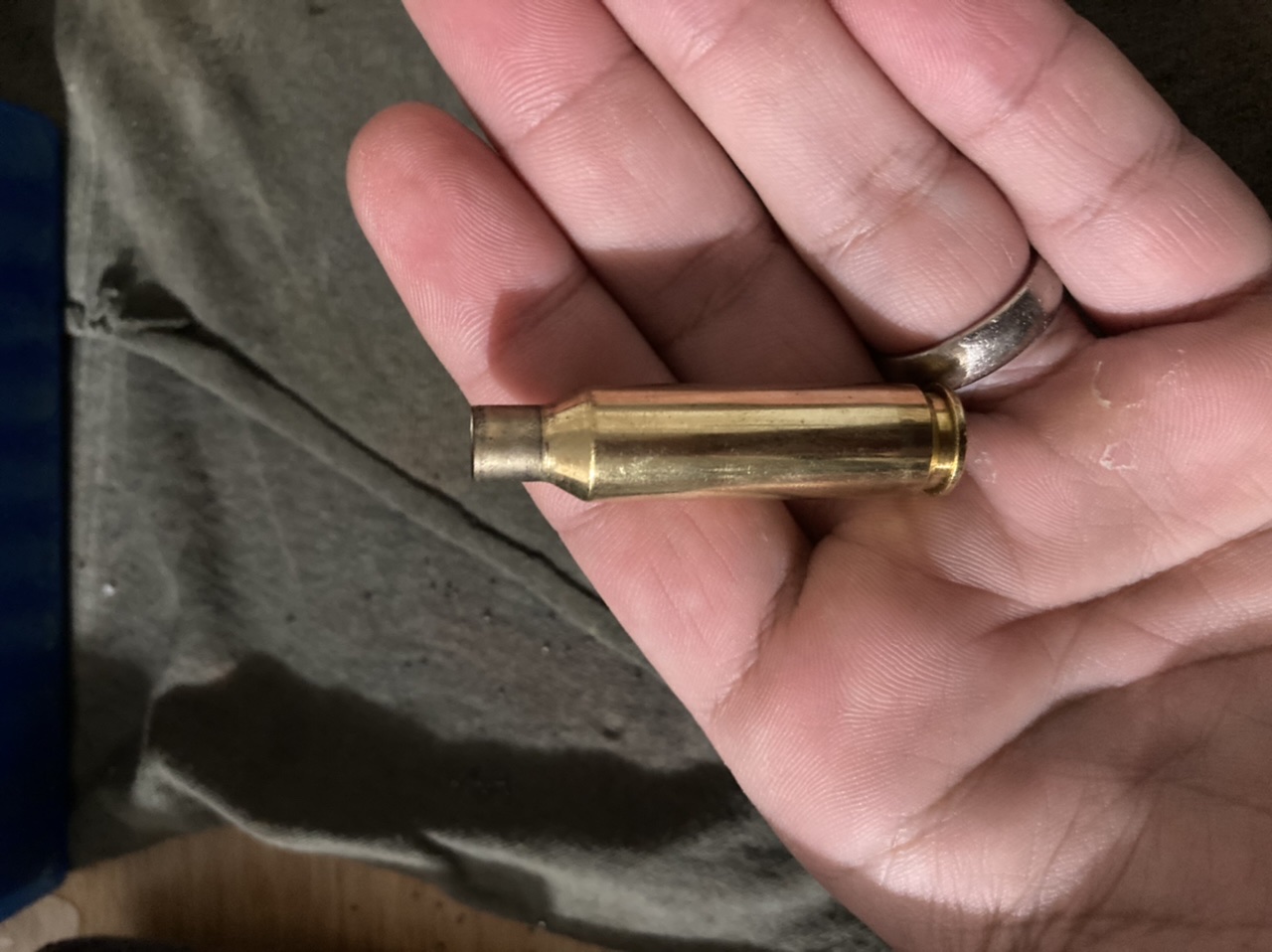

3. Stuck cases, cause and prevention?
This little guy is S&B factory ammo that I was shooting for giggles (it shot into the same group at 400 yds as my Hornady 140 BTHP… I was surprised). I think I need to swap my extractor (KRG SOTIC), so that might have contributed. When I got around to rodding the case, it just fell out as soon as I tipped the rifle up.
This isn’t something I’ve encountered running my ARs suppressed and I don’t have an explanation.
