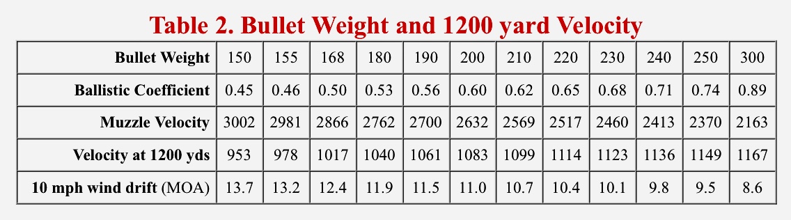

Interesting perspective on the trade-off between bullet weight, BC and wind drift. Basically mathematical proof that high muzzle velocity never compensates for the compromised BC of lightweight bullets, if wind drift is your main selection criteria (as it should be):
These are projected BC values, not actual commercial bullets. And yes i realize we don’t have a 300 gn 308 bullet (yet). 😊
Of course it would be even better to shoot that super heavy 250 gn 308 bullet out of a 300 PRC or a 300 Norma at much higher speed.... but shooting a 308WIN well beyond 1,000 is a worthy challenge, like learning to shoot a 22LR out to 400, which makes for a good ELR trainer rifle if you don’t have access to a 1,000 yard plus range nearby.

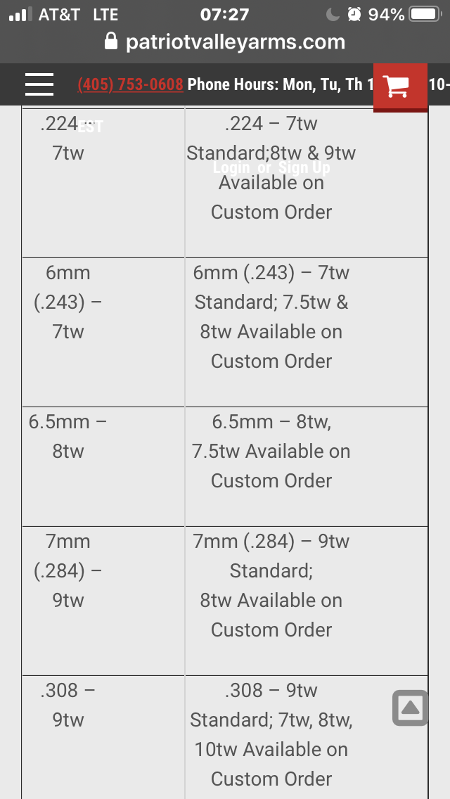

Bryan Litz and Josh Kunz at Patriot Valley Arms are all recommending much faster twist rates now, presumably to shoot the super high BC monolithic bullets and the new heavies.
It seems their PVA standard 308 prefit barrel has a 9 twist, with 7 or 8 twist available on special order. Surprising!

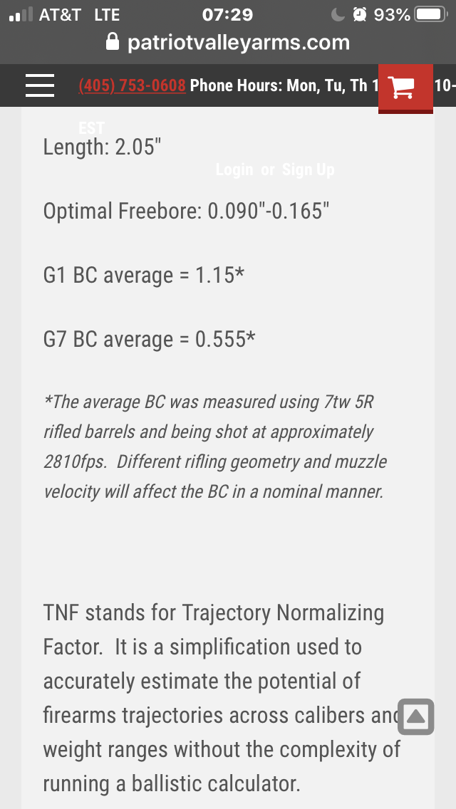

Below is their new 241 gn monolithic bullet, which has a screaming high BC, but note the twist rate comment at the bottom in the pic below:
They used a 7 twist 308 diameter barrel to shoot this very heavy 241 gn monolithic bullet - with a sky high G1 BC of 1.15, higher than most 50 cal bullets, and a superb G7 BC of 0.555!! Presumably this was fired from a 300 PRC or 300 Norma or similar to achieve the impressive 2810 fps muzzle velocity. Supersonic to beyond 2,300 yards according to Strelok. Amazing!
Seems to me there is a BC “arms race” going on between the bullet makers, and all the new bullets are getting longer and heavier, needing more freebore.
It would seem prudent to pick a faster twist rate when it is time to replace your 308 barrel, to shoot the latest heavies.
