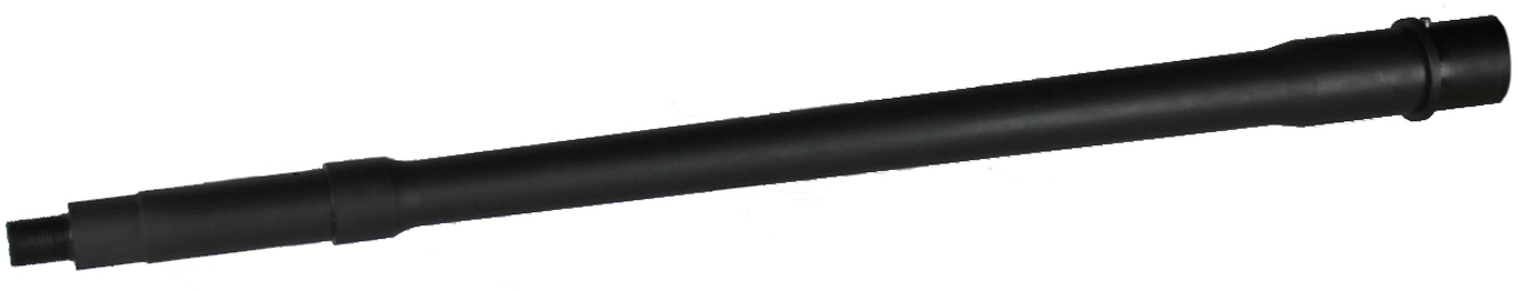

I would suggest ADM billet upper, bcg and handguard.
Then get this Criterion hybrid 16" barrel with rifle length gas system.
https://www.opticsplanet.com/criter...l.html?_iv_code=2RR-ATB-RLHYBRID15-15160-HY12
opplanet-criterion-barrels-16in-hybrid-rifle-gas-system-barrel-chrome-lined-15160-hy12-main
This would be a fantastic suppressor host for the RC2 and is essentially an adm mod 2 upper with a different Criterion barrel. You can go adjustable gas block if you wanted as well or just tune with buffers.
