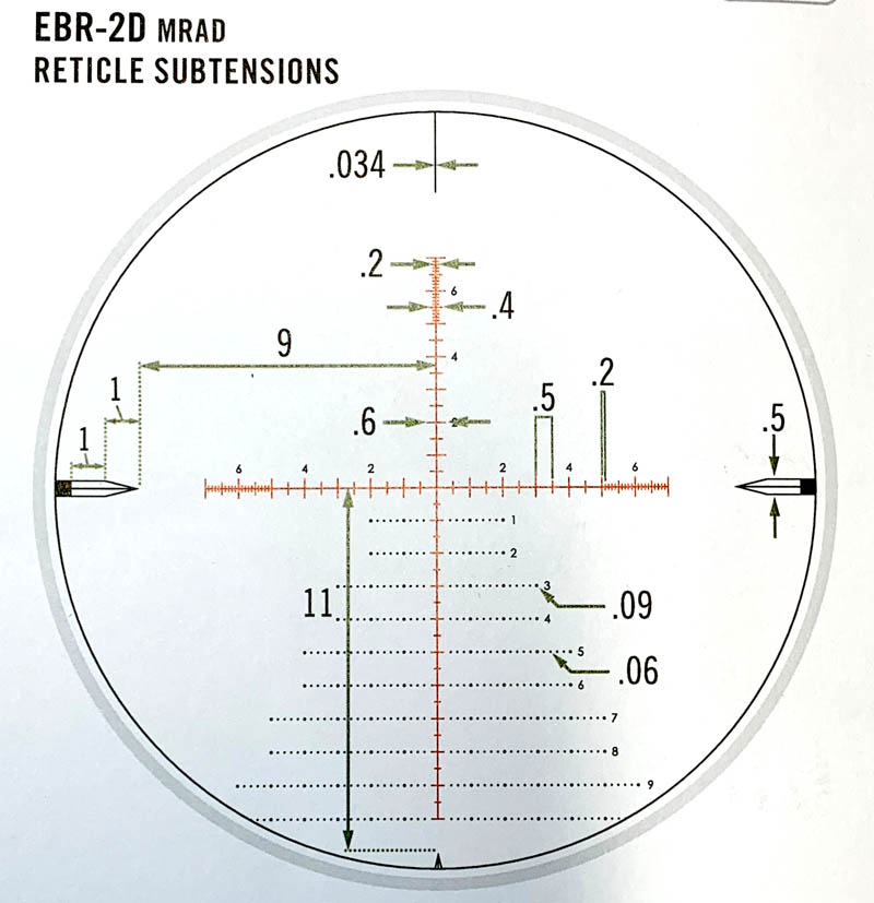

The crosshair is .034mils thick vs .03 with the other variants. Illumination is bright enough. 28.1oz. My only ding is not locking turrets. It was a special run, not sure if you can find them new.

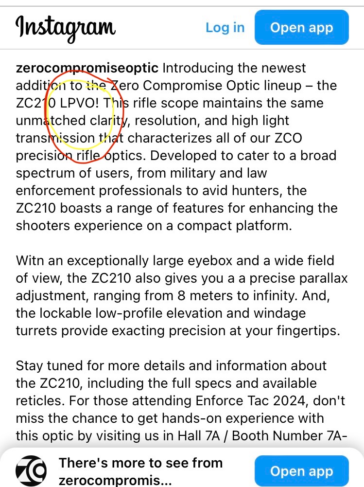

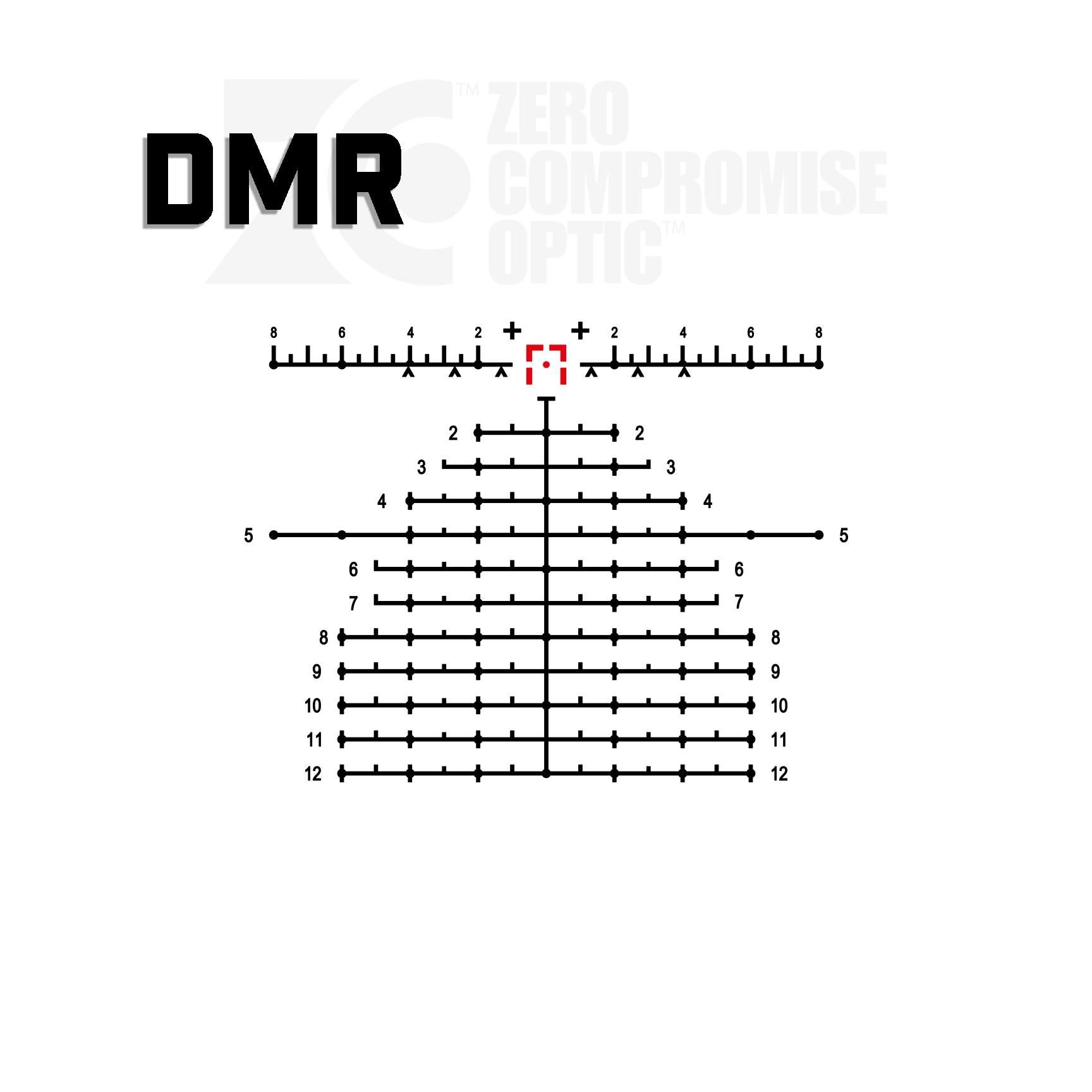

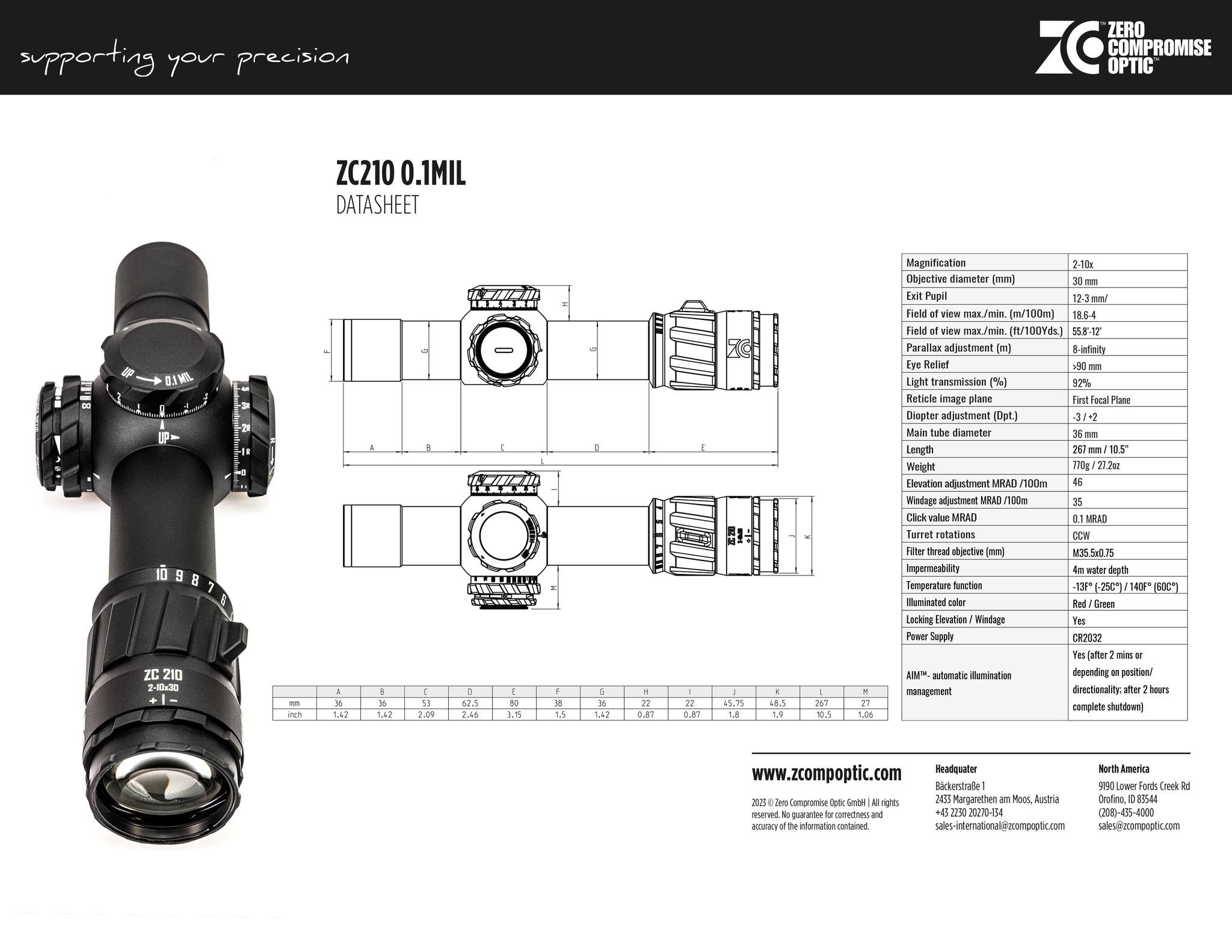

ZCO announced a 2-10x30mm coming soon. 27.2oz with only a 30mm objective is hefty though. I want some specs on those reticles, but the HTR reticle looks promising for my uses. 36mm tube cause fuck you. Also probably $3500+ cause ZCO 😭 https://www.instagram.com/zerocompromiseoptic/reel/C3ydHVHvZOM/
That HTR reticle nailed it! Only things I dislike are the 36mm tube, weight, and probably the price tag as you said.
SPR/DMR type application as well as hunting where larger objectives may not be as much a factor. I prefer FFP for hunting, biggest issue is sucky reticles at low mag.
