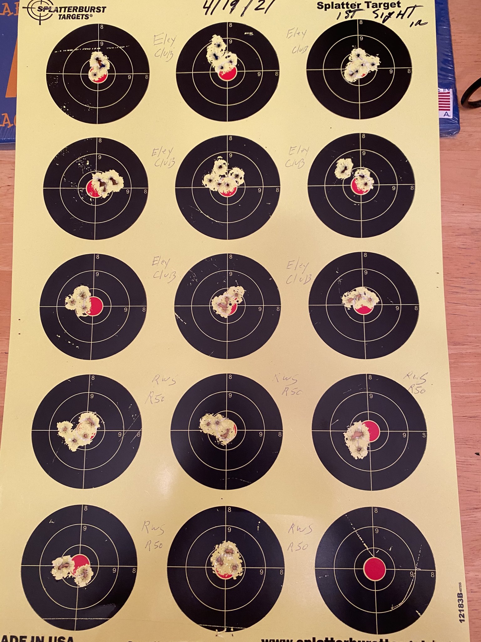

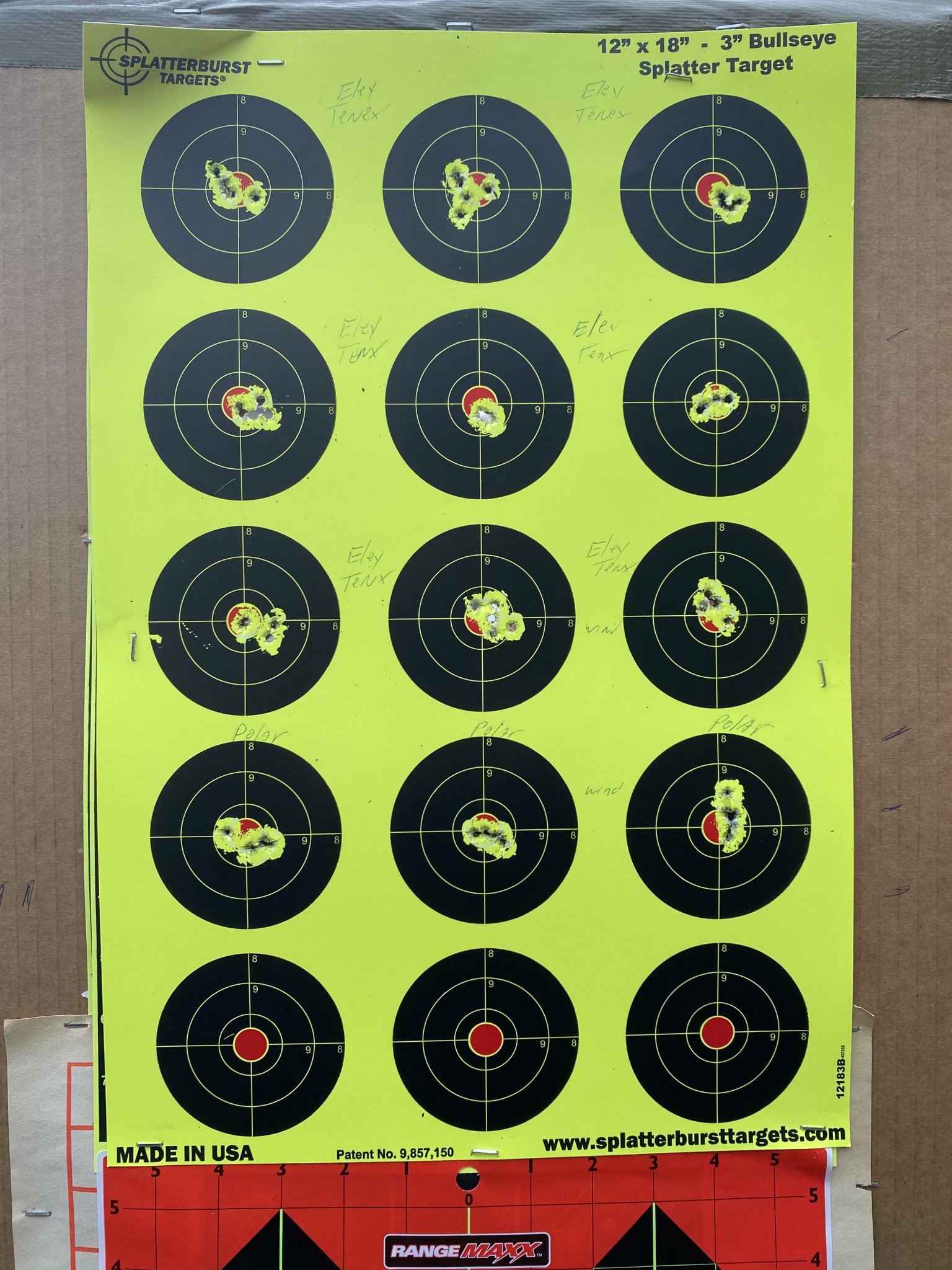

I have found with testing a lot of custom rifles and a lot of ammo over the years that the ammo I listed will net the best results in most every rifle. I have very rarely found RWS R-50 or R-100 hang with those I listed. That said for some reason Eley Tenex is usually the fastest of the bunch, rarely do you find a lot of Tenex that is below 1060fps. I have never seen any high velocity ammo shoot anywhere close to subsonic match ammo.
With all that said, just test proven match ammo based on down range results not FPS. Record the FPS of the ammo you test if you have a reliable method of measuring it or simply record what the manufacturers list that specific lot as (but keep in mind the actual may be slightly different in your barrel) to use as a reference when making your next purchase or changing brands as a starting point.

I find this all fascinating. I’m new to rimfire and sighted in my new Anschutz 1761. Then I tried shooting some different ammos back to back. I shot in order, Eley Club, RWS50, Eley Tenx, Lapua Polar. The wind was pretty strong so I’m sure that I can do better in better conditions but I had no idea there was a process to testing and evaluating different ammos. I guess that I’ll have to read up on the how to’s and start all over again. Oh well, more range time.
