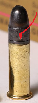

    So I got a new barrel for my Tikka T1X bolt action and I was trying to figure out if I'm headspacing correctly. I have a tight Winchester 52D chamber and I can't even push a round in my hand, so I basically would put the barrel in, tighten it down, and cycle the bolt, see if there's a gap, and rinse and repeat. Initially it was really hard to push the bolt all the way forward so I could close it, so I undid everything and tried to loosen up the headspace a bit. It was easier to cycle the bolt, but then I was getting light strikes and 50% of my shots wouldn't fire. So I lessened the headspace.
    I've shot 350 rounds through it now, and 0 failures for feeding, firing, or ejecting. But cycling the bolt does take some oomph. I need to make sure I push forward with enough force to get the bullet seated. Otherwise the bolt isn't far enough to allow for it to close. Shooting prone is okay, I just put a little more effort, and I can get back on target pretty quickly. I went to a bench, and without gripping bipod legs that I had in prone, it was a bit harder to chamber a round. I worry that this will most likely affect me during positional and barricade shooting, I also don't know how much of it is headspacing issue, versus just a tight match chamber. I saw someone with a brand new anschutz and they had a very similar experience where they had to put a bit more effort into loading the round.
    I inspected all the ejected rounds, and I didn't notice any rims "crushed". I did notice that sometimes feeding I could tell the bottom of the bullet, right where it meets the brass, and has those lines, like where the red is, right around there gets scraped on the barrel.

    Ideally the rounds should be engraved by the rifling. That is what you are probably seeing. It should also have a minimal amount of side to side movement.

    On a .22 LR, the nominal SAAMI headspace dimension is .043. This is the dimension from the bolt face to the surface of the barrel that the cartridge rim contacts. In order to set or check headspace on a .22LR or any rimmed cartridge chamber, you must have at least one or preferably a set of headspace gauges.
    In a .22LR chamber, headspace has nothing to do with how much the bullet engraves, this is typically determined by the dimensions of the reamer used to cut the chamber. You indicate that your barrel has a Winchester 52D chamber. If you look at a list of .22LR chamber dimensions, you will find that the 52D chamber is probably the shortest one listed, this worked in a 52 because they have a lot of closing cam. In an action with less closing cam, you will need to push the bolt forward to push the bullet into the throat far enough to get the locking lugs to what ever closing cam it has. I will also point out here that the cartridge base to forward driving band dimension varies quite a bit between the different ammo brands. Hope you find this helpful.
