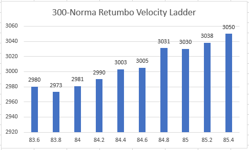

    Just came back from the range after exercising my new MPA 300 Norma rifle. This velocity ladder was just too pretty not to share. Next steps are really obvious, with SD/Group testing planned at 84.5gr and 84.9. The last shot at 3050 ft/sec gave me the first hint of a heavy bolt, so I feel like I'm right in the sweet spot I was looking for.

    How many shots were taken at each charge weight, to generate the bars? Thanks.
    Good speeds, I can't push 230 Berger's any faster than 2950 fps before encountering pressure with 85.0 grains Retumbo.
    I wouldn't read too much into data from 10-shot ladders though.

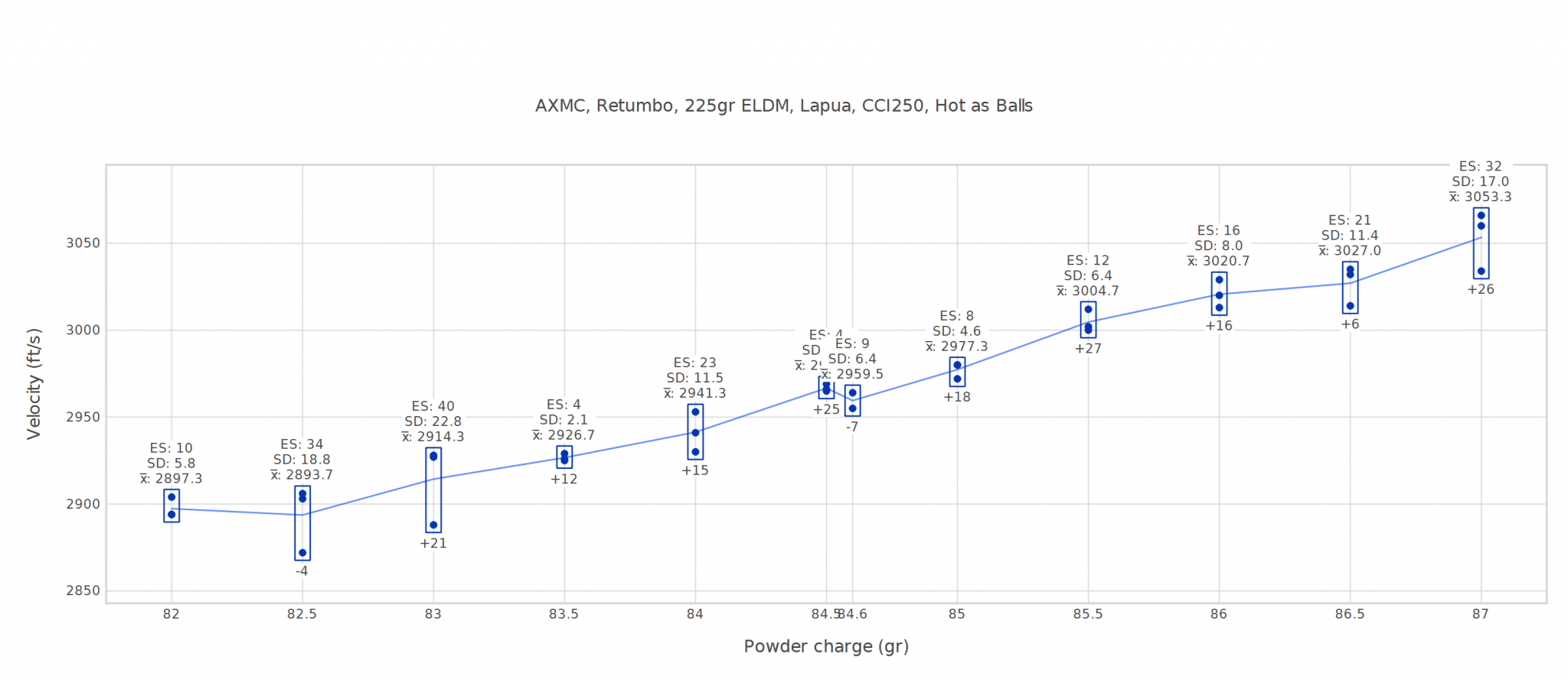

    Same on this end. I got 3040 FPS (27") with 225 ELDM's and 86 grains. I had heavy bolt lift.
    I don't read any more into it than it shows.
    • 10 shots at .2 increments
    • Gradual and predictable increase in velocity
    • No pressure signs early
    • Last shot showed pressure
    • Two flat spots to investigate further
    Why do you say this ... I'm curious. Would you have done 20 shots? Used larger or smaller increments? Interpreted the result differently? Do you think ladder tests of any kind are unreliable?
    I've noticed a common statement in this forum is "You can't trust 10-shot ladder tests" ... but my findings actually indicate they're good prognosticators for next steps in the load development process.
    My question back to you is ... What would you have done instead of this, to figure out next steps in your load development process?

    Load up a few identical ladders, and see if those so-called "flat spots" still exist.
    Ladders are great for getting an idea of approximate velocity and where pressure may be found. I perform ladders as well, for those two purposes.
    However, you may find those "flat spots" don't really exist...
    Understood ... BUT ... "IF" I load 10 rounds to a flat spot and get single-digit SD's and tight groups ... should I stop, or keep looking? I get what you're saying, but in our world of limited supplies and expensive components, knowing when to declare victory is important too. I've decided to load 10 rounds at 84.5 with Retumbo, and see if that 3000 ft/sec is (a) real, and (b) consistent. An SD of "5.0" with tight groups is usually my target. If I can get there, I load more, and test at distance (1,000 yards). If none of that works, I'll go back and try another ladder, or possibly different components. It's not a destination ... it's a journey ... right? At the end of the testing, I want this to be my 1-mile competition rifle load.
    Reactions: kthomas
    SD of 5 is great. If that's what you get, rock on.
    Honestly, these days it's hard to load bad ammo with quality components and reloading gear, using a repeatable process.
    My point is that we try to look for conclusions in small data sets that don't actually exist. There probably isn't much of a difference between any of the charge weights, SD wise.
    In all reality, there isn't probably any real velocity "nodes" or flat spots when compared to other charge weights you tested.

    You won't find any so-called "nodes" with a ladder test.
    But don't take my word for it, try it for yourself. Load up 2 or 3 identical ladders and see if any "nodes" found in the first ladder repeat in the other ladders.
    If you want single digit SD's, all you need is a repeatable reloading process with good quality equipment and components.
    I don't need any load development to develop a load that has an SD of around 5.

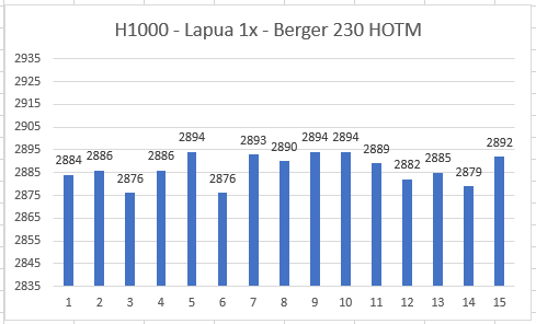

    Just finished ladder test with a 26" Proof. Settled on 84.5 grains. Had several groups in the 85.5gr area in the sub .200" MOA but was getting a click so I backed it off. I'll verify the loads in the morning but don't think too much will change at distance.
    OK ... now you've officially got me "curious". I'm going to reproduce that ladder exactly as before, and see what happens.
    sorry to revive an older thread .. but my curiosity is getting to me.
    Rusty, did you redo the ladder to see if you replicated the previous findings?

    I did try it, and the result was actually more pressure signs at the lower numbers. Decided to go in a slightly different direction and build a ladder with H1000 instead of Retumbo. The results were good, and two ladders in a row pointed me to around 79.2 grains of H1000 for velocities around 2900 and really nice SD's and tight groups. Here's 15 that I shot last month before the weather got ugly. Average velocity of 2884 and a SD of 6.35. Next range day I'll go out to 1400 yards and see how the BC holds up ... at 200 yards the BC calculated to .337 (manufacturer's BC is .364).
    Using ladders now to find good spots to settle on powder charge and test "other stuff" mostly around neck tension and seating force.
    I've also just today received my new AMP Press (Woohoo), so I'll be able to get more precision and consistency around bullet seating ... so that's on the agenda too. Just need more good weather range days, and fewer honey-do list items.
