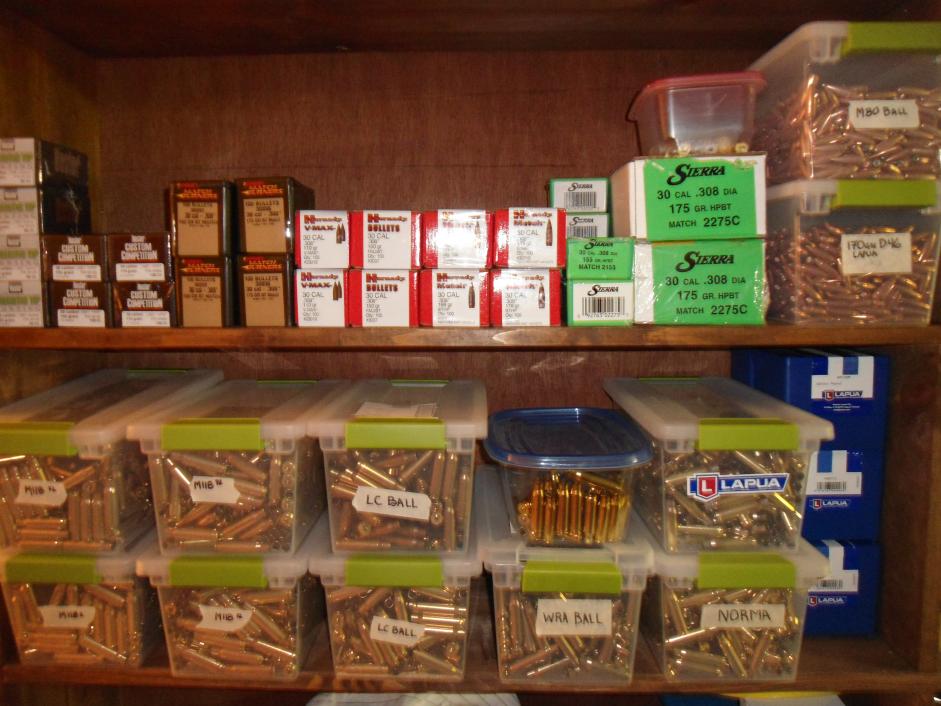

Well for someone still using the old bullets, thought you might like this one. Note the bottom bullet box on the right. Brass is markedDSC01098.jpg
You mean D46 with rebated boat tail? Never tried them (185gr scenar/170gr lockbase are my primary two bullets) but as far as i know they are mostly not in stock so you either have a stash or its easier to get Scenars.
