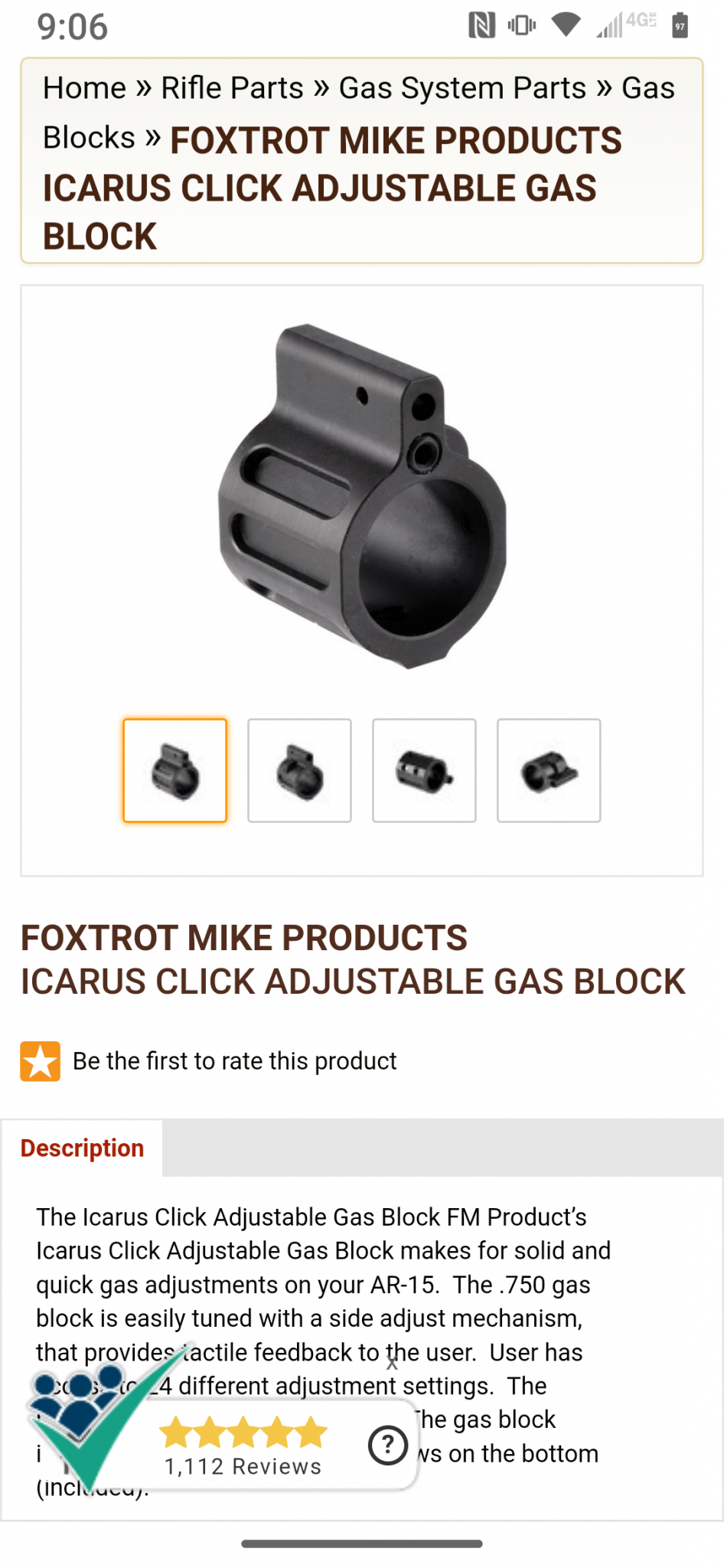

    If you get a chance gives this one a go it has a super low profile, most AGBs carbon lock after a few hundred rounds as you know and I have yet to have one of these lock up or get stiff on me, the detents stay strong and tactile and the clicker is adjustable too

    I have superlative arms on most of my rifles but I have also gone back to restrictive mode and started buying the more basic adjustable gas blocks again for that very reason.
    I just wish they made one in .875
    Damn, those are priced really well too.
    Reactions: bigjake83
    @bigjake83 I'll keep those in mind next time I'm in the market. I didn't know FM was making an AGB but all of their other products I've seen have been fairly well thought out and very reasonably priced.
