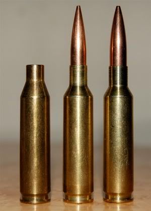

Very cool! Coupled with my work on the 6mm Super LR, I also made up the 6.5 Super LR that's a little bit different than yours. Mine has the same body and head space as the 6mm Super LR that's on our 6mmAR.com website and winds up with a .329" long neck. I never published much on it yet because I did not have as much testing time with it as I wanted, but it is definitely a viable cartridge and shoots real well.
On left is a .243 Win case, next to a 6mm Super LR cartridge (Center) and followed by a 6.5 Super LR (Right).
With the current batch of 6mm Super LR dies I have was thinking I could modify one (open up the through hole below where the bushing sits) and use it with a larger bushing. This seems like it would not be a hard modification to make the dies I have work for it. It would also need a 6.5 mm expander button (inexpensive part) and the right size bushing and you would be good to go.

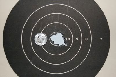

Here's a 10 shot target at 100 yards (prone with a sling) with the 6.5 Super LR with 44.7 gr. of N160, Russian Primers and Berger 130 gr VLD's in the lands .012". First time at 600 yards with this I shot a 199/16x (i.e. lost one point to winds but hammered the x ring pretty well even so).
For the sizing die now I am using an original 6XC die Tubb used to sell held up off the shell holder .120", with one of the neck/shoulder bushings he sells that we opened up to re-size the 6.5 mm brass (instead of 6mm).
