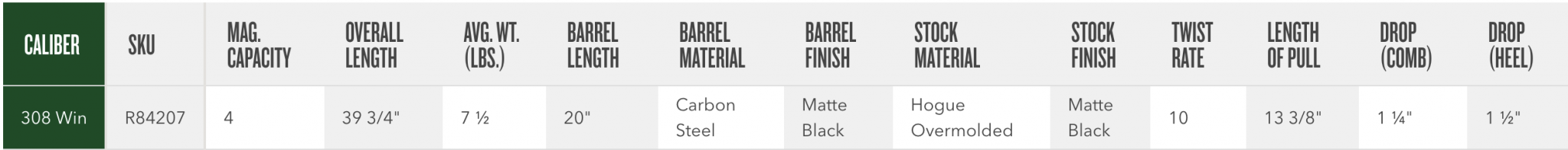

Hopefully this fits your need...(multiple sources contain same info, in my quick research).
I have a new manufacture 700 SPS Tactical 308 with the "RA" prefix and I can't find the twist rate to save my life. It's not on the barrel, factory packaging or Remingtons website.
Also, I noticed while trying to find twist rate that their site says the SPS Tactical has 5R rifling now. I thought that was reserved for the more expensive models? Maybe it's a typo, who knows.
Does anyone know what the twist in these are? I'm hoping it's faster than 1:12 as I have a couple cases of factory 180gr Fusions that probably won't shoot too well
When Remington reopened their door under Vista Outdoors ownership, they made some MAJOR updates to every rifle model and cartridge. They updated twist rates to modern twist rates, and they started using 5R rifling on every rifle now.

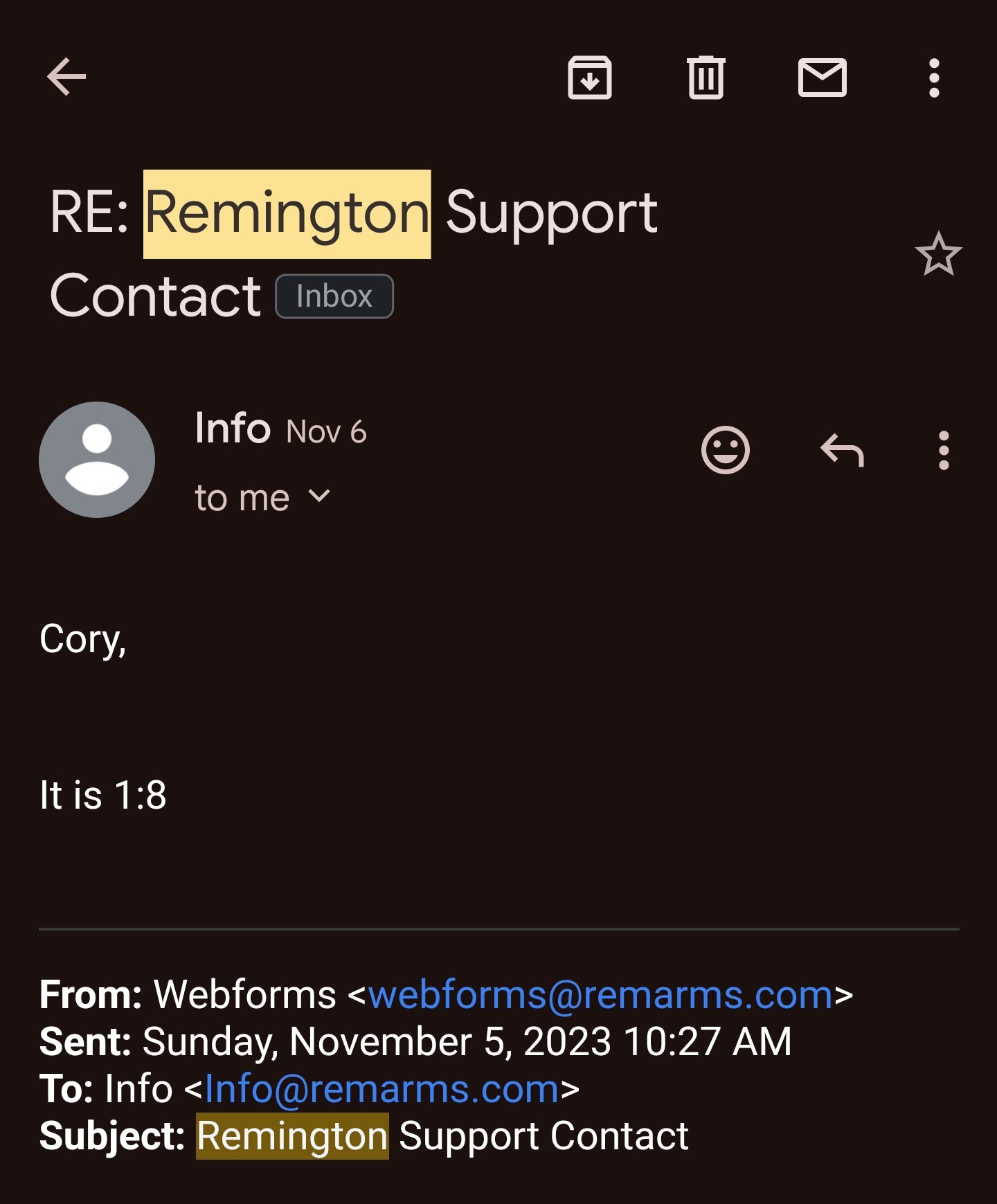

A couple days after I made this thread I got a response from Remington customer service and this was their response. For some reason I don't think this is correct 🤔
I note that the Remy info does not state the steel type, and whether the barrel is button rifled or hammer forged. It's like a State secret or something.
From everything I have seen, all the new Rem Arms barrels are cold hammer forged (unless specified) Chrome-Moly steel or 416r stainless, and all have 5R rifling, and updated modern twist rates.

If it has a modern twist rate and says 5R on it, then it’s a new model. If not, then it was probably a NOS still sitting around in someone’s inventory.
It doesn't say twist rate or the type of rifling on it. Came with the X Mark Pro trigger but has a Super 700 now
