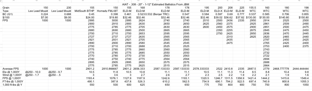

Picture below is some estimated 20” velocities based on information gathered here in the reloading depot. The ballistic data is using JBM outputs using the average velocity at sea level with default atmospheric conditions. Prices are from Midsouthshooters.com and the WTC Flatlines are from their site. I did not include Berger and Sierra offerings in the data because I thing the Hornady projectiles offer greater BC per penny spent across the board until you step up to the WTC Flatlines.
From what I can see here and using the berger twist rate calculator, the 155 grain ELD-M gives better to best results with the 1-12” twist from a factory AI barrel. Personally, I’ll after I burn out the factory barrel, I’ll go with a 1-9” to use the 225 ELD-M and 180/198 WTC Flatlines.
I include cast bullets on here because I’d like to use those as a trainer barrel because AI does not offer .223 bolt faces. Probably cast after I burn out my factory AI barrel. Buy a 1-9” for the ELD-Ms and a 1-10” for cast. Run a 230 Lee casted bullet at 1050fps and never wear out the barrel for some solid and cheap practice under 250 yards.
Anyways, if you buy ANY AI rifle, its a sound decision. If you only want to shoot .308 or its offspring and do not need or want the features of the AIAX, buy the AIAT and save 3-3.5k.
