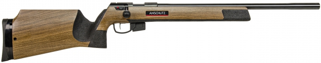

1761 MSR
Technical data sheet
All technical data
Total length (cm):​
95​
Total weight (kg):​
4.0​
Barreled Action
Bolt throw :​
60​
Locking:​
Three locking lug mechanism​
Finsih of the reciever:​
QPQ-Coating​
Trigger
Type:​
Druckpunktabzug 5061 Light​
Version:​
right​
Color of the trigger shoe:​
Silver​
Safety:​
Sliding safety catch​
Trigger weight, adjusted (g):​
300​
Adjustment of the trigger weight (mm):​
250 - 450​
Barrel
Material:​
Steel​
Finish:​
blued​
Caliber:​
.22 l.r.​
Length of twist (mm):​
420​
Number of grooves:​
8​
Muzzle diameter (mm):​
22​
Barrel length (mm):​
544​
Sight set
Stock
Aluminuim grooved rail on the lower side:​
yes​
Version:​
right​
Length of stock (mm):​
780​
Weight (g):​
1900​
Material:​
Walnut​
Stippled checkering:​
yes​
Stock type:​
MS R​
Stock finish:​
laquered​
Butt plate:​
Rubber butt plate​
Length of pull (mm):​
330​
Prepared for claming element:​
yes​

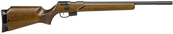

1761 HB MPR
All technical data
Total length (cm):​
97​
Total weight (kg):​
3.5​
Barreled Action
Bolt throw :​
60​
Locking:​
QPQ-Coating​
Trigger
Type:​
Version:​
right​
Silver​
Safety:​
300​
250 - 450​
Barrel
Material:​
Steel​
Finish:​
blued​
Caliber:​
.22 l.r.​
420​
Number of grooves:​
8​
22​
544​
Sight set
Stock
yes​
Version:​
right​
760​
Weight (g):​
1500​
Material:​
Hardwood​
yes​
Stock type:​
MP R​
Stock finish:​
gebeizt​
Butt plate:​
Rubber butt plate​
360​
yes​

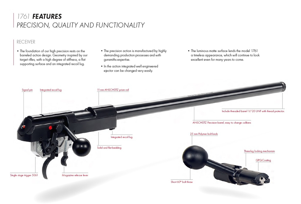

Not 64 or 54, totally new action. I've read they are round on top with flat bottoms. Price looks decent for a new Anschutz! I'll be looking forward to reading some reviews, hopefully they will pop up soon.
Reactions: Merlin O
Improved and stiffer replacement for the 64 action...? A CZ 457 comparable action (or better) 3 lug bolt, comes with a great trigger and a superb barrel.... Looks like a really nice overall stock configuration for playing on the MSR version too. Looks like the trigger starts a 10.5 oz and goes to ~1lb. The trigger shows to also come in a 2 stage version...

Action was presented last year on IWA so its in production for a year so no now and honestly having handled it its not any better than 64 its just tailored for quick caliber change , i am actualy not a fan of quick change barrel systems used in RF actions lately , most designs are not beneficial to accuracy ,not by a long shot.
Don't get me wrong 3 lug bolt and reciever seem to be at least as good as 64 if not better but quick change barrel is not.
bild.php5
At present i woudn't realy bet on this new action being an improvment.

Its actualy much better system than that used in CZ , here there are two U pieces with set screws that act like a clamp on the barrel groove but still ,i am not a fan of such systems . I would greatly prefer the reciever to be threaded.
Rest , like the bolt and reciver , are definetly a step up. Its a stout reciever design , three lug mid bolt locking, lugs seem to have both closing and extraction cam cut on the lugs ,cocking should be smoother due to roller on the cocking piece but is not that much due to smaller bolt and shorter bolt handle.
