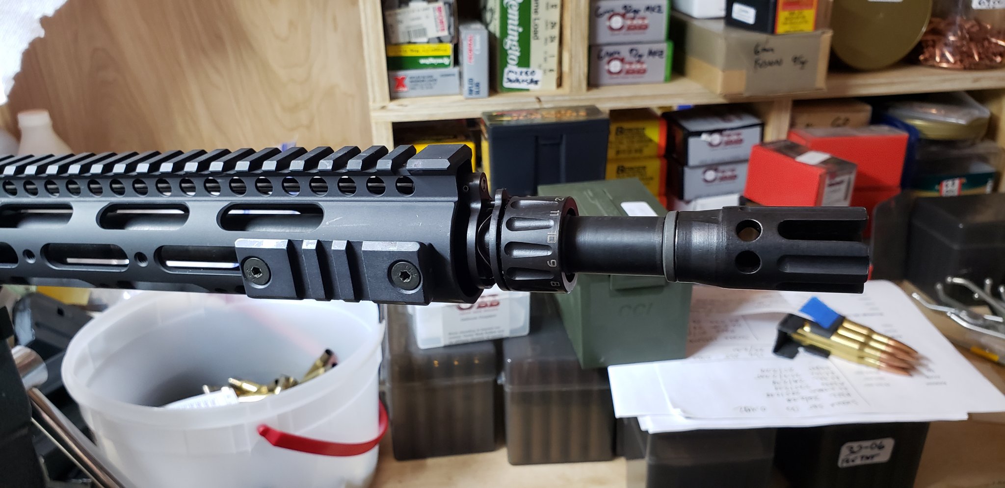

    Hog hunting, hmm. I built a 6.8 SPC with a 12.5" ARP barrel and Aero Precision M4E1 upper and lower. I put the Adams Arms Piston system in it. Note that you MUST get the threaded standard version of the upper that uses mil spec barrel nut for that AA system to fit. It's mid length gas and I used AA light weight carrier. Then I put a Troy SOCC 10.5" rail on it, fits beautiful. Needs just a little dremeling to expand 1 mlok slot so you can tighten 1 of the Piston block screws. Easy peasy 5 min job.
