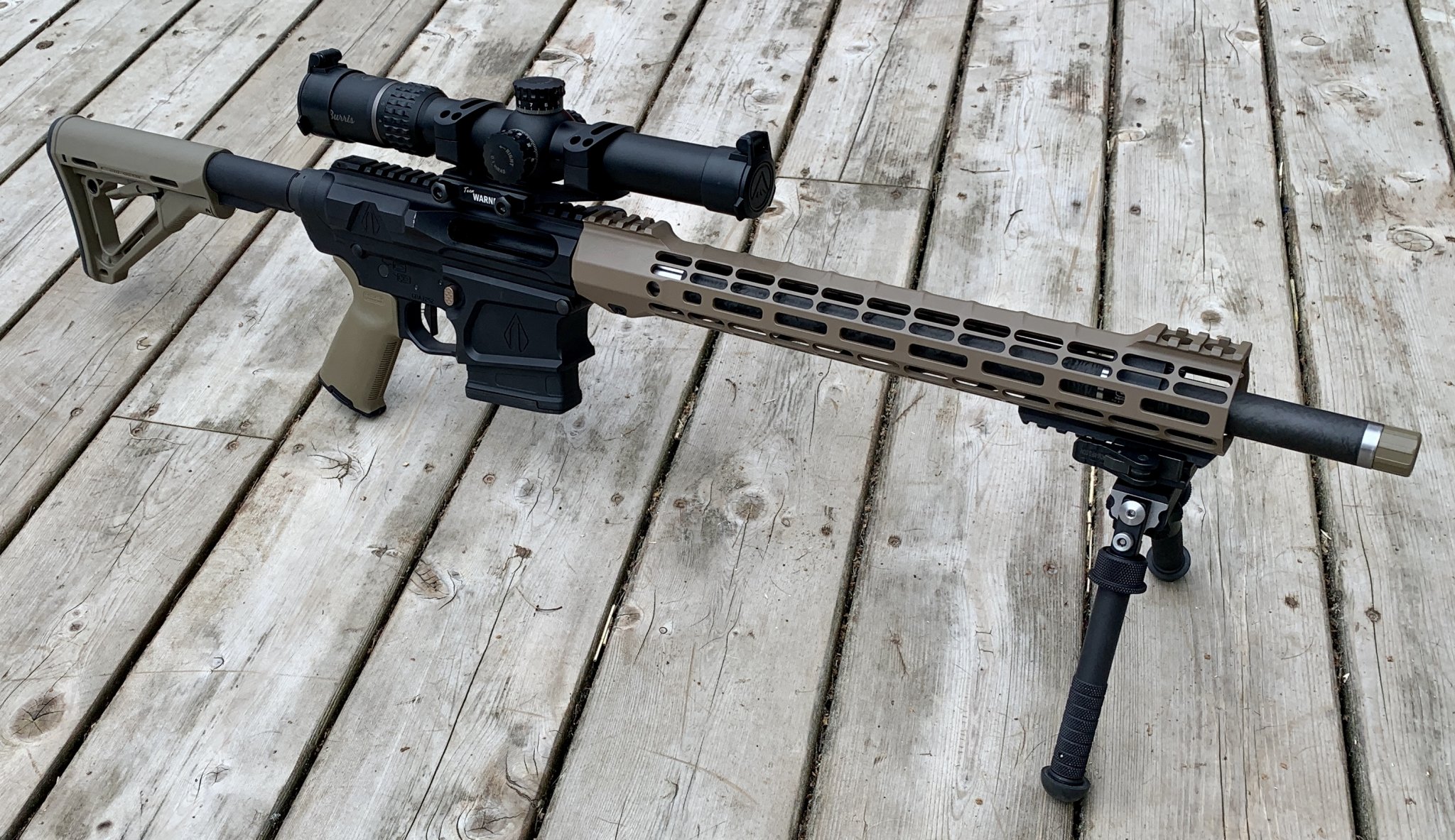

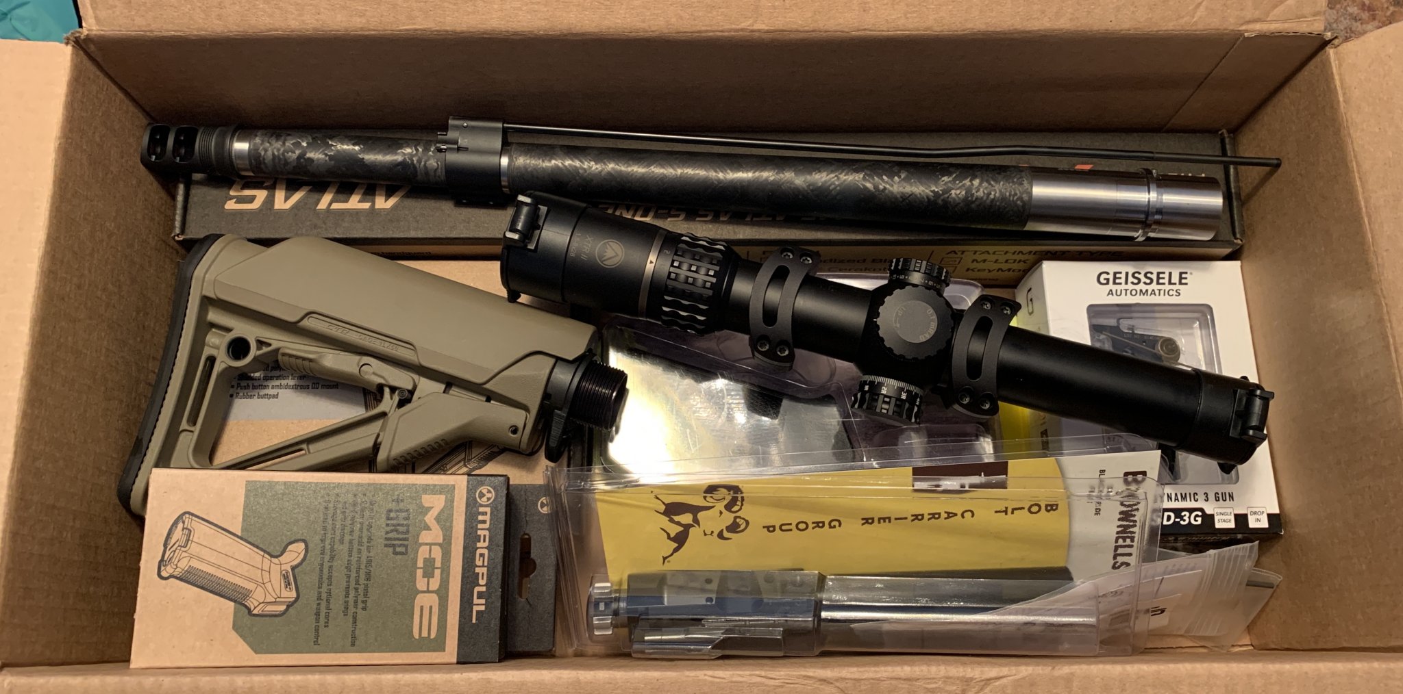

I’m putting together the parts for an AR10 build.
Gibbz side charging upper/lower set
Proof 18” carbon fiber barrel
Magpul moe+ grip and CTR stock w/ 1/2” riser
Giesselle SD3G trigger
Superlative arms adjustable gas block
Brownells DPMS style bolt carrier group w/jp bolt
Aero m5 handguard
I’m going to mount a Burris XTRII 1.5-8 on it.
I’m actually building the rifle around the optic, I had it on a 450 bushmaster but didn’t seem worthy of the scope.
Anything I’m missing? Parts should start arriving this week.
Buffer system is all I am not seeing here. Just make sure you get a full mass system. Proof barrels can be finicky with silent capture systems.
Muzzle device.

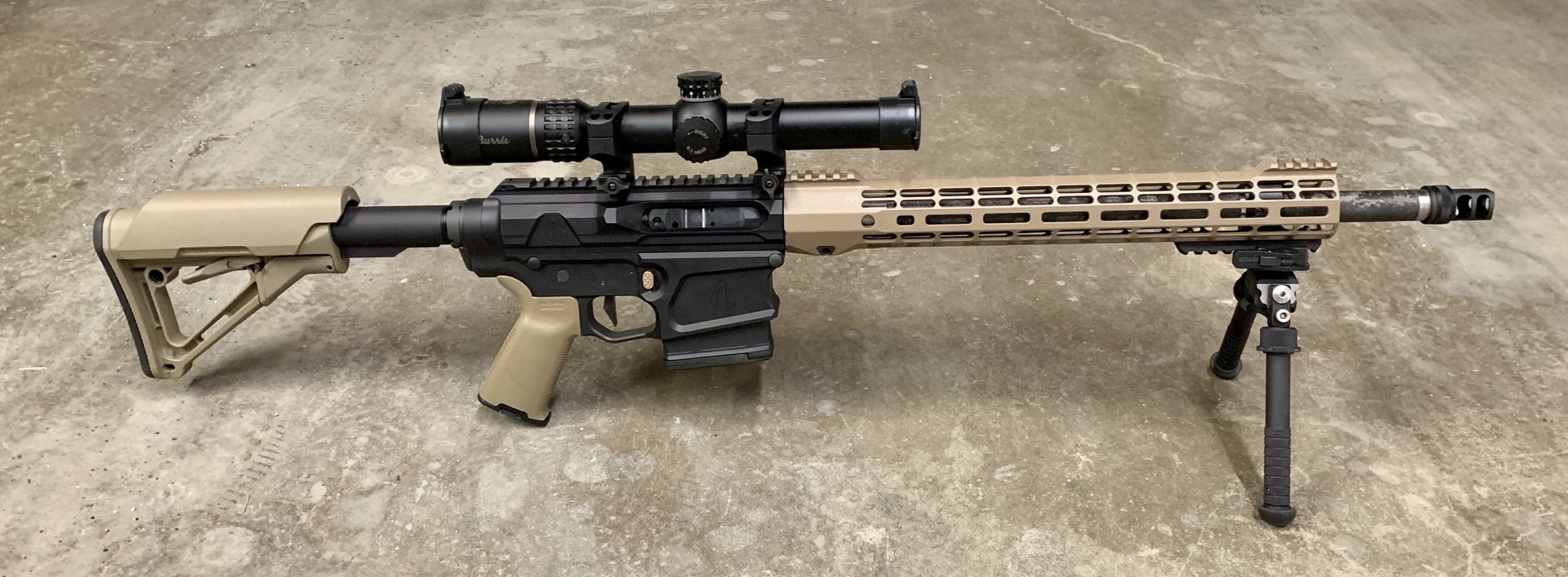

Well it’s accurate but it not cycling. It’s short stroking. It’s only ejecting 20% and not picking another round up.
I picked up another non adjustable gas block to try out, I also grabbed a couple different buffer weights and a lighter buffer spring to try.
I’m wishing I had gone with the jp lightweight bolt carrier.
I’m guessing it’s undergassed but I really don’t want to go drilling bigger ports in the proof barrel if I don’t have to.
Any ideas?

New gas block and lighter buffer has it running correctly.
Nice.
Its a rarity to have a Large Frame AR be under gassed.
After it fully breaks in, you might try the SA Adj. GB / heavier buffer again.
Start with the buffer first since that is easiest.
( That is how rare a Large frame AR being under-gassed is to me ! Lol )
The only down side was if I used my suppressor it was way over gassed and sprayed gas into your face, if adjusted down to limit that it would short stroke without the suppressor.
I decided to just run this one sans suppressor.
Accuracy isn’t quite what I expected from a proof barrel. The best accuracy I have gotten was with 175gr federal gold metal match, averaging just under 1” for 5 shots st 100 yards. Several other loads run in the 1.25-1.75” for 5 shots.
The one happy note is that everything from 147gr ball, 150 fusions, 155 Hornady HPBT, 168 SMK and Hornady HPBT, and 175gr SMK all print into a 2.5” group right to the same basic POI.
Any ideas to wring out a bit more accuracy?

Accuracy wise.. try shooting off a bag ( I shoot much better off a bag than a bipod.. )
Let the barrel break in more.. try 168gr FGMM, Hornady 155gr Amer. Gunner.
Did you try lapping the upper receiver face ?
Make triple sure all of the scope mount screws are torqued correctly / fully.
Make sure the gas tube can freely go through the upper.. as in, rattle is good through the upper.
Upper to lower snug enough ?
Make sure the hand guard is slightly off of the upper.. a little gap is better then a tight fit .
And ample room around the GB and inside of the free float handguard... if the GB is bonking the handguard.. that is bad.
