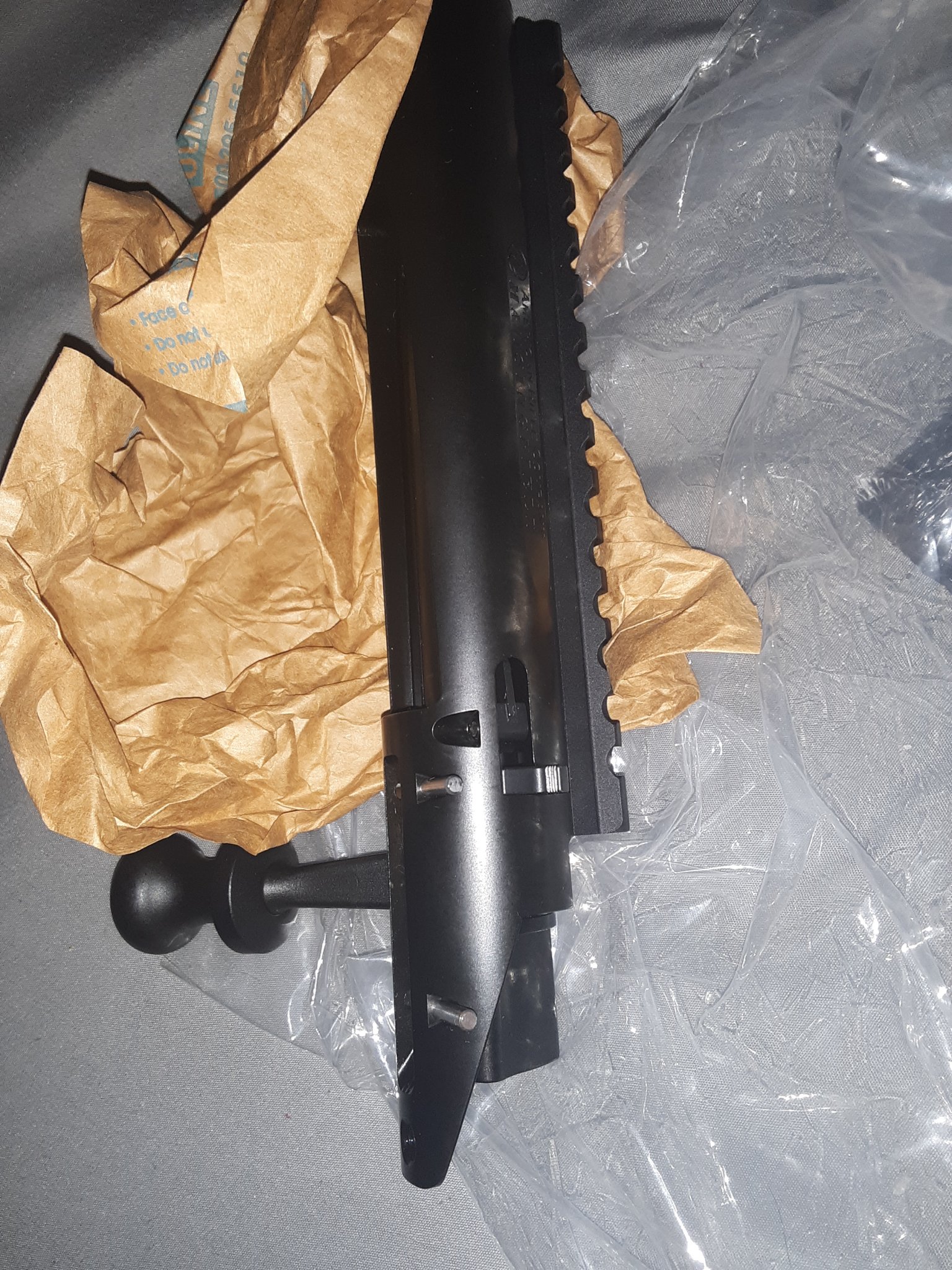

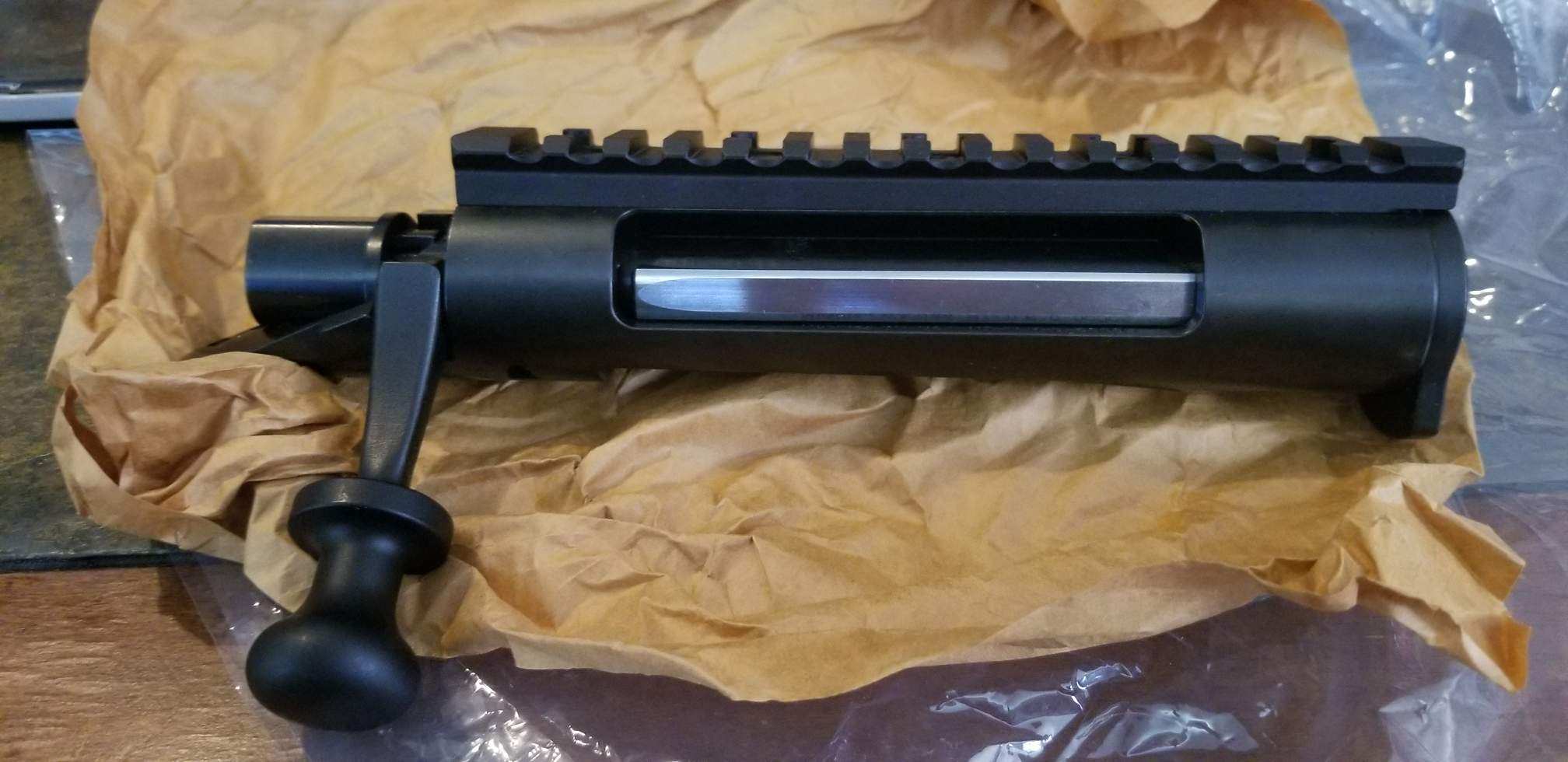

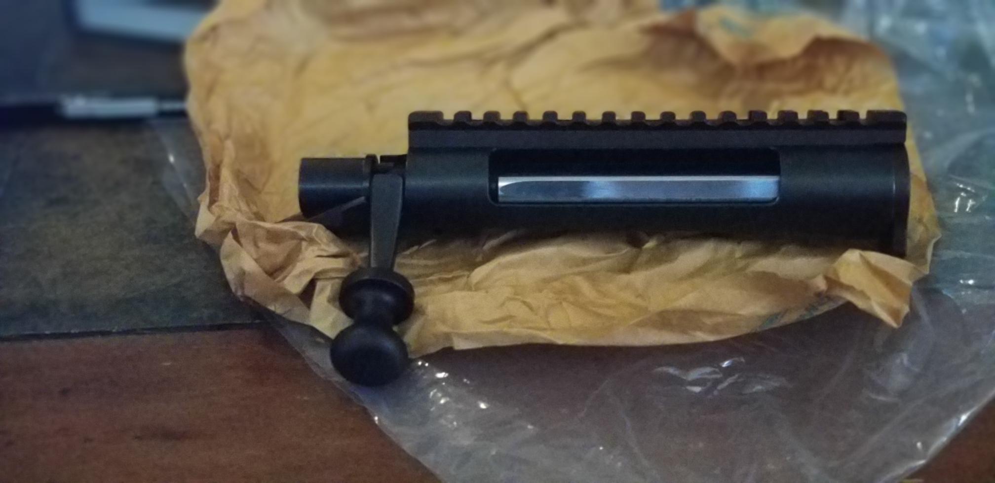

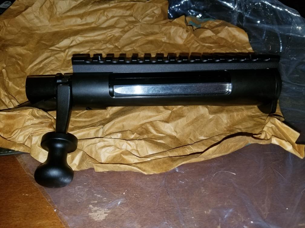

I've gotten my hands on the closed top ARC mausingfield, it is made for a detachable mag, and its serial is 00005. I've attached a few pictures to show the ejection port. Also sorry for my potato quality phone. Best I could do today. Build is settled on .300 prc and will order ammo from Hornady. Hopefully more manufacturers catch on and make some good quality like hornady as I dont reload right now.

Bought it straight from ARC. They just released this model as far as I know. M7-TLR-D-00005 is mine. I talked to Jason and he asked if I wanted the closed top like the older ones and if we had enough people thatd I'd get the closed top instead of open top.

Loads of reasons why this isn’t one of the first ones they made; the early ones:
-were in the white; not nitrided
-had the hookah pipe bolt knob with exposed screw head
-had a different bolt stop
Agreed. Early ones looked shiny. I ordered off their site so I knew I'd get the M7
