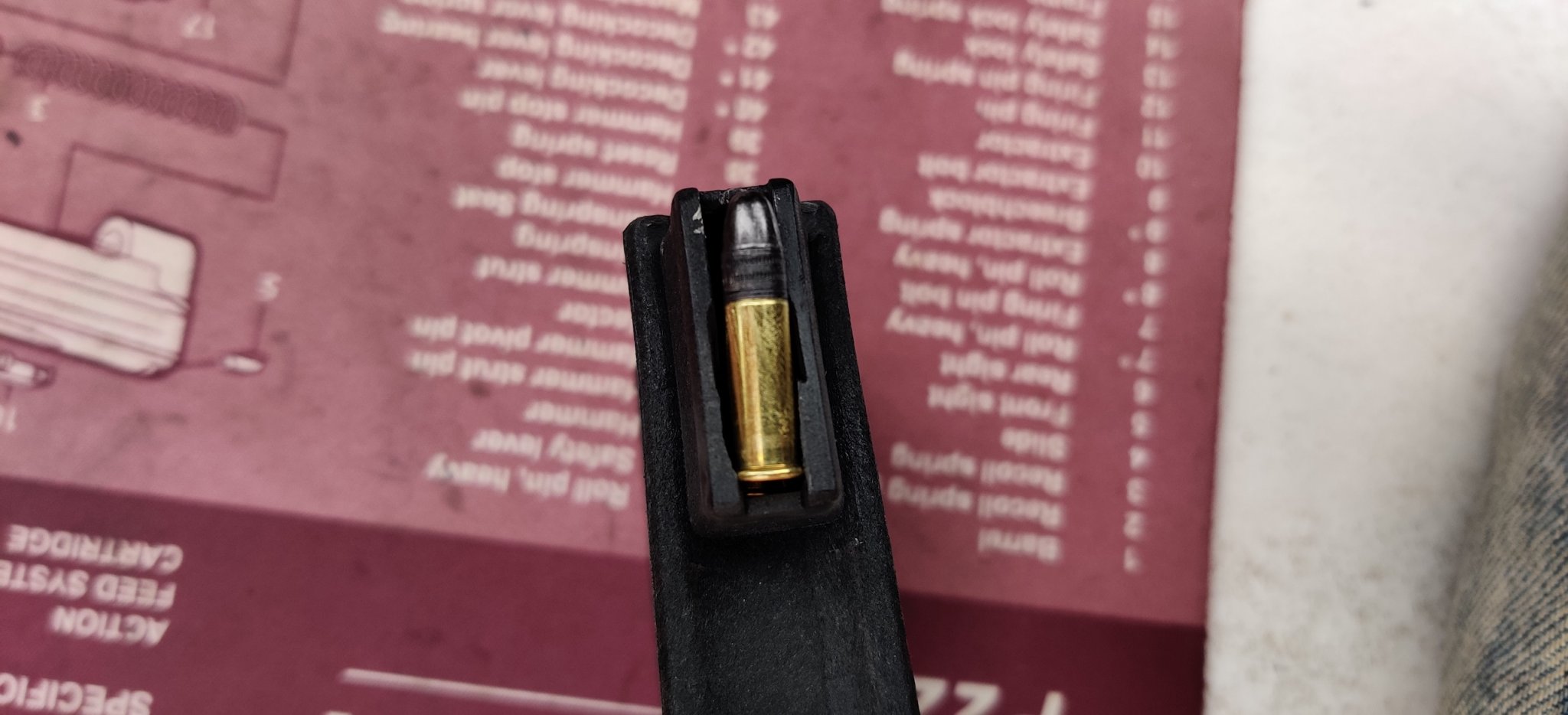

The Bergara Bad, my magazine broke somewhere around the 20th to 30th shot. It did greatly affect feeding by not holding the round in place mostly on the 5th shot. I have never seen nor heard of one breaking like this. I know Bergara will replace it. This did not affect the accuracy because I learned how the bolt needed to be worked, learned on CCI SV. From here we will start with photos with dialog.
You can see the broken section on the left side where the bullet rim is held in place.
I found the broken piece laying on the table.
This is how the ammo was sitting. The rounds were barely held in.
When I inserted a the mag I had to hold my finger in the port to keep the round in place. If I worked the bolt to fast rearward the round on top would tip up. Here's three examples of what I experienced.

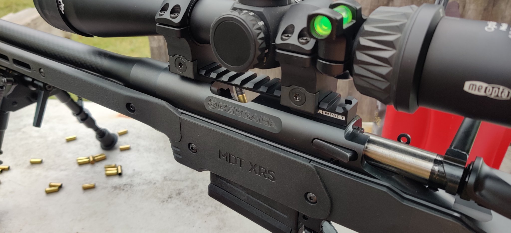

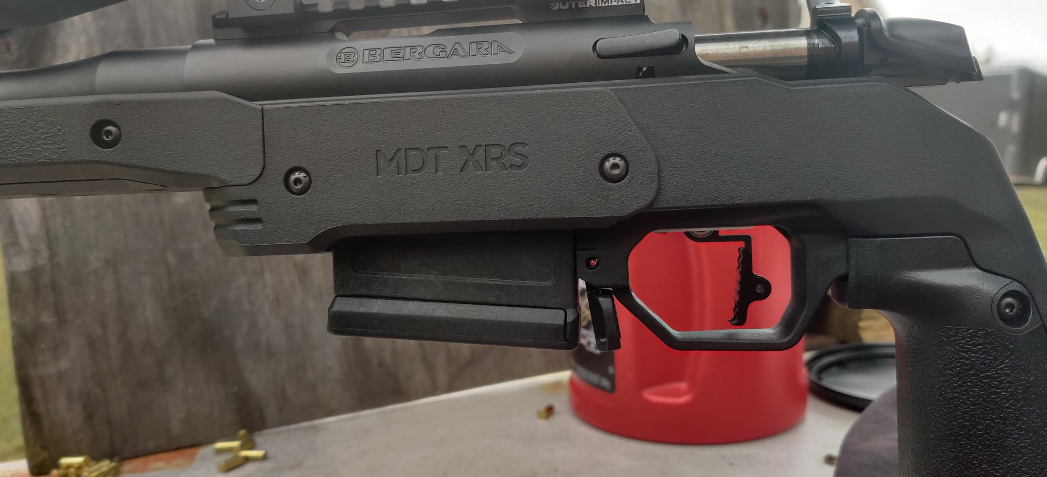

The MDT XRS Bad. I cannot understand why MDT decided to use both standard and metric size bolts. The bolts that hold the grip on is 3/32", the bolts that holds the buttplate on is 4mm. The two action screws are 3/16"! Why?? That's not really a bad thing I guess but irritating somewhat.

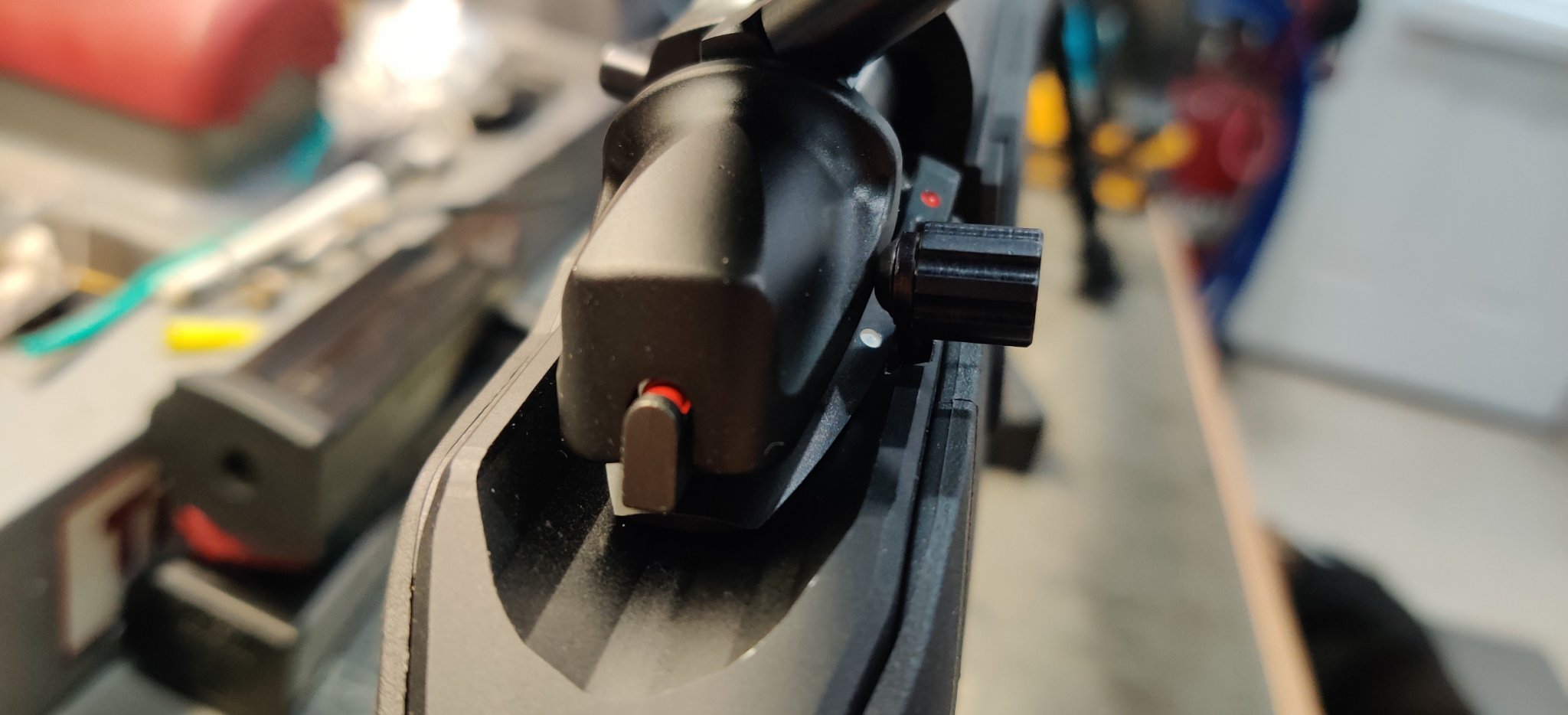

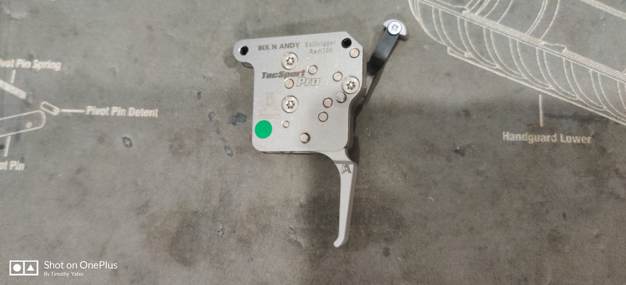

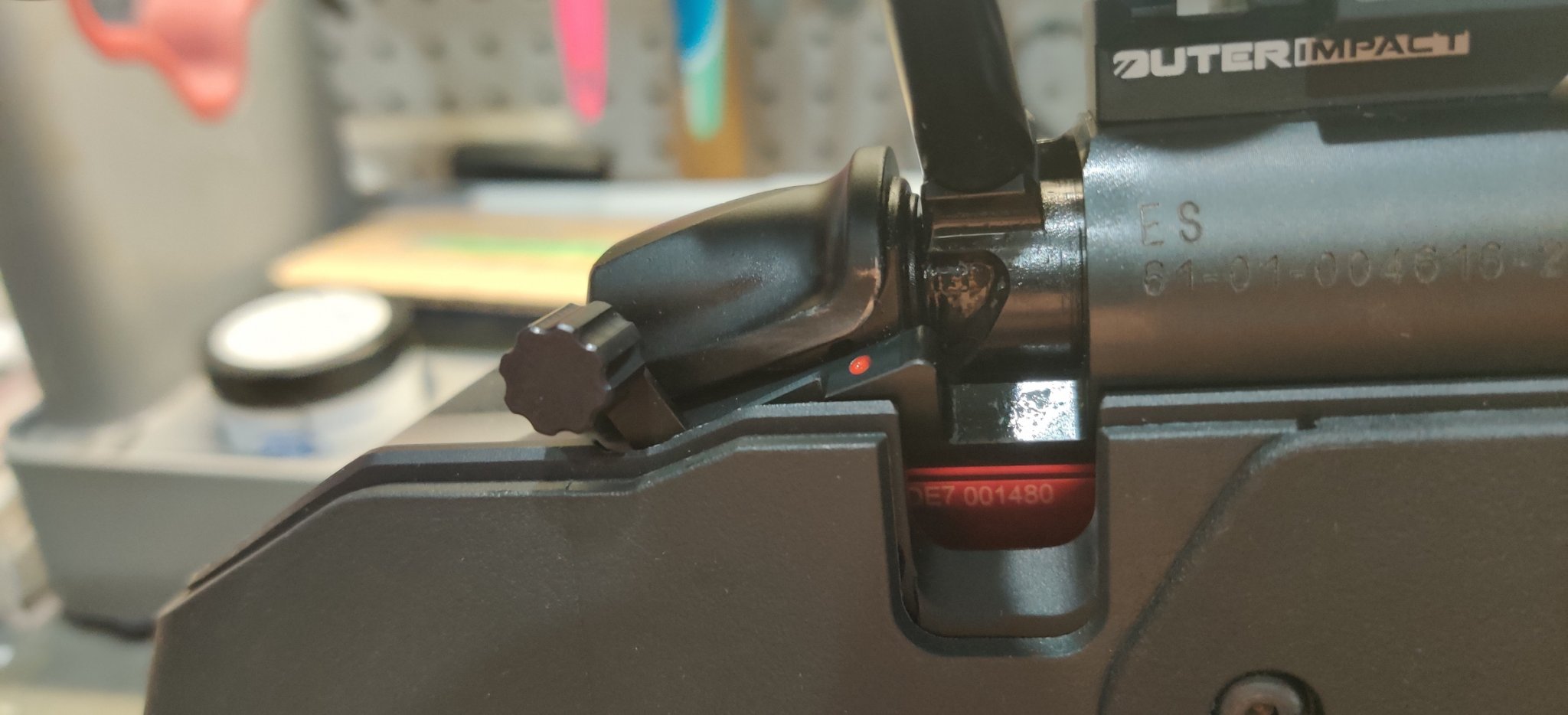

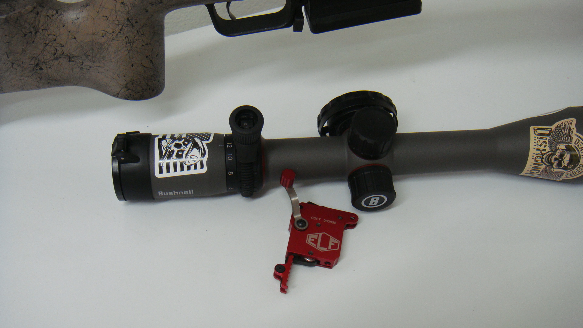

The Elf Trigger Bad. It's the safety lever again. I have one extra "short" lever that Elftmann sent for the 1st Elf trigger. With the short lever the action will not fit in the chassis. When I put the original lever on it hit the bolt shroud just like the first one did. I ended up removing the lever knob because the screw holding it on is what was hitting the shroud. Unless Elftmann has changed this it will be a problem for anyone wanting to use the Elftmann 700 on their B-14R. Without the knob the safety is still easily reached and moved. It's not a problem.
Short trigger. Clears the bolt shroud but not the chassis.
Here is the other lever that someone would receive with the trigger. You can see where it hits the shroud and the lack of clearance.
This is how it looks. Not bad really. It's not a problem for me to not have the knob there.

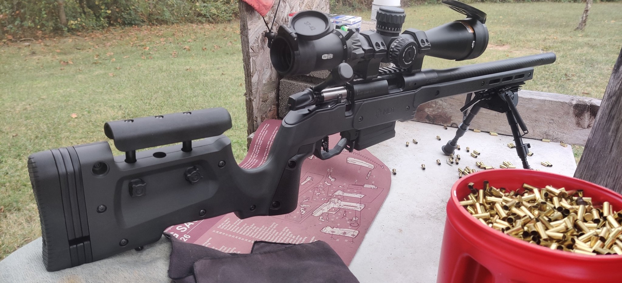

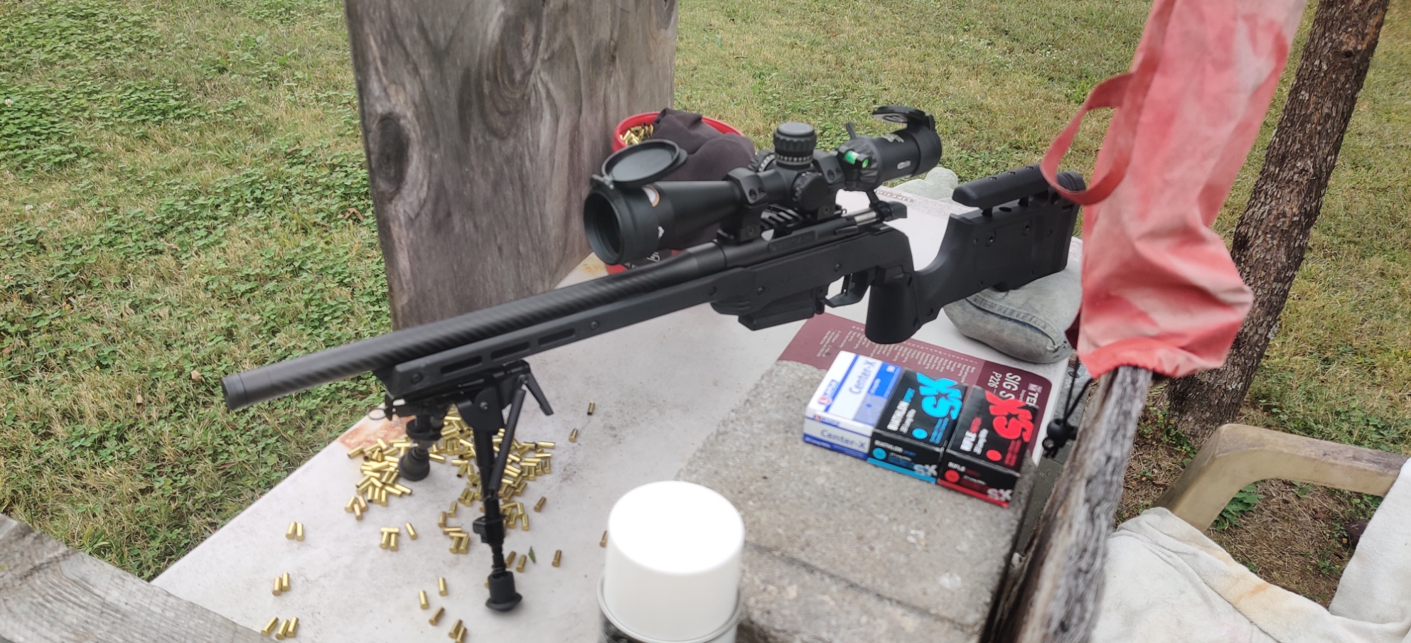

I love the overall look of the rifle. Seems like all the black components are very close to the same shade of black. I have named it...Black Beauty. :love:

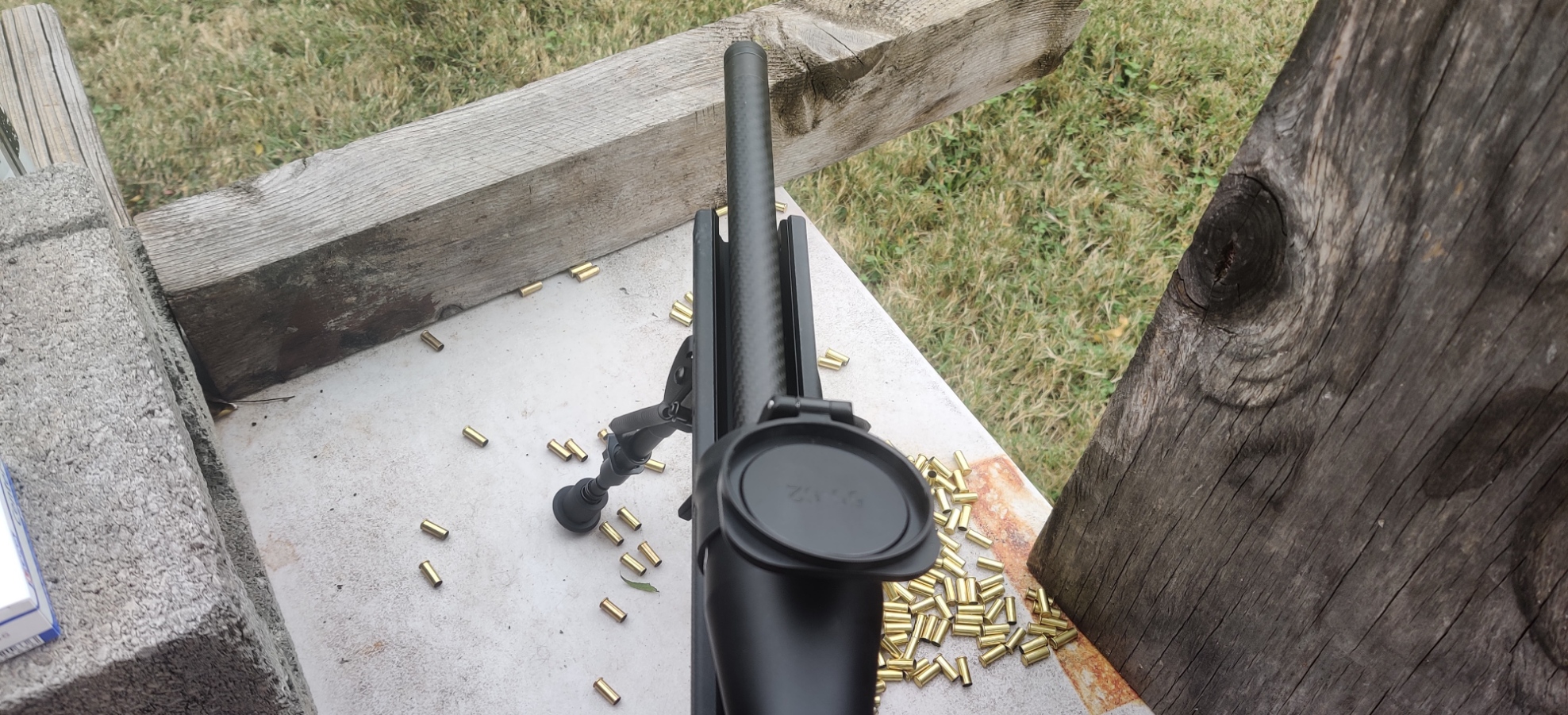

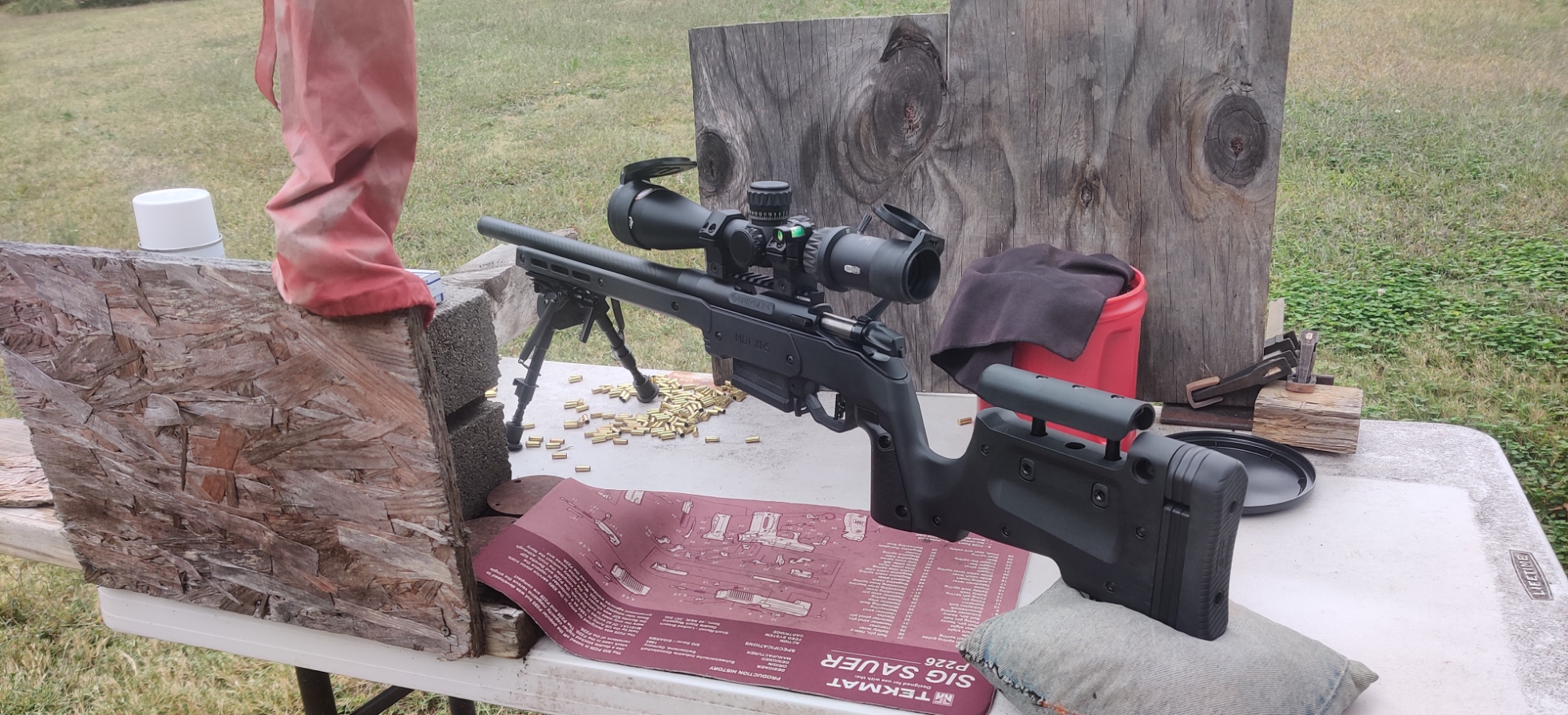

Here I'm trying to show the barrel channel and how much room there is.

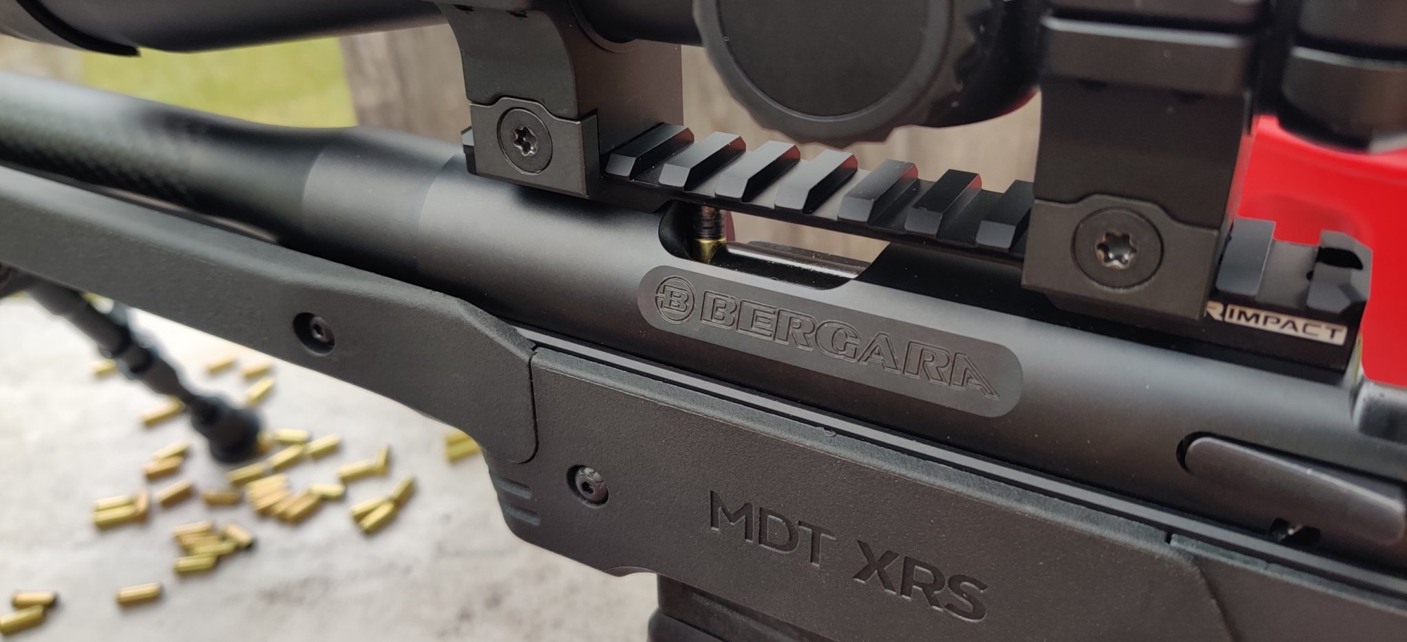

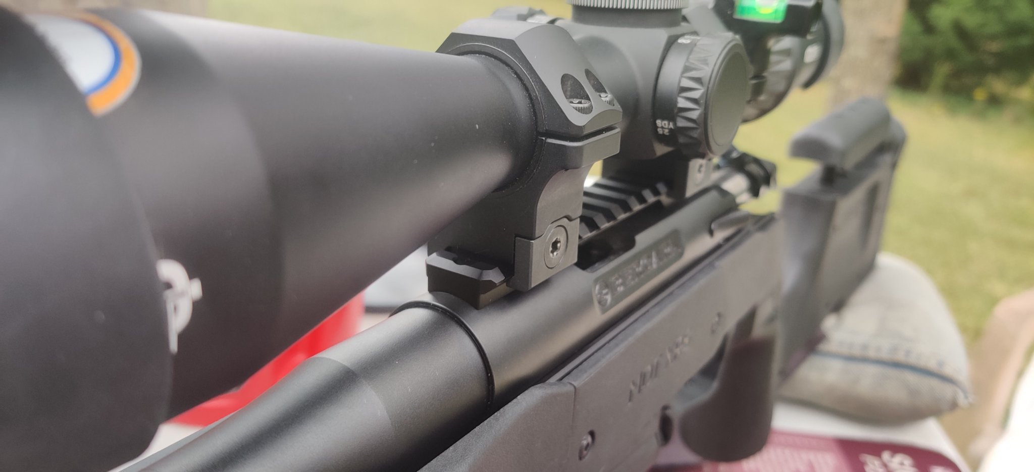

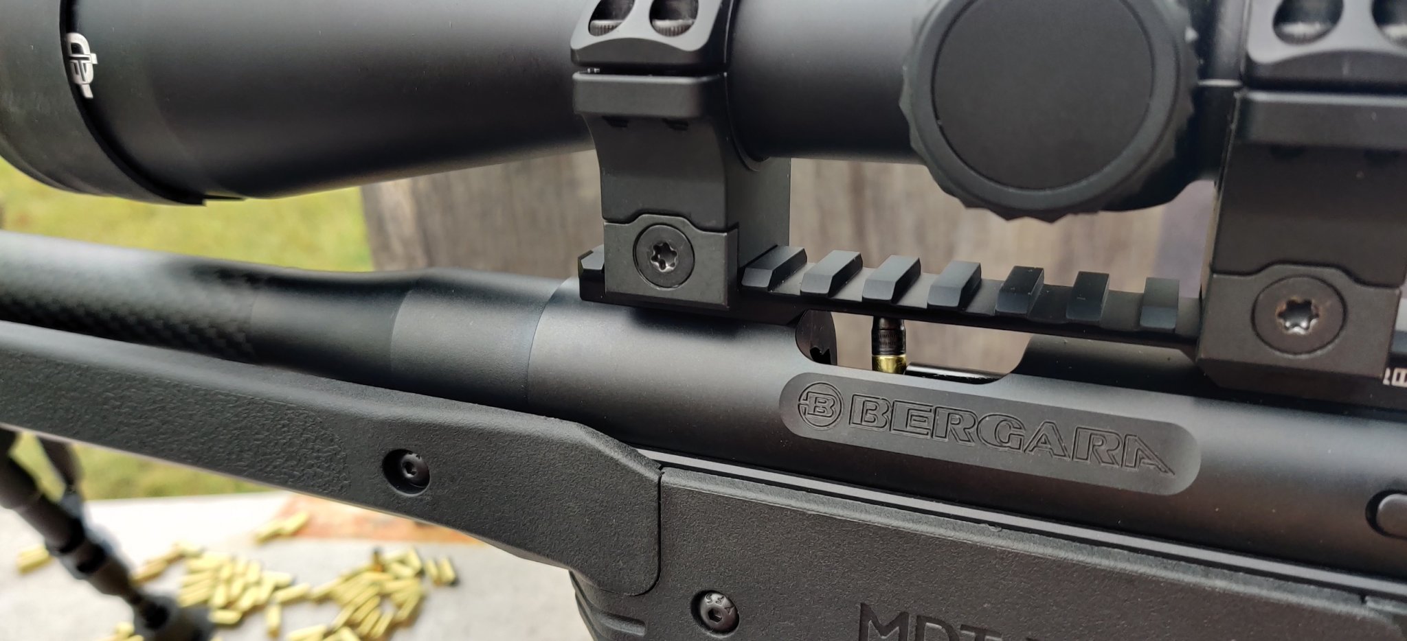

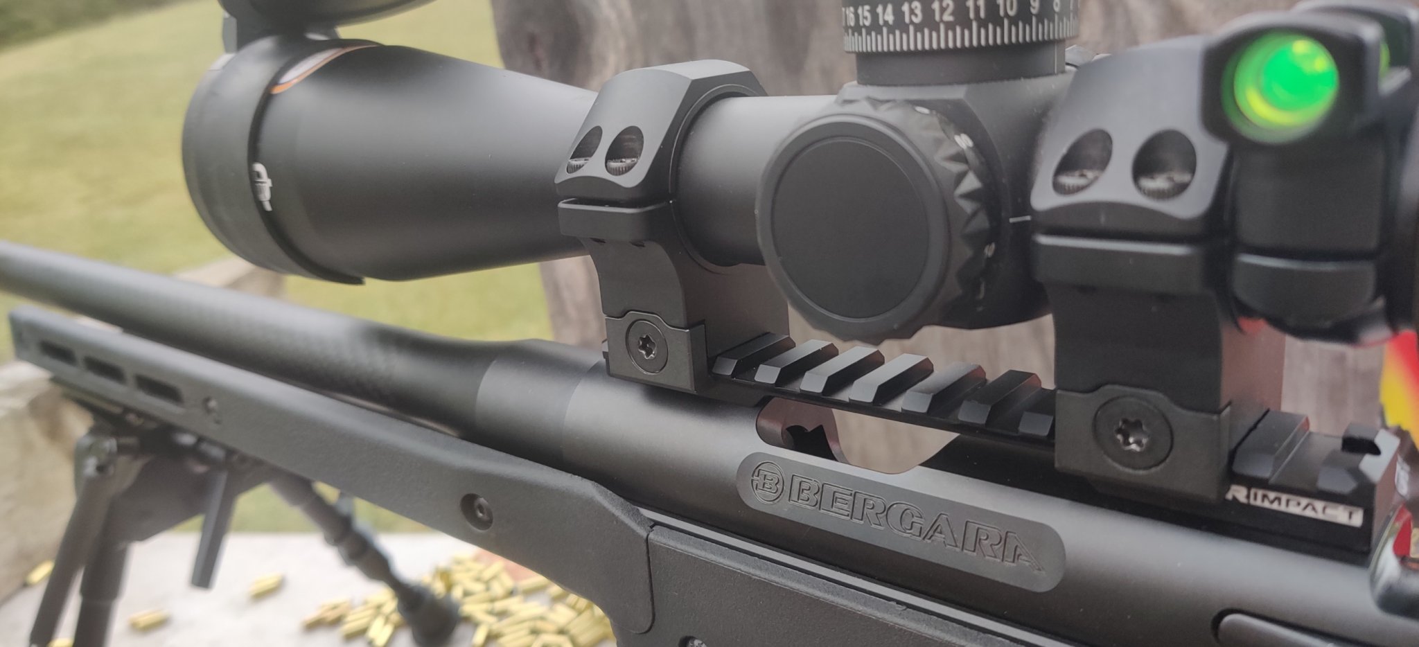

I wanted to show a couple of closeups of the rings with reducers. These are UTG PRO 34mm rings. The screws are all 25 Torx. The base screws are spring loaded. I have 34mm to 30mm reducers to enable them to work with this scope. Unless I need a classy look on a wood rifle these are all I get from now on. Or unless I need the Burris Signature rings with the offset inserts. These rings have been on several rifles and held several scopes. They still work perfect. Just goes to show you don't have to spend an ungodly amount of money for rings. BTW, the rings and reducers are made in the USA.
Here's the mag release. I like how it comes down pretty much even with the bottom of the mag. Just makes for a nice look to me. I also prefer the vertical grip and straight trigger shoe.

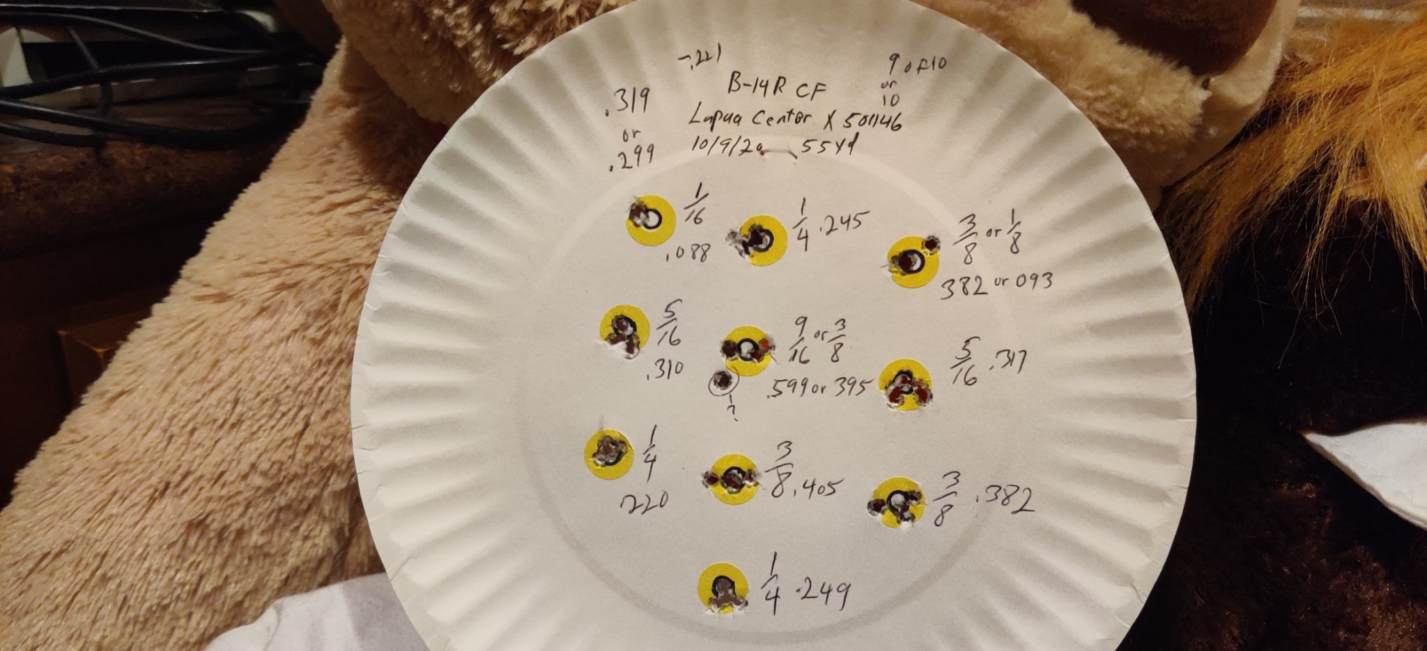

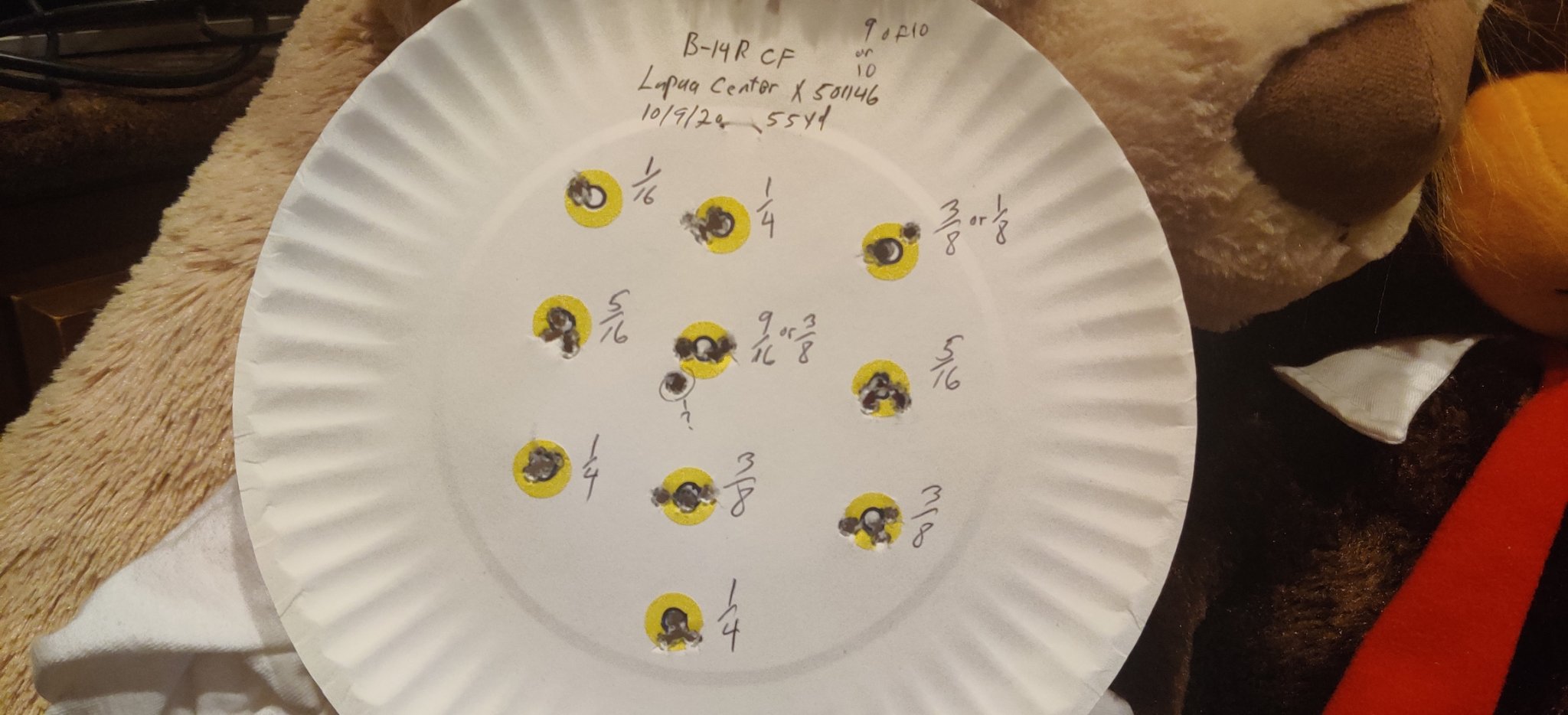

The best groups of the day belonged to Center-X. But not by much. This is probably the best target I have ever shot when you take into account the overall group size. That circle is 1/2" outside diameter. 49 out of 50 shots hit that circle. I really didn't know if I was wasting my money on this rifle but I am so happy I got it. It's also worth noting that this was the 3rd ammo shot. Notice the very first group at top left. That's tied for my smallest group ever. The 3rd group almost did it but on shot was out and I don't remember which shot it was. I have two bricks of this ammo left.

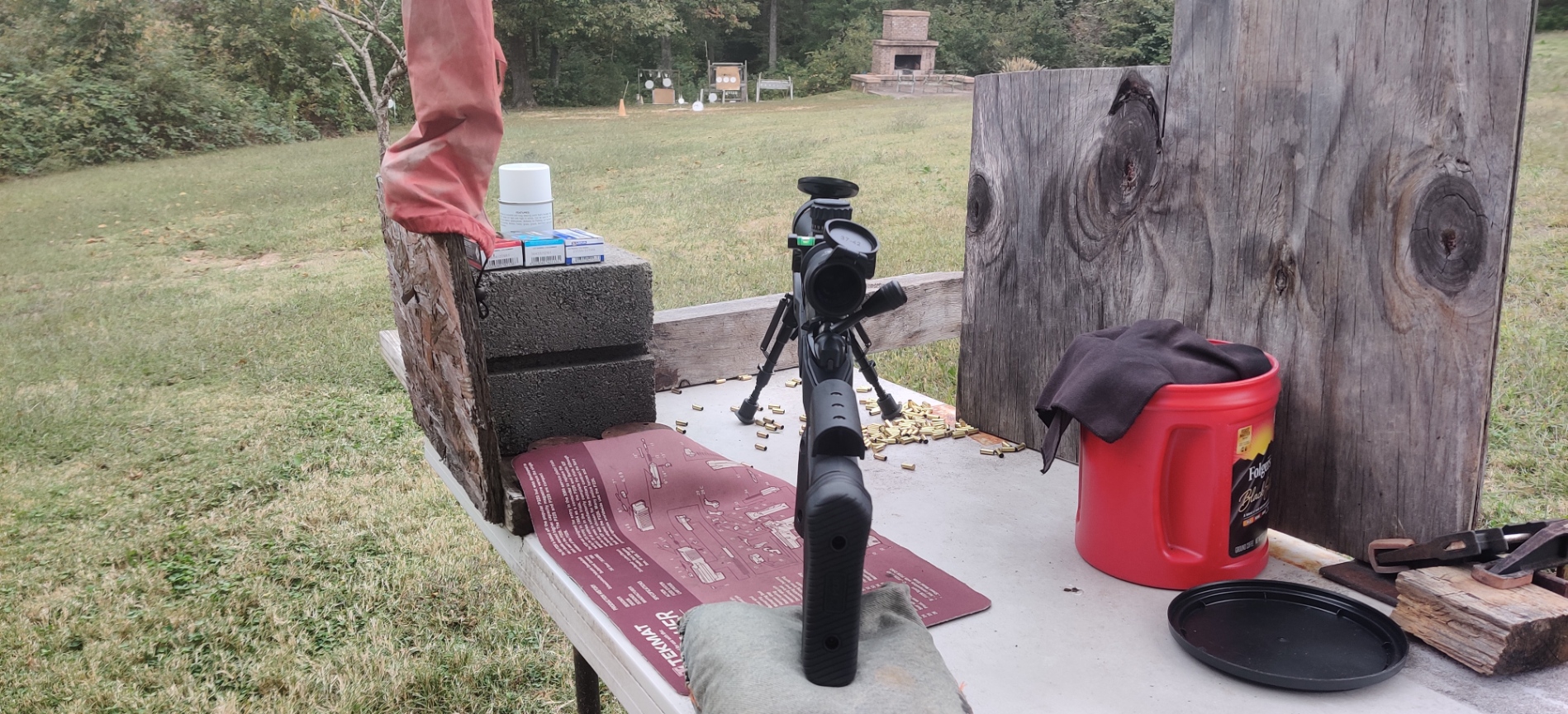

Here is my backyard range. The distance down there is 55 yards. The far right target group is KYL.

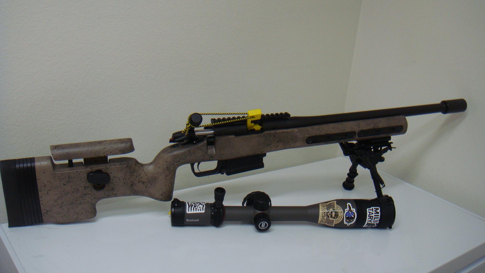

here is the old picture when she just arrive and got taken away from my dealer to mee. just showing the trigger for b14r/scope

Baracuda22, the Elf 700 will still work great. But if yours has the button head screw like mine shown in the photos it will hit the bolt shroud. The way I see it you have four options, 1. don't use the trigger 2. use the trigger without the safety lever 3. make bends in the arm to allow it to clear the bolt shroud and still fit the Grayboe and 4. do like I did and just remove the button head screw and knob. I still highly recommend the Elf trigger. I have an Elf 700 in both my B-14R's and a Bix TacSport PRO on the shelf. I'll let that speak for itself. I was originally leaning towards the Grayboe until I found out mine didn't come with the DBM. I like how yours looks. Looking forward to hear how your Shilen Ratchet barrel does. That's what Mark Penrod is putting in mine.

Just a thought on the Elftman trigger issue. Countersink the screw side of the safety arm and use a "low profile" flat head screw. I'm assuming its a 4x40 or something small like that, so the low profile screw should all but disappear into the safety arm.
There are also low profile pan heads as well which wouldn't require any modification to the arm, but might still not be thin enough to clear.
Edit-realized I called both types of screws i was thinking of "flat head".

Vodak, that's exactly what Elftmann did with the other trigger I have on my steel barreled b-14R. I don't know how the Elf 700 SE triggers are being shipped now but hopefully that's how a new one would come. I looked around my shop and I didn't find a screw so I left my knob off. I don't have a photo of the modified Elf but it's the same as this Bix trigger shown below. If anyone is reading this and is confused, I am showing the flat head screw facing you that holds the silver safety knob on the black safety arm.
vaguru, the action screws are 3/16" Allen head.

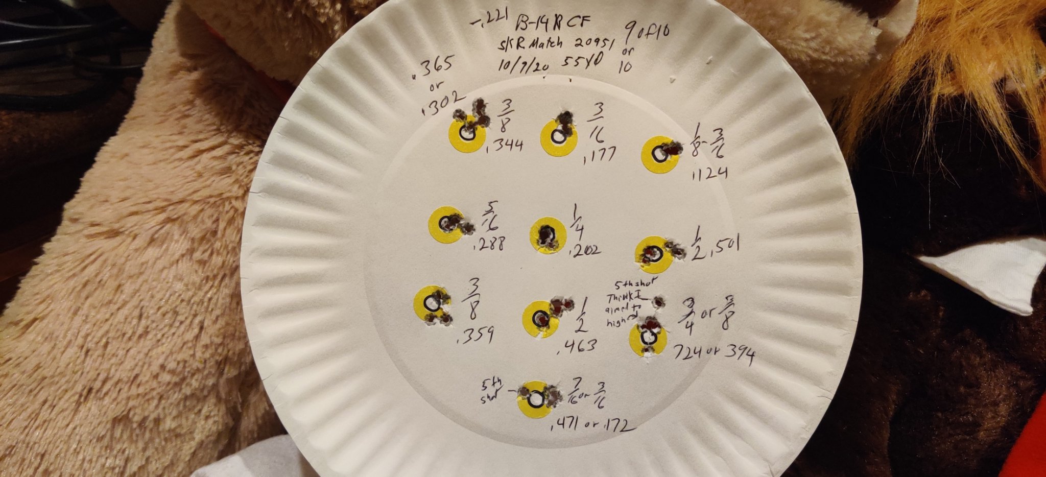

Below are the same three targets as shown above but with decimal measurements. I wanted to do this since no one seems to measure in fractions like I do. Also showing are the bullets hole size vs a set size of .221" on the calipers. As can be seen the .221" is actually a little larger than the residue marks on the paper. That leads me to believe that anyone who uses a bullet diameter size any larger than .221", their groups are not as small as they are measured to show. In all honesty maybe I should have used .220". Everything has a tolerance, for these measurements it is +/- .005". Final measurements can be seen at the top left. The -.221 is to remind myself the subtraction value.
On this target, the 9th bullseye shows a high shot. I'm 99% sure I aimed high, aimed at the center of the 3-shot cluster and resulted in a high shot. In all honesty that group would have been in the 3/8" range. Even with that it wouldn't have been quite as good as the Center-X above.
I had thought the above Lapua Center-X target was the best 10 five-shot group plate I had shot. But, that actually belongs to the Anschutz 1710 XLR shown below. I have hundreds of plates and there may be more that I have not measured. In the big picture this is like splitting hairs anyway, bottom line is the B-14R CF barreled version I have is very accurate by my standards. Maybe not to some of you but it is to me.

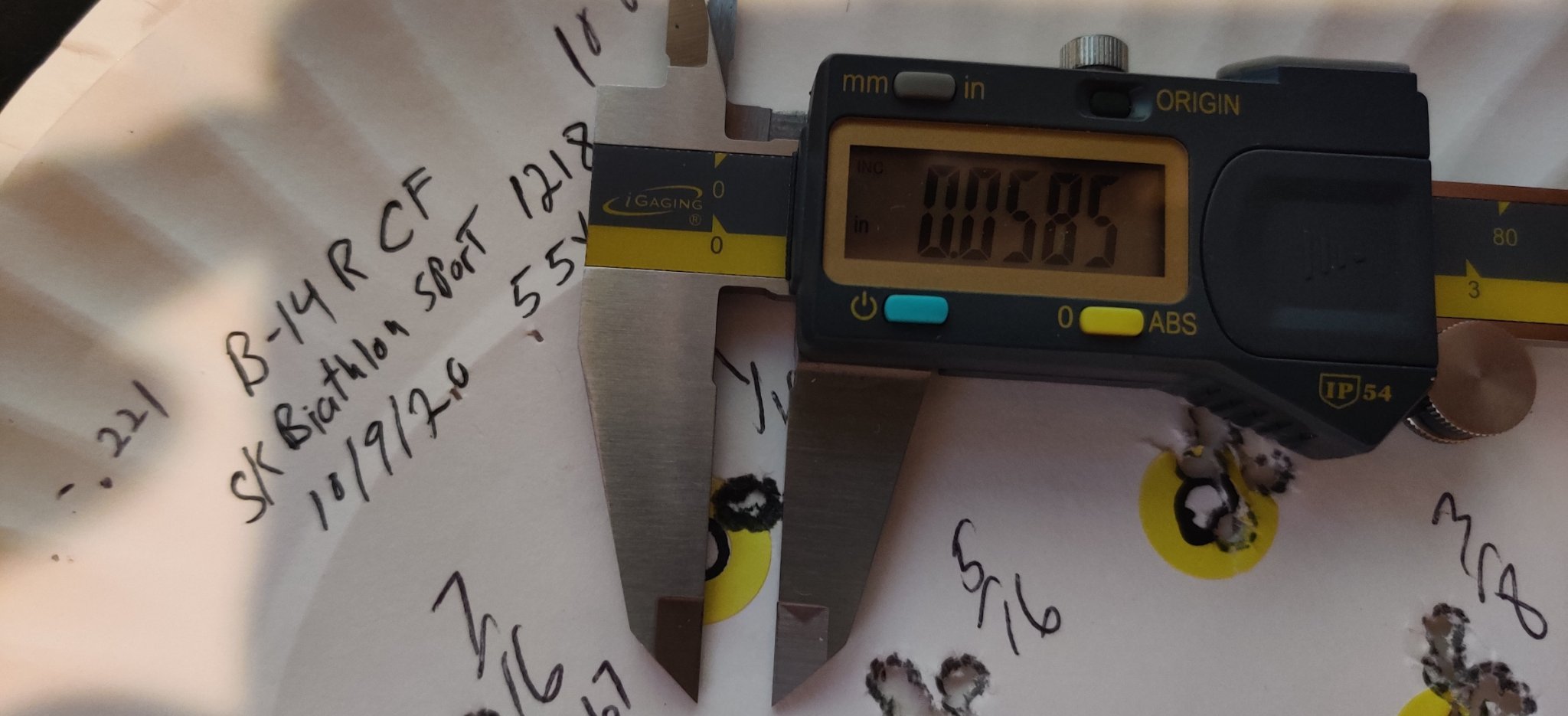

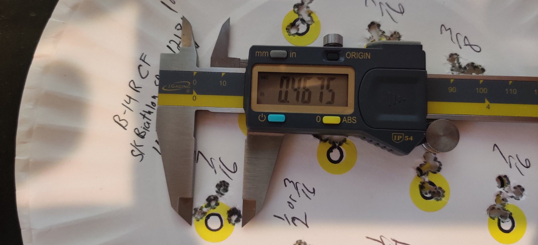

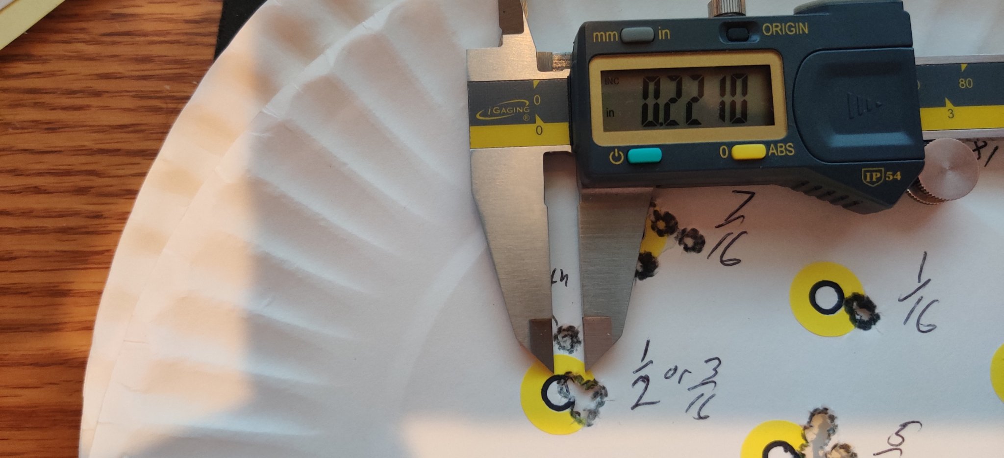

Here are some photos showing the bullet holes and size and examples of how I measured my groups. As I said above if anyone uses a number larger than .221" to subtract from their edge to edge group size they are not being honest with themselves. What I did was zeroed my calipers to -.221" and measured outside to outside edge the best I could. My calculations were already there. All the measurements you see have already taken into account a bullet diameter of .221".

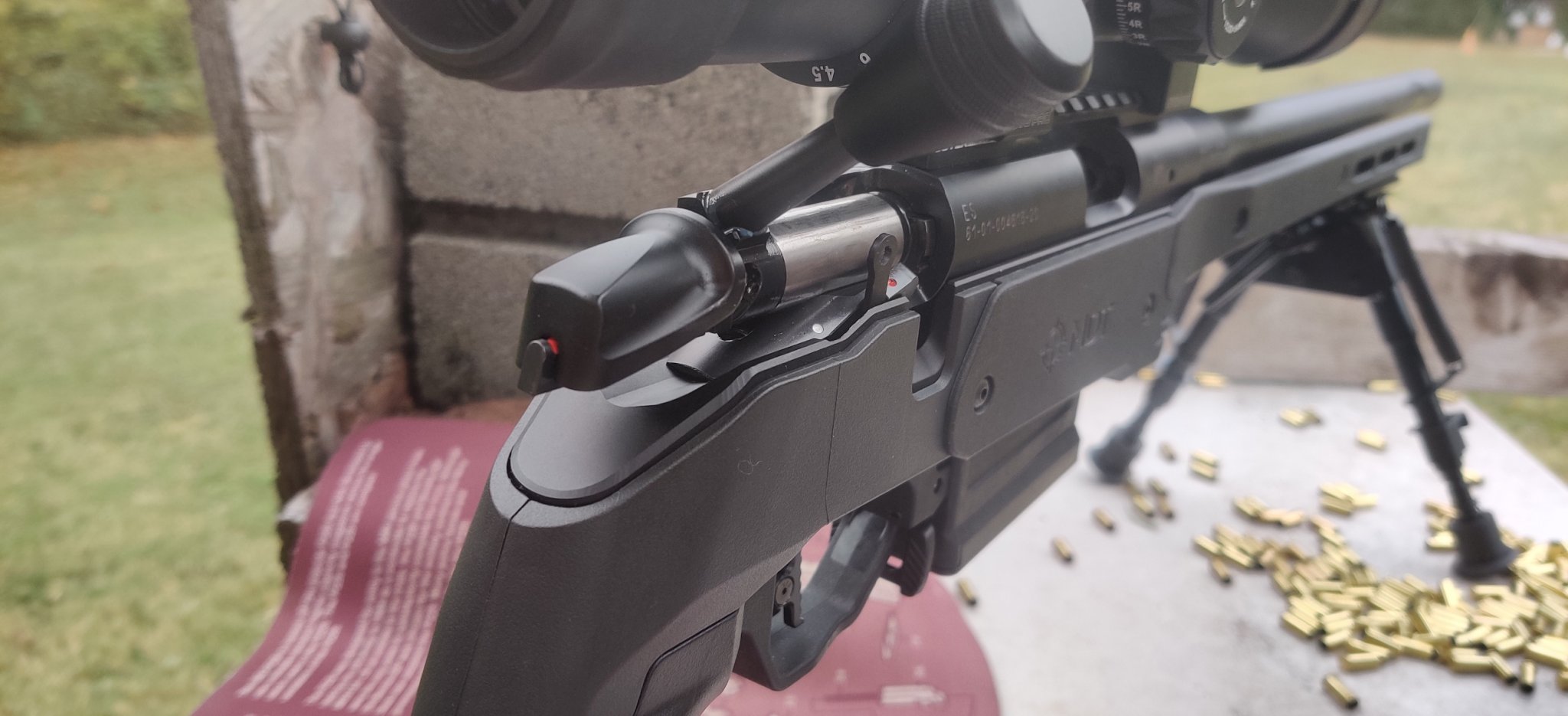

How does the XRS compare to a Bravo?
How do your steel and CF barrels shoot with your suppressors? better or worse?
They are both really similar in design and feel.
The XRS is roughly $150 more.
Starting from the buttstock both come with 3 spacers. The XRS has a much better spacer/LOP adjustment system over the Bravo because you don't have to remove the buttpad like the Bravo. KRG offers a buttpad replacement for the Bravo that is adjustable for height.
The Bravo has a better adjustable cheek riser "to me" because you only have to mess with one screw whereas the XRS has two. Not really a big deal but it is different.
Grip area, the Bravo has a vertical style grip and is a little larger in OD but the XRS comes with two grip sections, a slant and vertical and I like that.
The XRS forearm is a little longer and I can get the bipod out further than on a regular Bravo. I extended my Bravo with the KRG spigot mount.
The XRS has 3 M-LOK slots on the sides whereas the Bravo has two. The M-LOK attachments will attach to plastic on both. The bottom of the forearm on both have 5 M-LOK slots. The big difference between the two is on the Bravo you lock into plastic, on the XRS you lock into the aluminum chassis and to me that is a major difference.
The texture on the plastic forearm on the XRS where the M-LOK slots start is much more grippier than the rest of the plastic. The Bravo is the same all over and not near as grippy as the XRS forearm.
On the Bravo the front action screw is captured and the rear can fall free. The XRS has both captured.
Both will get the job done. I can see where the $150 more for the XRS might be worth it to some. I wanted the XRS because I already had two Bravos and wanted something different and the Bravo, I have heard sometimes has mag and feeding issues. I'm happy with the XRS and glad I went with it.

I talked with Hosea at Bergara today. The will be sending me another magazine but he said they had to come from Spain and it would be about a month before I get one. I found some in stock at DACK Outdoors for $27.99 + $7.99 flat rate shipping. Click on the link.
