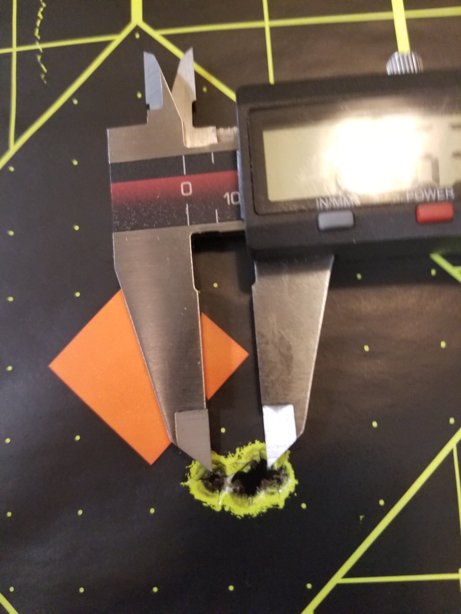

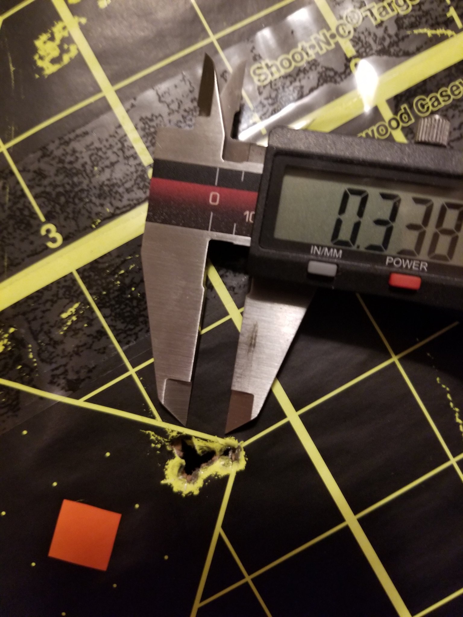

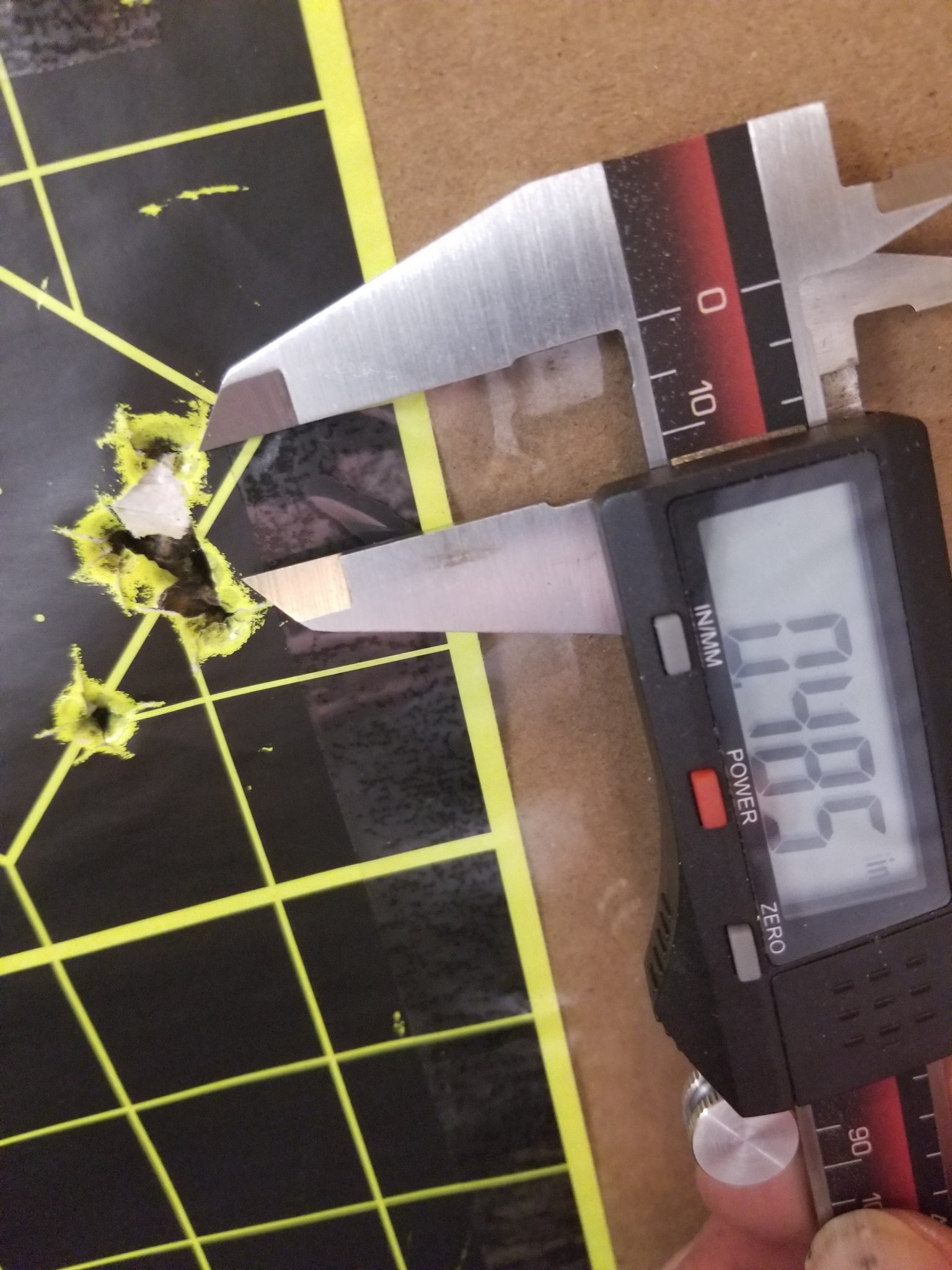

Mounted my new 65 Creed Bartlein 9 to 8 gain twist barrel chambered by Greg at SPR on my rpr 6.5. Zero'd my scope with a few Factory rounds and then started load data with the new Hornady A-Tip 153. Shot 20 rounds then cleaned it shot 20 more and cleaned again. I also shot some 140 ELD match for comparison. First of all I am extremely impressed with the barrel. I can't thank Greg enough. I am an average shooter at best, but with this combination I'm shooting 5 shot groups without paper between the holes, as shown. I also changed to Peterson 6 .5 large primer pocket brass (new) part way through, so I'm not going to compare too much load data, I do know my RPR likes .020 off the lands and it likes ELD match 140gr about the same as A-Tip 153, but I had under powdered the Peterson brass at 40.5 -40.9 because of case volume difference and not wanting pressure problems because the velocities were in the 2600's. With Hornady brass and 42.1 to 42.6 gr's of H4350 the velocity was in the 2820s to 2840's and the groups were tight. Now that the barrel is partially broken in I'm going to try the A- tips against ELD M in the peterson once fired brass with better velocities and see whether it's worth the extra cash for the A-tip's. I'm sure others and compare the two and have some data to report.

Thanks. I was shooting 1/2 moa at best before the Barrel change, and now, after the complete break-in, I expect 5 shot groups without paper between them consistently. I also replaced the stock with a Luth MBA-3 which got me a much more comfortable shooting position.
