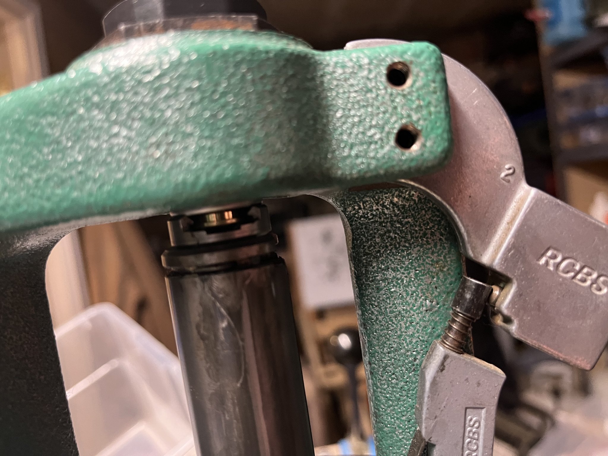

I am seeing contact with the shell holder on both my normal Redding die as well as my rcbs small base die. I thought the small base die resized brass all the way to factory dimensions or a little smaller?

Yes camming over, I could try sanding down the bottom of the small base die since I have no use for it in case I ruin it.

Yep die was definitely making hard contact with shell holder. I spoke with the smith and he uses a tight chamber and small chamfer for most support. I have not measured the fired brass from yesterday yet but will today.

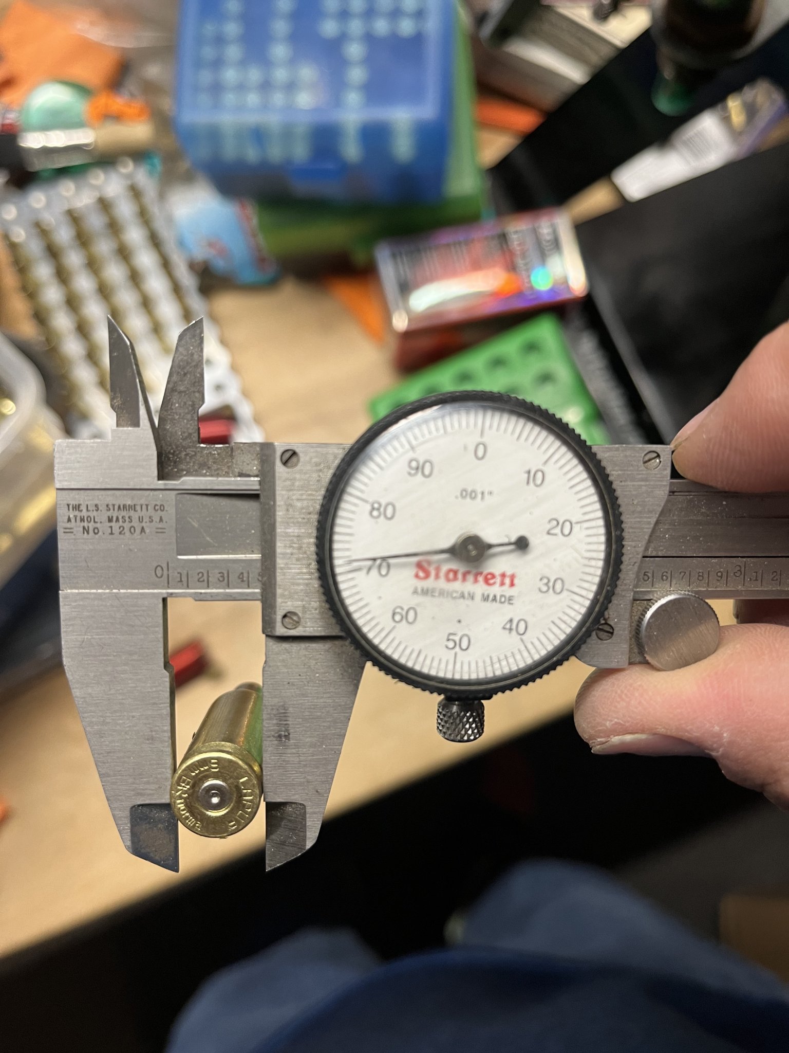

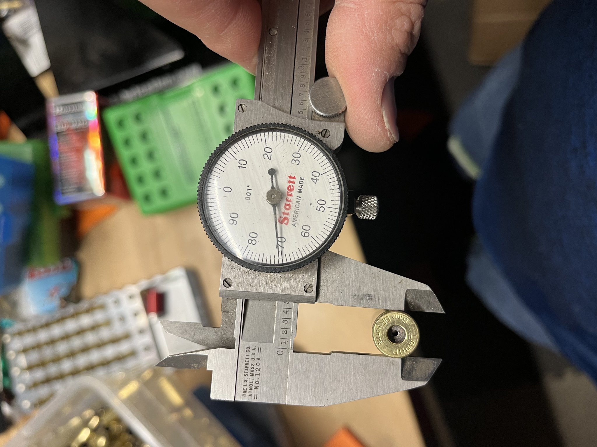

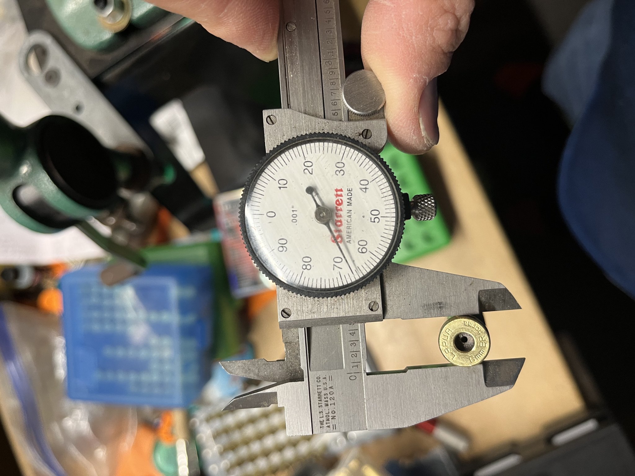

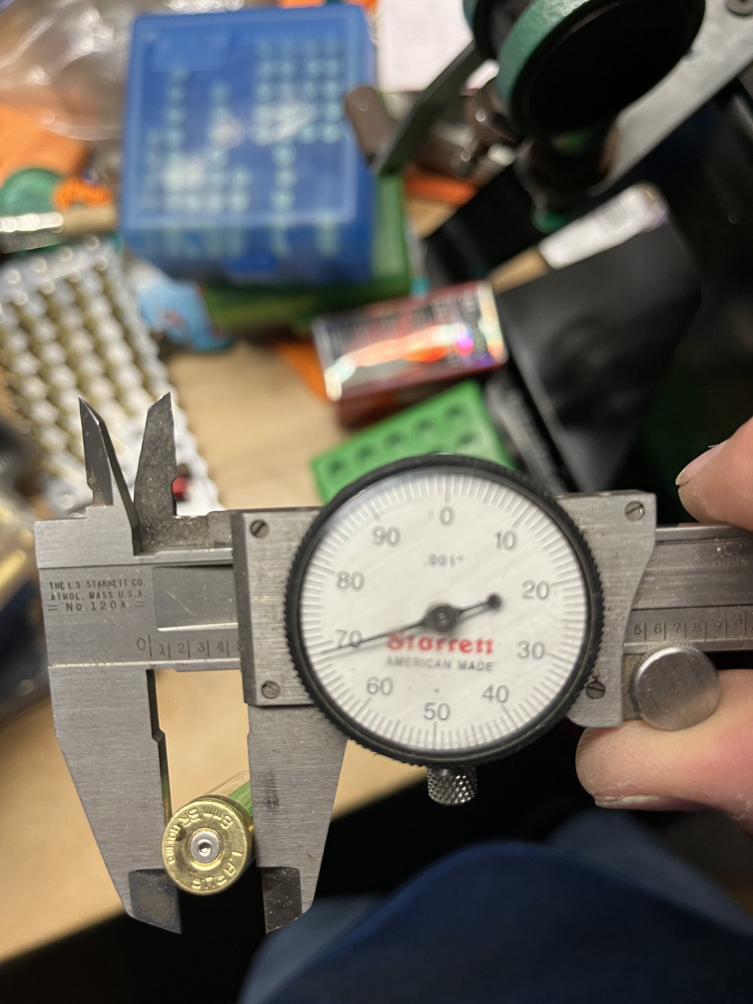

Ok, so I went and took pictures of my brass in different stages just at the web. Trying to measure the body consistently was a joke.
First picture is fired brass out of my old chamber. .471”
Second picture is fired brass from new chamber. .469”
Third is brass from old chamber run through my Redding type 2 full length sizing die. .470
Fourth is that exact same brass that was sized with the Redding now run through the rcbs small base die. .467”
And yes, I am aware that calipers are not as accurate as micrometers or what ever other tool that’s better but it’s enough to show the difference.
And best I could do for pictures but the shell holder and die are 100% in contact.
I really do appreciate everyone’s help with this. Just trying to provide some more data for future people that might search this.
