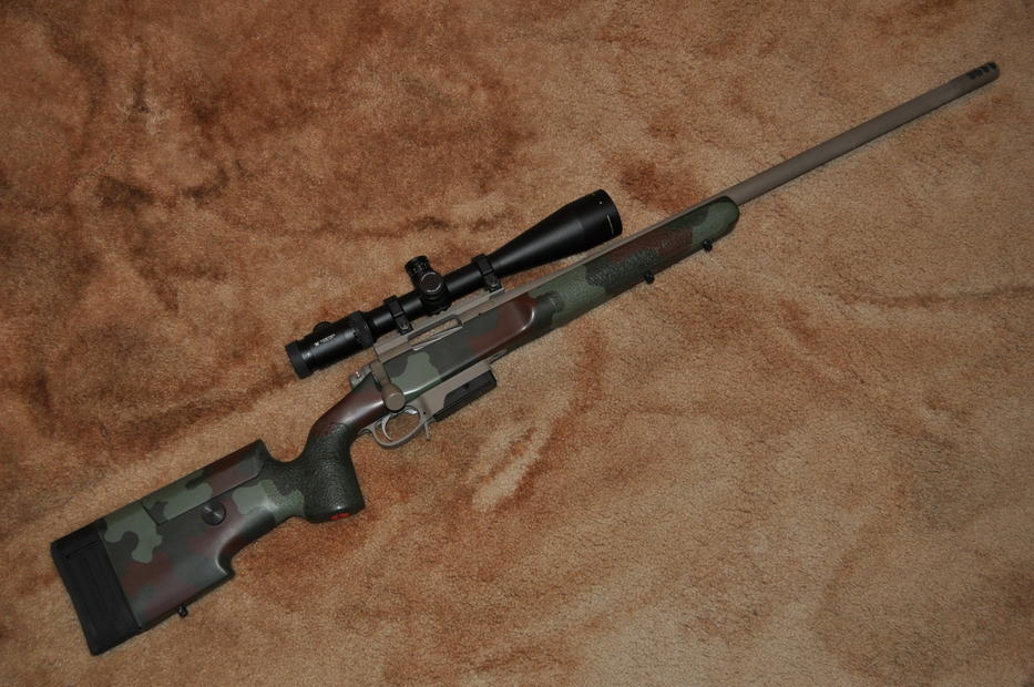

My 260 Improved 30* also likes 4831SC. First load I tried with SC used S142MKs & F210s in necked-down WW7-08 cases, and it hammered at 600. Vertical for that first 5-shot 600yd group was an inch or less, and the rifle's shot very consistently with this load ever since. Velocity's not what I'd hoped for at 2670fps, but I may have a 'slow' bbl. It's a SS Bartlein 4-groove 8.5tw in sendero contour that I finished at 26", threaded into a new trued SA700. I used a Jewell HVR, PTG Stealth DBM, EGW 20 MOA sloped base w/TPS TSR rings holding a Vortex Viper PST 6-24x50. Threaded the muzzle 5/8-24 for a Harrell's Precision tactical brake, then later swapped it out for a TBAC brake/mount so I could use my 30BA can.
Initially skim bedded the bbl'd action into a B&C 1000 stock that Wade had inletted for M5 DBM, and it shot great in that stock. Recently acquired an adjustable McM A5 that was factory inletted for M5, and moved the bbl'd action into it after bedding with Devcon. Was slightly more than somewhat amazed that POI didn't change as much as a click after the stock swap, even after removing & reinstalling the scope twice while doing some machine work on the action after the McM swap.
I've played with cartridges from the 223 AI to 280 AI in tactical rifles, and this 260 Imp is quickly becoming one of my favorites. I'll be trying RL17 with the 142s in search for more velocity, but if it doesn't shoot as good as SC, I'll settle for 2670 and go on down the road. Bought this stock off McM's inventory list - forest camo wouldn't have been my 1st choice, but it doesn't clash with the FDE CeraKote I used on the metal parts.

Thanks guys. Couldn't have done it without this site. That's an awesome lookin stick Flatland. Seems you should be getting more velocity, but if it hammers.. who cares? I like the stock, and color. Mine will be going into a Mcree, or Rock Solid very soon. I checked vel again today and it was showing 2750-2780?? I need to get rid of this borrowed piece of junk, and get a good one.
Thanks GHB - I've really enjoyed working with this rifle; yours is shooting at least as good as the best I've seen out of mine so far, so I'm sure you're going to be pleased with the choices you made.
On the velocity thing - the load I'm using for fireforming uses RS Hunter or surplus Data 85, which is essentially the same thing. S123MKs are shooting very well in this FF load, which has been running 2900-2925fps. Used it out to 600yds during the last steel match, then switched to the 142s & 4831SC on out to 1100. Sure is fun to watch those 123s stacking up on top of each other on steel while fireforming. I should probably try Hunter/Data 85 with the 142s to see how accuracy & velocity compares to SC - ya never know, it might be just the ticket.
