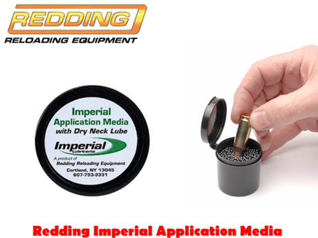

For sizing:
If you use imperial wax on the bodies then its no problem with a quick dunk.
If you use a spray lube that also indiscriminately gets on/in the neck or shoulders then the little ceramic balls can stick to the neck after a dip, just a short tap should knock them off. I kept a little bowl or butter dish or something there to knock the case against so the balls dont go everywhere when they unstick. The little tin isnt quite hefty enough to tap against without me fearing Ill tip it over.
For seating:
If you cleaned the cases after sizing then they should dip with no sticking. While dipping just the bullet may not work as well as the case, I did notice a marked improvement over undipped when I was having heavy seating pressure issues. and then I didnt have graphite all over the outside of the necks after.
My tip with that application media is to dump out one third and shake the shit out of it
What is your favorite graphite powder? Is it the Redding as well? Just dip the case before seating, then after seating wipe neck for any left over residue?

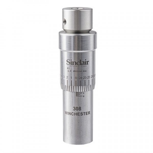

My planned workflow is going to include wet tumbling, annealing, full length resizing (via Redding bushing) and neck expansion (Sinclair mandrel). With all of this done after each firing. Especially given the cleaning and annealing steps, I read of this being a potential driver for higher pressure required for bullet seating plus hints of an increasing bond (molecular? electrochemical such as galvanic corrosion?) between bullet and neck wall over time. Which to me means that while care is given to set neck tension, factors beyond pure tension can impact the grip/adhesion level between the bullet and the neck interior. With some advocates not wanting to clean or anneal so that the inside of the neck maintains some level of material (carbon?) left over from prior firings to act as both a lubricant and barrier to prevent bullet to neck bonding.

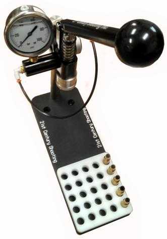

So at this moment if someone (like me) plans to extensively clean the brass as well as anneal, that some type of lubricant (such as a dry lubricant) inside the neck is a good thing. I see people can measure seating force via what I assume is something like a load cell and arbor press. Has anyone done something like a study of the force to remove a bullet from a case once seated? With time (days, weeks, months) as the variable? if there was a correlation then I can see that velocity may vary depending upon how long the ammo has sat after being loaded? And to go along with this potential, that the use of something like a dry lubricant can maybe help both bullet seating as well as prevent unintended bullet to neck wall bonds from developing?

Youre right, they use a hydro arbor press such as the 21st century or k&m, usuaes special seating dies, not those that screw into your normal press.

I dip the case neck, tap it on cap to remove exces.
Then use wax on the body to size, no more chatter on expander.

Was doing the qtip thing but it is slower than dunk and tap.
Cannot say which is best but excess dry lube is dry not wet incase of a mistake?
I dont know of a way to test that, it is faster.
Some #2 or 4 shot pellets in the graphite neck lube container works well for dunking the necks and preventing a clump in there. I then wipe the outside of the necks and load. Alternatively, you can load the rounds a tad long and final seat them a day or two before you shoot for score. But, in fact, I only do the aforementioned when I think the rounds might not be fired for a few weeks. On rounds to be fired within a few days; I don't find either necessary. All of these techniques will produce single to low double digit ES's if your other variables are under control.
