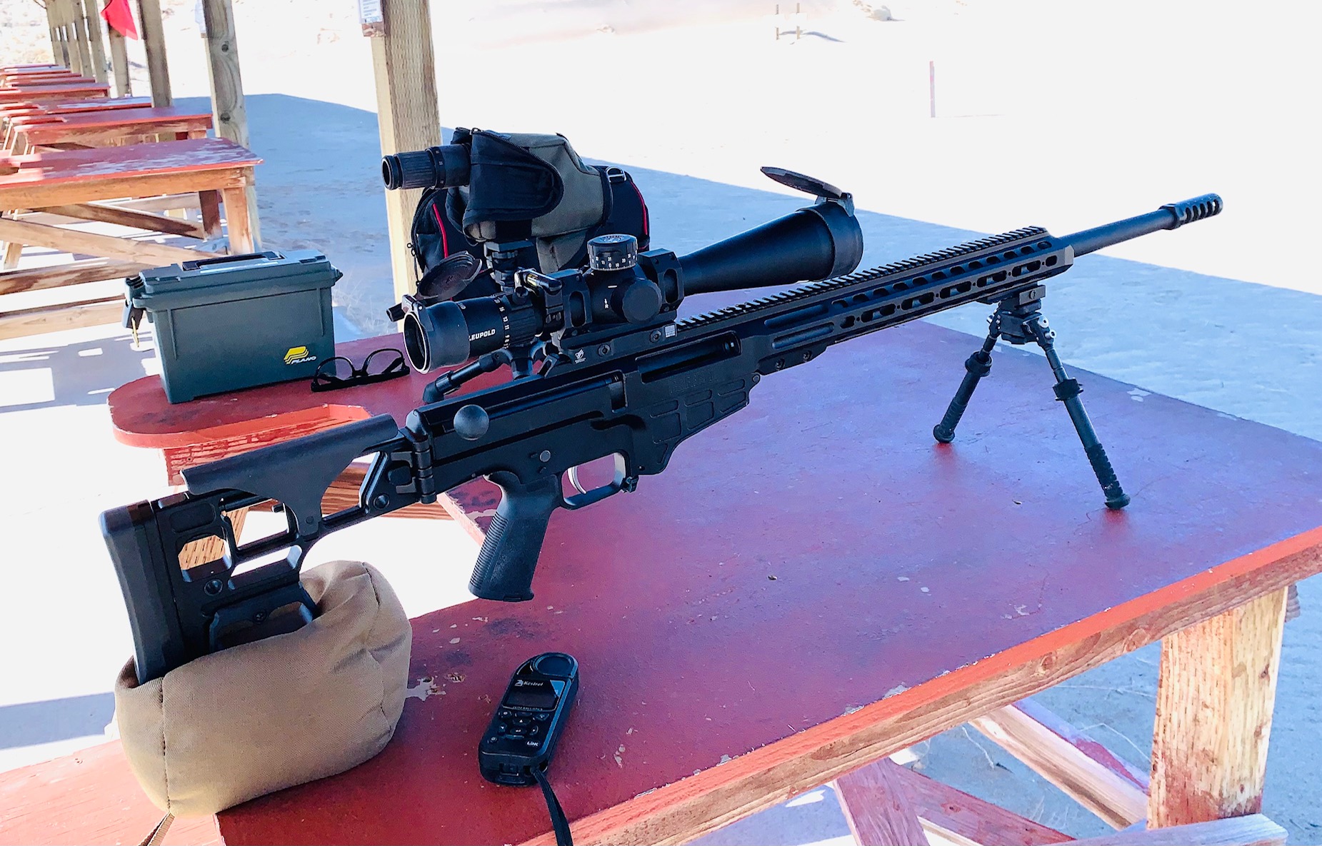

    Can't help you on the brass question, but that's one hell of a lot of cool rifle you have there.
    Pics?
    No doubt ... love my MRAD. Got barrels in 6.5-CM, 308-Win, and 300-PRC too, along with the 300-WM and 338-LM.
    With glass and accessories ... I don't even want to "think" about what I have invested in this little firecracker.
    Crappy photo, but it's the only one I could find.
