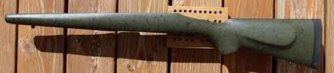

    Now that I finished up the HMR project, I was wondering what my new project should be. Then I remembered I had an old HS Precision stock stashed in the attic that had seen better days. I've basically treated this thing with wanton disregard but it could be fun.
    So what do you guys think? A little JB Weld, a new recoil pad, a little paint, and she's back in action.

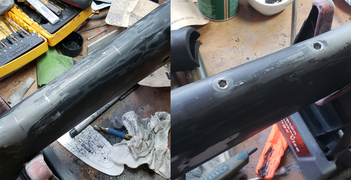

    The project is coming along, after all the paint got stripped off I noticed there were some areas where the shell had chipped away and the foam core was exposed. The only thing I could think to do was mill out a small pocket out to the where the shell wasn't damaged and fill it with epoxy. That seems to be all done now and between those spots and filling in the holes where the sling studs were, it's been a little more work than I'd planned. Yesterday I filled in those two holes in the buttstock with JB Weld WaterWeld, trimmed and sanded about 1/4" off the back of the butt to clean up that mess, and drilled the holes for the flush cups. Turns out I'm going to have to rethink my plans for the recoil pad, after looking at the one I've got it's just not going to work like I'd hoped and I'm trying to avoid a grind to fit pad.
    Plans for this weekend are to JB Weld the flush cups, install the pic rail in the forend, and bed the Magpul DBM to clean up the inletting.

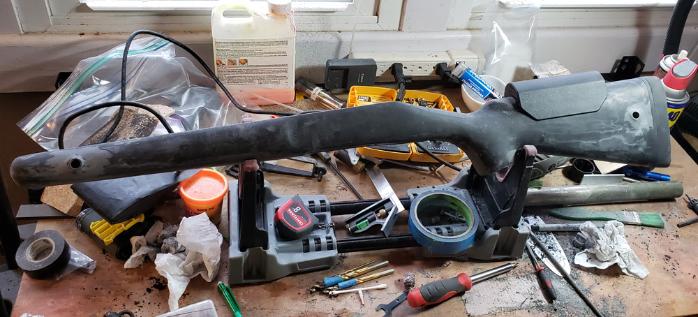

    I have been a little negligent in documenting the whole process but here is where things are at the moment.
    I forgot to get a shot of the grip area but here's the forend with the sling swivel holes filled in and some other areas where the foam was exposed.

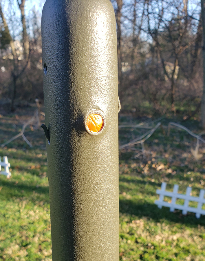

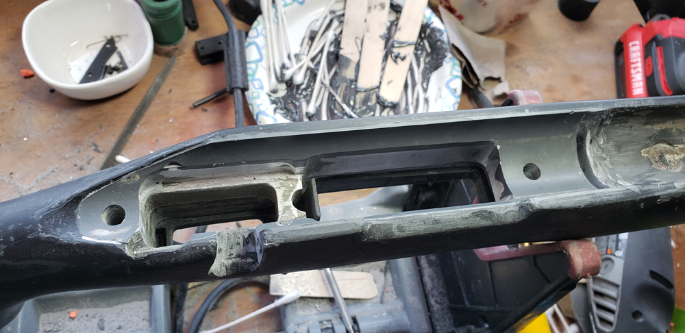

    One of the front flush cup pockets done and tapped. It's 9/16-18 tap btw for those Grove-Tec flush cups, they'll be epoxied in towards the end after I'm done sanding and what not. I drilled it with a 1/2" drill bit with a piece of tape so I only went in as far as I needed to.

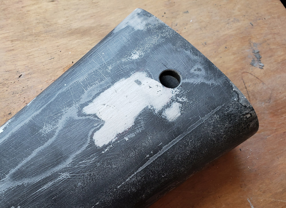

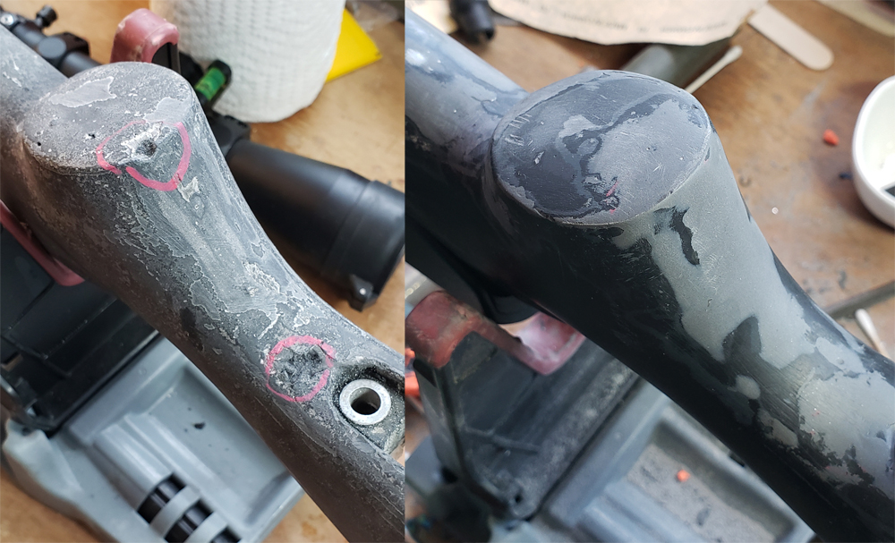

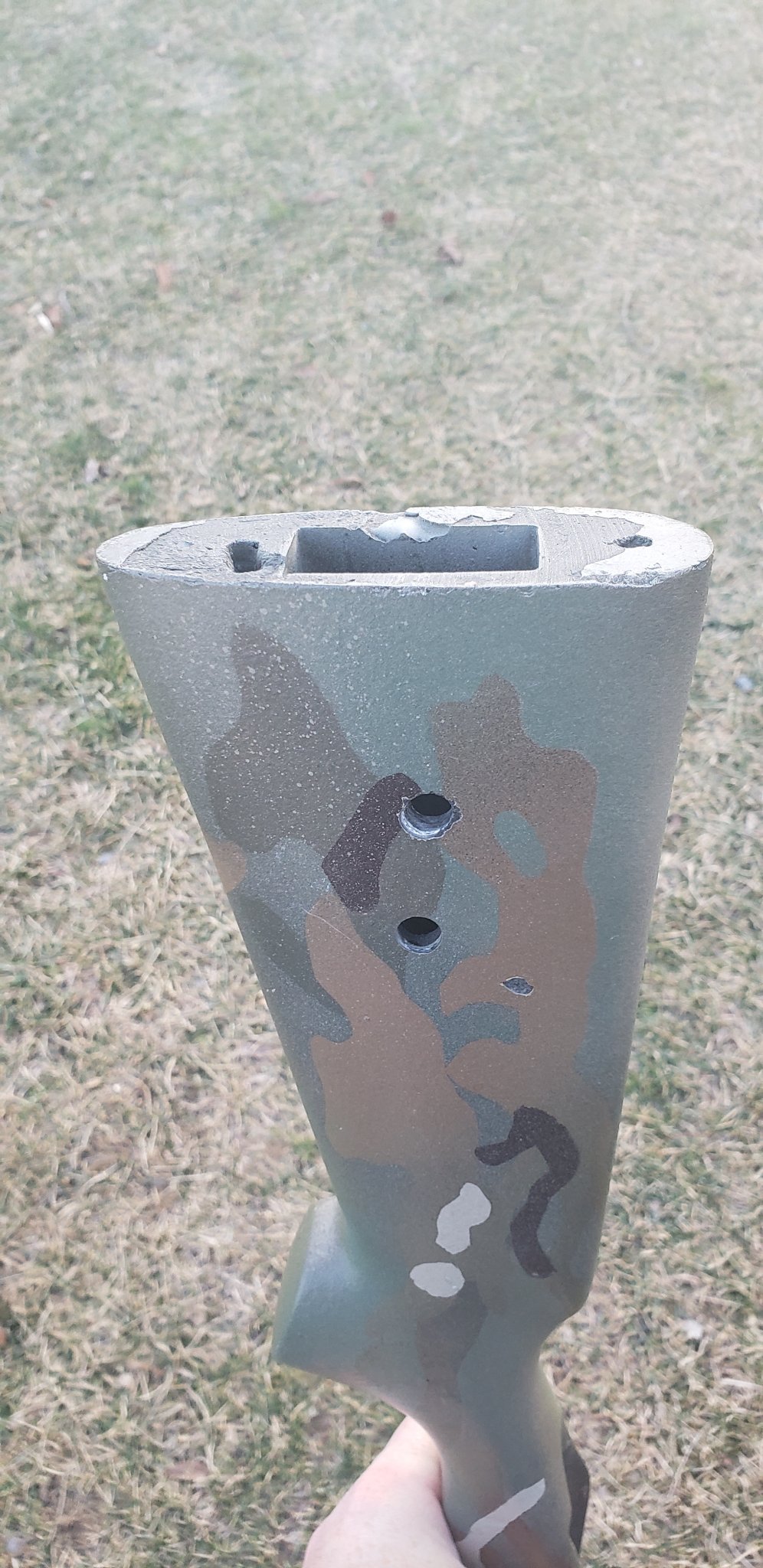

    Buttstock area where I filled in the two holes shown earlier with JB Weld WaterWeld and sanded it down. I used a small round file to chamber both the inside and outside of the hole so that when I smashed the putty in there it'd have a better bite and resist any moment one way or the other. In theory anyway.

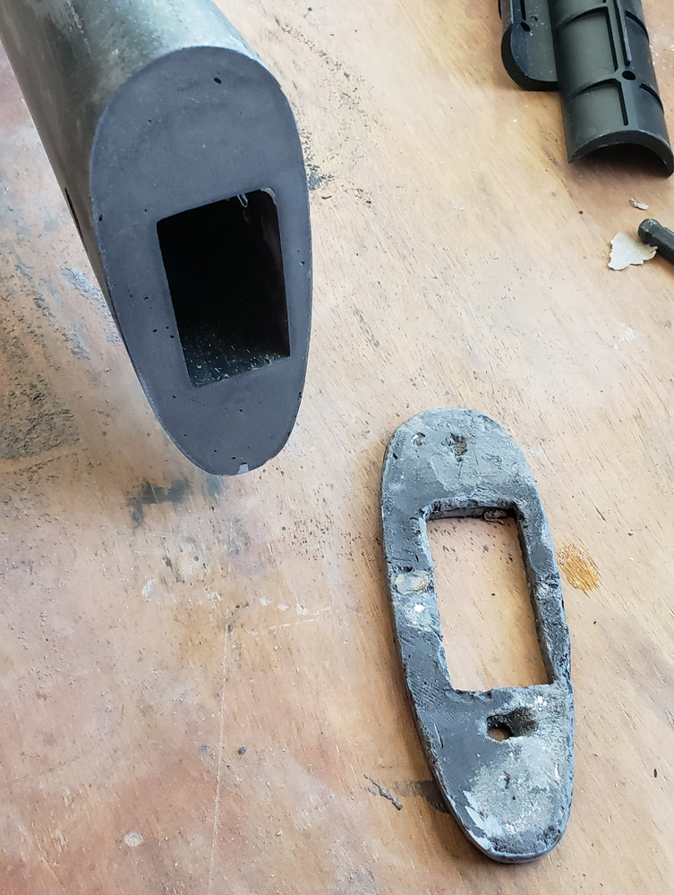

    Cut off the nastiness in the back and sanded it down. I may end up taking a little more off the back depending on how the LOP works out when I get the new recoil pad.

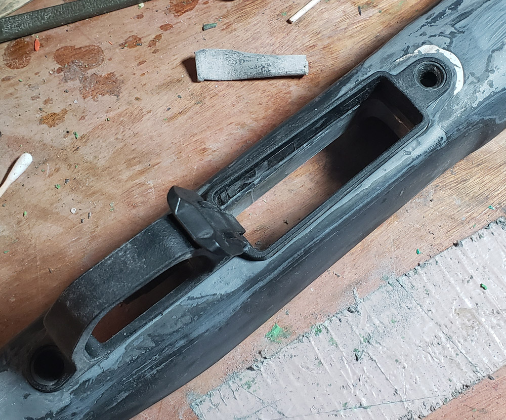

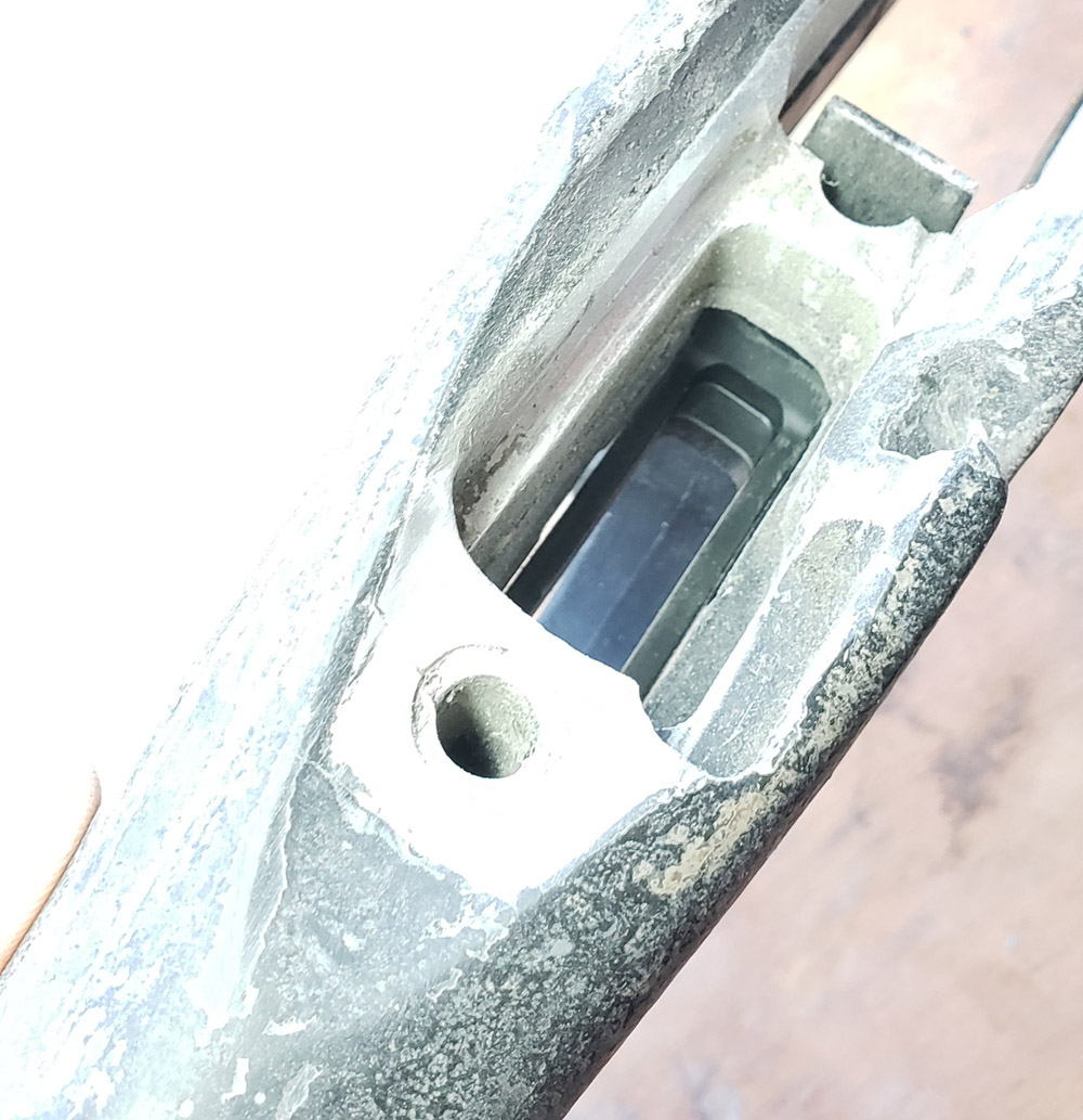

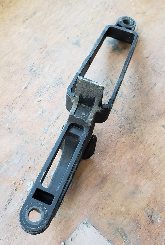

    Modified Magpul DBM so that it works with the stock.
    This is why the rear magazine guide had to be contoured the way it is, it has to clear the interior receiver bridge.

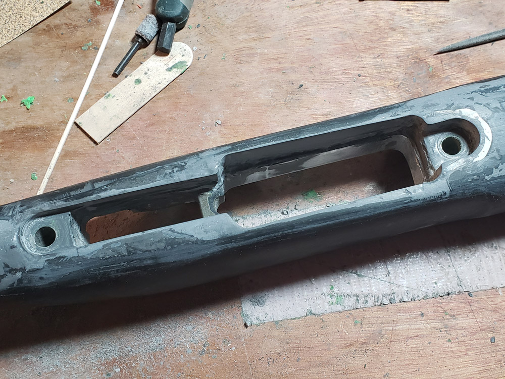

    Ok, bedding the bottom metal now to clean up the gaps so we'll see how it turns out tomorrow. I filled in the lettering with neutral shoe polish, in fact shoe polished it all over and then gave it a coat of Hornady One Shot for good measure. It'll either work or I'll have created a mini-chassis set up. Since I made up a good batch of JB Weld I also installed the rear flush cups, I'm not doing the fronts yet because I have other stuff I need to do up there still.

    Recoil pad shaped

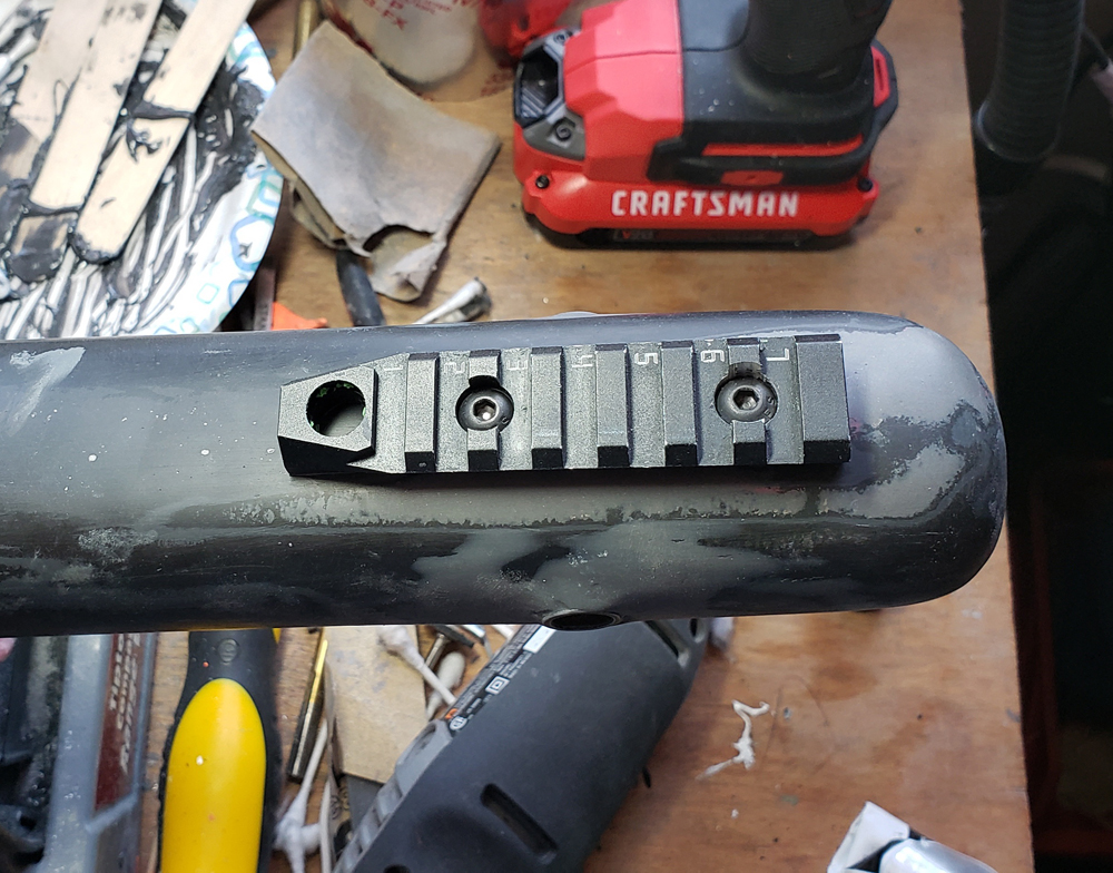

    Since I just made the front rail out of an MLOK rail, I'm going to bed it to the radius of the stock and glue on the recoil pad at the same time. That's basically only to leave bedding the action area and getting this thing ready for paint.

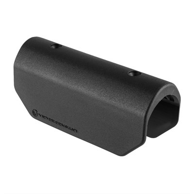

    Any mor info on the cheek riser? I've been keeping an eye on this but might have missed it.
    I've got a hollow fiber stock I've gotta get a riser stuck on, just curious how you did it.
    I've got a Kydex press I make my holsters so I may end up using that.

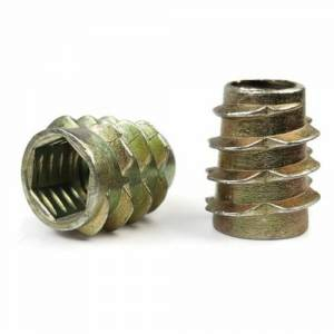

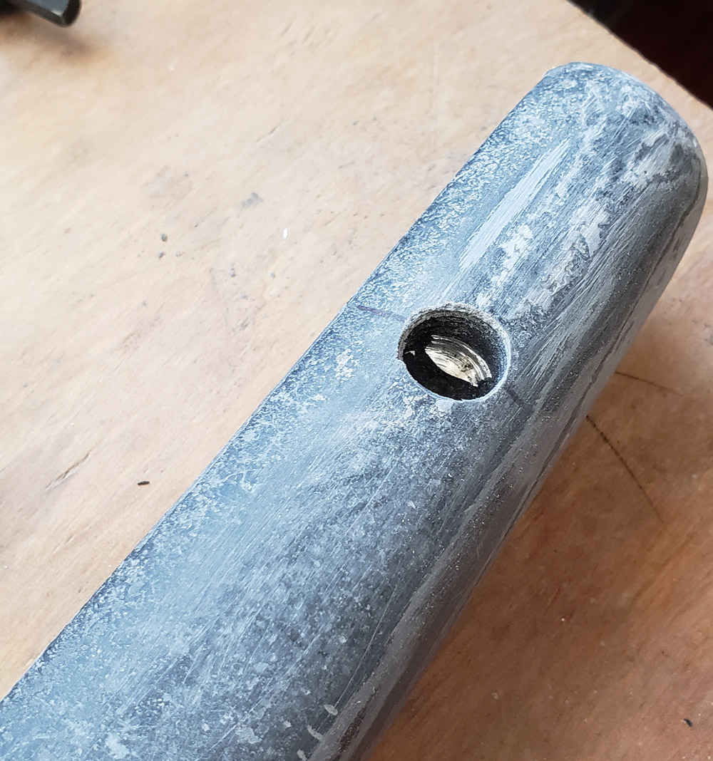

    The cheek riser is a Victor Company cheek riser. There's enough meat in that part of the stock to embed two 10-32 threaded inserts with JB Weld to secure them along the top of the comb.
    These ones, I got them from the hardware store.
    Once I found center line I marked the holes and started with an 1/8" drill before stepping up in size until I got to one that was just smaller than the OD of the threads, I think it was 5/16", I'll have to check. This minimized deformation as I threaded them but still gave them some bite into the substrate. I chamfered the hole to give the JB weld somewhere to pool and provide some reinforcement to the outer shell, in theory anyway. I used 10-32 zinc coated flat head machine screws to secure it to the stock. I would've preferred black oxide but the oxide screws have a different head diameter that doesn't jive well with the Victor Company riser.
    When I cut my 700 ADL stock to take the magpul bottom metal I did a TON of cut and fit, then cut and fit more. When it was all done with it fit like a glove. Then when I bedded it..... oops... It never came back out. But it fits and works great.
    I didn't cut the bottom metal, just the wood.
    Like this?
    Without modification I don't think it'd work, the Victor Company has some flex but I'm not sure if would flex enough to set correctly over the Monte Carlo-style hump.
    You could probably trim back the leg on the left side to make it work though, it's only plastic so not too hard to cut.
    Reactions: xsn10s
    That's the one. Thanks for doing the leg work! That was kind of my worry, I'll keep working on something. For the time being I'll probably go with one of the strap on stock pack things so I can avoid drilling any extra holes.

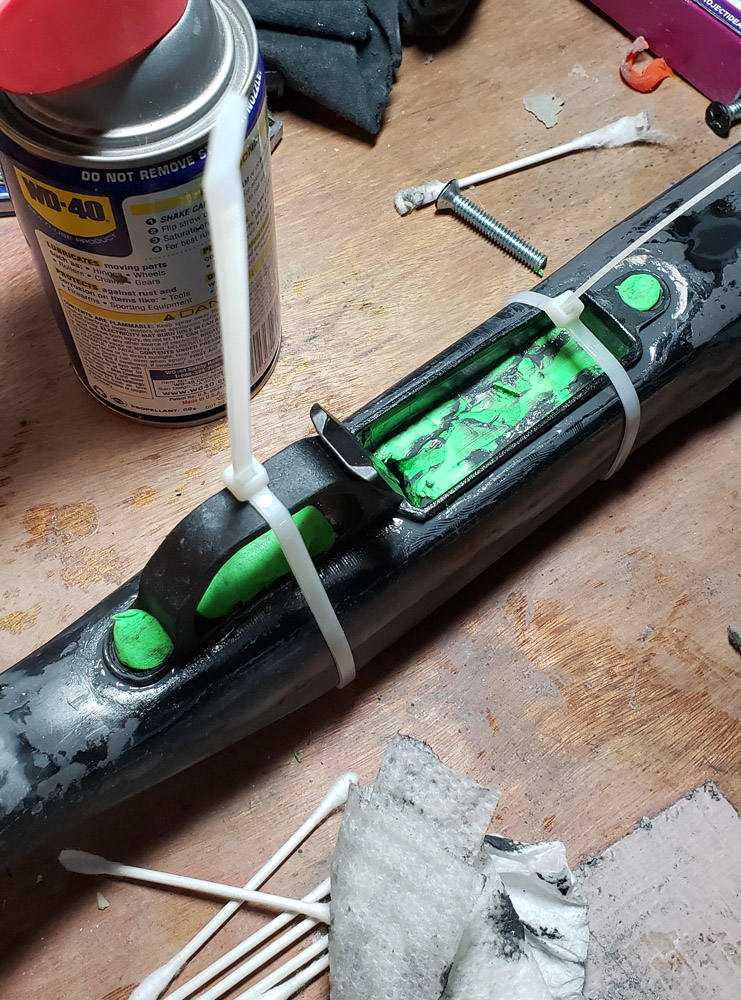

    My week got away from me but I did get the action bedded, now all I need to do is sand it down one last time and get it prepped for paint. I cleaned up the overflow with a Dremel, files, and sandpaper, time consuming but it came out well. I'm going to sand the barrel channel a little more before I paint it.

    Modified MLOK rail, I bedded it to the stock so the bottom has a radius now to match the contour of the stock.
    Here's the threaded inserts for the cheek riser that was mentioned above. The front one is a little wonky but it may not look as bad with the paint on it and it'll be concealed underneath the cheek riser anyway. I heated the cheek riser with a heat gun and pressed it down onto the stock to widen the bottom a little, my main reason for doing this was so that it didn't scrape the paint off when I put it on later. The position of the cheek riser also allows me to remove the bolt without having to remove the riser.

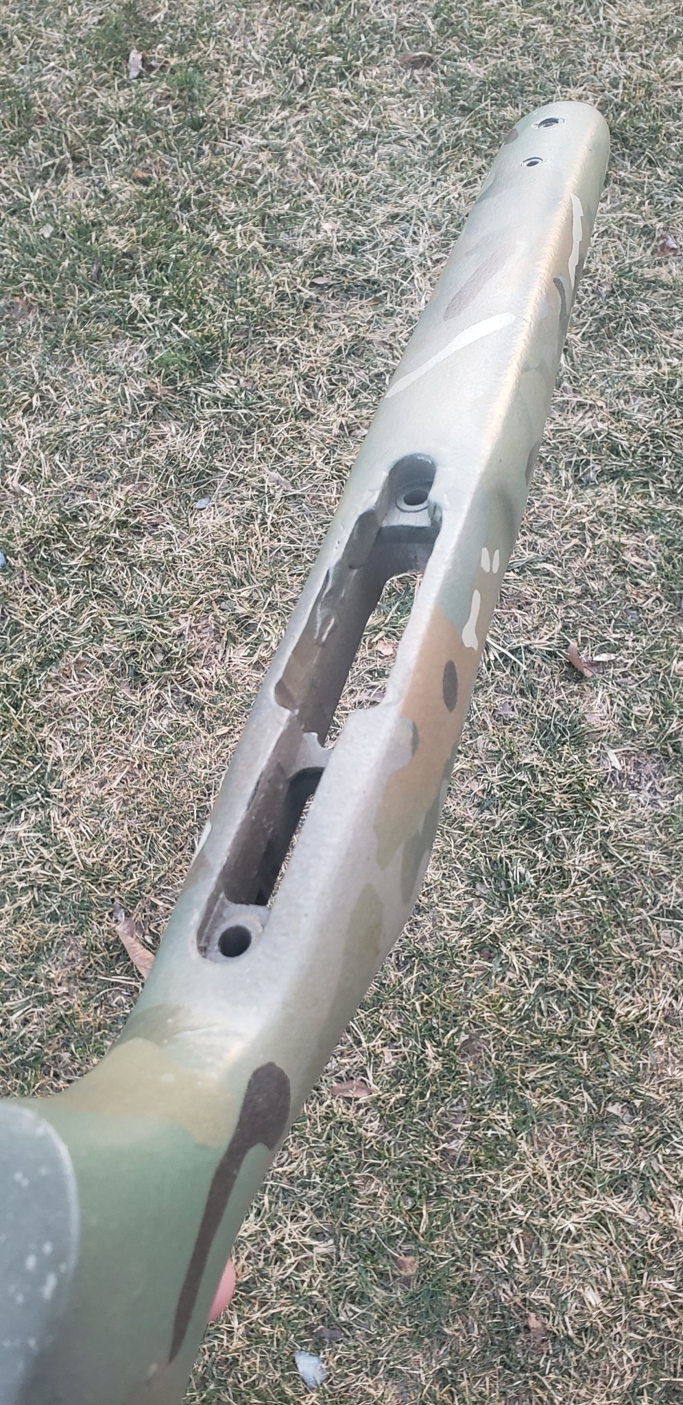

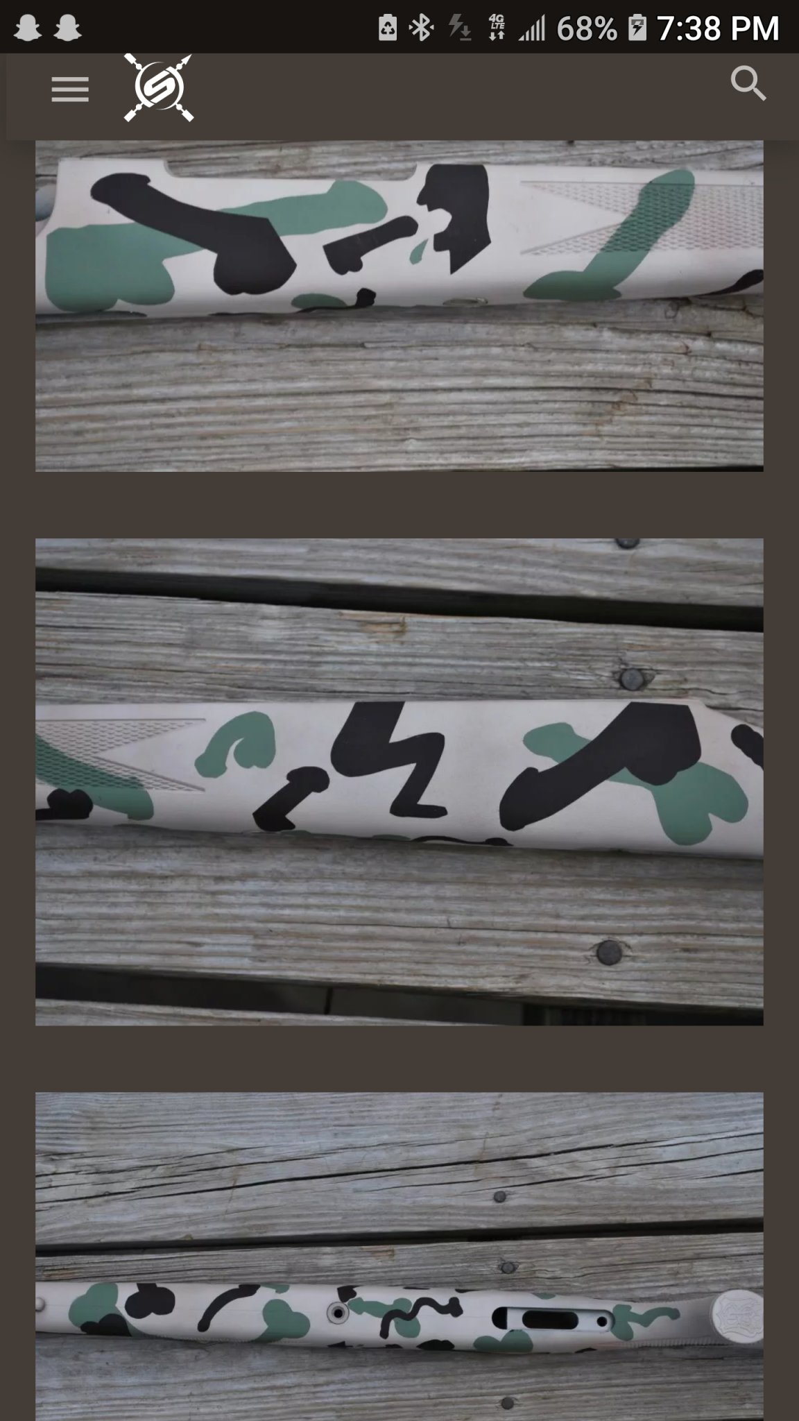

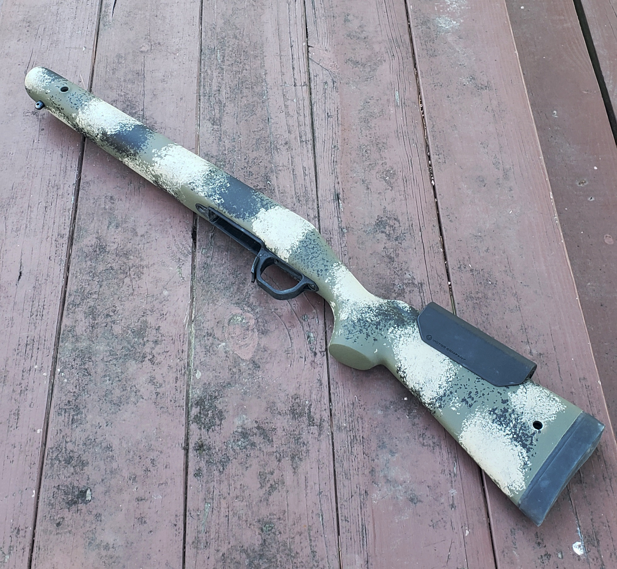

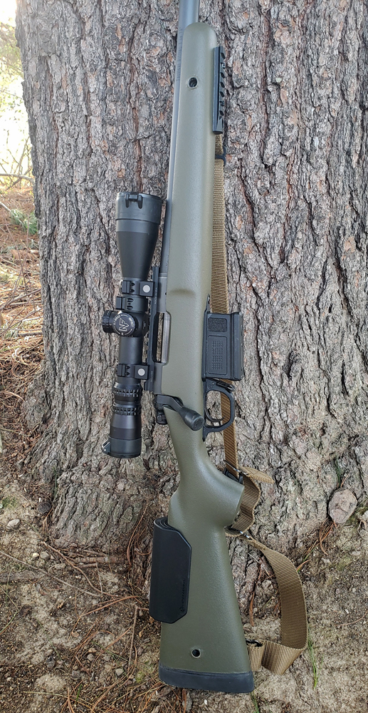

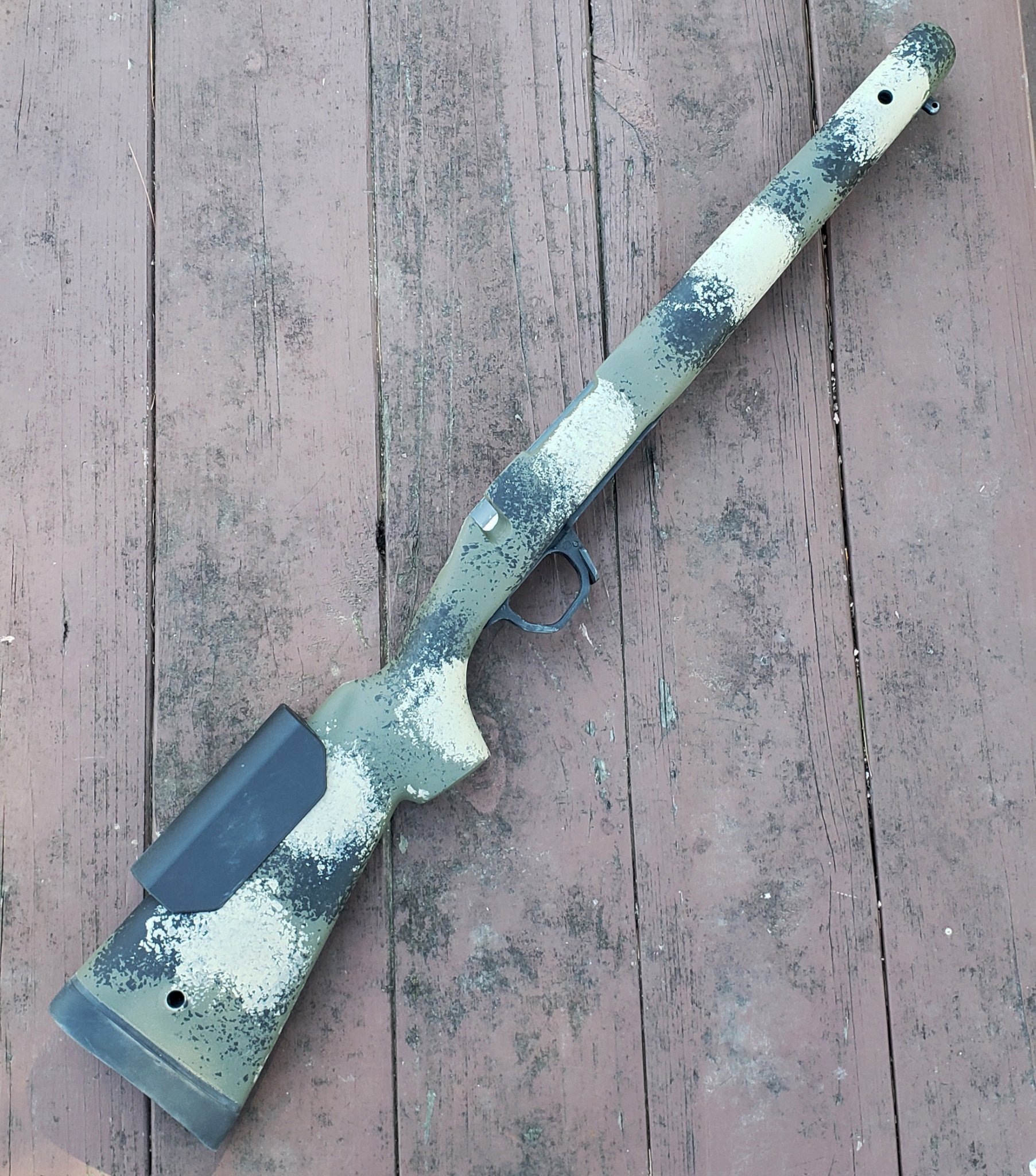

    I can't believe it's been two years since I wrapped this project up but I got bored one day and decided that I didn't really like the janky front rail set up. I settled on taking it back to a more OEM sling swivel set up. I plugged the hole left by one of the mounting screws and had to refinish the stock except this time I went for a quasi-GAP camo sponge job. Colors are off-brand OD camo, the cheapest flat black paint shoved into an aerosol can, and Krylon camo khaki paint finished off with a few coats of Krylon matte clear. The sponges came from Walmart's craft section and cost as much as two of the cans of paint....
    Overall, pretty happy with the outcome though. Pretty funny how far this stock has come from when it was just shoved up in my attic.
