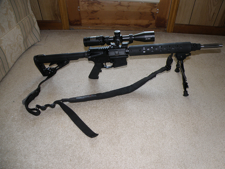

Just wanted to show it off, I wanted my wife to have a rifle of her own so I've been collecting parts here and there to build each of us our first ARs, finally got this together. I also built myself one that's mostly the same but has a 20" bull barrel, same stock /grip/small parts though. Specs are:
Anderson lower, massaged milspec trigger w/ JP springs and anti walk pins (4lb smooth & short pull with grip screw mod), LWRC trigger guard (I love it if for aesthetics alone)
Aero upper, bcm gunfighter ch mod4
Magpul MOE stock (fde, other parts are alumahyde coyote)
Sierra Precision SPR grip, bad lever
18" barrel, 223 wylde chamber from Integrity Arms (supposedly same barrels as ARP, it was a good deal so fingers are crossed).
JP brake, free float tube is fiberglass, built by me, and I threw on a Harris copy for now.
Burris Zee rings and a Redfield Revenge DNS, I'm digging this scope if the elevation turret is repeatable. Windage is capped, reticle has windage markings at 2moa increments @9x, elevation is low-profile and has solid clicks, I figured it'd be perfect for her.
I'll get a range report sometime this week

Thanks guys, Anthony they are right at 1" from rail to center, I'm not sure if it would clear a top rail though so depending on what kind of handguard you have you might have to go higher for that

Your scope looks very low? Can you look through the center of the eye piece with a comfortable cheek weld? I have a Bushnell AR/223 scope with a 4.5-18x40mm zoom mounted in Nikon P-SERIES 2 piece mounts and if they were any lower I could not get a good cheek weld.
Mine measures 1+3/8" from top of rail to center of the 1" scope tube.
