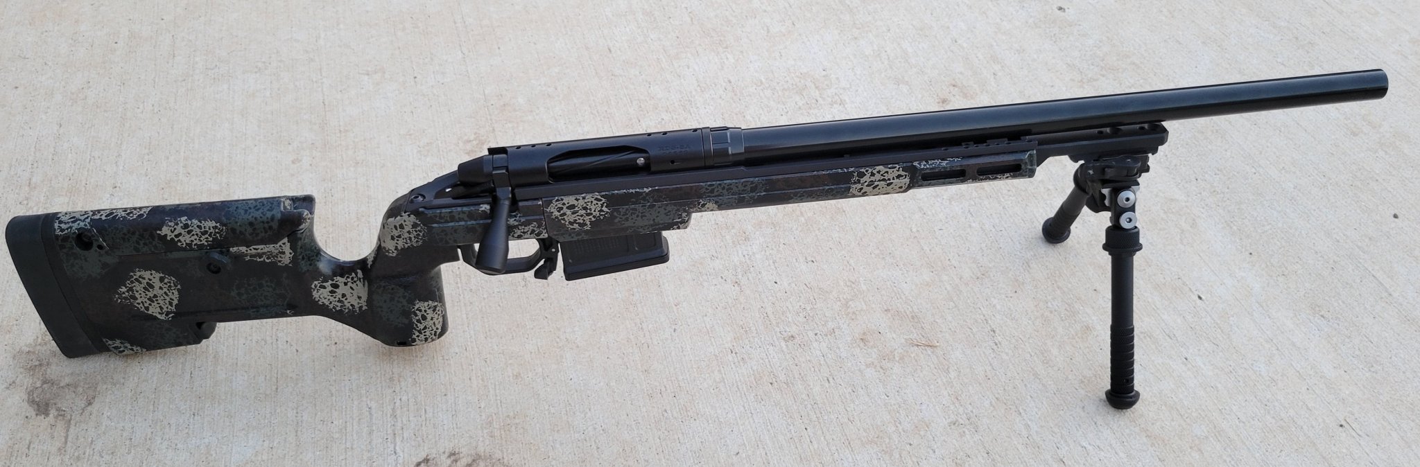

    Newest 22-250 AI barrel showed up today.

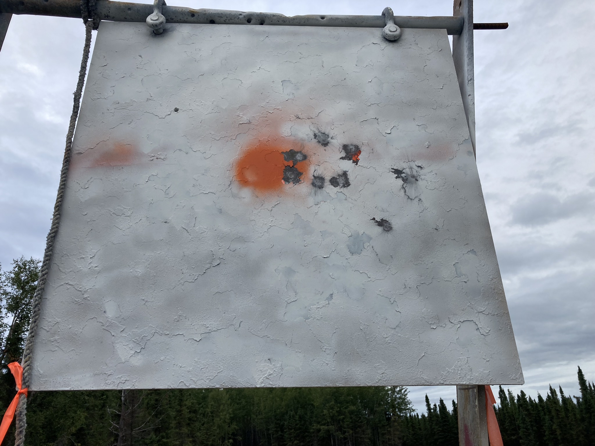

    I too shoot a .223 throated to .169 and 1:7 twist 26 inch barrel. It likes 90 gr SMK at 2775 FPS. Here is a group at a 1000 last night.
    I'm running the same twist in a Schneider 26". Mine did ok with the 90 Berger's but 80 gr amax is where it was at for mine. RL15
    What I’m finding with the 90 gr. is they like to be close to being jammed. I’m only .009 from a jammed stuck bullet. I use Varget when I have it but I have a ton of Imr4064 and since I’m seating so long I’m able to get 24.2 gr in the case and it barely compressed. It was pushing them at 2750. I really think a 6.5 twist would be better for the 90gr. The 88 gr Hornaday eldm fly really well also but they take a bit longer throat due to their longer ogive. A really good read is A Mouse On Steroids.
