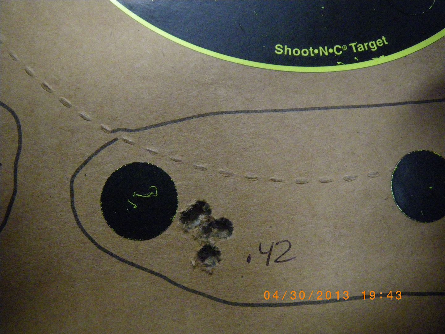

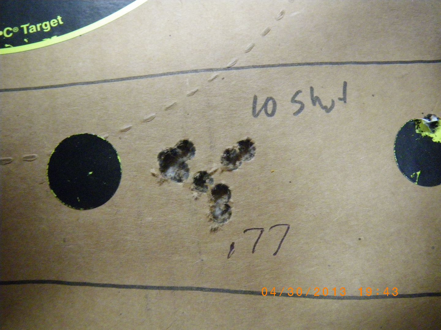

I had the barrel cut to 18 inches and this caused me some troubles with cycling because it did not have enough gas. I had ADCO open the gas port and it worked better but still not 100% so I ended up making a low mass buffer by taking apart 3 rifle buffers removing the heavy weights and only leaving the lighter ones in and now its 100%. Shoots very well and seems to have gotten better as I shoot it. The average with the Sierra load has been .75 so far . (22.3 grains of N135, 77 grain Sierra SMK with cannular Federal match primers Lake City brass avg velocity 2700 fps)
I don't like the reticle in the scope that much as its very fine and hard to see on some backgrounds. I will be getting a different scope when funding allows.
I am very pleased with it so far now that I have it running. The strange thing was the first few groups from the rifle back when it did not cycle sucked. It was shooting 1.5 moa with the same load that gave me a .77 10 shot group. It seems to be tightening up as its shot.
