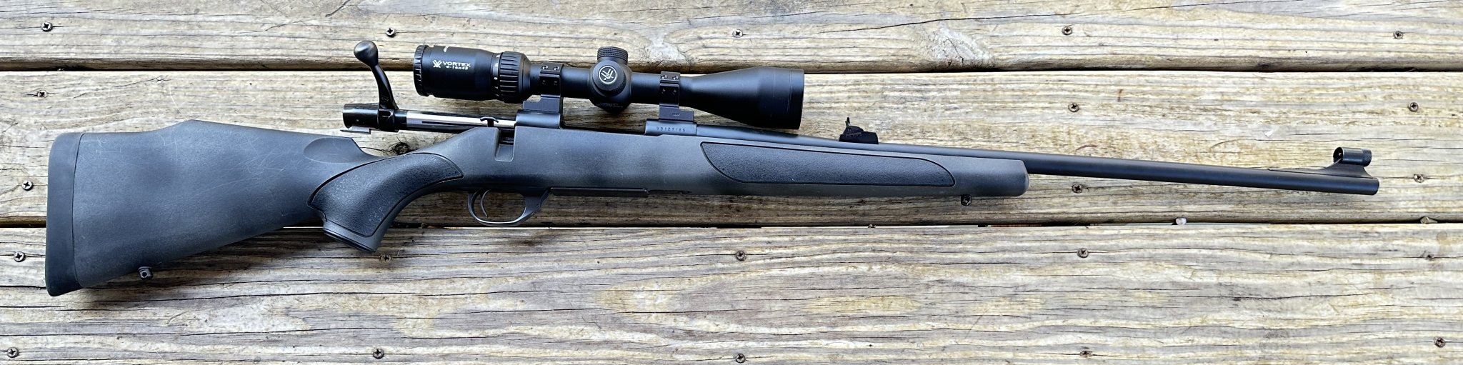

I live in Florida so long range for me might be 200 yards hunting over an open crop field. My local range goes out to 400. That would be max.
